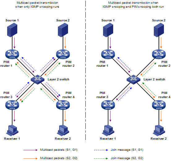

PIM snooping runs on Layer 2 devices. It works with IGMP snooping to analyze received PIM messages, and adds the ports that are interested in specific multicast data to a PIM snooping routing entry. In this way, the multicast data can be forwarded to only the ports that are interested in the data.
Figure 1 Multicast packet transmission without or with PIM snooping
As shown in Figure 1, Source 1 sends multicast data to multicast group G1, and Source 2 sends multicast data to multicast group G2. Receiver 1 belongs to G1, and Receiver 2 belongs to G2. The Layer 2 switch's interfaces that connect to the PIM routers are in the same VLAN.
·          When the Layer 2 switch runs only IGMP snooping, it performs the following actions:
a.    Maintains the router ports according to the received PIM hello messages that PIM routers send.
b.    Floods all other types of received PIM messages except PIM hello messages in the VLAN.
c.    Forwards all multicast data to all router ports in the VLAN.
Each PIM router in the VLAN, whether interested in the multicast data or not, can receive all multicast data and all PIM messages except PIM hello messages.
·          When the Layer 2 switch runs both IGMP snooping and PIM snooping, it performs the following actions:
a.    Examines whether a PIM router is interested in the multicast data addressed to a multicast group according to the received PIM messages that the router sends.
b.    Adds only the ports that connect to the router and are interested in the data to a PIM snooping routing entry.
c.    Forwards PIM messages and multicast data to only the routers that are interested in the data, which saves network bandwidth.

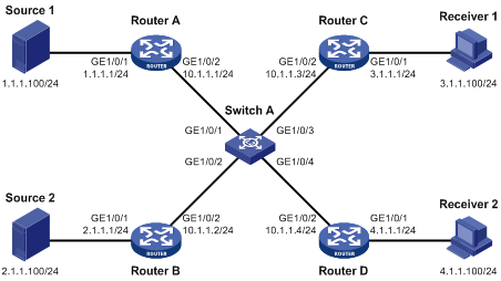

Network requirements
As shown in Figure 2:
·          OSPF runs on the network.
·          Source 1 and Source 2 send multicast data to multicast groups 224.1.1.1 and 225.1.1.1, respectively.
·          Receiver 1 and Receiver 2 belong to multicast groups 224.1.1.1 and 225.1.1.1, respectively.
·          Router C and Router D run IGMP on GigabitEthernet 1/0/1. Router A, Router B, Router C, and Router D run PIM-SM.
·          GigabitEthernet 1/0/2 on Router A acts as a C-BSR and a C-RP.
To make sure Switch A forwards PIM protocol packets and multicast data packets only to the routers that are connected to receivers, perform the following tasks:
·          On Switch A, configure IGMP snooping and PIM snooping.
·          On all PIM routers connected to Switch A, set the maximum size of a join or prune message to 1400 bytes, which is less than the path MTU.
Figure 2 Network diagram

# On Switch A, display PIM snooping neighbor information for VLAN 100.
[SwitchA] display pim-snooping neighbor vlan 100
Total 4 neighbors.
VLAN 100: Total 4 neighbors.
  10.1.1.1
    Ports (1 in total):
      GE1/0/1                 (00:32:43)
  10.1.1.2
    Ports (1 in total):
      GE1/0/2                 (00:32:43)
  10.1.1.3
    Ports (1 in total):
      GE1/0/3                 (00:32:43)
  10.1.1.4
    Ports (1 in total):
      GE1/0/4                 (00:32:43)
The output shows that Router A, Router B, Router C, and Router D are PIM snooping neighbors.
# On Switch A, display PIM snooping routing entries for VLAN 100.
[SwitchA] display pim-snooping routing-table vlan 100
Total 2 entries.
FSM Flag: NI-no info, J-join, PP-prune pending
VLAN 100: Total 2 entries.
  (*, 224.1.1.1)
    Upstream neighbor: 10.1.1.1
      Upstream Ports (1 in total):
        GE1/0/1
      Downstream Ports (1 in total):
        GE1/0/3
          Expires: 00:03:01, FSM: J
  (*, 225.1.1.1)
    Upstream neighbor: 10.1.1.2
        GE1/0/2
        GE1/0/4
          Expires: 00:03:11, FSM: J
The output shows the following information:
·          Switch A will forward the multicast data intended for multicast group 224.1.1.1 only to Router C.
·          Switch A will forward the multicast data intended for multicast group 225.1.1.1 only to Router D.
