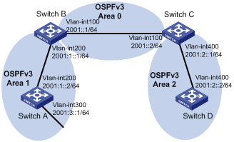

OSPFv3 configuration examples
OSPFv3 stub area configuration example
Network requirements
As shown in Figure 2:
·          Enable OSPFv3 on all switches.
·          Split the AS into three areas.
·          Configure Switch B and Switch C as ABRs to forward routing information between areas.
·          Configure Area 2 as a stub area to reduce LSAs in the area without affecting route reachability.
Figure 2 Network diagram
Configuration procedure
1.        Configure IPv6 addresses for interfaces. (Details not shown.)
2.        Configure basic OSPFv3:
# On Switch A, enable OSPFv3 and specify the router ID as 1.1.1.1.
<SwitchA> system-view
[SwitchA] ospfv3
[SwitchA-ospfv3-1] router-id 1.1.1.1
[SwitchA-ospfv3-1] quit
[SwitchA] interface vlan-interface 300
[SwitchA-Vlan-interface300] ospfv3 1 area 1
[SwitchA-Vlan-interface300] quit
[SwitchA] interface vlan-interface 200
[SwitchA-Vlan-interface200] ospfv3 1 area 1
[SwitchA-Vlan-interface200] quit
# On Switch B, enable OSPFv3 and specify the router ID as 2.2.2.2.
<SwitchB> system-view
[SwitchB] ospfv3
[SwitchB-ospfv3-1] router-id 2.2.2.2
[SwitchB-ospfv3-1] quit
[SwitchB-Vlan-interface100] ospfv3 1 area 0
[SwitchB] interface vlan-interface 200
[SwitchB-Vlan-interface200] ospfv3 1 area 1
[SwitchB-Vlan-interface200] quit
# On Switch C, enable OSPFv3 and specify the router ID as 3.3.3.3.
<SwitchC> system-view
[SwitchC] ospfv3
[SwitchC-ospfv3-1] router-id 3.3.3.3
[SwitchC-ospfv3-1] quit
[SwitchC] interface vlan-interface 100
[SwitchC-Vlan-interface100] ospfv3 1 area 0
[SwitchC-Vlan-interface100] quit
[SwitchC] interface vlan-interface 400
[SwitchC-Vlan-interface400] ospfv3 1 area 2
[SwitchC-Vlan-interface400] quit
# On Switch D, enable OSPFv3 and specify the router ID as 4.4.4.4.
<SwitchD> system-view
[SwitchD] ospfv3
[SwitchD-ospfv3-1] router-id 4.4.4.4
[SwitchD-ospfv3-1] quit
[SwitchD] interface vlan-interface 400
[SwitchD-Vlan-interface400] ospfv3 1 area 2
[SwitchD-Vlan-interface400] quit
# Display OSPFv3 neighbors on Switch B.
[SwitchB] display ospfv3 peer
               OSPFv3 Process 1 with Router ID 2.2.2.2
 Area: 0.0.0.0
 Router ID       Pri State             Dead-Time InstID Interface
 3.3.3.3         1   Full/BDR          00:00:40  0      Vlan100
 Area: 0.0.0.1
 1.1.1.1         1   Full/DR           00:00:40  0      Vlan200
# Display OSPFv3 neighbors on Switch C.
[SwitchC] display ospfv3 peer
               OSPFv3 Process 1 with Router ID 3.3.3.3
 Area: 0.0.0.0
 2.2.2.2         1   Full/DR           00:00:40  0      Vlan100
 Area: 0.0.0.2
 4.4.4.4         1   Full/BDR          00:00:40  0      Vlan400
# Display OSPFv3 routing table information on Switch D.
[SwitchD] display ospfv3 routing
               OSPFv3 Process 1 with Router ID 4.4.4.4
 I  - Intra area route,  E1 - Type 1 external route,  N1 - Type 1 NSSA route
 IA - Inter area route,  E2 - Type 2 external route,  N2 - Type 2 NSSA route
 *  - Selected route
 *Destination: 2001::/64
  Type       : IA                                        Cost     : 2
  NextHop    : FE80::F40D:0:93D0:1                       Interface: Vlan400
  AdvRouter  : 3.3.3.3                                   Area     : 0.0.0.2
  Preference : 10
 *Destination: 2001:1::/64
  Type       : IA                                        Cost     : 3
  Preference : 10
 *Destination: 2001:2::/64
  Type       : I                                         Cost     : 1
  Nexthop    : ::                                        Interface: Vlan400
  AdvRouter  : 4.4.4.4                                   Area     : 0.0.0.2
  Preference : 10
 *Destination: 2001:3::/64
  Type       : IA                                        Cost     : 4
  Preference : 10
 Total: 4
 Intra area: 1         Inter area: 3         ASE: 0         NSSA: 0
3.        Configure Area 2 as a stub area:
# Configure Switch D.
[SwitchD] ospfv3
[SwitchD-ospfv3-1] area 2
[SwitchD-ospfv3-1-area-0.0.0.2] stub
# Configure Switch C, and specify the cost of the default route sent to the stub area as 10.
[SwitchC] ospfv3
[SwitchC-ospfv3-1] area 2
[SwitchC-ospfv3-1-area-0.0.0.2] stub
[SwitchC-ospfv3-1-area-0.0.0.2] default-cost 10
 *  - Selected route
 *Destination: ::/0
  Type       : IA                                        Cost     : 11
  Preference : 10
  Type       : IA                                        Cost     : 2
  Preference : 10
  Type       : IA                                        Cost     : 3
  Preference : 10
  Type       : I                                         Cost     : 1
  Preference : 10
  Type       : IA                                        Cost     : 4
  Preference : 10
 Total: 5
 Intra area: 1         Inter area: 4         ASE: 0         NSSA: 0
The output shows that a default route is added, and its cost is the cost of a direct route plus the configured cost.
4.        Configure Area 2 as a totally stub area:
# Configure Area 2 as a totally stub area on Switch C.
[SwitchC-ospfv3-1-area-0.0.0.2] stub no-summary
 *  - Selected route
 *Destination: ::/0
  Type       : IA                                        Cost     : 11
  Preference : 10
  Type       : I                                         Cost     : 1
  Preference : 10
 Total: 2
 Intra area: 1         Inter area: 1         ASE: 0         NSSA: 0
The output shows that route entries are reduced. All indirect routes are removed, except the default route.

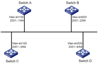

OSPFv3 DR election configuration example
As shown in Figure 4:
·          Configure router priority 100 for Switch A, the highest priority on the network, so it will become the DR.
·          Configure router priority 2 for Switch C, the second highest priority on the network, so it will become the BDR.
·          Configure router priority 0 for Switch B, so it cannot become a DR or BDR.
·          Switch D uses the default router priority 1.
Figure 4 Network diagram
[SwitchA] ospfv3
[SwitchA-Vlan-interface100] ospfv3 1 area 0
[SwitchB] ospfv3
[SwitchB-Vlan-interface200] ospfv3 1 area 0
[SwitchC] ospfv3
[SwitchD] ospfv3
[SwitchD] interface vlan-interface 200
[SwitchD-Vlan-interface200] ospfv3 1 area 0
[SwitchD-Vlan-interface200] quit
# Display neighbor information on Switch A. The switches have the same default DR priority 1, so Switch D (the switch with the highest router ID) is elected as the DR, and Switch C is the BDR.
[SwitchA] display ospfv3 peer
               OSPFv3 Process 1 with Router ID 1.1.1.1
 Area: 0.0.0.0
 2.2.2.2         1   2-Way/DROther     00:00:36  0      Vlan200
 3.3.3.3         1   Full/BDR          00:00:35  0      Vlan100
 4.4.4.4         1   Full/DR           00:00:33  0      Vlan200
# Display neighbor information on Switch D. The neighbor states are all full.
[SwitchD] display ospfv3 peer
 Area: 0.0.0.0
 1.1.1.1         1   Full/DROther      00:00:30  0      Vlan100
 2.2.2.2         1   Full/DROther      00:00:37  0      Vlan200
 3.3.3.3         1   Full/BDR          00:00:31  0      Vlan100
3.        Configure router priorities for interfaces:
# Set the router priority of VLAN-interface 100 to 100 on Switch A.
[SwitchA] interface Vlan-interface 100
[SwitchA-Vlan-interface100] ospfv3 dr-priority 100
# Set the router priority of VLAN-interface 200 to 0 on Switch B.
[SwitchB-Vlan-interface200] ospfv3 dr-priority 0
# Set the router priority of VLAN-interface 100 to 2 on Switch C.
[SwitchC] interface Vlan-interface 100
[SwitchC-Vlan-interface100] ospfv3 dr-priority 2
# Display neighbor information on Switch A. Router priorities have been updated, but the DR and BDR are not changed.
 Area: 0.0.0.0
 2.2.2.2         0   2-Way/DROther     00:00:36  0      Vlan200
 3.3.3.3         2   Full/BDR          00:00:35  0      Vlan200
# Display neighbor information on Switch D. Switch D is still the DR.
 Area: 0.0.0.0
 1.1.1.1         100 Full/DROther      00:00:30  0      Vlan100
 2.2.2.2         0   Full/DROther      00:00:37  0      Vlan200
 3.3.3.3         2   Full/BDR          00:00:31  0      Vlan100
4.        Restart DR and BDR election:
# Use the shutdown and undo shutdown commands on interfaces to restart DR and BDR election. (Details not shown.)
# Display neighbor information on Switch A. The output shows that Switch C becomes the BDR.
 Area: 0.0.0.0
 2.2.2.2         0   Full/DROther      00:00:36  0      Vlan200
 3.3.3.3         2   Full/BDR          00:00:35  0      Vlan100
 4.4.4.4         1   Full/DROther      00:00:33  0      Vlan200
 Area: 0.0.0.0
 1.1.1.1         100 Full/DR           00:00:30  0      Vlan100
 2.2.2.2         0   2-Way/DROther     00:00:37  0      Vlan200
The output shows that Switch A becomes the DR.

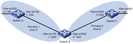

OSPFv3 route redistribution configuration example
As shown in Figure 5:
·          Switch A, Switch B, and Switch C are in Area 2.
·          OSPFv3 process 1 and OSPFv3 process 2 run on Switch B. Switch B communicates with Switch A and Switch C through OSPFv3 process 1 and OSPFv3 process 2.
·          Configure OSPFv3 process 2 to redistribute direct routes and the routes from OSPFv3 process 1 on Switch B, and set the default metric for redistributed routes to 3. Switch C can then learn the routes destined for 1::0/64 and 2::0/64, and Switch A cannot learn the routes destined for 3::0/64 or 4::0/64.
Figure 5 Network diagram
# Enable OSPFv3 process 1 on Switch A.
[SwitchA] ospfv3 1
[SwitchA-Vlan-interface100] ospfv3 1 area 2
[SwitchA-Vlan-interface200] ospfv3 1 area 2
# Enable OSPFv3 process 1 and OSPFv3 process 2 on Switch B.
[SwitchB] ospfv3 1
[SwitchB-Vlan-interface100] ospfv3 1 area 2
[SwitchB] ospfv3 2
[SwitchB-ospfv3-2] router-id 3.3.3.3
[SwitchB-ospfv3-2] quit
[SwitchB] interface vlan-interface 300
[SwitchB-Vlan-interface300] ospfv3 2 area 2
[SwitchB-Vlan-interface300] quit
# Enable OSPFv3 process 2 on Switch C.
[SwitchC] ospfv3 2
[SwitchC-ospfv3-2] router-id 4.4.4.4
[SwitchC-ospfv3-2] quit
[SwitchC] interface vlan-interface 300
[SwitchC-Vlan-interface300] ospfv3 2 area 2
[SwitchC-Vlan-interface300] quit
[SwitchC-Vlan-interface400] ospfv3 2 area 2
# Display the routing table on Switch C.
[SwitchC] display ipv6 routing-table
Destinations : 7 Routes : 7
Destination: ::1/128                                     Protocol  : Direct
NextHop    : ::1                                         Preference: 0
Interface  : InLoop0                                     Cost      : 0
Destination: 3::/64                                      Protocol  : Direct
NextHop    : ::                                          Preference: 0
Interface  : Vlan300                                     Cost      : 0
Destination: 3::2/128                                    Protocol  : Direct
Destination: 4::/64                                      Protocol  : Direct
Interface  : Vlan400                                     Cost      : 0
Destination: 4::1/128                                    Protocol  : Direct
Destination: FE80::/10                                   Protocol  : Direct
Interface  : NULL0                                       Cost      : 0
Destination: FF00::/8                                    Protocol  : Direct
Interface  : NULL0
3.        Configure OSPFv3 route redistribution:
# Configure OSPFv3 process 2 to redistribute direct routes and the routes from OSPFv3 process 1 on Switch B.
[SwitchB] ospfv3 2
[SwitchB-ospfv3-2] default cost 3
[SwitchB-ospfv3-2] import-route ospfv3 1
[SwitchB-ospfv3-2] import-route direct
Destinations : 9 Routes : 9
Destination: 1::/64                                      Protocol  : O_ASE2
NextHop    : FE80::200:CFF:FE01:1C03                     Preference: 150
Interface  : Vlan300                                     Cost      : 3
Destination: 2::/64                                      Protocol  : O_ASE2
Interface  : NULL0

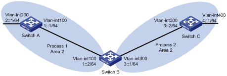

OSPFv3 route summarization configuration example
As shown in Figure 6:
·          OSPFv3 process 1 and OSPFv3 process 2 run on Switch B. Switch B communicates with Switch A and Switch C through OSPFv3 process 1 and OSPFv3 process 2, respectively.
·          On Switch A, configure IPv6 addresses 2:1:1::1/64, 2:1:2::1/64, and 2:1:3::1/64 for VLAN-interface 200.
·          On Switch B, configure OSPFv3 process 2 to redistribute direct routes and the routes from OSPFv3 process 1. Switch C can then learn the routes destined for 2::/64, 2:1:1::/64, 2:1:2::/64, and 2:1:3::/64.
·          On Switch B, configure route summarization to advertise only summary route 2::/16 to Switch C.
Figure 6 Network diagram
2.        Configure OSPFv3:
[SwitchA] ospfv3 1
[SwitchA-Vlan-interface200] ipv6 address 2:1:1::1 64
[SwitchA-Vlan-interface200] ipv6 address 2:1:2::1 64
[SwitchA-Vlan-interface200] ipv6 address 2:1:3::1 64
[SwitchB] ospfv3 1
[SwitchB] ospfv3 2
[SwitchC] ospfv3 2
[SwitchB] ospfv3 2
Destinations : 12 Routes : 12
Interface  : Vlan300                                     Cost      : 1
Destination: 2:1:1::/64                                  Protocol  : O_ASE2
Destination: 2:1:2::/64                                  Protocol  : O_ASE2
Destination: 2:1:3::/64                                  Protocol  : O_ASE2
NextHop    : 3::2                                        Preference: 0
NextHop    : 4::1                                        Preference: 0
Interface  : NULL0
4.        Configure ASBR route summarization:
# On Switch B, configure OSPFv3 process 2 to advertise a single route 2::/16.
[SwitchB] ospfv3 2
[SwitchB-ospfv3-2] asbr-summary 2:: 16
Destination: 2::/16                                      Protocol  : O_ASE2
Interface  : NULL0
OSPFv3 GR configuration example
As shown in Figure 7:
·          Switch A, Switch B, and Switch C that reside in the same AS and the same OSPFv3 routing domain are GR capable.
·          Switch A acts as the GR restarter. Switch B and Switch C act as the GR helpers, and synchronize their LSDBs with Switch A through GR.
Figure 7 Network diagram
# On Switch A, enable OSPFv3 process 1, enable GR, and set the router ID to 1.1.1.1.
[SwitchA] ospfv3 1
[SwitchA-ospfv3-1] graceful-restart enable
[SwitchA-Vlan-interface100] ospfv3 1 area 1
# On Switch B, enable OSPFv3 and set the router ID to 2.2.2.2. (By default, GR helper is enabled on Switch B.)
[SwitchB] ospfv3 1
[SwitchB-Vlan-interface100] ospfv3 1 area 1
# On Switch C, enable OSPFv3 and set the router ID to 3.3.3.3. (By default, GR helper is enabled on Switch C.)
[SwitchC] ospfv3 1
[SwitchC-Vlan-interface100] ospfv3 1 area 1
# Perform a master/backup switchover on Switch A to trigger an OSPFv3 GR operation. (Details not shown.)

OSPFv3 FRR configuration example
As shown in Figure 10, Switch A, Switch B, and Switch C reside in the same OSPFv3 domain. Configure OSPFv3 FRR so that when Link A fails, traffic is immediately switched to Link B.
Figure 10 Network diagram
Device
Interface
IP address
Device
Interface
IP address
Switch A
Vlan-int100
1::1/64
Switch B
Vlan-int101
3::1/64
Vlan-int200
2::1/64
Vlan-int200
2::2/64
Loop0
10::1/128
Loop0
20::1/128
Switch C
Vlan-int100
1::2/64
Vlan-int101
3::2/64
1.        Configure IPv6 addresses and subnet masks for interfaces on the switches. (Details not shown.)
2.        Configure OSPFv3 on the switches to ensure that Switch A, Switch B, and Switch C can communicate with each other at the network layer. (Details not shown.)
3.        Configure OSPFv3 FRR to automatically calculate the backup next hop:
You can enable OSPFv3 FRR to either calculate a backup next hop by using the LFA algorithm, or specify a backup next hop by using a routing policy.
¡  (Method 1.) Enable OSPFv3 FRR to calculate the backup next hop by using the LFA algorithm:
# Configure Switch A.
[SwitchA] ospfv3 1
[SwitchA-ospfv3-1] fast-reroute lfa
# Configure Switch B.
[SwitchB] ospfv3 1
[SwitchB-ospfv3-1] fast-reroute lfa
¡  (Method 2.) Enable OSPFv3 FRR to designate a backup next hop by using a routing policy:
[SwitchA] ipv6 prefix-list abc index 10 permit 20::1 128
[SwitchA] route-policy frr permit node 10
[SwitchA-route-policy-frr-10] if-match ipv6 address prefix-list abc
[SwitchA-route-policy-frr-10] apply ipv6 fast-reroute backup-interface vlan-interface 100 backup-nexthop 1::2/64
[SwitchA-route-policy-frr-10] quit
[SwitchA] ospfv3 1
[SwitchA-ospfv3-1] fast-reroute route-policy frr
[SwitchB] ipv6 prefix-list abc index 10 permit 10::1 128
[SwitchB] route-policy frr permit node 10
[SwitchB-route-policy-frr-10] if-match ipv6 address prefix-list abc
[SwitchB-route-policy-frr-10] apply ipv6 fast-reroute backup-interface vlan-interface 101 backup-nexthop 3::2/64
[SwitchB-route-policy-frr-10] quit
[SwitchB] ospfv3 1
[SwitchB-ospfv3-1] fast-reroute route-policy frr
# Display the route 20::1/128 on Switch A to view the backup next hop information.
[SwitchA] display ipv6 routing-table 20::1 128 verbose
Summary count : 1
Destination: 20::1/128
   Protocol: O_INTRA
 Process ID: 1
  SubProtID: 0x1                    Age: 00h03m45s
       Cost: 6               Preference: 10
      IpPre: N/A             QosLocalID: N/A
        Tag: 0                    State: Active Adv
  OrigTblID: 0x0                OrigVrf: default-vrf
    TableID: 0xa                 OrigAs: 0
      NibID: 0x23000005          LastAs: 0
     AttrID: 0xffffffff        Neighbor: ::
      Flags: 0x10041        OrigNextHop: FE80::7685:45FF:FEAD:102
      Label: NULL           RealNextHop: FE80::7685:45FF:FEAD:102
    BkLabel: NULL             BkNextHop: FE80::34CD:9FF:FE2F:D02
  Tunnel ID: Invalid          Interface: Vlan-interface200
BkTunnel ID: Invalid        BkInterface: Vlan-interface100
   FtnIndex: 0x0           TrafficIndex: N/A
  Connector: N/A
