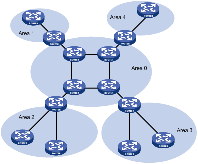

OSPF areas
In large OSPF routing domains, SPF route computations consume too many storage and CPU resources, and enormous OSPF packets generated for route synchronization occupy excessive bandwidth.
To resolve these issues, OSPF splits an AS into multiple areas. Each area is identified by an area ID. The boundaries between areas are routers rather than links. A network segment (or a link) can only reside in one area as shown in Figure 1.
You can configure route summarization on ABRs to reduce the number of LSAs advertised to other areas and minimize the effect of topology changes.
Figure 1 Area-based OSPF network partition

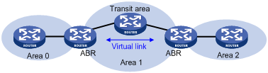

In practice, these requirements might not be met due to lack of physical links. OSPF virtual links can solve this issue.
A virtual link is established between two ABRs through a non-backbone area. It must be configured on both ABRs to take effect. The non-backbone area is called a transit area.
As shown in Figure 2, Area 2 has no direct physical link to the backbone Area 0. You can configure a virtual link between the two ABRs to connect Area 2 to the backbone area.
Figure 2 Virtual link application 1

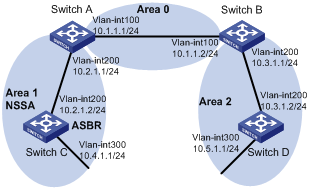

NSSA area and totally NSSA area
An NSSA area does not import AS external LSAs (Type-5 LSAs) but can import Type-7 LSAs generated by the NSSA ASBR. The NSSA ABR translates Type-7 LSAs into Type-5 LSAs and advertises the Type-5 LSAs to other areas.
As shown in Figure 4, the OSPF AS contains Area 1, Area 2, and Area 0. The other two ASs run RIP. Area 1 is an NSSA area where the ASBR redistributes RIP routes in Type-7 LSAs into Area 1. Upon receiving the Type-7 LSAs, the NSSA ABR translates them to Type-5 LSAs, and advertises the Type-5 LSAs to Area 0.
The ASBR of Area 2 redistributes RIP routes in Type-5 LSAs into the OSPF routing domain. However, Area 1 does not receive Type-5 LSAs because it is an NSSA area.
Figure 4 NSSA area

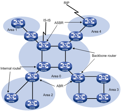

Router types
OSPF routers are classified into the following types based on their positions in the AS:
·          Internal router—All interfaces on an internal router belong to one OSPF area.
·          ABR—Belongs to more than two areas, one of which must be the backbone area. ABR connects the backbone area to a non-backbone area. An ABR and the backbone area can be connected through a physical or logical link.
·          Backbone router—No less than one interface of a backbone router must reside in the backbone area. All ABRs and internal routers in Area 0 are backbone routers.
·          ASBR—Exchanges routing information with another AS is an ASBR. An ASBR might not reside on the border of the AS. It can be an internal router or an ABR.
Figure 5 OSPF router types

Configuring a virtual link
Virtual links are configured for connecting backbone area routers that have no direct physical links.
To configure a virtual link:
Step
Remarks
1.       Enter system view.
N/A
2.       Enter OSPF view.
ospf [ process-id | router-id router-id ] *
N/A
3.       Enter area view.
area area-id
N/A
4.       Configure a virtual link.
vlink-peer router-id [ dead seconds | hello seconds | { { hmac-md5 | md5 } key-id { cipher | plain } string | keychain keychain-name | simple { cipher | plain } string } | retransmit seconds | trans-delay seconds ] *
By default, no virtual links exist.
Configure this command on both ends of a virtual link. The hello and dead intervals must be identical on both ends of the virtual link.

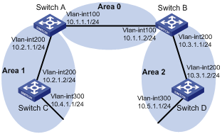

OSPF configuration examples
Basic OSPF configuration example
Network requirements
As shown in Figure 8:
·          Enable OSPF on all switches, and split the AS into three areas.
·          Configure Switch A and Switch B as ABRs.
Figure 8 Network diagram
Configuration procedure
1.        Configure IP addresses for interfaces. (Details not shown.)
2.        Enable OSPF:
# Configure Switch A.
<SwitchA> system-view
[SwitchA] router id 10.2.1.1
[SwitchA] ospf
[SwitchA-ospf-1] area 0
[SwitchA-ospf-1-area-0.0.0.0] network 10.1.1.0 0.0.0.255
[SwitchA-ospf-1-area-0.0.0.0] quit
[SwitchA-ospf-1] area 1
[SwitchA-ospf-1-area-0.0.0.1] network 10.2.1.0 0.0.0.255
[SwitchA-ospf-1-area-0.0.0.1] quit
[SwitchA-ospf-1] quit
# Configure Switch B.
<SwitchB> system-view
[SwitchB] router id 10.3.1.1
[SwitchB] ospf
[SwitchB-ospf-1] area 0
[SwitchB-ospf-1-area-0.0.0.0] network 10.1.1.0 0.0.0.255
[SwitchB-ospf-1-area-0.0.0.0] quit
[SwitchB-ospf-1] area 2
[SwitchB-ospf-1-area-0.0.0.2] network 10.3.1.0 0.0.0.255
[SwitchB-ospf-1-area-0.0.0.2] quit
[SwitchB-ospf-1] quit
# Configure Switch C.
<SwitchC> system-view
[SwitchC] router id 10.4.1.1
[SwitchC] ospf
[SwitchC-ospf-1] area 1
[SwitchC-ospf-1-area-0.0.0.1] network 10.2.1.0 0.0.0.255
[SwitchC-ospf-1-area-0.0.0.1] network 10.4.1.0 0.0.0.255
[SwitchC-ospf-1-area-0.0.0.1] quit
[SwitchC-ospf-1] quit
# Configure Switch D.
<SwitchD> system-view
[SwitchD] router id 10.5.1.1
[SwitchD] ospf
[SwitchD-ospf-1] area 2
[SwitchD-ospf-1-area-0.0.0.2] network 10.3.1.0 0.0.0.255
[SwitchD-ospf-1-area-0.0.0.2] network 10.5.1.0 0.0.0.255
[SwitchD-ospf-1-area-0.0.0.2] quit
[SwitchD-ospf-1] quit
# Display information about neighbors on Switch A.
[SwitchA] display ospf peer verbose
          OSPF Process 1 with Router ID 10.2.1.1
                  Neighbors
 Area 0.0.0.0 interface 10.1.1.1(Vlan-interface100)'s neighbors
 Router ID: 10.3.1.1         Address: 10.1.1.2         GR State: Normal
   State: Full  Mode: Nbr is master  Priority: 1
   DR: 10.1.1.1  BDR: 10.1.1.2  MTU: 0
   Options is 0x02 (-|-|-|-|-|-|E|-)
   Dead timer due in 37  sec
   Neighbor is up for 06:03:59
   Authentication Sequence: [ 0 ]
   Neighbor state change count: 5
 Area 0.0.0.1 interface 10.2.1.1(Vlan-interface200)'s neighbors
 Router ID: 10.4.1.1         Address: 10.2.1.2         GR State: Normal
   DR: 10.2.1.1  BDR: 10.2.1.2  MTU: 0
   Dead timer due in 32  sec
   Neighbor is up for 06:03:12
# Display OSPF routing information on Switch A.
[SwitchA] display ospf routing
                   Routing Table
 Routing for network
 Destination        Cost     Type    NextHop         AdvRouter       Area
 10.2.1.0/24        1        Transit 10.2.1.1        10.2.1.1        0.0.0.1
 10.3.1.0/24        2        Inter   10.1.1.2        10.3.1.1        0.0.0.0
 10.4.1.0/24        2        Stub    10.2.1.2        10.4.1.1        0.0.0.1
 10.5.1.0/24        3        Inter   10.1.1.2        10.3.1.1        0.0.0.0
 10.1.1.0/24        1        Transit 10.1.1.1        10.2.1.1        0.0.0.0
 Total nets: 5
 Intra area: 3  Inter area: 2  ASE: 0  NSSA: 0
# Display OSPF routing information on Switch D.
[SwitchD] display ospf routing
          OSPF Process 1 with Router ID 10.5.1.1
                   Routing Table
 Routing for network
 10.2.1.0/24        3        Inter   10.3.1.1        10.3.1.1        0.0.0.2
 10.3.1.0/24        1        Transit 10.3.1.2        10.3.1.1        0.0.0.2
 10.4.1.0/24        4        Inter   10.3.1.1        10.3.1.1        0.0.0.2
 10.5.1.0/24        1        Stub    10.5.1.1        10.5.1.1        0.0.0.2
 10.1.1.0/24        2        Inter   10.3.1.1        10.3.1.1        0.0.0.2
 Total nets: 5
 Intra area: 2  Inter area: 3  ASE: 0  NSSA: 0
# On Switch D, ping the IP address 10.4.1.1 to test reachability.
[SwitchD] ping 10.4.1.1
Ping 10.4.1.1 (10.4.1.1): 56 data bytes, press CTRL_C to break
56 bytes from 10.4.1.1: icmp_seq=0 ttl=253 time=1.549 ms
56 bytes from 10.4.1.1: icmp_seq=1 ttl=253 time=1.539 ms
56 bytes from 10.4.1.1: icmp_seq=2 ttl=253 time=0.779 ms
56 bytes from 10.4.1.1: icmp_seq=3 ttl=253 time=1.702 ms
56 bytes from 10.4.1.1: icmp_seq=4 ttl=253 time=1.471 ms
--- Ping statistics for 10.4.1.1 ---
round-trip min/avg/max/std-dev = 0.779/1.408/1.702/0.323 ms

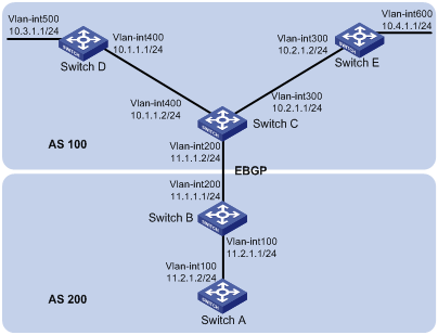

As shown in Figure 10:
·          Configure OSPF on Switch A and Switch B in AS 200.
·          Configure OSPF on Switch C, Switch D, and Switch E in AS 100.
·          Configure an EBGP connection between Switch B and Switch C. Configure Switch B and Switch C to redistribute OSPF routes and direct routes into BGP and BGP routes into OSPF.
·          Configure Switch B to advertise only summary route 10.0.0.0/8 to Switch A.
Figure 10 Network diagram
2.        Enable OSPF:
[SwitchA] router id 11.2.1.2
[SwitchA] ospf
[SwitchA-ospf-1-area-0.0.0.0] network 11.2.1.0 0.0.0.255
[SwitchB] router id 11.2.1.1
[SwitchB] ospf
[SwitchB-ospf-1-area-0.0.0.0] network 11.2.1.0 0.0.0.255
[SwitchC] router id 11.1.1.2
[SwitchC] ospf
[SwitchC-ospf-1] area 0
[SwitchC-ospf-1-area-0.0.0.0] network 10.1.1.0 0.0.0.255
[SwitchC-ospf-1-area-0.0.0.0] network 10.2.1.0 0.0.0.255
[SwitchC-ospf-1-area-0.0.0.0] quit
[SwitchD] router id 10.3.1.1
[SwitchD] ospf
[SwitchD-ospf-1] area 0
[SwitchD-ospf-1-area-0.0.0.0] network 10.1.1.0 0.0.0.255
[SwitchD-ospf-1-area-0.0.0.0] network 10.3.1.0 0.0.0.255
[SwitchD-ospf-1-area-0.0.0.0] quit
# Configure Switch E.
<SwitchE> system-view
[SwitchE] router id 10.4.1.1
[SwitchE] ospf
[SwitchE-ospf-1] area 0
[SwitchE-ospf-1-area-0.0.0.0] network 10.2.1.0 0.0.0.255
[SwitchE-ospf-1-area-0.0.0.0] network 10.4.1.0 0.0.0.255
[SwitchE-ospf-1-area-0.0.0.0] quit
[SwitchE-ospf-1] quit
3.        Configure BGP to redistribute OSPF routes and direct routes:
[SwitchB] bgp 200
[SwitchB-bgp] peer 11.1.1.2 as 100
[SwitchB-bgp] address-family ipv4 unicast
[SwitchB-bgp-ipv4] import-route ospf
[SwitchB-bgp-ipv4] import-route direct
[SwitchB-bgp ipv4] quit
[SwitchB-bgp] quit
[SwitchC] bgp 100
[SwitchC-bgp] peer 11.1.1.1 as 200
[SwitchC-bgp] address-family ipv4 unicast
[SwitchC-bgp-ipv4] import-route ospf
[SwitchC-bgp-ipv4]import-route direct
[SwitchC-bgp-ipv4] quit
[SwitchC-bgp] quit
4.        Configure Switch B and Switch C to redistribute BGP routes into OSPF:
# Configure OSPF to redistribute routes from BGP on Switch B.
[SwitchB] ospf
[SwitchB-ospf-1] import-route bgp
# Configure OSPF to redistribute routes from BGP on Switch C.
[SwitchC] ospf
[SwitchC-ospf-1] import-route bgp
# Display the OSPF routing table on Switch A.
[SwitchA] display ip routing-table
         Destinations : 16        Routes : 16
0.0.0.0/32          Direct 0    0            127.0.0.1       InLoop0
10.1.1.0/24         O_ASE2 150  1            11.2.1.1        Vlan100
10.2.1.0/24         O_ASE2 150  1            11.2.1.1        Vlan100
10.3.1.0/24         O_ASE2 150  1            11.2.1.1        Vlan100
10.4.1.0/24         O_ASE2 150  1            11.2.1.1        Vlan100
11.2.1.0/24         Direct 0    0            11.2.1.2        Vlan100
11.2.1.0/32         Direct 0    0            11.2.1.2        Vlan100
11.2.1.2/32         Direct 0    0            127.0.0.1       InLoop0
11.2.1.255/32       Direct 0    0            11.2.1.2        Vlan100
127.0.0.0/8         Direct 0    0            127.0.0.1       InLoop0
127.0.0.0/32        Direct 0    0            127.0.0.1       InLoop0
127.0.0.1/32        Direct 0    0            127.0.0.1       InLoop0
127.255.255.255/32  Direct 0    0            127.0.0.1       InLoop0
224.0.0.0/4         Direct 0    0            0.0.0.0         NULL0
224.0.0.0/24        Direct 0    0            0.0.0.0         NULL0
255.255.255.255/32  Direct 0    0            127.0.0.1       InLoop0
5.        Configure route summarization:
# Configure route summarization on Switch B to advertise a summary route 10.0.0.0/8.
[SwitchB-ospf-1] asbr-summary 10.0.0.0 8
# Display the IP routing table on Switch A.
         Destinations : 13        Routes : 13
10.0.0.0/8          O_ASE2 150  1            11.2.1.1        Vlan100
The output shows that routes 10.1.1.0/24, 10.2.1.0/24, 10.3.1.0/24 and 10.4.1.0/24 are summarized into a single route 10.0.0.0/8.

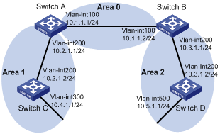

As shown in Figure 11:
·          Configure Switch A and Switch B as ABRs to forward routing information between areas.
·          Configure Switch D as the ASBR to redistribute static routes.
·          Configure Area 1 as a stub area to reduce advertised LSAs without influencing reachability.
Figure 11 Network diagram
2.        Enable OSPF (see "
3.        Basic OSPF configuration example").
4.        Configure route redistribution:
# Configure Switch D to redistribute static routes.
[SwitchD] ip route-static 3.1.2.1 24 10.5.1.2
[SwitchD] ospf
[SwitchD-ospf-1] import-route static
# Display ABR/ASBR information on Switch C.
<SwitchC> display ospf abr-asbr
          OSPF Process 1 with Router ID 10.4.1.1
                  Routing Table to ABR and ASBR
 Type        Destination     Area            Cost  Nexthop         RtType
 Intra       10.2.1.1        0.0.0.1         3     10.2.1.1        ABR
 Inter       10.5.1.1        0.0.0.1         7     10.2.1.1        ASBR
# Display OSPF routing table on Switch C.
<SwitchC> display ospf routing
                   Routing Table
 Routing for network
 10.2.1.0/24        3        Transit 0.0.0.0         10.2.1.1        0.0.0.1
 10.3.1.0/24        7        Inter   10.2.1.1        10.2.1.1        0.0.0.1
 10.4.1.0/24        3        Stub    10.4.1.1        10.4.1.1        0.0.0.1
 10.5.1.0/24        17       Inter   10.2.1.1        10.2.1.1        0.0.0.1
 10.1.1.0/24        5        Inter   10.2.1.1        10.2.1.1        0.0.0.1
 Routing for ASEs
 Destination        Cost     Type    Tag         NextHop         AdvRouter
 3.1.2.0/24         1        Type2   1           10.2.1.1        10.5.1.1
 Total nets: 6
 Intra area: 2  Inter area: 3  ASE: 1  NSSA: 0
The output shows that Switch C's routing table contains an AS external route.
5.        Configure Area 1 as a stub area:
[SwitchA] ospf
[SwitchA-ospf-1-area-0.0.0.1] stub
[SwitchC] ospf
[SwitchC-ospf-1-area-0.0.0.1] stub
# Display OSPF routing information on Switch C
[SwitchC] display ospf routing
                   Routing Table
 Routing for network
 0.0.0.0/0          4        Inter   10.2.1.1        10.2.1.1        0.0.0.1
 Total nets: 6
 Intra area: 2  Inter area: 4  ASE: 0  NSSA: 0
The output shows that a default route replaces the AS external route.
# Configure Area 1 as a totally stub area.
[SwitchA] ospf
[SwitchA-ospf-1-area-0.0.0.1] stub no-summary
# Display OSPF routing information on Switch C.
                   Routing Table
 Routing for network
 10.2.1.0/24        3        Transit 0.0.0.0         10.4.1.1        0.0.0.1
 Total nets: 3
 Intra area: 2  Inter area: 1  ASE: 0  NSSA: 0
The output shows that inter-area routes are removed, and only one external route (a default route) exists on Switch C.
OSPF NSSA area configuration example
As shown in Figure 12:
·          Configure OSPF on all switches and split AS into three areas.
·          Configure Area 1 as an NSSA area and configure Switch C as an ASBR to redistribute static routes into the AS.
Figure 12 Network diagram
4.        Configure Area 1 as an NSSA area:
[SwitchA] ospf
[SwitchA-ospf-1-area-0.0.0.1] nssa
[SwitchC] ospf
[SwitchC-ospf-1-area-0.0.0.1] nssa
                   Routing Table
 Routing for network
 10.2.1.0/24        3        Transit 10.2.1.2        10.4.1.1        0.0.0.1
 Total nets: 5
5.        Configure route redistribution:
# Configure Switch C to redistribute static routes.
[SwitchC] ip route-static 3.1.3.1 24 10.4.1.2
[SwitchC] ospf
[SwitchC-ospf-1] import-route static
<SwitchD> display ospf routing
                   Routing Table
 Routing for network
 10.2.1.0/24        22       Inter   10.3.1.1        10.3.1.1        0.0.0.2
 10.3.1.0/24        10       Transit 10.3.1.2        10.3.1.1        0.0.0.2
 10.4.1.0/24        25       Inter   10.3.1.1        10.3.1.1        0.0.0.2
 10.5.1.0/24        10       Stub    10.5.1.1        10.5.1.1        0.0.0.2
 10.1.1.0/24        12       Inter   10.3.1.1        10.3.1.1        0.0.0.2
 Routing for ASEs
 3.1.3.0/24         1        Type2   1           10.3.1.1        10.2.1.1
 Total nets: 6
The output shows that an external route imported from the NSSA area exists on Switch D.
[SwitchB] ospf 1 router-id 2.2.2.2
[SwitchB-ospf-1] area 1
[SwitchB–ospf-1-area-0.0.0.1] network 10.2.1.0 0.0.0.255
[SwitchB–ospf-1-area-0.0.0.1] quit
[SwitchC] ospf 1 router-id 3.3.3.3
[SwitchC-ospf-1] area 2
[SwitchC–ospf-1-area-0.0.0.2] network 10.3.1.0 0.0.0.255
[SwitchC–ospf-1-area-0.0.0.2] quit
[SwitchD] ospf 1 router-id 4.4.4.4
# Display the OSPF routing table on Switch B.
[SwitchB] display ospf routing
          OSPF Process 1 with Router ID 2.2.2.2
                   Routing Table
 Routing for network
 10.2.1.0/24        2        Transit 10.2.1.1        3.3.3.3         0.0.0.1
 10.1.1.0/24        2        Transit 10.1.1.2        2.2.2.2         0.0.0.0
 Total nets: 2
 Intra area: 2  Inter area: 0  ASE: 0  NSSA: 0
The output shows that Switch B does not have routes to Area 2 because Area 0 is not directly connected to Area 2.
3.        Configure a virtual link:
[SwitchB] ospf
[SwitchB-ospf-1-area-0.0.0.1] vlink-peer 3.3.3.3
[SwitchB-ospf-1-area-0.0.0.1] quit
[SwitchC] ospf 1
[SwitchC-ospf-1-area-0.0.0.1] vlink-peer 2.2.2.2
                   Routing Table
 Routing for network
 10.3.1.0/24        5        Inter   10.2.1.2        3.3.3.3         0.0.0.0
 Total nets: 3
The output shows that Switch B has learned the route 10.3.1.0/24 to Area 2.

OSPF FRR configuration example
As shown in Figure 18, Switch A, Switch B, and Switch C reside in the same OSPF domain. Configure OSPF FRR so that when the link between Switch A and Switch B fails, traffic is immediately switched to Link B.
Figure 18 Network diagram
Device
Interface
IP address
Switch A
Vlan-int100
12.12.12.1/24
Switch A
Vlan-int200
13.13.13.1/24
Switch A
Loop0
1.1.1.1/32
Switch B
Vlan-int101
24.24.24.4/24
Switch B
Vlan-int200
13.13.13.2/24
Switch B
Loop0
4.4.4.4/32
Switch C
Vlan-int100
12.12.12.2/24
Switch C
Vlan-int101
24.24.24.2/24
1.        Configure IP addresses and subnet masks for interfaces on the switches. (Details not shown.)
2.        Configure OSPF on the switches to ensure that Switch A, Switch B, and Switch C can communicate with each other at the network layer. (Details not shown.)
3.        Configure OSPF FRR to automatically calculate the backup next hop:
You can enable OSPF FRR to either calculate a backup next hop by using the LFA algorithm, or specify a backup next hop by using a routing policy.
¡  (Method 1.) Enable OSPF FRR to calculate the backup next hop by using the LFA algorithm:
[SwitchA] ospf 1
[SwitchA-ospf-1] fast-reroute lfa
[SwitchB] ospf 1
[SwitchB-ospf-1] fast-reroute lfa
¡  (Method 2.) Enable OSPF FRR to designate a backup next hop by using a routing policy.
[SwitchA] ip prefix-list abc index 10 permit 4.4.4.4 32
[SwitchA] route-policy frr permit node 10
[SwitchA-route-policy-frr-10] if-match ip address prefix-list abc
[SwitchA-route-policy-frr-10] apply fast-reroute backup-interface vlan-interface 100 backup-nexthop 12.12.12.2
[SwitchA-route-policy-frr-10] quit
[SwitchA] ospf 1
[SwitchA-ospf-1] fast-reroute route-policy frr
[SwitchB] ip prefix-list abc index 10 permit 1.1.1.1 32
[SwitchB] route-policy frr permit node 10
[SwitchB-route-policy-frr-10] if-match ip address prefix-list abc
[SwitchB-route-policy-frr-10] apply fast-reroute backup-interface vlan-interface 101 backup-nexthop 24.24.24.2
[SwitchB-route-policy-frr-10] quit
[SwitchB] ospf 1
[SwitchB-ospf-1] fast-reroute route-policy frr
# Display route 4.4.4.4/32 on Switch A to view the backup next hop information.
[SwitchA] display ip routing-table 4.4.4.4 verbose
Summary Count : 1
Destination: 4.4.4.4/32
   Protocol: O_INTRA
 Process ID: 1
  SubProtID: 0x1                     Age: 04h20m37s
       Cost: 1                Preference: 10
      IpPre: N/A              QosLocalID: N/A
        Tag: 0                     State: Active Adv
  OrigTblID: 0x0                 OrigVrf: default-vrf
    TableID: 0x2                  OrigAs: 0
      NibID: 0x26000002           LastAs: 0
     AttrID: 0xffffffff         Neighbor: 0.0.0.0
      Flags: 0x1008c         OrigNextHop: 13.13.13.2
      Label: NULL            RealNextHop: 13.13.13.2
    BkLabel: NULL              BkNextHop: 12.12.12.2
  Tunnel ID: Invalid           Interface: Vlan-interface200
BkTunnel ID: Invalid         BkInterface: Vlan-interface100
   FtnIndex: 0x0            TrafficIndex: N/A
  Connector: N/A
# Display route 1.1.1.1/32 on Switch B to view the backup next hop information.
[SwitchB] display ip routing-table 1.1.1.1 verbose
Summary Count : 1
Destination: 1.1.1.1/32
   Protocol: O_INTRA
 Process ID: 1
      Flags: 0x1008c         OrigNextHop: 13.13.13.1
      Label: NULL            RealNextHop: 13.13.13.1
    BkLabel: NULL              BkNextHop: 24.24.24.2
BkTunnel ID: Invalid         BkInterface: Vlan-interface101
  Connector: N/A
