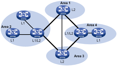

Figure 2 shows one IS-IS network topology. Area 1 is the backbone that comprises a set of Level-2 routers. The other four areas are non-backbone areas connected to the backbone through Level-1-2 routers.
Figure 2 IS-IS topology 1

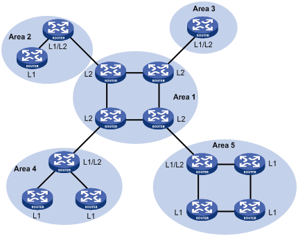

Figure 3 shows another IS-IS topology. The Level-1-2 routers connect to the Level-1 and Level-2 routers, and form the IS-IS backbone together with the Level-2 routers. No area is defined as the backbone in this topology. The backbone comprises all contiguous Level-2 and Level-1-2 routers in different areas. The IS-IS backbone does not need to be a specific area.
Figure 3 IS-IS topology 2
Both the Level-1 and Level-2 routers use the SPF algorithm to generate the shortest path tree.

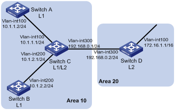

IS-IS configuration examples
Basic IS-IS configuration example
Network requirements
As shown in Figure 8, Switch A, Switch B, Switch C, and Switch D reside in an IS-IS AS.
Switch A and B are Level-1 switches, Switch D is a Level-2 switch, and Switch C is a Level-1-2 switch. Switch A, Switch B, and Switch C are in Area 10, and Switch D is in Area 20.
Figure 8 Network diagram
Configuration procedure
1.        Configure IP addresses for interfaces. (Details not shown.)
2.        Configure IS-IS:
# Configure Switch A.
<SwitchA> system-view
[SwitchA] isis 1
[SwitchA-isis-1] is-level level-1
[SwitchA-isis-1] network-entity 10.0000.0000.0001.00
[SwitchA-isis-1] quit
[SwitchA-Vlan-interface100] isis enable 1
# Configure Switch B.
<SwitchB> system-view
[SwitchB] isis 1
[SwitchB-isis-1] is-level level-1
[SwitchB-isis-1] network-entity 10.0000.0000.0002.00
[SwitchB-isis-1] quit
[SwitchB] interface vlan-interface 200
[SwitchB-Vlan-interface200] isis enable 1
[SwitchB-Vlan-interface200] quit
# Configure Switch C.
<SwitchC> system-view
[SwitchC] isis 1
[SwitchC-isis-1] network-entity 10.0000.0000.0003.00
[SwitchC-isis-1] quit
[SwitchC] interface vlan-interface 100
[SwitchC-Vlan-interface100] isis enable 1
[SwitchC-Vlan-interface100] quit
[SwitchC] interface vlan-interface 200
[SwitchC-Vlan-interface200] isis enable 1
[SwitchC-Vlan-interface200] quit
[SwitchC] interface vlan-interface 300
[SwitchC-Vlan-interface300] isis enable 1
[SwitchC-Vlan-interface300] quit
# Configure Switch D.
<SwitchD> system-view
[SwitchD] isis 1
[SwitchD-isis-1] is-level level-2
[SwitchD-isis-1] network-entity 20.0000.0000.0004.00
[SwitchD-isis-1] quit
[SwitchD] interface vlan-interface 100
[SwitchD-Vlan-interface100] isis enable 1
[SwitchD-Vlan-interface100] quit
[SwitchD] interface vlan-interface 300
[SwitchD-Vlan-interface300] isis enable 1
[SwitchD-Vlan-interface300] quit
# Display the IS-IS LSDB on each switch to verify the LSPs.
[SwitchA] display isis lsdb
                       Database information for IS-IS(1)
                          Level-1 Link State Database
LSPID                 Seq Num      Checksum   Holdtime   Length  ATT/P/OL
0000.0000.0001.00-00* 0x00000004   0xdf5e     1096       68      0/0/0
0000.0000.0002.00-00  0x00000004   0xee4d     1102       68      0/0/0
0000.0000.0002.01-00  0x00000001   0xdaaf     1102       55      0/0/0
0000.0000.0003.00-00  0x00000009   0xcaa3     1161       111     1/0/0
0000.0000.0003.01-00  0x00000001   0xadda     1112       55      0/0/0
    *-Self LSP, +-Self LSP(Extended), ATT-Attached, P-Partition, OL-Overload
[SwitchB] display isis lsdb
0000.0000.0001.00-00  0x00000006   0xdb60     988         68      0/0/0
0000.0000.0002.00-00* 0x00000008   0xe651     1189        68      0/0/0
0000.0000.0002.01-00* 0x00000005   0xd2b3     1188        55      0/0/0
0000.0000.0003.00-00  0x00000014   0x194a     1190        111     1/0/0
0000.0000.0003.01-00  0x00000002   0xabdb     995         55      0/0/0
[SwitchC] display isis lsdb
0000.0000.0001.00-00  0x00000006   0xdb60     847         68      0/0/0
0000.0000.0002.00-00  0x00000008   0xe651     1053        68      0/0/0
0000.0000.0002.01-00  0x00000005   0xd2b3     1052        55      0/0/0
0000.0000.0003.00-00* 0x00000014   0x194a     1051        111     1/0/0
0000.0000.0003.01-00* 0x00000002   0xabdb     854         55      0/0/0
                          Level-2 Link State Database
0000.0000.0003.00-00* 0x00000012   0xc93c     842         100     0/0/0
0000.0000.0004.00-00  0x00000026   0x331      1173        84      0/0/0
0000.0000.0004.01-00  0x00000001   0xee95     668         55      0/0/0
[SwitchD] display isis lsdb
0000.0000.0003.00-00  0x00000013   0xc73d        1003          100     0/0/0
0000.0000.0004.00-00* 0x0000003c   0xd647        1194          84      0/0/0
0000.0000.0004.01-00* 0x00000002   0xec96        1007          55      0/0/0
# Display the IS-IS routing information on each switch.
[SwitchA] display isis route
                         Route information for IS-IS(1)
                         Level-1 IPv4 Forwarding Table
 IPv4 Destination     IntCost    ExtCost ExitInterface   NextHop         Flags
 10.1.1.0/24          10         NULL    Vlan100         Direct          D/L/-
 10.1.2.0/24          20         NULL    Vlan100         10.1.1.1        R/-/-
 192.168.0.0/24       20         NULL    Vlan100         10.1.1.1        R/-/-
 0.0.0.0/0            10         NULL    Vlan100         10.1.1.1        R/-/-
      Flags: D-Direct, R-Added to Rib, L-Advertised in LSPs, U-Up/Down Bit Set
[SwitchC] display isis route
 192.168.0.0/24       10         NULL    Vlan300         Direct          D/L/-
 10.1.2.0/24          10         NULL    Vlan200         Direct          D/L/-
                         Level-2 IPv4 Forwarding Table
 192.168.0.0/24       10         NULL                                    D/L/-
 10.1.1.0/24          10         NULL                                    D/L/-
 10.1.2.0/24          10         NULL                                    D/L/-
 172.16.0.0/16        20         NULL    Vlan300         192.168.0.2     R/-/-
[SwitchD] display isis route
 10.1.1.0/24          20         NULL    Vlan300         192.168.0.1     R/-/-
 10.1.2.0/24          20         NULL    Vlan300         192.168.0.1     R/-/-
 172.16.0.0/16        10         NULL    Vlan100         Direct          D/L/-
The output shows that the routing table of Level-1 switches contains a default route with the next hop as the Level-1-2 switch. The routing table of Level-2 switch contains both routing information of Level-1 and Level-2.

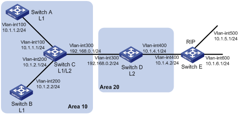

IS-IS route redistribution configuration example
As shown in Figure 10, Switch A, Switch B, Switch C, and Switch D reside in the same AS. They use IS-IS to interconnect. Switch A and Switch B are Level-1 routers, Switch D is a Level-2 router, and Switch C is a Level-1-2 router.
Redistribute RIP routes into IS-IS on Switch D.
Figure 10 Network diagram

3.        Run RIPv2 between Switch D and Switch E, and configure IS-IS to redistribute RIP routes on Switch D:
# Configure RIPv2 on Switch D.
[SwitchD] rip 1
[SwitchD-rip-1] network 10.0.0.0
[SwitchD-rip-1] version 2
[SwitchD-rip-1] undo summary
# Configure RIPv2 on Switch E.
[SwitchE] rip 1
[SwitchE-rip-1] network 10.0.0.0
[SwitchE-rip-1] version 2
[SwitchE-rip-1] undo summary
# Configure IS-IS to redistribute RIP routes on Switch D.
[SwitchD-rip-1] quit
[SwitchD] isis 1
[SwitchD–isis-1] address-family ipv4
[SwitchD–isis-1-ipv4] import-route rip level-2
# Display IS-IS routing information on Switch C.
 10.1.1.0/24          10         NULL    VLAN100         Direct          D/L/-
 10.1.2.0/24          10         NULL    VLAN200         Direct          D/L/-
 192.168.0.0/24       10         NULL    VLAN300         Direct          D/L/-
 10.1.4.0/24          20         NULL    VLAN300         192.168.0.2     R/L/-
 10.1.5.0/24          10         0       VLAN300         192.168.0.2     R/L/-
 10.1.6.0/24          10         0       VLAN300         192.168.0.2     R/L/-

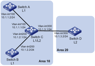

IS-IS authentication configuration example
As shown in Figure 11, Switch A, Switch B, Switch C, and Switch D reside in the same IS-IS routing domain. Run IS-IS among them.
Switch A, Switch B, and Switch C belong to Area 10, and Switch D belongs to Area 20.
·          Configure neighbor relationship authentication between neighbors.
·          Configure area authentication in Area 10 to prevent untrusted routes from entering into the area.
·          Configure routing domain authentication on Switch C and Switch D to prevent untrusted routes from entering the routing domain.
Figure 11 Network diagram
