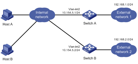

As shown in Figure 1, Host A and Host B that run Linux support IRDP, and they are in the internal network. Switch A and Switch B act as the egress routers and connect to external networks 192.168.1.0/24 and 192.168.2.0/24, respectively.
Configure Switch A as the default gateway for the hosts. Make sure Switch A has routes to reach both External network 1 and External network 2, so that packets to these external networks can be correctly routed.
Figure 1 Network diagram

# Display the routing table for Host A.
[HostA@localhost ~]$ netstat -rne
Kernel IP routing table
Destination     Gateway         Genmask         Flags Metric Ref    Use Iface
10.154.5.0      0.0.0.0         255.255.255.0   U     0      0        0 eth1
192.168.1.0     0.0.0.0         255.255.255.0   U     0      0        0 eth1
192.168.2.0     0.0.0.0         255.255.255.0   U     0      0        0 eth1
0.0.0.0          10.154.5.1     0.0.0.0          UG    0      0        0 eth1
The output shows that the default route on Host A points to IP address 10.154.5.1, and Host A has routes to 192.168.1.0/24 and 192.168.2.0/24.
# Display the routing table for Host B.
[HostB@localhost ~]$ netstat -rne
The output shows that the default route on Host B points to IP address 10.154.5.1, and Host B has routes to 192.168.1.0/24 and 192.168.2.0/24.
