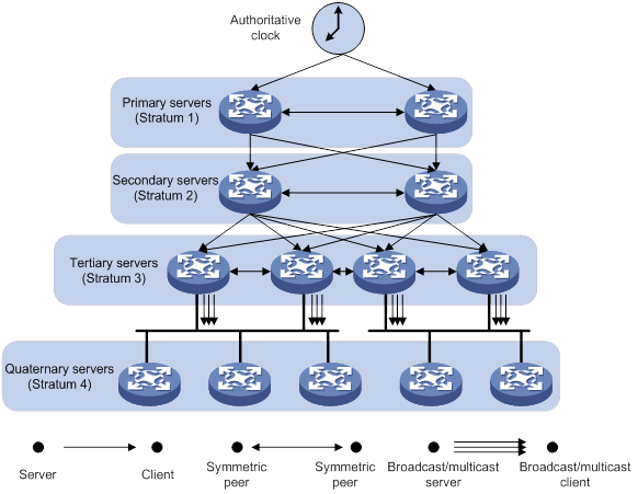

NTP architecture
NTP uses stratums 1 to 16 to define clock accuracy, as shown in Figure 2. A lower stratum value represents higher accuracy. Clocks at stratums 1 through 15 are in synchronized state, and clocks at stratum 16 are not synchronized.
Figure 2 NTP architecture
A stratum 1 NTP server gets its time from an authoritative time source, such as an atomic clock. It provides time for other devices as the primary NTP server. A stratum 2 time server receives its time from a stratum 1 time server, and so on.
To ensure time accuracy and availability, you can specify multiple NTP servers for a device. The device selects an optimal NTP server as the clock source based on parameters such as stratum. The clock that the device selects is called the reference source. For more information about clock selection, see the related protocols and standards.
If the devices in a network cannot synchronize to an authoritative time source, you can perform the following tasks:
·          Select a device that has a relatively accurate clock from the network.
·          Use the local clock of the device as the reference clock to synchronize other devices in the network.

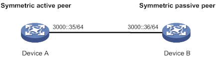

Symmetric active/passive
On the symmetric active peer, specify the IP address of the symmetric passive peer.
A symmetric active peer periodically sends clock synchronization messages to a symmetric passive peer. The symmetric passive peer automatically operates in symmetric passive mode and sends a reply.
If the symmetric active peer can be synchronized to multiple time servers, it selects an optimal clock and synchronizes its local clock to the optimal clock after receiving the replies from the servers.
A symmetric active peer and a symmetric passive peer can be synchronized to each other. If both of them are synchronized, the peer with a higher stratum is synchronized to the peer with a lower stratum.
As Figure 2 shows, this mode is most often used between servers with the same stratum to operate as a backup for one another. If a server fails to communicate with all the servers of a lower stratum, the server can still synchronize to the servers of the same stratum.

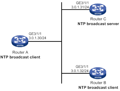

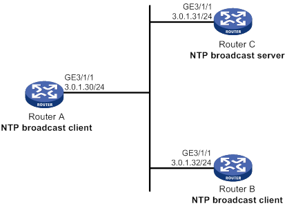

Broadcast
A server periodically sends clock synchronization messages to the broadcast address 255.255.255.255. Clients listen to the broadcast messages from the servers to synchronize to the server according to the broadcast messages.
When a client receives the first broadcast message, the client and the server start to exchange messages to calculate the network delay between them. Then, only the broadcast server sends clock synchronization messages.
A broadcast client can synchronize to a broadcast server, but a broadcast server cannot synchronize to a broadcast client.
A broadcast server sends clock synchronization messages to synchronize clients in the same subnet. As Figure 2 shows, broadcast mode is intended for configurations involving one or a few servers and a potentially large client population.
The broadcast mode has lower time accuracy than the client/server and symmetric active/passive modes because only the broadcast servers send clock synchronization messages.

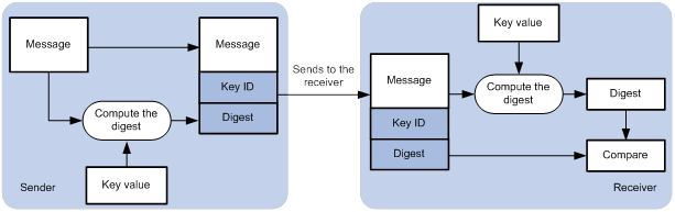

Use this feature to authenticate the NTP messages for security purposes. If an NTP message passes authentication, the device can receive it and get time synchronization information. If not, the device discards the message. This function makes sure the device does not synchronize to an unauthorized time server.
Figure 3 NTP authentication
As shown in Figure 3, NTP authentication is performed as follows:
1.        The sender uses the key identified by the key ID to calculate a digest for the NTP message through the MD5/HMAC authentication algorithm. Then it sends the calculated digest together with the NTP message and key ID to the receiver.
2.        Upon receiving the message, the receiver performs the following actions:
a.    Finds the key according to the key ID in the message.
b.    Uses the key and the MD5/HMAC authentication algorithm to calculate the digest for the message.
c.    Compares the digest with the digest contained in the NTP message.
-      If they are different, the receiver discards the message.
-      If they are the same, the local device determines whether the sender is allowed to use the authentication ID. If the sender is allowed to use the authentication ID, the receiver accepts the message. If the sender is not allowed to use the authentication ID, the receiver discards the message.

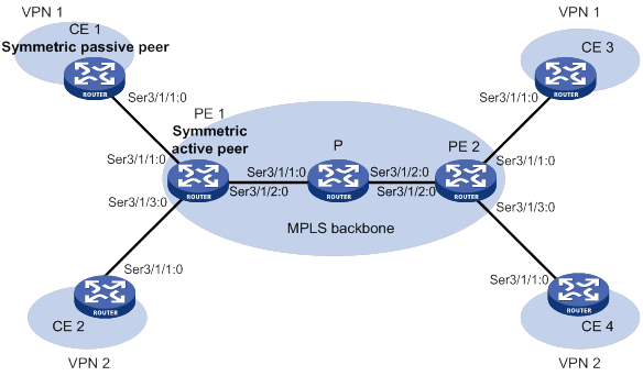

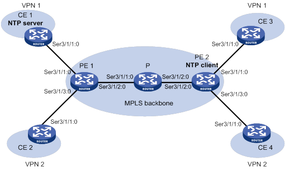

NTP for MPLS L3VPN instances
On an MPLS L3VPN network, a PE that acts as an NTP client or active peer can synchronize with the NTP server or passive peer in an MPLS L3VPN instance.
As shown in Figure 4, users in VPN 1 and VPN 2 are connected to the MPLS backbone network through provider edge (PE) devices. VPN instances vpn1 and vpn2 have been created for VPN 1 and VPN 2, respectively on the PEs. Services of the two VPN instances are isolated. Time synchronization between PEs and devices in the two VPN instances can be realized if you perform the following tasks:
·          Configure the PEs to operate in NTP client or symmetric active mode.
·          Specify the VPN instance to which the NTP server or NTP symmetric passive peer belongs.
Figure 4 Network diagram
For more information about MPLS L3VPN, VPN instance, and PE, see MPLS Configuration Guide.

Configuring NTP in symmetric active/passive mode
To configure NTP in symmetric active/passive mode, specify a symmetric passive peer for the active peer.
For a symmetric passive peer to process NTP messages from a symmetric active peer, execute the ntp-service enable command on the symmetric passive peer to enable NTP.
For time synchronization between the symmetric active peer and the symmetric passive peer, make sure either or both of them are in synchronized state.
You can specify multiple symmetric passive peers by executing the ntp-service unicast-peer or ntp-service ipv6 unicast-peer command multiple times.
1.        Enter system view.
2.        Specify a symmetric passive peer for the device.
IPv4:
ntp-service unicast-peer { peer-name | ip-address } [ vpn-instance vpn-instance-name ] [ authentication-keyid keyid | priority | source interface-type interface-number | version number ] *
IPv6:
ntp-service ipv6 unicast-peer { peer-name | ipv6-address } [ vpn-instance vpn-instance-name ] [ authentication-keyid keyid | priority | source interface-type interface-number ] *
By default, no symmetric passive peer is specified.
Configuring NTP in broadcast mode
To configure NTP in broadcast mode, you must configure an NTP broadcast client and an NTP broadcast server.
For a broadcast client to synchronize to a broadcast server, make sure the broadcast server is synchronized by other devices or uses its local clock as the reference source.
Configuring the broadcast client
2.        Enter interface view.
3.        Configure the device to operate in broadcast client mode.
ntp-service broadcast-client
By default, the device does not operate in any NTP association mode.
After you execute the command, the device receives NTP broadcast messages from the specified interface.
Configuring the broadcast server
3.        Configure the device to operate in NTP broadcast server mode.
ntp-service broadcast-server [ authentication-keyid keyid | version number ] *
After you execute the command, the device sends NTP broadcast messages from the specified interface.

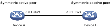

Example: Configuring NTP symmetric active/passive association mode
As shown in Figure 7, perform the following tasks:
·          Configure Device A's local clock as its reference source, with stratum level 2.
·          Configure Device A to operate in symmetric active mode and specify Device B as the passive peer of Device A.
Figure 7 Network diagram
1.        Assign an IP address to each interface, and make sure Device A and Device B can reach each other, as shown in Figure 7. (Details not shown.)
2.        Configure Device B:
# Enable the NTP service.
<DeviceB> system-view
[DeviceB] ntp-service enable
# Specify NTP for obtaining the system time.
[DeviceB] clock protocol ntp mdc 1
3.        Configure Device A:
<DeviceA> system-view
[DeviceA] ntp-service enable
[DeviceA] clock protocol ntp mdc 1
# Specify the local clock as the reference source, with stratum level 2.
[DeviceA] ntp-service refclock-master 2
# Configure Device B as its symmetric passive peer.
[DeviceA] ntp-service unicast-peer 3.0.1.32
# Verify that Device B has synchronized to Device A, and the clock stratum level of Device B is 3.
[DeviceB] display ntp-service status
 Clock status: synchronized
 Clock stratum: 3
 System peer: 3.0.1.31
 Local mode: sym_passive
 Reference clock ID: 3.0.1.31
 Leap indicator: 00
 Clock jitter: 0.000916 s
 Stability: 0.000 pps
 Clock precision: 2^-17
 Root delay: 0.00609 ms
 Root dispersion: 1.95859 ms
 Reference time: 83aec681.deb6d3e5  Wed, Jan  8 2014 14:33:11.081
# Verify that an IPv4 NTP association has been established between Device B and Device A.
[DeviceB] display ntp-service sessions
       source          reference       stra reach poll  now offset  delay disper
   [1234]3.0.1.31      127.127.1.0        2    62   64   34 0.4251 6.0882 1392.1
Notes: 1 source(master), 2 source(peer), 3 selected, 4 candidate, 5 configured.
 Total sessions: 1
Example: Configuring IPv6 NTP symmetric active/passive association mode
As shown in Figure 8, perform the following tasks:
·          Configure Device A to operate in symmetric active mode and specify Device B as the IPv6 passive peer of Device A.
Figure 8 Network diagram
1.        Assign an IP address to each interface, and make sure Device A and Device B can reach each other, as shown in Figure 8. (Details not shown.)

# Configure Device B as an IPv6 symmetric passive peer.
[DeviceA] ntp-service ipv6 unicast-peer 3000::36

Example: Configuring NTP broadcast association mode
As shown in Figure 9, configure Router C as the NTP server of multiple devices on the same network segment so that these devices synchronize the time with Router C.
·          Configure Router C's local clock as its reference source, with stratum level 2.
·          Configure Router C to operate in broadcast server mode and send broadcast messages from GigabitEthernet 3/1/1.
·          Configure Router B and Router A to operate in broadcast client mode and receive broadcast messages on GigabitEthernet 3/1/1.
Figure 9 Network diagram
1.        Assign an IP address to each interface, and make sure Router A, Router B, and Router C can reach each other, as shown in Figure 9. (Details not shown.)
2.        Configure Router C:
<RouterC> system-view
[RouterC] ntp-service enable
[RouterC] clock protocol ntp mdc 1
[RouterC] ntp-service refclock-master 2
# Configure Router C to operate in broadcast server mode and send broadcast messages from GigabitEthernet 3/1/1.
[RouterC] interface GigabitEthernet 3/1/1
[RouterC-GigabitEthernet3/1/1] ntp-service broadcast-server
3.        Configure Router A:
<RouterA> system-view
[RouterA] ntp-service enable
[RouterA] clock protocol ntp mdc 1
# Configure Router A to operate in broadcast client mode and receive broadcast messages on GigabitEthernet 3/1/1.
[RouterA] interface GigabitEthernet 3/1/1
[RouterA-GigabitEthernet3/1/1] ntp-service broadcast-client
4.        Configure Router B:
<RouterB> system-view
[RouterB] ntp-service enable
[RouterB] clock protocol ntp mdc 1
# Configure Router B to operate in broadcast client mode and receive broadcast messages on GigabitEthernet 3/1/1.
[RouterB] interface GigabitEthernet 3/1/1
[RouterB-GigabitEthernet3/1/1] ntp-service broadcast-client
The following procedure uses Router A as an example to verify the configuration.
# Verify that Router A has synchronized its time with Router C, and the clock stratum level of Router A is 3.
[RouterA-GigabitEthernet3/1/1] display ntp-service status
 Clock stratum: 3
 Local mode: bclient
 Leap indicator: 00
 Clock jitter: 0.044281 s
 Clock precision: 2^-18
 Root delay: 0.00229 ms
 Root dispersion: 4.12572 ms
 Reference time: d0d289fe.ec43c720  Sat, Jan  8 2011  7:00:14.922
# Verify that an IPv4 NTP association has been established between Router A and Router C.
[RouterA-GigabitEthernet3/1/1] display ntp-service sessions
 [1245]3.0.1.31        127.127.1.0        2     1   64  519   -0.0 0.0022 4.1257
Notes: 1 source(master),2 source(peer),3 selected,4 candidate,5 configured.
 Total sessions: 1

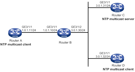

Example: Configuring NTP multicast association mode
As shown in Figure 10, configure Router C as the NTP server of multiple devices on different network segments so that these devices synchronize the time with Router C.
·          Configure Router C to operate in multicast server mode and send multicast messages from GigabitEthernet 3/1/1.
·          Configure Router D and Router A to operate in multicast client mode and receive multicast messages on GigabitEthernet 3/1/1.
Figure 10 Network diagram
1.        Assign an IP address to each interface, and make sure the routers can reach each other, as shown in Figure 10. (Details not shown.)
# Configure Router C to operate in multicast server mode and send multicast messages from GigabitEthernet 3/1/1.
[RouterC-GigabitEthernet3/1/1] ntp-service multicast-server
3.        Configure Router D:
<RouterD> system-view
[RouterD] ntp-service enable
[RouterD] clock protocol ntp mdc 1
# Configure Router D to operate in multicast client mode and receive multicast messages on GigabitEthernet 3/1/1.
[RouterD] interface GigabitEthernet 3/1/1
[RouterD-GigabitEthernet3/1/1] ntp-service multicast-client
4.        Verify the configuration:
# Verify that Router D has synchronized to Router C, and the clock stratum level of Router D is 3.
Router D and Router C are on the same subnet, so Router D can receive multicast messages from Router C without being enabled with the multicast function.
[RouterD-GigabitEthernet3/1/1] display ntp-service status
 Clock stratum: 3
 Local mode: bclient
 Leap indicator: 00
# Verify that an IPv4 NTP association has been established between Router D and Router C.
[RouterD-GigabitEthernet3/1/1] display ntp-service sessions
 Total sessions: 1
5.        Configure Router B:
Because Router A and Router C are on different subnets, you must enable the multicast functions on Router B so that Router A can receive multicast messages from Router C.
# Enable the IP multicast function.
[RouterB] multicast routing
[RouterB-mrib] quit
[RouterB-GigabitEthernet3/1/1] igmp enable
[RouterB-GigabitEthernet3/1/1] igmp static-group 224.0.1.1
[RouterB-GigabitEthernet3/1/1] quit
[RouterB] interface GigabitEthernet 3/1/2
[RouterB-GigabitEthernet3/1/2] pim dm
6.        Configure Router A:
# Configure Router A to operate in multicast client mode and receive multicast messages from GigabitEthernet 3/1/1.
[RouterA-GigabitEthernet3/1/1] ntp-service multicast-client
# Verify that Router A has synchronized to Router C, and the clock stratum level of Router A is 3.
 Clock stratum: 3
 Local mode: bclient
 Leap indicator: 00
 Clock jitter: 0.165741 s
 Root delay: 0.00534 ms
 Root dispersion: 4.51282 ms
 Reference time: d0c61289.10b1193f  Wed, Dec 29 2010 20:03:21.065
 [1234]3.0.1.31        127.127.1.0        2   247   64   381  -0.0 0.0053 4.5128
 Total sessions: 1

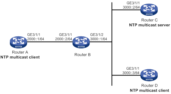

Example: Configuring IPv6 NTP multicast association mode
As shown in Figure 11, configure Router C as the NTP server of multiple devices on different network segments so that these devices synchronize the time with Router C.
·          Configure Router C to operate in IPv6 multicast server mode and send IPv6 NTP multicast messages from GigabitEthernet 3/1/1.
·          Configure Router D and Router A to operate in multicast client mode and receive IPv6 multicast messages on GigabitEthernet 3/1/1.
Figure 11 Network diagram
1.        Assign an IP address to each interface, and make sure the routers can reach each other, as shown in Figure 11. (Details not shown.)
# Configure Router C to operate in IPv6 multicast server mode and send multicast messages from GigabitEthernet 3/1/1.
[RouterC-GigabitEthernet3/1/1] ntp-service ipv6 multicast-server ff24::1
# Configure Router D to operate in IPv6 multicast client mode and receive multicast messages on GigabitEthernet 3/1/1.
[RouterD-GigabitEthernet3/1/1] ntp-service ipv6 multicast-client ff24::1
Router D and Router C are on the same subnet, so Router D can receive the IPv6 multicast messages from Router C without being enabled with the IPv6 multicast functions.
 Clock stratum: 3
 System peer: 3000::2
 Local mode: bclient
 Reference clock ID: 165.84.121.65
 Leap indicator: 00
 Clock jitter: 0.000977 s
 Root delay: 0.00000 ms
 Root dispersion: 8.00578 ms
 Reference time: d0c60680.9754fb17  Wed, Dec 29 2010 19:12:00.591
# Verify that an IPv6 NTP association has been established between Router D and Router C.
[RouterD-GigabitEthernet3/1/1] display ntp-service ipv6 sessions
 Source:  [1234]3000::2
 Reference: 127.127.1.0           Clock stratum: 2
 Reachabilities: 111              Poll interval: 64
 Last receive time: 23            Offset: -0.0
 Roundtrip delay: 0.0             Dispersion: 0.0
 Total sessions: 1
Because Router A and Router C are on different subnets, you must enable the multicast functions on Router B so that Router A can receive IPv6 multicast messages from Router C.
# Enable the IPv6 multicast function.
[RouterB] ipv6 multicast routing
[RouterB-mrib6] quit
[RouterB-GigabitEthernet3/1/1] mld enable
[RouterB-GigabitEthernet3/1/1] mld static-group ff24::1
[RouterB-GigabitEthernet3/1/2] ipv6 pim dm
# Configure Router A to operate in IPv6 multicast client mode and receive multicast messages from GigabitEthernet 3/1/1.
[RouterA-GigabitEthernet3/1/1] ntp-service ipv6 multicast-client ff24::1
[RouterA-GigabitEthernet3/1/1] display ntp status
 Clock stratum: 3
 Local mode: bclient
 Leap indicator: 00
# Verify that an IPv6 NTP association has been established between Router A and Router C.
[RouterA-GigabitEthernet3/1/1] display ntp-service ipv6 sessions
 Source:   [124]3000::2
 Reachabilities: 2                Poll interval: 64
 Last receive time: 71            Offset: -0.0
 Total sessions: 1

Example: Configuring NTP authentication in broadcast mode
As shown in Figure 13, configure Router C as the NTP server of multiple devices on the same segment so that these devices synchronize the time with Router C. Configure Router A and Router B to authenticate the NTP server.
·          Configure Router C's local clock as its reference source, with stratum level 3.
·          Configure Router A and Router B to operate in broadcast client mode and receive broadcast messages on GigabitEthernet 3/1/1.
·          Configure NTP authentication on Router A, Router B, and Router C.
Figure 13 Network diagram
1.        Assign an IP address to each interface, and make sure Router A, Router B, and Router C can reach each other, as shown in Figure 13. (Details not shown.)
2.        Configure Router A:
# Enable NTP authentication on Router A. Create a plaintext NTP authentication key, with key ID of 88 and key value of 123456. Specify it as a trusted key.
[RouterA] ntp-service authentication enable
[RouterA] ntp-service authentication-keyid 88 authentication-mode md5 simple 123456
[RouterA] ntp-service reliable authentication-keyid 88
# Configure Router A to operate in broadcast client mode and receive NTP broadcast messages from GigabitEthernet 3/1/1.
3.        Configure Router B:
# Enable NTP authentication on Router B. Create a plaintext NTP authentication key, with key ID of 88 and key value of 123456. Specify it as a trusted key.
[RouterB] ntp-service authentication enable
[RouterB] ntp-service authentication-keyid 88 authentication-mode md5 simple 123456
[RouterB] ntp-service reliable authentication-keyid 88
# Configure Router B to operate in broadcast client mode and receive NTP broadcast messages on GigabitEthernet 3/1/1.
4.        Configure Router C:
# Specify the local clock as the reference source, with stratum level 3.
[RouterC] ntp-service refclock-master 3
# Configure Router C to operate in the NTP broadcast server mode and send NTP broadcast messages from GigabitEthernet 3/1/1.
[RouterC-GigabitEthernet3/1/1] quit
5.        Verify the configuration:
NTP authentication is enabled on Router A and Router B, but not enabled on Router C, so Router A and Router B cannot synchronize their local clocks to Router C.
[RouterB-GigabitEthernet3/1/1] display ntp-service status
 Clock status: unsynchronized
 Clock stratum: 16
 Reference clock ID: none
6.        Configure NTP authentication on Router C:
# Enable NTP authentication on Router C. Create a plaintext NTP authentication key, with key ID of 88 and key value of 123456. Specify it as a trusted key.
[RouterC] ntp-service authentication enable
[RouterC] ntp-service authentication-keyid 88 authentication-mode md5 simple 123456
[RouterC] ntp-service reliable authentication-keyid 88
# Specify Router C as an NTP broadcast server, and associate key 88 with Router C.
[RouterC-GigabitEthernet3/1/1] ntp-service broadcast-server authentication-keyid 88
The following procedure uses Router B as an example to verify the configuration.
# Verify that Router B has synchronized to Router C, and the clock stratum level of Router B is 4.
 Clock stratum: 4
 Local mode: bclient
 Leap indicator: 00
 Clock jitter: 0.006683 s
 Root delay: 0.00127 ms
 Root dispersion: 2.89877 ms
 Reference time: d0d287a7.3119666f  Sat, Jan  8 2011  6:50:15.191
# Verify that an IPv4 NTP association has been established between Router B and Router C.
[RouterB-GigabitEthernet3/1/1] display ntp-service sessions
 [1245]3.0.1.31        127.127.1.0        3     3   64   68   -0.0 0.0000    0.0
 Total sessions: 1
Example: Configuring MPLS L3VPN network time synchronization in client/server mode
As shown in Figure 14, two MPLS L3VPN instances are present on PE 1 and PE 2: vpn1 and vpn2. CE 1 and CE 3 are devices in VPN 1.
To synchronize time between PE 2 and CE 1 in VPN 1, perform the following tasks:
·          Configure CE 1's local clock as its reference source, with stratum level 2.
·          Configure CE 1 in the VPN instance vpn1 as the NTP server of PE 2.
Figure 14 Network diagram
Device
Interface
IP address
Device
Interface
IP address
CE 1
Ser3/1/1:0
10.1.1.1/24
PE 1
Ser3/1/1:0
10.1.1.2/24
CE 2
Ser3/1/1:0
10.2.1.1/24
Ser3/1/2:0
172.1.1.1/24
CE 3
Ser3/1/1:0
10.3.1.1/24
Ser3/1/3:0
10.2.1.2/24
CE 4
Ser3/1/1:0
10.4.1.1/24
PE 2
Ser3/1/1:0
10.3.1.2/24
P
Ser3/1/1:0
172.1.1.2/24
Ser3/1/2:0
172.2.1.2/24
Ser3/1/2:0
172.2.1.1/24
Ser3/1/3:0
10.4.1.2/24
Before you perform the following configuration, be sure you have completed MPLS L3VPN-related configurations. For information about configuring MPLS L3VPN, see MPLS Configuration Guide.
1.        Assign an IP address to each interface, as shown in Figure 14. Make sure CE 1 and PE 1, PE 1 and PE 2, and PE 2 and CE 3 can reach each other. (Details not shown.)
2.        Configure CE 1:
<CE1> system-view
[CE1] ntp-service enable
[CE1] clock protocol ntp mdc 1
[CE1] ntp-service refclock-master 2
3.        Configure PE 2:
<PE2> system-view
[PE2] ntp-service enable
[PE2] clock protocol ntp mdc 1
# Specify CE 1 in the VPN instance vpn1 as the NTP server of PE 2.
[PE2] ntp-service unicast-server 10.1.1.1 vpn-instance vpn1
# Verify that PE 2 has synchronized to CE 1, with stratum level 3.
[PE2] display ntp-service status
 Clock stratum: 3
 System peer: 10.1.1.1
 Local mode: client
 Reference clock ID: 10.1.1.1
 Leap indicator: 00
 Clock jitter: 0.005096 s
 Root delay: 0.00655 ms
 Root dispersion: 1.15869 ms
 Reference time: d0c62687.ab1bba7d  Wed, Dec 29 2010 21:28:39.668
# Verify that an IPv4 NTP association has been established between PE 2 and CE 1.
[PE2] display ntp-service sessions
 [1245]10.1.1.1        127.127.1.0        2     1   64  519   -0.0 0.0065    0.0
 Total sessions: 1
# Verify that server 127.0.0.1 has synchronized to server 10.1.1.1, and server 10.1.1.1 has synchronized to the local clock.
[PE2] display ntp-service trace
Server     127.0.0.1
Stratum    3 , jitter  0.000, synch distance 796.50.
Server     10.1.1.1
Stratum    2 , jitter 939.00, synch distance 0.0000.
RefID      127.127.1.0
Example: Configuring MPLS L3VPN network time synchronization in symmetric active/passive mode
As shown in Figure 15, two VPN instances are present on PE 1 and PE 2: vpn1 and vpn2. CE 1 and CE 3 belong to VPN 1.
To synchronize time between PE 1 and CE 1 in VPN 1, perform the following tasks:
·          Configure CE 1 in the VPN instance vpn1 as the symmetric passive peer of PE 1.
Figure 15 Network diagram
Device
Interface
IP address
Device
Interface
IP address
CE 1
Ser3/1/1:0
10.1.1.1/24
PE 1
Ser3/1/1:0
10.1.1.2/24
CE 2
Ser3/1/1:0
10.2.1.1/24
Ser3/1/2:0
172.1.1.1/24
CE 3
Ser3/1/1:0
10.3.1.1/24
Ser3/1/3:0
10.2.1.2/24
CE 4
Ser3/1/1:0
10.4.1.1/24
PE 2
Ser3/1/1:0
10.3.1.2/24
P
Ser3/1/1:0
172.1.1.2/24
Ser3/1/2:0
172.2.1.2/24
Ser3/1/2:0
172.2.1.1/24
Ser3/1/3:0
10.4.1.2/24
1.        Assign an IP address to each interface, as shown in Figure 15. Make sure CE 1 and PE 1, PE 1 and PE 2, PE 2 and CE 3 can reach each other. (Details not shown.)
2.        Configure CE 1:
<CE1> system-view
3.        Configure PE 1:
<PE1> system-view
[PE1] ntp-service enable
[PE1] clock protocol ntp mdc 1
# Specify CE 1 in the vpn instance vpn1 as the symmetric passive peer of PE 1.
[PE1] ntp-service unicast-peer 10.1.1.1 vpn-instance vpn1
# Verify that PE 1 has synchronized to CE 1, with stratum level 3.
[PE1] display ntp-service status
 Clock stratum: 3
 Local mode: sym_active
 Leap indicator: 00
# Verify that an IPv4 NTP association has been established between PE 1 and CE 1.
[PE1] display ntp-service sessions
 [1245]10.1.1.1        127.127.1.0        2     1   64  519   -0.0 0.0000    0.0
 Total sessions: 1
[PE1] display ntp-service trace
Server     127.0.0.1
Server     10.1.1.1
RefID      127.127.1.0
