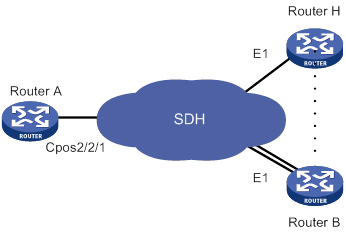

CPOS E1 interfaces are typically used to aggregate E1 lines, as shown in Figure 1.

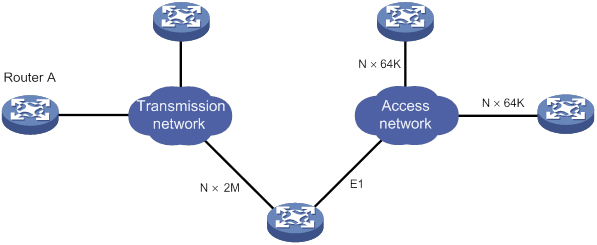

In actual applications, the connection between low-end devices and the CPOS interfaces might span more than one transmission network and might require relay.
Figure 1 CPOS E1 interface application scenario

CPOS interface configuration examples
Example: Configuring CPOS-E1 channels
As shown in Figure 2, branch nodes Router B through Router H are uplinked to the central node Router A through E1 links. Router A aggregates these E1 links by using a CPOS interface.
Add one additional E1 link on Router B to expand its capacity, and use an MP-group interface to bind the two E1 links.
Figure 2 Network diagram
IMPORTANT
IMPORTANT:
For correct network synchronization, make sure the master clock mode is configured on the SONET/SDH devices connected to the routers.
1.        Configure Router A:
# Configure E1 channels 1 and 2 of CPOS 2/2/1 to operate in unframed mode.
<RouterA> system-view
[RouterA] controller cpos 2/2/1
[RouterA-Cpos2/2/1] e1 1 unframed
[RouterA-Cpos2/2/1] e1 2 unframed
# Create MP-group 1 and assign an IP address to it.
[RouterA] interface mp-group 3/1/1
[RouterA-Mp-group3/1/1] ip address 10.1.1.1 24
[RouterA-Mp-group3/1/1] quit
# Assign Serial 2/2/1/1:0 to MP-group 3/1/1.
[RouterA] interface serial2/2/1/1:0
[RouterA-Serial2/2/1/1:0] ppp mp mp-group 3/1/1
[RouterA-Serial2/2/1/1:0] quit
# Assign Serial 2/2/1/2:0 to MP-group 3/1/1.
[RouterA] interface serial2/2/1/2:0
[RouterA-Serial2/2/1/2:0] ppp mp mp-group 3/1/1
[RouterA-Serial2/2/1/2:0] quit
2.        Configure Router B:
# Configure E1 2/4/1 to operate in E1 mode.
<RouterB> system-view
[RouterB] controller e1 2/4/1
[RouterB-E1 2/4/1] using e1
[RouterB-E1 2/4/1] quit
# Configure E1 2/4/2 to operate in E1 mode.
[RouterB] controller e1 2/4/2
[RouterB-E1 2/4/2] using e1
[RouterB-E1 2/4/2] quit
# Create MP-group 3/1/1 and assign an IP address to it.
[RouterB] interface mp-group 3/1/1
[RouterB-Mp-group3/1/1] ip address 10.1.1.2 24
[RouterB-Mp-group3/1/1] quit
# Assign Serial 3/2/1/1:0 to MP-group 3/1/1.
[RouterB] interface serial3/2/1/1:0
[RouterB-Serial3/2/1/1:0] ppp mp mp-group 3/1/1
[RouterB-Serial3/2/1/1:0] quit
# Assign Serial 3/2/1/2:0 to MP-group 3/1/1.
[RouterB] interface serial3/2/1/2:0
[RouterB-Serial3/2/1/2:0] ppp mp mp-group 3/1/1
[RouterB-Serial3/2/1/2:0] quit
# Verify the serial interface configuration and state, for example, on Router B.
<RouterB> display interface serial 3/2/1/1:0
# Verify the MP interface, and MP bundle configuration and state, for example, on Router B.
<RouterB> display interface mp-group 3/1/1
<RouterB> display interface display ppp mp
# Verify that the routers can ping one another. (Details not shown.)
