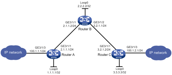

Example: Configuring a static CRLSP
Router A, Router B, and Router C run IS-IS.
Establish an MPLS TE tunnel over a static CRLSP from Router A to Router C to transmit data between the two IP networks. The required bandwidth for the tunnel is 2000 kbps.
The maximum bandwidth for MPLS TE traffic is 10000 kbps, and the maximum reservable bandwidth is 5000 kbps.
Figure 1 Network diagram
1.        Configure IP addresses and masks for interfaces. (Details not shown.)
2.        Configure IS-IS to advertise interface addresses, including the loopback interface address:
# Configure Router A.
<RouterA> system-view
[RouterA] isis 1
[RouterA-isis-1] network-entity 00.0005.0000.0000.0001.00
[RouterA-isis-1] quit
[RouterA] interface gigabitethernet 3/1/1
[RouterA-GigabitEthernet3/1/1] isis enable 1
[RouterA-GigabitEthernet3/1/1] quit
[RouterA] interface loopback 0
[RouterA-LoopBack0] isis enable 1
[RouterA-LoopBack0] quit
# Configure Router B.
<RouterB> system-view
[RouterB] isis 1
[RouterB-isis-1] network-entity 00.0005.0000.0000.0002.00
[RouterB-isis-1] quit
[RouterB] interface gigabitethernet 3/1/1
[RouterB-GigabitEthernet3/1/1] isis enable 1
[RouterB-GigabitEthernet3/1/1] quit
[RouterB] interface gigabitethernet 3/1/2
[RouterB-GigabitEthernet3/1/2] isis enable 1
[RouterB-GigabitEthernet3/1/2] quit
[RouterB] interface loopback 0
[RouterB-LoopBack0] isis enable 1
[RouterB-LoopBack0] quit
# Configure Router C.
<RouterC> system-view
[RouterC] isis 1
[RouterC-isis-1] network-entity 00.0005.0000.0000.0003.00
[RouterC-isis-1] quit
[RouterC] interface gigabitethernet 3/1/1
[RouterC-GigabitEthernet3/1/1] isis enable 1
[RouterC-GigabitEthernet3/1/1] quit
[RouterC] interface loopback 0
[RouterC-LoopBack0] isis enable 1
[RouterC-LoopBack0] quit
# Execute the display ip routing-table command on each router to verify that the routers have learned the routes to one another, including the routes to the loopback interfaces. (Details not shown.)
3.        Configure an LSR ID, and enable MPLS and MPLS TE:
[RouterA] mpls lsr-id 1.1.1.1
[RouterA] mpls te
[RouterA-te] quit
[RouterA-GigabitEthernet3/1/1] mpls enable
[RouterA-GigabitEthernet3/1/1] mpls te enable
[RouterB] mpls lsr-id 2.2.2.2
[RouterB] mpls te
[RouterB-te] quit
[RouterB-GigabitEthernet3/1/1] mpls enable
[RouterB-GigabitEthernet3/1/1] mpls te enable
[RouterB-GigabitEthernet3/1/2] mpls enable
[RouterB-GigabitEthernet3/1/2] mpls te enable
[RouterC] mpls lsr-id 3.3.3.3
[RouterC] mpls te
[RouterC-te] quit
[RouterC-GigabitEthernet3/1/1] mpls enable
[RouterC-GigabitEthernet3/1/1] mpls te enable
4.        Configure MPLS TE attributes:
# On Router A, set the maximum bandwidth and the maximum reservable bandwidth.
[RouterA-GigabitEthernet3/1/1] mpls te max-link-bandwidth 10000
[RouterA-GigabitEthernet3/1/1] mpls te max-reservable-bandwidth 5000
# On Router B, set the maximum bandwidth and the maximum reservable bandwidth.
[RouterB-GigabitEthernet3/1/1] mpls te max-link-bandwidth 10000
[RouterB-GigabitEthernet3/1/1] mpls te max-reservable-bandwidth 5000
[RouterB-GigabitEthernet3/1/2] mpls te max-link-bandwidth 10000
[RouterB-GigabitEthernet3/1/2] mpls te max-reservable-bandwidth 5000
# On Router C, set the maximum bandwidth and the maximum reservable bandwidth.
[RouterC-GigabitEthernet3/1/1] mpls te max-link-bandwidth 10000
[RouterC-GigabitEthernet3/1/1] mpls te max-reservable-bandwidth 5000
5.        Configure an MPLS TE tunnel on Router A:
# Configure the MPLS TE tunnel interface Tunnel 0.
[RouterA] interface tunnel 0 mode mpls-te
[RouterA-Tunnel0] ip address 6.1.1.1 255.255.255.0
# Specify the tunnel destination address as the LSR ID of Router C.
[RouterA-Tunnel0] destination 3.3.3.3
# Configure MPLS TE to use a static CRLSP to establish the tunnel.
[RouterA-Tunnel0] mpls te signaling static
[RouterA-Tunnel0] quit
6.        Create a static CRLSP:
# Configure Router A as the ingress node of the static CRLSP, and specify the next hop address as 2.1.1.2, outgoing label as 20, and required bandwidth as 2000 kbps.
[RouterA] static-cr-lsp ingress static-cr-lsp-1 nexthop 2.1.1.2 out-label 20 bandwidth 2000
# On Router A, configure tunnel 0 to use the static CRLSP static-cr-lsp-1.
[RouterA-Tunnel0] mpls te static-cr-lsp static-cr-lsp-1
# Configure Router B as the transit node of the static CRLSP, and specify the incoming label as 20, next hop address as 3.2.1.2, outgoing label as 30, and required bandwidth as 2000 kbps.
[RouterB] static-cr-lsp transit static-cr-lsp-1 in-label 20 nexthop 3.2.1.2 out-label 30 bandwidth 2000
# Configure Router C as the egress node of the static CRLSP, and specify the incoming label as 30.
[RouterC] static-cr-lsp egress static-cr-lsp-1 in-label 30

  Collected Bandwidth  : -               Service-Class        :
# Display static CRLSP information on each router.
[RouterA] display mpls lsp
FEC                         Proto    In/Out Label    Out Inter/NHLFE/LSINDEX
1.1.1.1/0/1                 StaticCR -/20            GE3/1/1
2.1.1.2                     Local    -/-             GE3/1/1
[RouterB] display mpls lsp
-                           StaticCR 20/30           GE3/1/2
3.2.1.2                     Local    -/-             GE3/1/2
[RouterC] display mpls lsp
-                           StaticCR 30/-            -
[RouterA] display mpls static-cr-lsp
Name            LSR Type    In/Out Label   Out Interface        State
static-cr-lsp-1 Ingress     Null/20        GE3/1/1              Up
[RouterB] display mpls static-cr-lsp
static-cr-lsp-1 Transit     20/30          GE3/1/2              Up
[RouterC] display mpls static-cr-lsp
static-cr-lsp-1 Egress      30/Null        -                    Up
# Verify that Router A has a static route entry with interface Tunnel 0 as the output interface.
[RouterA] display ip routing-table
Destinations : 12        Routes : 12
Destination/Mask   Proto   Pre Cost        NextHop         Interface
0.0.0.0/32         Direct  0   0           127.0.0.1       InLoop0
1.1.1.1/32         Direct  0   0           127.0.0.1       InLoop0
2.1.1.0/24         Direct  0   0           2.1.1.1         GE3/1/1
2.1.1.0/32         Direct  0   0           2.1.1.1         GE3/1/1
2.1.1.1/32         Direct  0   0           127.0.0.1       InLoop0
2.1.1.255/32       Direct  0   0           2.1.1.1         GE3/1/1
2.2.2.2/32         IS_L1   15  10          2.1.1.2         GE3/1/1
100.1.2.0/24       Static  1   0           0.0.0.0         Tun0
3.3.3.3/32         IS_L1   15  20          2.1.1.2         GE3/1/1
6.1.1.0/24         Direct  0   0           6.1.1.1         Tun0
6.1.1.0/32         Direct  0   0           6.1.1.1         Tun0
6.1.1.1/32         Direct  0   0           127.0.0.1       InLoop0
6.1.1.255/32       Direct  0   0           6.1.1.1         Tun0
