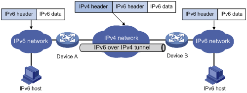

IPv6 over IPv4 tunneling enables isolated IPv6 networks to communicate, as shown in Figure 1.
The devices at both ends of an IPv6 over IPv4 tunnel must support the IPv4/IPv6 dual stack.
Figure 1 IPv6 over IPv4 tunnel
The IPv6 over IPv4 tunnel processes packets by using the following steps:
1.        A host in the IPv6 network sends an IPv6 packet to Device A at the tunnel source.
2.        After Device A receives the IPv6 packet, it processes the packet as follows:
a.    Searches the routing table to identify the outgoing interface for the IPv6 packet.
The outgoing interface is the tunnel interface, so Device A knows that the packet needs to be forwarded through the tunnel.
b.    Adds an IPv4 header to the IPv6 packet and forwards the packet through the physical interface of the tunnel.
In the IPv4 header, the source IPv4 address is the IPv4 address of the tunnel source, and the destination IPv4 address is the IPv4 address of the tunnel destination.
3.        Upon receiving the packet, Device B de-encapsulates the packet.
4.        If the destination address of the IPv6 packet is itself, Device B forwards it to the upper-layer protocol. If it is not, Device B forwards it according to the routing table.

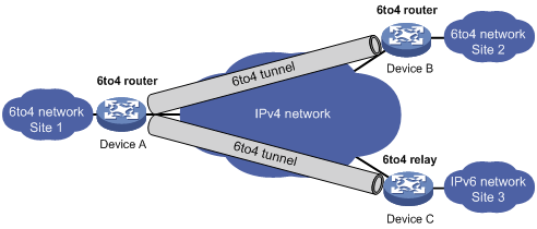

6to4 relay
6to4 relay connects a 6to4 network and an IPv6 network that uses an IP prefix other than 2002::/16. A 6to4 relay router is a gateway that forwards packets from a 6to4 network to an IPv6 network.
As shown in Figure 2, 6to4 network Site 1 communicates with IPv6 network Site 3 over a 6to4 tunnel. Configure a static route on the border router (Device A) in the 6to4 network. The next hop address must be the 6to4 address of the 6to4 relay router (Device C). Device A forwards all packets destined for the IPv6 network over the 6to4 tunnel, and Device C then forwards them to the IPv6 network.
Figure 2 Principle of 6to4 tunneling and 6to4 relay

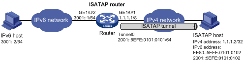

ISATAP tunneling
An ISATAP tunnel is a point-to-multipoint automatic tunnel. It provides a solution to connect an IPv6 host and an IPv6 network over an IPv4 network. ISATAP tunnels are mainly used for communication between IPv6 routers or between an IPv6 host and an IPv6 router over an IPv4 network.
Figure 3 Principle of ISATAP tunneling

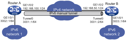

Example: Configuring an IPv6 over IPv4 manual tunnel
As shown in Figure 4, configure an IPv6 over IPv4 tunnel between Router A and Router B so the two IPv6 networks can reach each other over the IPv4 network. Because the tunnel destination IPv4 address cannot be automatically obtained from the destination IPv6 addresses, configure an IPv6 over IPv4 manual tunnel.
Figure 4 Network diagram
Make sure Router A and Router B can reach each other through IPv4.
·          Configure Router A:
# Specify an IPv4 address for GigabitEthernet 3/1/2.
<RouterA> system-view
[RouterA] interface gigabitethernet 3/1/2
[RouterA-GigabitEthernet3/1/2] ip address 192.168.100.1 255.255.255.0
[RouterA-GigabitEthernet3/1/2] quit
# Specify an IPv6 address for GigabitEthernet 3/1/1.
[RouterA] interface gigabitethernet 3/1/1
[RouterA-GigabitEthernet3/1/1] ipv6 address 3002::1 64
[RouterA-GigabitEthernet3/1/1] quit
# Create IPv6 over IPv4 manual tunnel interface Tunnel 0.
[RouterA] interface tunnel 0 mode ipv6-ipv4
# Specify an IPv6 address for the tunnel interface.
[RouterA-Tunnel0] ipv6 address 3001::1/64
# Specify GigabitEthernet 3/1/2 as the source interface of the tunnel interface.
[RouterA-Tunnel0] source gigabitethernet 3/1/2
# Specify the destination address for the tunnel interface as the IP address of GigabitEthernet 3/1/2 on Router B.
[RouterA-Tunnel0] destination 192.168.50.1
[RouterA-Tunnel0] quit
# Configure a static route destined for IPv6 network 2 through Tunnel 0.
[RouterA] ipv6 route-static 3003:: 64 tunnel 0
·          Configure Router B:
<RouterB> system-view
[RouterB] interface gigabitethernet 3/1/2
[RouterB-GigabitEthernet3/1/2] ip address 192.168.50.1 255.255.255.0
[RouterB-GigabitEthernet3/1/2] quit
[RouterB] interface gigabitethernet 3/1/1
[RouterB-GigabitEthernet3/1/1] ipv6 address 3003::1 64
[RouterB-GigabitEthernet3/1/1] quit
[RouterB] interface tunnel 0 mode ipv6-ipv4
[RouterB-Tunnel0] ipv6 address 3001::2/64
[RouterB-Tunnel0] source gigabitethernet 3/1/2
# Specify the destination address for the tunnel interface as the IP address of GigabitEthernet 3/1/2 on Router A.
[RouterB-Tunnel0] destination 192.168.50.1
[RouterB-Tunnel0] quit
# Configure a static route destined for IPv6 network 1 through Tunnel 0.
[RouterB] ipv6 route-static 3002:: 64 tunnel 0
# Use the display ipv6 interface command to display tunnel interface status on Router A and Router B. Verify that the interface tunnel 0 is up. (Details not shown.)
# Verify that Router B and Router A can ping the IPv6 address of GigabitEthernet 3/1/1 of each other. This example uses Router A.
[RouterA] ping ipv6 3003::1
Ping6(56 data bytes) 3001::1 --> 3003::1, press CTRL C to break
56 bytes from 3003::1, icmp_seq=0 hlim=64 time=45.000 ms
56 bytes from 3003::1, icmp_seq=1 hlim=64 time=10.000 ms
56 bytes from 3003::1, icmp_seq=2 hlim=64 time=4.000 ms
56 bytes from 3003::1, icmp_seq=3 hlim=64 time=10.000 ms
56 bytes from 3003::1, icmp_seq=4 hlim=64 time=11.000 ms
--- Ping6 statistics for 3003::1 ---
round-trip min/avg/max/std-dev = 4.000/16.000/45.000/14.711 ms

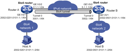

Example: Configuring a 6to4 tunnel
As shown in Figure 5, configure a 6to4 tunnel between 6to4 routers Router A and Router B so the two hosts can reach each other over the IPv4 network.
Figure 5 Network diagram
Requirements analysis
To enable communication between 6to4 networks, configure 6to4 addresses for 6to4 routers and hosts in the 6to4 networks.
·          The IPv4 address of GigabitEthernet 3/1/2 on Router A is 2.1.1.1/24, and the corresponding 6to4 prefix is 2002:0201:0101::/48. Host A must use this prefix.
·          The IPv4 address of GigabitEthernet 3/1/2 on Router B is 5.1.1.1/24, and the corresponding 6to4 prefix is 2002:0501:0101::/48. Host B must use this prefix.
[RouterA-GigabitEthernet3/1/2] ip address 2.1.1.1 24
# Specify a 6to4 address for GigabitEthernet 3/1/1.
[RouterA-GigabitEthernet3/1/1] ipv6 address 2002:0201:0101:1::1/64
# Create 6to4 tunnel interface Tunnel 0.
[RouterB] interface tunnel 0 mode ipv6-ipv4 6to4
# Specify the source interface as GigabitEthernet 3/1/2 for the tunnel interface.
# Configure a static route destined for 2002::/16 through the tunnel interface.
[RouterA] ipv6 route-static 2002:: 16 tunnel 0
[RouterB-GigabitEthernet3/1/2] ip address 5.1.1.1 24
[RouterB-GigabitEthernet3/1/1] ipv6 address 2002:0501:0101:1::1/64
[RouterB-Tunnel0] ipv6 address 3002::1/64
[RouterB] ipv6 route-static 2002:: 16 tunnel 0
# Verify that Host A and Host B can ping each other.
D:\>ping6 -s 2002:201:101:1::2 2002:501:101:1::2
Pinging 2002:501:101:1::2
from 2002:201:101:1::2 with 32 bytes of data:
Reply from 2002:501:101:1::2: bytes=32 time=13ms
Reply from 2002:501:101:1::2: bytes=32 time=1ms
Reply from 2002:501:101:1::2: bytes=32 time<1ms
Ping statistics for 2002:501:101:1::2:
    Minimum = 0ms, Maximum = 13ms, Average = 3ms

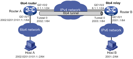

Example: Configuring 6to4 relay
As shown in Figure 6, Router A is a 6to4 router, and 6to4 addresses are used on the connected IPv6 network. Router B acts as a 6to4 relay router and is connected to an IPv6 network (2001::/16). Configure a 6to4 tunnel between Router A and Router B to make Host A and Host B reachable to each other.
The configuration on a 6to4 relay router is similar to that on a 6to4 router. However, to enable communication between the 6to4 network and the IPv6 network, you must configure a route to the IPv6 network on the 6to4 router. The IPv4 address of GigabitEthernet 3/1/2 on the relay router is 6.1.1.1/24 and its corresponding 6to4 prefix is 2002:0601:0101::/48. The next hop of the static route must be an address using this prefix.
Figure 6 Network diagram
[RouterA-GigabitEthernet3/1/2] ip address 2.1.1.1 255.255.255.0
[RouterA] interface tunnel 0 mode ipv6-ipv4 6to4
[RouterA-Tunnel0] ipv6 address 2002::1/64
# Configure a static route to the 6to4 relay router.
[RouterA] ipv6 route-static 2002:0601:0101:: 64 tunnel 0
# Configure a default route to reach the IPv6 network, which specifies the next hop as the 6to4 address of the relay router.
[RouterA] ipv6 route-static :: 0 2002:0601:0101::1
[RouterB-GigabitEthernet3/1/2] ip address 6.1.1.1 255.255.255.0
[RouterB-GigabitEthernet3/1/1] ipv6 address 2001::1/16
[RouterB-Tunnel0] ipv6 address 2003::1/64
D:\>ping6 -s 2002:201:101:1::2 2001::2
Pinging 2001::2
Reply from 2001::2: bytes=32 time=13ms
Reply from 2001::2: bytes=32 time=1ms
Reply from 2001::2: bytes=32 time<1ms
Ping statistics for 2001::2:

As shown in Figure 7, configure an ISATAP tunnel between the router and the ISATAP host so the ISATAP host in the IPv4 network can access the IPv6 network.
Figure 7 Network diagram
·          Configure the router:
# Specify an IPv6 address for GigabitEthernet 3/1/2.
<Router> system-view
[Router] interface gigabitethernet 3/1/2
[Router-GigabitEthernet3/1/2] ipv6 address 3001::1/64
[Router-GigabitEthernet3/1/2] quit
# Specify an IPv4 address for GigabitEthernet 3/1/1.
[Router] interface gigabitethernet 3/1/1
[Router-GigabitEthernet3/1/1] ip address 1.1.1.1 255.0.0.0
[Router-GigabitEthernet3/1/1] quit
# Create ISATAP tunnel interface Tunnel 0.
[Router] interface tunnel 0 mode ipv6-ipv4 isatap
# Specify an EUI-64 IPv6 address for the tunnel interface.
[Router-Tunnel0] ipv6 address 2001:: 64 eui-64
# Specify GigabitEthernet 3/1/1 as the source interface of the tunnel interface.
[Router-Tunnel0] source gigabitethernet 3/1/1
# Disable RA suppression so that the ISATAP host can acquire information such as the address prefix from the RA message advertised by the ISATAP router.
[Router-Tunnel0] undo ipv6 nd ra halt
[Router-Tunnel0] quit
·          Configure the ISATAP host:
Configurations on the ISATAP host vary by operating system. The following configuration is performed on Windows XP.
# Install IPv6.
C:\>ipv6 install
# On a host running Windows XP, the ISATAP interface is typically interface 2. Display information about the ISATAP interface.
C:\>ipv6 if 2
Interface 2: Automatic Tunneling Pseudo-Interface
  Guid {48FCE3FC-EC30-E50E-F1A7-71172AEEE3AE}
  does not use Neighbor Discovery
  does not use Router Discovery
  routing preference 1
  EUI-64 embedded IPv4 address: 0.0.0.0
  router link-layer address: 0.0.0.0
  preferred link-local fe80::5efe:1.1.1.2, life infinite
  link MTU 1280 (true link MTU 65515)
  current hop limit 128
  reachable time 42500ms (base 30000ms)
  retransmission interval 1000ms
  DAD transmits 0
  default site prefix length 48
# Specify an IPv4 address for the ISATAP router.
C:\>netsh interface ipv6 isatap set router 1.1.1.1
# Display information about the ISATAP interface.
C:\>ipv6 if 2
  uses Router Discovery
  EUI-64 embedded IPv4 address: 1.1.1.2
  router link-layer address: 1.1.1.1
  preferred global 2001::5efe:1.1.1.2, life 29d23h59m46s/6d23h59m46s (public)
  link MTU 1500 (true link MTU 65515)
  current hop limit 255
  DAD transmits 0
The host has obtained the prefix 2001::/64 and has automatically generated the global unicast address 2001::5efe:1.1.1.2. The message "uses Router Discovery" indicates that the router discovery feature is enabled on the host.
# Display information about IPv6 routes on the host.
C:\>ipv6 rt
2001::/64 -> 2 pref 1if+8=9 life 29d23h59m43s (autoconf)
::/0 -> 2/fe80::5efe:1.1.1.1 pref 1if+256=257 life 29m43s (autoconf)
·          On the IPv6 host, configure a route to the ISATAP router.
C:\>netsh interface ipv6 set route 2001::/64 5 3001::1
# Verify that the ISATAP host can ping the IPv6 host.
C:\>ping 3001::2
Pinging 3001::2 with 32 bytes of data:
Reply from 3001::2: time=1ms
Ping statistics for 3001::2:

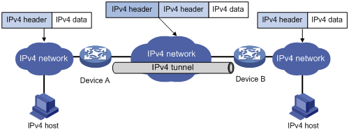

IPv4 over IPv4 tunneling
About IPv4 over IPv4 tunneling
IPv4 over IPv4 tunneling (RFC 1853) enables isolated IPv4 networks to communicate. For example, an IPv4 over IPv4 tunnel can connect isolated private IPv4 networks over a public IPv4 network.
Figure 8 IPv4 over IPv4 tunnel
Figure 8 shows the encapsulation and de-encapsulation processes.
·          Encapsulation:
a.    Device A receives an IP packet from an IPv4 host and submits it to the IP protocol stack.
b.    The IPv4 protocol stack determines how to forward the packet according to the destination address in the IP header. If the packet is destined for the IPv4 host connected to Device B, Device A delivers the packet to the tunnel interface.
c.    The tunnel interface adds a new IPv4 header to the IPv4 packet and submits it to the IP protocol stack.
In the new header, the source IP address specifies the tunnel source, and the destination IP address specifies the tunnel destination.
d.    The IP protocol stack uses the destination IP address of the new IP header to look up the routing table, and then sends the packet out.
·          De-encapsulation:
a.    After receiving the packet, Device B delivers it to the IP protocol stack.
b.    If the protocol number is 4 (indicating an IPv4 packet is encapsulated within the packet), the IP protocol stack delivers the packet to the tunnel module for de-encapsulation.
c.    The tunnel module de-encapsulates the IP packet and sends it back to the IP protocol stack.
d.    The protocol stack forwards the de-encapsulated packet.

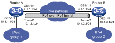

As shown in Figure 9, the two subnets IPv4 group 1 and IPv4 group 2 use private IPv4 addresses. Configure an IPv4 over IPv4 tunnel between Router A and Router B to make the two subnets reachable to each other.
Figure 9 Network diagram
[RouterA-GigabitEthernet3/1/1] ip address 10.1.1.1 255.255.255.0
# Specify an IPv4 address for GigabitEthernet 4/1/1, which is the physical interface of the tunnel.
[RouterA] interface gigabitethernet 4/1/1
[RouterA-GigabitEthernet4/1/1] ip address 2.1.1.1 255.255.255.0
[RouterA-GigabitEthernet4/1/1] quit
# Create IPv4 over IPv4 tunnel interface Tunnel 1.
[RouterA] interface tunnel 1 mode ipv4-ipv4
# Specify an IPv4 address for the tunnel interface.
[RouterA-Tunnel1] ip address 10.1.2.1 255.255.255.0
# Specify the IP address of GigabitEthernet 4/1/1 as the source address for the tunnel interface.
[RouterA-Tunnel1] source 2.1.1.1
# Specify the IP address of GigabitEthernet 4/1/1 on Router B as the destination address for the tunnel interface.
[RouterA-Tunnel1] destination 3.1.1.1
[RouterA-Tunnel1] quit
# Configure a static route destined for IPv4 group 2 through the tunnel interface.
[RouterA] ip route-static 10.1.3.0 255.255.255.0 tunnel 1
[RouterB-GigabitEthernet3/1/1] ip address 10.1.3.1 255.255.255.0
[RouterB] interface gigabitethernet 4/1/1
[RouterB-GigabitEthernet4/1/1] ip address 3.1.1.1 255.255.255.0
[RouterB-GigabitEthernet4/1/1] quit
# Create IPv4 over IPv4 tunnel interface Tunnel 2.
[RouterB] interface tunnel 2 mode ipv4-ipv4
[RouterB-Tunnel2] ip address 10.1.2.2 255.255.255.0
[RouterB-Tunnel2] source 3.1.1.1
# Specify the IP address of GigabitEthernet 4/1/1 on Router A as a destination address for the tunnel interface.
[RouterB-Tunnel2] destination 2.1.1.1
[RouterB-Tunnel2] quit
# Configure a static route destined for IPv4 group 1 through the tunnel interface.
[RouterB] ip route-static 10.1.1.0 255.255.255.0 tunnel 2
# Use the display interface tunnel command to display the status of the tunnel interfaces on Router A and Router B. Verify that the tunnel interfaces are up. (Details not shown.)
# Verify that Router A and Router B can ping the IPv4 address of the peer interface GigabitEthernet 3/1/1. This example uses Router A.
[RouterA] ping -a 10.1.1.1 10.1.3.1
Ping 10.1.3.1 (10.1.3.1) from 10.1.1.1: 56 data bytes, press CTRL_C to break
56 bytes from 10.1.3.1: icmp_seq=0 ttl=255 time=2.000 ms
56 bytes from 10.1.3.1: icmp_seq=1 ttl=255 time=1.000 ms
56 bytes from 10.1.3.1: icmp_seq=2 ttl=255 time=0.000 ms
56 bytes from 10.1.3.1: icmp_seq=3 ttl=255 time=1.000 ms
56 bytes from 10.1.3.1: icmp_seq=4 ttl=255 time=1.000 ms
--- Ping statistics for 10.1.3.1 ---
round-trip min/avg/max/std-dev = 0.000/1.000/2.000/0.632 ms

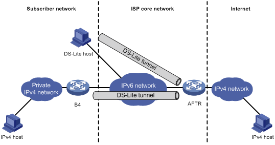

Dual Stack Lite (DS-Lite) is a combination of the tunneling and NAT technologies. NAT translates the private IPv4 addresses of the IPv4 hosts before the hosts reach the IPv4 public network.
DS-Lite tunnel supports only an IPv4 host in a private network initiating communication with an IPv4 host on the Internet. It does not support an IPv4 host on the Internet initiating communication with an IPv4 host in a private network.
Figure 10 DS-Lite tunnel
As shown in Figure 10, the DS-Lite feature contains the following components:
·          Basic Bridging BroadBand (B4) element
The B4 element is typically a CPE router that connects end hosts. IPv4 packets entering the B4 router are encapsulated into IPv6 packets and sent to the AFTR. IPv6 packets from the AFTR are de-encapsulated into IPv4 packets and sent to the subscriber's network.
Hosts that can act as the B4 router are referred to as DS-Lite hosts.
·          Address Family Transition Router (AFTR)
An AFTR resides in the ISP network and terminates the tunnel from the B4 router. NAT is also implemented on the interface that is connected to the public IPv4 network.
An AFTR de-encapsulates the tunneled packet, translates the network address, and routes the packet to the destination IPv4 network. For IPv4 packets coming from the public IPv4 network, the AFTR performs reverse address translation and sends them to the B4 router by using the DS-Lite tunnel.

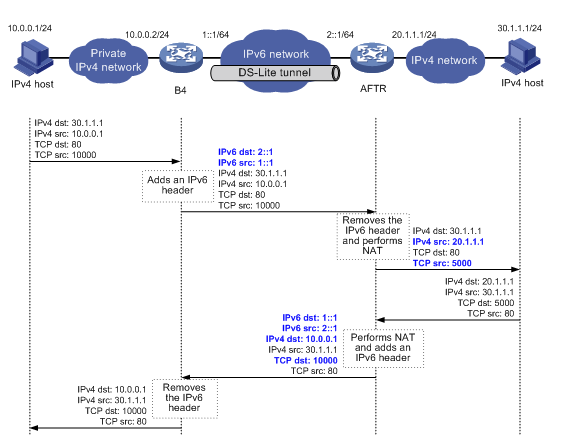

Figure 11 Packet forwarding process in DS-Lite
As shown in Figure 11, the packet forwarding process in DS-Lite is as follows:
1.        Upon receiving a packet from the private IPv4 network, the B4 router adds an IPv6 header to the packet and sends the IPv6 packet to the AFTR through the tunnel.
2.        The AFTR performs the following operations:
a.    Removes the IPv6 header from the tunneled packet.
b.    Assigns a tunnel ID for the B4 router.
c.    Records the mapping between the IPv6 address of the B4 router (the source IPv6 address of the packet), and the tunnel ID.
3.        After de-encapsulation, the AFTR translates the source private IPv4 address of the packet into a public IPv4 address and sends the packet to the destination IPv4 host. The AFTR also maps the NAT entries to the tunnel ID so that IPv4 networks connected to different B4 routers can use the same address space.
4.        Upon receiving the response packet from the public network, the AFTR translates the destination public IPv4 address into the private IPv4 address. The AFTR performs the following operations:
a.    Looks up the IPv6 address-tunnel ID mapping to obtain the IP address of the B4 router.
b.    Uses the address as the destination address of the encapsulated IPv6 packet.
c.    Forwards the packet to the B4 router.
Figure 11 shows an example of PAT translation for dynamic NAT. Typically, dynamic NAT is used. When you use static NAT for DS-Lite tunneling, make sure the IP addresses of private IPv4 networks connected to different B4 routers do not overlap. For more information about NAT, see NAT Configuration Guide.

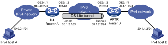

Example: Configuring a DS-Lite tunnel
As shown in Figure 12, to enable hosts in the private IPv4 network to access the public IPv4 network over the IPv6 network, perform the following tasks:
·          Configure a DS-Lite tunnel between Router A and Router B.
·          Configure NAT on GigabitEthernet 3/1/1 on the AFTR.
Figure 12 Network diagram
Make sure Router A and Router B can reach each other through IPv6. In this example, the CGN card is installed in slot 4 on Router B.
·          Configure B4 router Router A:
IMPORTANT
IMPORTANT:
The device cannot act as a B4 router. The following information is only for illustration.
[RouterA-GigabitEthernet3/1/1] ip address 10.0.0.2 255.255.255.0
# Specify an IPv6 address for GigabitEthernet 3/1/2, which is the physical interface of the tunnel.
[RouterA-GigabitEthernet3/1/2] ipv6 address 1::1 64
# Create IPv6 tunnel interface Tunnel 1.
[RouterA] interface tunnel 1 mode ipv6
[RouterA-Tunnel1] ip address 30.1.2.1 255.255.255.0
# Specify the IP address of GigabitEthernet 3/1/2 as the source address for the tunnel interface.
[RouterA-Tunnel1] source 1::1
# Specify IP address of GigabitEthernet 3/1/2 on Router B as the destination address for the tunnel interface.
[RouterA-Tunnel1] destination 2::2
# Configure a static route to the public IPv4 network through the tunnel interface.
[RouterA] ip route-static 20.1.1.0 255.255.255.0 tunnel 1
·          Configure AFTR Router B:
[RouterB-GigabitEthernet3/1/1] ip address 20.1.1.1 24
[RouterB-GigabitEthernet3/1/2] ipv6 address 2::2 64
# Create DS-Lite tunnel interface Tunnel 2.
[RouterB] interface tunnel 2 mode ds-lite-aftr
# Configure an IPv4 address for the tunnel interface.
[RouterB-Tunnel2] ip address 30.1.2.2 255.255.255.0
[RouterB-Tunnel2] source gigabitethernet 3/1/2
# Enable DS-Lite tunneling on GigabitEthernet 3/1/1.
[RouterB-GigabitEthernet3/1/1] ds-lite enable
# Create failover group cgn and configure the card in slot 4 as the primary node in the failover group.
[RouterB] failover group cgn id 1
[RouterB-failover-group-cgn] bind slot 4 primary
[RouterB-failover-group-cgn] quit
# Create a NAT address group numbered 0 and specify failover group cgn for the NAT address group.
[RouterB] nat address-group 0
[RouterB-address-group-0] failover-group cgn
# Add 20.1.1.11 and 20.1.1.12 to NAT address group 0, specify the port range as 1024 to 65535, and set the port block size to 300.
[RouterB-address-group-0] address 20.1.1.11 20.1.1.12
[RouterB-address-group-0] port-range 1024 65535
[RouterB-address-group-0] port-block block-size 300
[RouterB-address-group-0] quit
# Create IPv6 ACL 2100 and configure a rule to permit only IPv6 source addresses within the 1::/64 subnet.
RouterB] acl ipv6 basic 2100
[RouterB-acl-ipv6-basic-2100] rule permit source 1::/64
[RouterB-acl-ipv6-basic-2100] quit
# Create a traffic class named cgn and a traffic behavior named cgn, and redirect traffic that match IPv6 ACL 2100 to failover group cgn.
[RouterB] traffic classifier cgn
[RouterB-classifier-cgn] if-match acl ipv6 2100
[RouterB-classifier-cgn] quit
[RouterB] traffic behavior cgn
[RouterB-behavior-cgn] redirect failover-group cgn
[RouterB-behavior-cgn] quit
# Create QoS policy cgn and associate traffic class cgn with traffic behavior cgn in the QoS policy.
[RouterB] qos policy cgn
[RouterB-qospolicy-cgn] classifier cgn behavior cgn
[RouterB-qospolicy-cgn] quit
# Apply QoS policy cgn to the incoming traffic of GigabitEthernet 3/1/2.
[RouterB-GigabitEthernet3/1/2] qos apply policy cgn inbound
# Configure DS-Lite port block mapping on GigabitEthernet 3/1/1 to use address group 0 to translate packets permitted by IPv6 ACL 2100.
[RouterB-GigabitEthernet3/1/1] nat outbound ds-lite-b4 2100 address-group 0
# Redirect traffic permitted by IPv6 ACL 2100 to the primary node of failover group cgn for service processing.
[RouterB] session service-location acl ipv6 2100 failover-group cgn
# Enable flow-triggered port block assignment.
[RouterB] nat port-block flow-trigger enable
·          On host A, specify the IP address for the host as 10.0.0.1 and configure a static route to 20.1.1.0/24 with next hop 10.0.0.2. (Details not shown.)
·          On host B, specify the IP address for the host as 20.1.1.2. (Details not shown.)
# Verify that host A can ping host B.
C:\> ping 20.1.1.2
Pinging 20.1.1.2 with 32 bytes of data:
Reply from 20.1.1.2: bytes=32 time=51ms TTL=255
Reply from 20.1.1.2: bytes=32 time=44ms TTL=255
Reply from 20.1.1.2: bytes=32 time=1ms TTL=255
Ping statistics for 20.1.1.2:
    Minimum = 1ms, Maximum = 51ms, Average = 24ms
