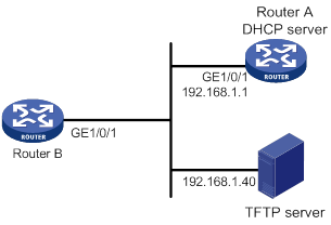

Example: Using a TFTP server for automatic configuration
As shown in Figure 2, Router B does not have a configuration file.
Configure the servers so Router B can obtain a configuration file to complete the following configuration tasks:
·          Enable the administrator to Telnet to Router B to manage Router B.
·          Require the administrator to enter the correct username and password at login.
Figure 2 Network diagram
1.        Configure the DHCP server:
# Enable DHCP.
<RouterA> system-view
[RouterA] dhcp enable
# Configure address pool 1 to assign IP addresses on the 192.168.1.0/24 subnet to clients. Specify the TFTP server and configuration file name for the clients.
[RouterA] dhcp server ip-pool 1
[RouterA-dhcp-pool-1] network 192.168.1.0 24
[RouterA-dhcp-pool-1] tftp-server ip-address 192.168.1.40
[RouterA-dhcp-pool-1] bootfile-name device.cfg
[RouterA-dhcp-pool-market] quit
2.        Configure the TFTP server:
# On the TFTP server, create a configuration file named device.cfg.
telnet server enable
local-user user
password simple abcabc
service-type telnet
user-interface vty 0 4
authentication-mode scheme
user-role network-admin
interface gigabitethernet 1/0/1
port link-mode route
ip address dhcp-alloc
return
# Start TFTP service software. (Details not shown.)
1.        Power on Router B.
2.        After Router B starts up, display assigned IP addresses on Router A.
<RouterA> display dhcp server ip-in-use
IP address       Client identifier/    Lease expiration      Type
                 Hardware address
192.168.1.2      0030-3030-632e-3239-  Dec 12 17:41:15 2013  Auto(C)
                 3035-2e36-3736-622d-
                 4574-6830-2f30-2f32
3.        Telnet to 192.168.1.2 from Router A.
<RouterA> telnet 192.168.1.2
4.        Enter username user and password abcabc as prompted. (Details not shown.)
You are logged in to Router B.

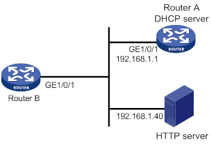

Example: Using an HTTP server and Tcl scripts for automatic configuration
As shown in Figure 3, Router B does not have a configuration file.
Configure the servers so Router B can obtain a Tcl script to complete the following configuration tasks:
Figure 3 Network diagram
# Enable DHCP.
# Specify the URL of the script file for the clients.
[RouterA-dhcp-pool-1] bootfile-name http://192.168.1.40/device.tcl
2.        Configure the HTTP server:
# Create a configuration file named device.tcl on the HTTP server.
return
local-user user
service-type telnet
return
# Start HTTP service software and enable HTTP service. (Details not shown.)
                 Hardware address
                 4574-6830-2f30-2f32

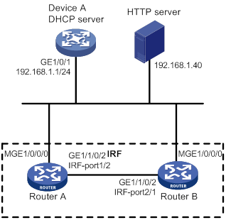

Example: Setting up an IRF fabric
As shown in Figure 5, Router A and Router B do not have a configuration file.
Configure the servers so the routers can obtain a Python script to complete their respective configurations and form an IRF fabric.
Figure 5 Network diagram
1.        Assign IP addresses to the interfaces. Make sure the devices can reach each other. (Details not shown.)
2.        Configure the following files on the HTTP server:

3.        Configure Device A as the DHCP server:
# Enable DHCP.
<DeviceA> system-view
[DeviceA] dhcp enable
[DeviceA] dhcp server ip-pool 1
[DeviceA-dhcp-pool-1] network 192.168.1.0 24
[DeviceA-dhcp-pool-1] bootfile-name http://192.168.1.40/device.py
[DeviceA-dhcp-pool-1] quit
# Enable the DHCP server on GigabitEthernet 1/0/1.
[DeviceA-GigabitEthernet1/0/1] dhcp select server
[DeviceA-GigabitEthernet1/0/1] quit
4.        Power on Router A and Router B.
Router A and Router B will obtain the Python script file from the DHCP server and execute the script. After completing the IRF configuration, Router A and Router B reboot.
5.        After Router A and Router B start up again, use a cable to connect Router A and Router B through their IRF physical ports.
Router A and Router B will elect a master member. The subordinate member will reboot to join the IRF fabric.
# On Router A, display IRF member devices. You can also use the display irf command on Router B to display IRF member devices.
<RouterA> display irf
MemberID  Slot  Role    Priority  CPU-Mac         Description
   1      1     Standby 1         00e0-fc0f-8c02  ---
 *+2      1     Master  30        00e0-fc0f-8c14  ---
 * indicates the device is the master.
 + indicates the device through which the user logs in.
 The Bridge MAC of the IRF is: 000c-1000-1111
 Auto upgrade                : yes
 Mac persistent              : always
 Domain ID                   : 0
 Auto merge                  : yes
The output shows that the routers have formed an IRF fabric.
