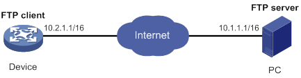

Example: Using the device as an FTP server (in standalone mode)
·          Configure the device as an FTP server.
·          Create a local user account named abc on the FTP server. Set the password to 123456.
·          Use the user account to log in to the FTP server from the FTP client.
·          Upload the temp.bin file from the FTP client to the FTP server.
·          Download configuration file startup.cfg from the FTP server to the FTP client for backup.
Figure 1 Network diagram
1.        Configure IP addresses as shown in Figure 1. Make sure the device and PC can reach other. (Details not shown.)
2.        Configure the device (FTP server):
# Create a local user named abc. Set the password to 123456.
<Sysname> system-view
[Sysname] local-user abc class manage
[Sysname-luser-manage-abc] password simple 123456
# Assign the network-admin user role to the user. Set the working directory to the root directory of the flash memory on the active MPU. (To set the working directory to the root directory of the flash memory on the standby MPU, you must include the slot number in the directory path.)
[Sysname-luser-manage-abc] authorization-attribute user-role network-admin work-directory flash:/
# Assign the service type FTP to the user.
[Sysname-luser-manage-abc] service-type ftp
[Sysname-luser-manage-abc] quit
# Enable the FTP server.
[Sysname] ftp server enable
[Sysname] quit
# Examine the storage space for space insufficiency and delete unused files for more free space.
<Sysname> dir
Directory of flash:
     0      drw-           -  Jun 29 2011 18:30:38     logfile
     1      drw-           -  Jun 21 2011 14:51:38     diagfile
     2      drw-           -  Jun 21 2011 14:51:38     seclog
     3      -rw-        2943  Jul 02 2011 08:03:08     startup.cfg
     4      -rw-       63901  Jul 02 2011 08:03:08     startup.mdb
     5      -rw-         716  Jun 21 2011 14:58:02     hostkey
     6      -rw-         572  Jun 21 2011 14:58:02     serverkey
     7      -rw-     6541264  Aug 04 2011 20:40:49     backup.bin
473664 KB total (467080 KB free)
<Sysname> delete /unreserved flash:/backup.bin
3.        Perform FTP operations from the PC (FTP client):
# Log in to the FTP server at 1.1.1.1 using username abc and password 123456.
c:\> ftp 1.1.1.1
Connected to 1.1.1.1.
220 FTP service ready.
User(1.1.1.1:(none)):abc
331 Password required for abc.
Password:
230 User logged in.
# Use the ASCII mode to download configuration file startup.cfg from the device to the PC for backup.
ftp> ascii
200 TYPE is now ASCII
ftp> get startup.cfg back-startup.cfg
# Use the binary mode to upload the file temp.bin from the PC to the root directory of the flash memory on the active MPU.
ftp> binary
200 TYPE is now 8-bit binary
ftp> put temp.bin
# Exit FTP.
ftp> bye

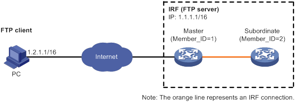

Example: Using the device as an FTP server (in IRF mode)
·          Configure the IRF fabric as an FTP server.
·          Download configuration file config.cfg from the FTP server to the FTP client for backup.
Figure 2 Network diagram
1.        Configure IP addresses as shown in Figure 2. Make sure the IRF fabric and the PC can reach each other. (Details not shown.)
2.        Configure the FTP server:
# Examine the storage space on the member devices. If the free space is insufficient, use the delete/unreserved file-url command to delete unused files. (Details not shown.)
# Assign the network-admin user role to the user. Set the working directory to the root directory of the flash memory on the global active MPU. (To set the working directory to the root directory of the flash memory on a global standby MPU, you must include the chassis and slot numbers in the directory path.)
[Sysname] quit
3.        Perform FTP operations from the FTP client:
c:\> ftp 1.1.1.1
Password:
230 User logged in.
# Use the ASCII mode to download configuration file config.cfg from the server to the client for backup.
ftp> ascii
ftp> get config.cfg back-config.cfg
# Use the binary mode to upload the temp.bin file to the root directory of the flash memory on the global active MPU.
ftp> binary
ftp> put temp.bin
# Exit FTP.
ftp> bye

Example: Using the device as an FTP client (in standalone mode)
As shown in Figure 3, the PC is acting as an FTP server. A user account with username abc and password 123456 has been created on the PC.
·          Use the device as an FTP client to log in to the FTP server.
·          Download the temp.bin file from the PC to the device.
·          Upload configuration file startup.cfg from the device to the PC for backup.
Figure 3 Network diagram
# Configure IP addresses as shown in Figure 3. Make sure the device and PC can reach each other. (Details not shown.)
# Examine the storage space of the device. If the free space is insufficient, use the delete/unreserved file-url command to delete unused files. (Details not shown.)
# Log in to the FTP server at 10.1.1.1 using username abc and password 123456.
<Sysname> ftp 10.1.1.1
Press CTRL+C to abort.
Connected to 10.1.1.1 (10.1.1.1).
220 WFTPD 2.0 service (by Texas Imperial Software) ready for new user
User (10.1.1.1:(none)): abc
331 Give me your password, please
Password:
230 Logged in successfully
Remote system type is MSDOS.
ftp>
# Set the file transfer mode to binary.
ftp> binary
# Download the temp.bin file from the PC to the root directory of the flash memory on the active MPU.
ftp> get temp.bin
local: temp.bin remote: temp.bin
150 Connecting to port 47457
226 File successfully transferred
23951480 bytes received in 95.399 seconds (251.0 kbyte/s)
# Download the temp.bin file from the PC to the root directory of the flash memory on the standby MPU (in slot 1).
ftp> get temp.bin slot1#flash:/temp.bin
# Use the ASCII mode to upload configuration file startup.cfg from the device to the PC for backup.
ftp> ascii
ftp> put startup.cfg back-startup.cfg
local: startup.cfg remote: back-startup.cfg
150 Connecting to port 47461
3494 bytes sent in 5.646 seconds (618.00 kbyte/s)
ftp> bye
221-Goodbye. You uploaded 2 and downloaded 2 kbytes.
221 Logout.
<Sysname>
