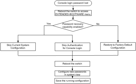

Restoring the factory-default configuration
CAUTION
CAUTION:
Performing this task can cause all next-startup configuration files in the current storage medium to be permanently deleted.
IMPORTANT
IMPORTANT:
Perform this task only if the switch has one MPU. If the switch has two MPUs, you cannot restore the factory-default configuration.
To restore the factory-default configuration from the EXTENDED-BOOTWARE menu, make sure password recovery capability is disabled. If the capability is enabled, you cannot perform the task.
To enable the system to start up with the factory-default configuration instead of a next-startup configuration file:
1.        Enter 5 in the EXTENDED-BOOTWARE menu.
==========================<EXTENDED-BOOTWARE MENU>==========================
|<1> Boot System                                                           |
|<2> Enter Serial SubMenu                                                  |
|<3> Enter Ethernet SubMenu                                                |
|<4> File Control                                                          |
|<5> Restore to Factory Default Configuration                              |
|<6> BootWare Operation Menu                                               |
|<7> Skip Authentication for Console Login                                 |
|<8> Storage Device Operation                                              |
|<0> Reboot                                                                |
Ctrl+Z: Access EXTENDED ASSISTANT MENU
Ctrl+C: Display Copyright
Ctrl+F: Format File System
Enter your choice(0-9):5
2.        Follow the system instruction to complete the task.
If password recovery capability is enabled, first disable the capability from the CLI, and then reboot the device to access the EXTENDED-BOOTWARE menu.
Password recovery capability is enabled. To perform this operation, first
disable the password recovery capability using the undo password-recovery
enable command in CLI.
If password recovery capability is disabled, enter Y at the prompt to complete the task.
Because the password recovery capability is disabled, this operation can
cause the configuration files to be deleted, and the system will start up
with factory defaults. Are you sure to continue?[Y/N]Y
Setting...Done.

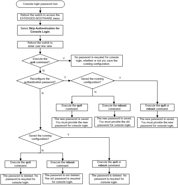

Skipping console login authentication
IMPORTANT
IMPORTANT:
·      To perform this task, make sure password recovery capability is enabled. If the capability is disabled, you cannot perform this task.
·      Perform this task only if the switch has one MPU. If the switch has two MPUs, you cannot skip console login authentication.
If you cannot remember the console login password, enter 8 in the EXTENDED-BOOTWARE menu, and then enter 1 or 0 in the EXTENDED-BOOTWARE menu. The switch will reboot and load the next-startup configuration file with the console login password ignored.
Enter your choice(0-9): 8
Clear Image Password Success!
After the switch starts up, you can configure a new console login password and save the running configuration so the new password takes effect (see Figure 1). If you do not configure a new console login password, the old password continues to take effect for the subsequent reboot.
Figure 1 Skipping console login authentication

Disabling password recovery capability
Password recovery capability controls console user access to the device configuration and SDRAM from BootWare menus. This feature also decides the method for handling console login password loss (see Figure 2).
If password recovery capability is enabled, a console user can access the device configuration without authentication to configure new passwords.
If password recovery capability is disabled, console users must restore the factory-default configuration before they can configure new passwords. Restoring the factory-default configuration deletes the next-startup configuration files.
To enhance system security, disable password recovery capability.
Figure 2 Handling console login password loss
Table 13 summarizes options whose availability depends on the password recovery capability setting.
Table 13 BootWare options and password recovery capability compatibility matrix
BootWare menu option
Password recovery enabled
Password recovery disabled
Tasks that can be performed
Download Image Program To SDRAM And Run
Yes
No
Load and run Comware software images in SDRAM.
Yes
No
Enable console login without authentication.
This is a one-time operation and takes effect only for the first system boot or reboot after you choose this option.
Skip Current System Configuration
Yes
No
Skip the configuration file at the next startup.
This is a one-time operation. It takes effect only for the first system boot or reboot after you choose this option.
This option does not delete the configuration file.
No
Yes
Delete the next-startup configuration file and load the factory-default configuration.
Download Files(*.*)
Yes
No
Download a file to the current storage medium.
