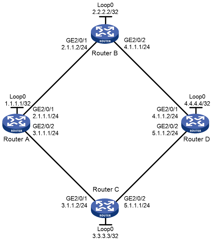

MPLS protection switching provides an end-to-end linear protection mechanism for MPLS TE tunnels. It associates an MPLS TE tunnel (working tunnel) with another MPLS TE tunnel (protection tunnel) to form a protection group. When the working tunnel fails, traffic is immediately switched to the protection tunnel, ensuring continuous traffic forwarding.
Protection switching triggering modes
A failure on the working tunnel triggers a protection switching. Protection switching can also be triggered by a command or a signal fail indication.
·     Command switching (external switching)—A protection switching is triggered by an externally configured switching command, which can define the following switching actions (in the descending order of priority):
¡     Clear—Clears all configured switching actions.
¡     Lockout of protection—Always uses the working tunnel to forward traffic.
¡     Forced switch—Forces traffic to be switched from the working tunnel to the protection tunnel.
¡     Manual switch—Manually switches traffic from the working tunnel to the protection tunnel. If a failure has occurred on the protection tunnel, traffic is not switched.
·     Signal fail switching—A protection switching is automatically triggered by a signal fail indication. The signaling can be BFD detection for MPLS TE tunnels or interface state (up/down) detection through link layer. For more information about configuring BFD for MPLS TE tunnels, see "Configuring MPLS OAM."
The following shows the protection switching triggers in the descending order of priority:
·     Clear.
·     Lockout of protection.
·     Forced switch.
·     Signal fail on the protection tunnel—The signaling protocol detected a failure on the protection tunnel.
·     Signal fail on the working tunnel—The signaling protocol detected a failure on the working tunnel.
·     Clear signal fail—The signaling protocol detected that the working or protection tunnel has recovered.
·     Manual switch.
If multiple triggers exist, the one with the highest priority determines the tunnel for traffic forwarding.
Protection switching modes
MPLS protection switching supports the following protection switching modes:
·     1:1 protection switching—Typically, traffic travels along the working tunnel. When either of the following events occurs, the ingress node selects the traffic forwarding tunnel (working or protection tunnel) according to the protection state:
¡     The ingress or egress node detects a failure on the working tunnel.
¡     An external switching command is executed on the node.
·     1+1 protection switching—Typically, traffic travels along both the working and protection tunnels, and the egress node receives traffic from the working tunnel. When either of the following events occurs, the egress node determines from which tunnel it receives traffic according to the protection state:
·     The tunnel ingress or egress node can detect tunnel failures through BFD for MPLS or other detection mechanisms. For more information about BFD for MPLS, see "Configuring MPLS OAM."
·     The protection state indicates the comprehensive status of a protection switching protection group. For more information, see the display mpls forwarding protection command in MPLS Command Reference.
Path switching modes
A bidirectional MPLS TE tunnel switches the traffic forwarding path in one of the following modes:
·     Unidirectional path switching—When an external switching command or a signal fail triggers protection switching for traffic in one direction, protection switching switches the traffic forwarding tunnel only in this direction. The traffic forwarding tunnel in the other direction does not change.
·     Bidirectional path switching—When an external switching command or a signal fail triggers protection switching for traffic in one direction, protection switching switches the traffic forwarding tunnels in both directions.
The ingress node and the egress node periodically send Protection State Coordination (PSC) packets to each other to coordinate the protection state. When one tunnel end performs a protection switching, the other end also performs a protection switching.
1:1 protection switching supports both unidirectional and bidirectional path switching. 1+1 protection switching supports only bidirectional path switching.

Example: Configuring MPLS TE tunnel 1:1 protection switching
Router A, Router B, Router C, and Router D run IS-IS.
Establish two MPLS TE tunnels (Tunnel 1 and Tunnel 2) from Router A to Router D to allow communication between two IP networks over the MPLS TE tunnels. Tunnel 1 uses the path Router A—Router B—Router D. Tunnel 2 uses the path Router A—Router C—Router D.
Configure protection switching on Router A by creating an MPLS protection group, and specify Tunnel 1 as the working tunnel and Tunnel 2 as the protection tunnel.
Figure 1 Network diagram
Device
Interface
IP address
Device
Interface
IP address
Router A
Loop0
1.1.1.1/32
Router D
Loop0
4.4.4.4/32
GE2/0/1
2.1.1.1/24
GE2/0/1
4.1.1.2/24
GE2/0/2
3.1.1.1/24
GE2/0/2
5.1.1.2/24
GE2/0/3
100.1.1.1/24
GE2/0/3
100.1.2.1/24
Router B
Loop0
2.2.2.2/32
Router C
Loop0
3.3.3.3/32
GE2/0/1
2.1.1.2/24
GE2/0/1
3.1.1.2/24
GE2/0/2
4.1.1.1/24
GE2/0/2
5.1.1.1/24
1.     Configure IP addresses and masks for interfaces as shown in Figure 1. (Details not shown.)
2.     Create MPLS TE tunnels on Router A:
# Create two MPLS TE tunnels (Tunnel 1 and Tunnel 2) to Router D. For more information, see "Configuring MPLS TE."

5.     Configure a static route to 100.1.2.0/24 through Tunnel-Bundle 0.
[RouterA] ip route-static 100.1.2.0 24 tunnel-bundle 0 preference 1
