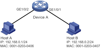

Example: Configuring static IPv4SG
As shown in Figure 2, all hosts use static IP addresses.
Configure static IPv4SG bindings on Device A and Device B to meet the following requirements:
·          All interfaces of Device A allow IP packets from Host A to pass.
·          GigabitEthernet 1/0/1 of Device A allows IP packets from Host B to pass.
Figure 2 Network diagram
# Configure an IP address for each interface. (Details not shown.)
# Enable IPv4SG on GigabitEthernet 1/0/2.
<DeviceA> system-view
[DeviceA] interface gigabitethernet 1/0/2
[DeviceA-GigabitEthernet1/0/2] ip verify source ip-address mac-address
[DeviceA-GigabitEthernet1/0/2] quit
# Configure a static IPv4SG binding for Host A.
[DeviceA] ip source binding ip-address 192.168.0.1 mac-address 0001-0203-0406
# Enable IPv4SG on GigabitEthernet 1/0/1.
[DeviceA-GigabitEthernet1/0/1] ip verify source ip-address mac-address
# On GigabitEthernet 1/0/1, configure a static IPv4SG binding for Host B.
[DeviceA-GigabitEthernet1/0/1] ip source binding mac-address 0001-0203-0407
[DeviceA-GigabitEthernet1/0/1] quit
# Verify that the static IPv4SG bindings are configured successfully on Device A.
<DeviceA> display ip source binding static
Total entries found: 2
IP Address      MAC Address    Interface                VLAN Type
192.168.0.1     0001-0203-0406 N/A                      N/A  Static
N/A             0001-0203-0407 GE1/0/1                  N/A  Static

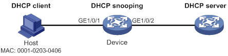

Example: Configuring DHCP snooping-based dynamic IPv4SG
As shown in Figure 3, the host (the DHCP client) obtains an IP address from the DHCP server. Perform the following tasks:
·          Enable DHCP snooping on the device to make sure the DHCP client obtains an IP address from the authorized DHCP server. To generate a DHCP snooping entry for the DHCP client, enable recording of client information in DHCP snooping entries.
·          Enable dynamic IPv4SG on GigabitEthernet 1/0/1 to filter incoming packets by using the IPv4SG bindings generated based on DHCP snooping entries. Only packets from the DHCP client are allowed to pass.
Figure 3 Network diagram
1.        Configure the DHCP server.
For information about DHCP server configuration, see Layer 3—IP Services Configuration Guide.
2.        Configure the device:
# Configure IP addresses for the interfaces. (Details not shown.)
# Enable DHCP snooping.
<Device> system-view
[Device] dhcp snooping enable
# Configure GigabitEthernet 1/0/2 as a trusted interface.
[Device] interface gigabitethernet 1/0/2
[Device-GigabitEthernet1/0/2] dhcp snooping trust
[Device-GigabitEthernet1/0/2] quit
# Enable IPv4SG on GigabitEthernet 1/0/1 and verify the source IP address and MAC address for dynamic IPSG.
[Device-GigabitEthernet1/0/1] ip verify source ip-address mac-address
# Enable recording of client information in DHCP snooping entries on GigabitEthernet 1/0/1.
[Device-GigabitEthernet1/0/1] dhcp snooping binding record
# Display dynamic IPSGv4 bindings generated based on DHCP snooping entries.
[Device] display ip source binding dhcp-snooping
Total entries found: 1
192.168.0.1     0001-0203-0406 GE1/0/1                  1    DHCP snooping
The output shows that GigabitEthernet 1/0/1 will filter packets based on the IPSGv4 binding.

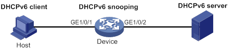

Example: Configuring DHCPv6 snooping-based dynamic IPv6SG address bindings
As shown in Figure 6, the host (the DHCPv6 client) obtains an IP address from the DHCPv6 server. Perform the following tasks:
·          Enable DHCPv6 snooping on the device to make sure the DHCPv6 client obtains an IPv6 address from the authorized DHCPv6 server. To generate a DHCPv6 snooping entry for the DHCPv6 client, enable recording of client information in DHCPv6 snooping entries.
·          Enable dynamic IPv6SG on GigabitEthernet 1/0/1 to filter incoming packets by using the IPv6SG bindings generated based on DHCPv6 snooping entries. Only packets from the DHCPv6 client are allowed to pass.
Figure 6 Network diagram
1.        Configure DHCPv6 snooping:
# Enable DHCPv6 snooping globally.
[Device] ipv6 dhcp snooping enable
[Device-GigabitEthernet1/0/2] ipv6 dhcp snooping trust
2.        Enable IPv6SG:
# Enable IPv6SG on GigabitEthernet 1/0/1 and verify the source IP address and MAC address for dynamic IPv6SG.
[Device-GigabitEthernet1/0/1] ipv6 verify source ip-address mac-address
# Enable recording of client information in DHCPv6 snooping entries on GigabitEthernet 1/0/1.
[Device-GigabitEthernet1/0/1] ipv6 dhcp snooping binding record
# Display dynamic IPSGv6 bindings generated based on DHCPv6 snooping entries.
[Device] display ipv6 source binding dhcpv6-snooping
IPv6 Address         MAC Address    Interface               VLAN Type
2001::1              040a-0000-0001 GE1/0/1                 1    DHCPv6 snooping
The output shows that GigabitEthernet 1/0/1 will filter packets based on the IPSGv6 binding.

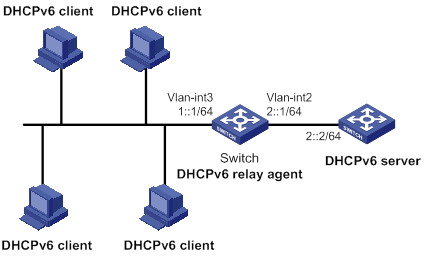

Example: Configuring DHCPv6 relay agent-based dynamic IPv6SG
As shown in Figure 8, DHCPv6 relay agent is enabled on the switch. The clients obtain IPv6 addresses from the DHCPv6 server through the DHCPv6 relay agent.
Enable dynamic IPv6SG on VLAN-interface 3 to filter incoming packets by using the IPv6SG bindings generated based on DHCPv6 relay entries.
Figure 8 Network diagram
1.        Configure the DHCPv6 relay agent:
# Create VLAN 2 and VLAN 3, assign interfaces to the VLANs, and specify IP addresses for VLAN-interface 2 and VLAN-interface 3. (Details not shown.)
# Enable the DHCPv6 relay agent on VLAN-interface 3.
[Switch] interface vlan-interface 3
[Switch-Vlan-interface3] ipv6 dhcp select relay
# Enable recording of DHCPv6 relay entries on the interface.
[Switch-Vlan-interface3] ipv6 dhcp relay client-information record
# Specify the DHCPv6 server address 2::2 on the relay agent.
[Switch-Vlan-interface3] ipv6 dhcp relay server-address 2::2
[Switch-Vlan-interface3] quit
2.        Enable IPv6SG on VLAN-interface 3 and verify the source IP address and MAC address for dynamic IPv6SG.
<Switch> system-view
[Switch-Vlan-interface3] ipv6 verify source ip-address mac-address
# Display dynamic IPv6SG bindings generated based on DHCPv6 relay entries.
[Switch] display ipv6 source binding dhcpv6-relay
1::2            0001-0203-0406 Vlan3                    3    DHCPv6 relay
The output shows that VLAN-interface 3 will filter packets based on the IPSGv6 binding.
