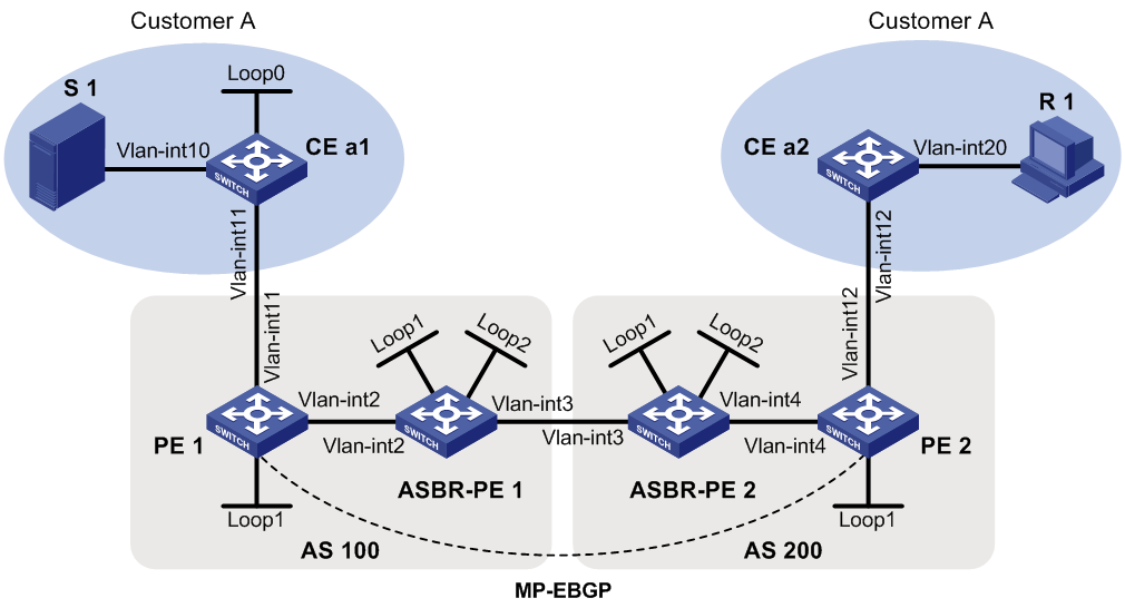

Example: Configuring intra-AS MDT-based MVPN
As shown in Figure 1:
·     Customer A has two branches that connect to the MPLS L3VPN network of a service provider.
·     PIM-SM runs within the two branches.
·     The multicast source and the receiver host are in different branches.
Configure intra-AS MDT-based MVPN so that the receiver host can receive the multicast data from the source.
Figure 1 Network diagram

Analysis
To meet the network requirement, you must run PIM on the devices of the public network, and configure MDT-based MVPN on each PE. In addition, make sure the PIM protocol on the public network is independent from the PIM protocol for the VPN instance.

Example: Configuring inter-AS option A MDT-based MVPN
As shown in Figure 2:
·     Customer A has two branches that separately connect to AS 100 and AS 200.
·     ASBR-PE 1 and ASBR-PE 2 are interconnected by using the inter-AS option A solution.
Configure inter-AS option A MDT-based MVPN so that the receiver host can receive the multicast data from the source.
Figure 2 Network diagram
Table 3 Interface and IP address assignment
Device
Interface
IP address
Device
Interface
IP address
S 1
10.11.3.2/24
R 1
10.11.4.2/24
PE 1
Vlan-int2
192.168.1.2/24
ASBR-PE 2
Vlan-int4
192.168.3.2/24
PE 1
Vlan-int11
10.11.1.1/24
ASBR-PE 2
Vlan-int3
192.168.2.2/24
PE 1
Loop1
1.1.1.1/32
ASBR-PE 2
Loop1
1.1.1.3/32
ASBR-PE 1
Vlan-int2
192.168.1.1/24
ASBR-PE 2
Loop2
22.22.22.22/32
ASBR-PE 1
Vlan-int3
192.168.2.1/24
PE 2
Vlan-int4
192.168.3.1/24
ASBR-PE 1
Loop1
1.1.1.2/32
PE 2
Vlan-int12
10.11.2.1/24
ASBR-PE 1
Loop2
11.11.11.11/32
PE 2
Loop1
1.1.1.4/32
CE a1
Vlan-int10
10.11.3.1/24
CE a2
Vlan-int20
10.11.4.1/24
CE a1
Vlan-int11
10.11.1.2/24
CE a2
Vlan-int12
10.11.2.2/24
CE a1
Loopback 0
2.2.2.2/32
Analysis

Example: Configuring inter-AS option C MDT-based MVPN
As shown in Figure 3:
·     ASBR-PE 1 and ASBR-PE 2 are interconnected by using the inter-AS option C solution.
Configure inter-AS option C MDT-based MVPN so that the receiver host can receive the multicast data from the source.
Figure 3 Network diagram
Table 5 Interface and IP address assignment
Device
Interface
IP address
Device
Interface
IP address
S 1
10.11.3.2/24
R 1
10.11.4.2/24
PE 1
Vlan-int2
192.168.1.2/24
ASBR-PE2
Vlan-int4
192.168.3.2/24
PE 1
Vlan-int11
10.11.1.1/24
ASBR-PE2
Vlan-int3
192.168.2.2/24
PE 1
Loop1
1.1.1.1/32
ASBR-PE2
Loop1
1.1.1.3/32
ASBR-PE1
Vlan-int2
192.168.1.1/24
ASBR-PE2
Loop2
22.22.22.22/32
ASBR-PE1
Vlan-int3
192.168.2.1/24
PE 2
Vlan-int4
192.168.3.1/24
ASBR-PE1
Loop1
1.1.1.2/32
PE 2
Vlan-int12
10.11.2.1/24
ASBR-PE1
Loop2
11.11.11.11/32
PE 2
Loop1
1.1.1.4/32
CE a1
Vlan-int10
10.11.3.1/24
CE a2
Vlan-int20
10.11.4.1/24
CE a1
Vlan-int11
10.11.1.2/24
CE a2
Vlan-int12
10.11.2.2/24
CE a1
Loop0
2.2.2.2/32
Analysis

6.     Create the same MVPN for the ASs, and specify the default-group, MVPN source interface, and data-group for the MVPN:
# On PE 1, create service loopback group 1 and specify the multicast tunnel service.
[PE1] service-loopback group 1 type multicast-tunnel
# Assign Ten-GigabitEthernet 1/0/4 to service loopback group 1.
[PE1] interface ten-gigabitethernet 1/0/4
[PE1-Ten-GigabitEthernet1/0/4] port service-loopback group 1
[PE1-Ten-GigabitEthernet1/0/4] quit
# Create an MDT-based MVPN for VPN instance customerA, enter MVPN IPv4 address family view, and specify the default-group, MVPN source interface, and data-group.
[PE1] multicast-vpn vpn-instance customerA mode mdt
[PE1-mvpn-customerA] address-family ipv4
[PE1-mvpn-customerA-ipv4] default-group 239.1.1.1
[PE1-mvpn-customerA-ipv4] source loopback 1
[PE1-mvpn-customerA-ipv4] data-group 225.2.2.0 28
[PE2-mvpn-customerA-ipv4] quit
[PE1-mvpn-customerA] quit
# On PE 2, create service loopback group 1 and specify the multicast tunnel service.
[PE2] service-loopback group 1 type multicast-tunnel
[PE2] interface ten-gigabitethernet 1/0/4
[PE2-Ten-GigabitEthernet1/0/4] port service-loopback group 1
[PE2-Ten-GigabitEthernet1/0/4] quit
[PE2] multicast-vpn vpn-instance customerA mode mdt
[PE2-mvpn-customerA] address-family ipv4
[PE2-mvpn-customerA-ipv4] default-group 239.1.1.1
[PE2-mvpn-customerA-ipv4] source loopback 1
[PE2-mvpn-customerA-ipv4] data-group 225.2.2.0 28
[PE2-mvpn-customerA] quit
# Verify that the default-MDT has been established on the public network in each AS on PEs and ASBR-PEs. The following example shows PIM routing table for the public network on ASBR-PE 1.
[ASBR-PE1] display pim routing-table
 Total 1 (*, G) entry; 2 (S, G) entry
 (*, 239.1.1.1)
     RP: 3.3.3.3 (local)
     Protocol: pim-sm, Flag: SPT LOC ACT
     UpTime: 02:54:43
     Upstream interface: Register
         Upstream neighbor: NULL
         RPF prime neighbor: NULL
     Downstream interface(s) information:
     Total number of downstreams: 1
         1: Vlan-interface2
             Protocol: pim-sm, UpTime: 02:54:43, Expires: -
 (1.1.1.1, 239.1.1.1)
     RP: 3.3.3.3 (local)
     UpTime: 01:57:13
     Upstream interface: Vlan-interface2
         Upstream neighbor: 192.168.1.2
         RPF prime neighbor: 192.168.1.2
     Downstream interface(s) information: None
(1.1.1.4, 239.1.1.1)
     RP: 3.3.3.3 (local)
     UpTime: 01:57:13
     Upstream interface: Vlan-interface3
         Upstream neighbor: 192.168.2.2
         RPF prime neighbor: 192.168.2.2
The output shows that an RPT for (*, 239.1.1.1), an SPT for (1.1.1.1, 239.1.1.1), and an SPT for (1.1.1.4, 239.1.1.1) have been established on the public network. The RPT and SPTs constitute the default-MDT for the public network.
