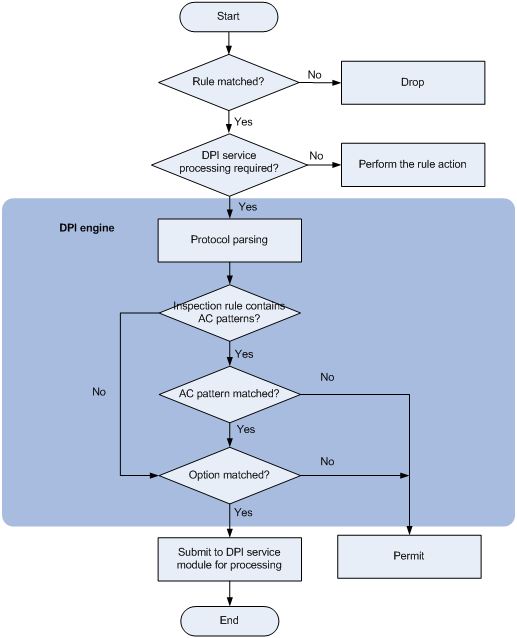

DPI engine mechanism
As shown in Figure 1, DPI engine works as follows:
1.      Upon receiving a packet, the device compares the packet against the object policy rules.
?  If a matching rule is found and a DPI application profile is specified for the rule, the device submits the packet to the DPI engine for processing. If no DPI application profile is specified for the rule, the device directly drops or permits the packet according to the configured rule action.
?  If no matching rule is found, the device drops the packet.
For more information about object policies, see object policy configuration in Security Configuration Guide.
2.      The DPI engine performs protocol parsing for the packet and searches for applicable inspection rules according to the parsing results.
3.      If an applicable inspection rule contains AC patterns, DPI engine performs AC pattern matching first. If an applicable inspection rule does not contain AC patterns, DPI engine directly performs option matching. The packet matches the rule if it matches the options.
4.      If the packet matches an AC pattern in an applicable inspection rule, the DPI engine further compares the packet against the options associated with the AC pattern. The packet matches the rule if it matches the both the AC pattern and its associated options. If the packet matches an AC pattern but does not match its associated options, the DPI engine permits the packet to pass.
5.      If the packet matches an inspection rule, the DPI engine submits the packet to the corresponding DPI service module for processing. If the packet does not match any rule, the DPI engine permits the packet to pass.
Figure 1 DPI engine mechanism
