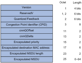

As shown in Figure 3, a payload contains the following fields:
Field
Length
Description
Version
4 bits
Its value is fixed at 0.
ReserverV
6 bits
Quantized Feedback
6 bits
Quantized value indicating the extent of congestion.
CPID
8 bytes
Identifies the CP where congestion occurs.
cnmQoffset
2 bytes
Indicates the difference between instantaneous queue size at the sampling point and desired queue length.
cnmQdelta
2 bytes
Indicates the difference between instantaneous queue sizes at the current sampling point and at the previous sampling point.
Encapsulated priority
2 bytes
Priority of the sampled frame that triggered the CNM.
Encapsulated destination MAC address
6 bytes
Destination MAC address of the sampled frame that triggered the CNM.
Encapsulated MSDU length
2 bytes
Number of bytes in the Encapsulated MSDU field of the sampled frame that triggered the CNM.
Encapsulated MSDU
0 to 64 bytes
Initial bytes of the Encapsulated MSDU field of the sampled frame that triggered the CNM.
Figure 3 CNM PDU format

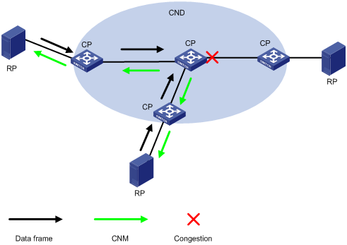

How QCN works
Figure 4 shows how QCN works.
·           The CP periodically samples frames from queues that are enabled with QCN and sends CNMs to the RPs when congestion occurs.
·           The RPs reduce their transmission rates when receiving CNMs. The RPs also periodically probe the bandwidth and increase their transmission rates if they fail to receive CNMs for a specific period of time.
Figure 4 How QCN works

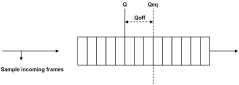

CP algorithm
The CP measures the queue size by periodically sampling frames and computes the congestion state based on the sampling result.
As shown in Figure 5, the CP algorithm includes the following parameters:
·           QIndicates the instantaneous queue size at the sampling point.
·           QeqIndicates the desired queue size.
·           QoldIndicates the queue size at the previous sampling point.
·           FbIndicates the extent of congestion in the form of a quantized value.
The following formulas apply:
·           Qoff = Q – Qeq
·           Qδ = Q – Qold
·           Fb = – (Qoff + wQδ)
where w is a constant to control the weight of Qδ in determining the value of Fb.
The CP determines whether to generate CNMs based on the Fb value.
·           When Fb ≥ 0, no congestion occurs, and the CP does not generate a CNM.
·           When Fb < 0, congestion occurs, and the CP generates an CNM containing the QntzFb. QntzFb is the quantized value of |Fb| and is calculated according to the following rules:
?  If Fb < – Qeq x (2 x w + 1), QntzFb takes the maximum value of 63.
?  Otherwise, QntzFb = – Fb x 63/(Qeq x (2 x w + 1)).
Figure 5 Congestion detection

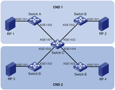

CND
A CND is a set of RPs and CPs enabled with QCN for a CNPV. CNDs are identified based on CNPVs. Devices enabled with QCN for a CNPV are assigned to the corresponding CND. A CNPV-based CND prevents traffic from outside the CND from entering the CND. If a frame from outside the CND includes the CNPV, the 802.1p priority value of the frame is mapped to a configured alternate priority value.
CND defense mode
Each interface on a device in a CND has a defense mode, which is statically configured or negotiated through LLDP.
The following defense modes are available:
·           disabledDisables congestion notification and performs priority mapping according to the priority mapping table.
·           edge—Maps the priority of incoming frames with a CNPV to an alternate priority and removes CN tags before sending out the frames.
·           interior—Does not alter the priority of incoming frames with a CNPV and removes CN tags before sending out the frames.
·           interiorReady—Does not alter the priority of incoming frames with a CNPV and retains CN tags when sending out the frames.

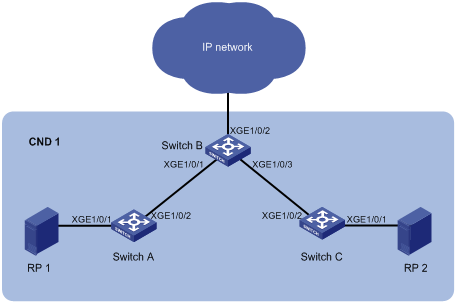

Basic QCN configuration example
Network requirements
As shown in Figure 6, RP 1 and RP 2 are in the same VLAN and both support QCN.
Configure QCN for CNPV 1 to meet the following requirements:
·           Switch A, Switch B, and Switch C detect congestion for traffic with 802.1p priority 1.
·           Switch A, Switch B, and Switch C do not detect congestion for all other traffic.
Figure 6 Network diagram

MultiCND QCN configuration example
As shown in Figure 7:
·           RP 1 and RP 2 are in the same VLAN.
·           RP 3 and RP 4 are in the same VLAN.
·           RP 1, RP 2, Switch A, Switch B, and Switch C form a CND with CNPV 1.
·           RP 3, RP 4, Switch C, Switch D, and Switch E form a CND with CNPV 5.
·           Switch A and Switch B do not detect congestion for traffic with 802.1p priority 5.
Configure QCN for CNPV 5 to meet the following requirements:
·           Switch C, Switch D, and Switch E detect congestion for traffic with 802.1p priority 5.
·           Switch D and Switch E do not detect congestion for traffic with 802.1p priority 1.
Figure 7 Network diagram
Configuration procedure
