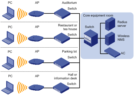

An H3C WA4320-ACN AP can act as a fit AP to cooperate with wireless switches or access controllers to provide wireless access for WLAN users. The network settings are configured on the wireless switches or access controllers. The H3C WA4320-ACN can also act as a fat AP to provide wireless access for WLAN users.

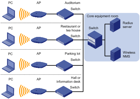

Figure 1 Deployment of the WA4320-ACN on hotspots (fit AP)
Figure 2 Deployment of the WA4320-ACN on hotspots (fat AP)

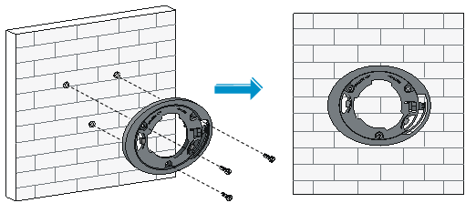

5.        Align the mounting holes in the mounting bracket with the anchors and insert screws through the mounting holes into the wall anchors. Adjust the position of the mounting bracket and tighten the screws.
Figure 9 Attaching the mounting bracket to the wall

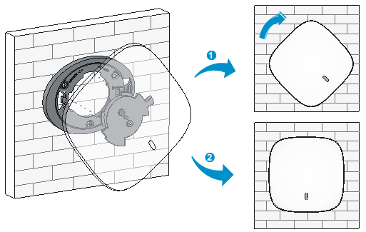

7.        Align the AP at a 45 degree angle with the mounting bracket, and rotate the AP clockwise until it clicks into place, as shown in Figure 10.
Figure 10 Attaching the AP to the wall mounting bracket

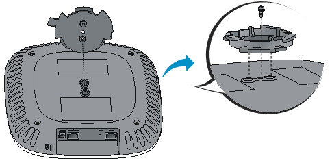

1.        Align the screw hole in the AP bracket with the screw hole in the AP rear. Use the M4 × 10 screw to secure the AP bracket to the AP.
Figure 11 Attaching the AP bracket to the AP rear

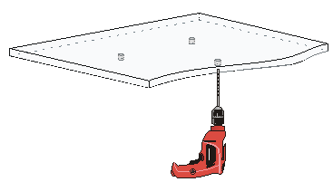

3.        Drill holes with a diameter of 5 mm (0.197 in) in the marked positions, as shown in Figure 12.
Figure 12 Drilling holes in the ceiling

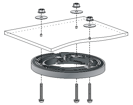

4.        Insert the M4 × 30 pan head screws through the mounting holes in the mounting bracket and the holes in the ceiling. Fasten washers and nuts at the other side of the ceiling to attach the mounting bracket to the ceiling, as shown in Figure 13.
Figure 13 Attaching the mounting bracket to the ceiling

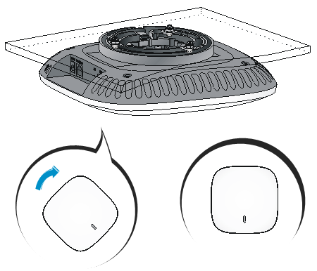

6.        Align the AP with the mounting bracket and rotate the AP clockwise until it clicks into place, as shown in Figure 14.
Figure 14 Attaching the AP to the ceiling mounting bracket

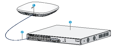

Connecting PoE power supply
Use an Ethernet cable to connect the Ethernet interface on the AP to an interface on a switch that supports PoE.
Figure 15 Connecting PoE power supply
(1) Ethernet interface
(2) Ethernet cable
(3) PoE switch

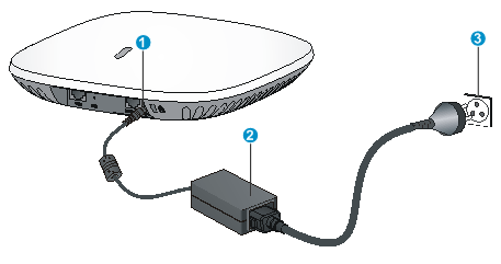

Connecting local power supply
The AC/DC adapter and power cord are user-supplied.
Table 2 AC/DC adapter specifications
Item
Specification
Input
100 VAC to 240 VAC
Output
+48V at 0.52 A
You can power the AP by using an AC/DC adapter. Use the AC/DC adapter to connect the power port of the AP to the local power source.
Figure 16 Connecting local power supply
(1) Power port
(2) AC/DC adapter
(3) Power source

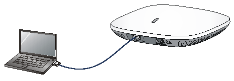

Logging in through the console port
Prepare the following items before logging in through the console port:
·          An 8-core console cable, with a crimped RJ-45 connector at one end, and a DB-9 connector at the other end.
·          A configuration terminal with a serial port, such as a laptop or PC.
Setting up the configuration environment
The serial ports on PCs do not support hot swapping. To connect a PC to an operating device, first connect the PC end. To disconnect a PC from an operating device, first disconnect the device end.
Connecting the console cable
1.        Connect the DB-9 connector to the serial port of the PC.
2.        Connect the RJ-45 connector to the console port of the AP.
Figure 17 Connecting the console cable

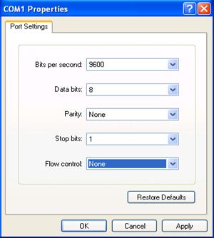

4.        Set Bits per second to 9600, Data bits to 8, Parity to None, Stop bits to 1, and Flow control to None, and click OK.
Figure 20 Setting the serial port parameters

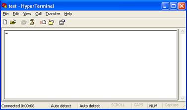

5.        Click OK and the system displays the HyperTerminal window.
Figure 21 HyperTerminal window

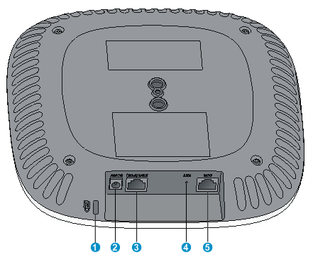

Ports
The AP provides the following ports:
·          One console port
·          One 10/100/1000 Mbps copper Ethernet port
·          One power port
The AP also has a reset button and a security slot. The security slot is 7 × 3 mm (0.28 × 0.12 in) in size.
Figure 22 Ports on the AP
(1) Security slot
(2) Power port
(3) 10/100/1000 Mbps copper Ethernet port
(4) Reset button
(5) Console port
Table 4 Port description
Port mark
Standards and protocols
Description
ETH1(PoE)
·         IEEE802.3
·         IEEE802.3u
·         IEEE802.3af
The Ethernet port can act as an uplink interface to access the Internet or MAN, and as a PoE port at the same time. It is represented by interface GE1/0/1.
DC 48V
N/A
The port receives +48 VDC power from the local supply.
CONSOLE
RS/EIA-232
The console port is used for configuration and management. When the AP acts as a fit AP, only the maintenance staff can use the console port.
