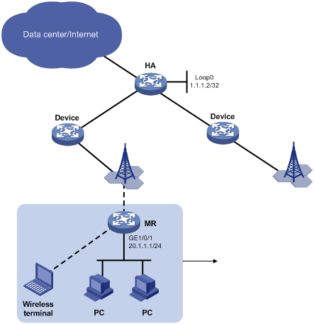

Connecting the mobile network to the home network through the 3G or 4G link
As shown in Figure 1, a tunnel is established between the home agent and the 3G or 4G modem interfaces of the mobile router. The mobile router and nodes on the mobile network can use the tunnel to access the home network.
When the mobile network roams, only the IP address of the 3G or 4G modem interface of the mobile router changes.
The mobile router sends a registration request to the home agent and re-establishes a tunnel with the home agent. Hosts attaching to the mobile router are unaware of the IP address change. Services are not interrupted.

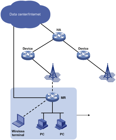

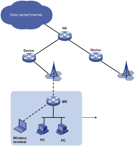

Connecting the mobile network to the home network through the wired link
As shown in Figure 2, the 3G or 4G wireless link is the backup link for the wired link between the mobile network and the home network.
When the mobile network roams, the wired link is disconnected. The mobile network is connected to the home network through the 3G or 4G wireless link. After the move is completed, the wired link is recovered, and the wireless link becomes the backup link.

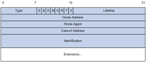

Registration request
A registration request contains the following fields:
·     Type—Type of the message. The value 1 represents a registration request, and the value 3 represents a registration reply.
·     S—Simultaneous bindings.
·     B—Broadcast datagrams.
·     D—Decapsulation by mobile node.
·     M—Minimal encapsulation.
·     G—GRE encapsulation.
·     r—Sent as zero. It is ignored on reception.
·     T—Reverse tunneling requested.
·     x—Sent as zero. It is ignored on reception.
·     Lifetime—Lifetime of the registration. The value 0 represents a request for deregistration. The value 0xFFFF (65535) indicates infinity.
·     Home Address—Home address of the mobile node.
·     Home Agent—IP address of the mobile node's home agent.
·     Care-of Address—IP address for the mobile router end of the tunnel.
·     Identification—Used to match registration requests and registration replies. The value is formatted as specified by the NTP.
·     Extensions—Registration extensions. The authentication extension must be added. The mobile network extension and NVSE extension can be added as required.

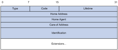

Registration reply
A registration reply contains the following different fields than a registration request:
·     Code—A value indicating the result of the registration request. The values 0 through 8 indicate that the registration request is accepted. For more information, see RFC 5944.
·     Identification—Used to match registration requests and registration replies. If the registration request is accepted, this field copies the value of the Identification field in the registration request.

Example: Configuring NEMO
As shown in Figure 9, the home agent is a Cisco device. The mobile router uses a USB 3G modem to register with the home agent and access the 3G network through Dial-on-Demand Routing (DDR).
Configure NEMO on the mobile router to meet the following requirements when the mobile network moves:
·     The hosts on the mobile network use their home addresses for communication.
·     Application connectivity is maintained on the hosts.
Figure 9 Network diagram
1.     Configure the mobile router:
# Assign the IP address 20.1.1.1 to GigabitEthernet 1/0/1.
<MR> system-view
[MR] interface gigabitethernet 1/0/1
[MR-GigabitEthernet1/0/1] ip address 20.1.1.1 255.255.255.0
[MR-GigabitEthernet1/0/1] quit
# Enable mobile IP.
[MR] router mobile
[MR-MIP] quit
# Enable the mobile router feature.
[MR] ip mobile router
# Assign a home address to the mobile router.
[MR-mobile-router] address 1.1.1.3
# Specify the IP address of the home agent 1.1.1.2 (IP address of the interface Loopback 0 on the home agent) on the mobile router.
[MR-mobile-router] home-agent 1.1.1.2
# Specify GigabitEthernet 1/0/1 as the mobile router interface.
[MR-mobile-router] mobile-network gigabitethernet 1/0/1
[MR-mobile-router] quit
# Channelize Cellular 2/4/0 into a synchronous/asynchronous serial interface.
[MR] controller cellular 2/4/0
[MR-Cellular2/4/0] serial-set 0
[MR-Cellular2/4/0] quit
# Configure Serial 2/4/0:0 as the roaming interface. (In this example, the IP address of the roaming interface is assigned by the service provider. For more information, see Layer 2—WAN Access Configuration Guide.)
[MR] interface serial 2/4/0:0
[MR-Serial2/4/0:0] ip mobile router-service roam
[MR-Serial2/4/0:0] quit
# Configure a security association that contains the home agent address 1.1.1.2, SPI 100, and the plaintext key abc. Make sure the same security association is configured on the home agent.
[MR] ip mobile secure home-agent 1.1.1.2 spi 100 key ascii simpletext abc
2.     Configure the home agent as described in its user documentation. (Details not shown.)
# Display registration information for the mobile router.
[MR] display ip mobile router registration
Registration accepted on 12/04/13 at 10:43:52, On Serial2/4/0:0
Care-of addr: 208.122.148.233, HA addr: 1.1.1.2, Home addr: 1.1.1.3
Lifetime requested: 65534, Granted: 36000
Remaining: 9 hours 58 minutes 36 seconds
Flags sbDmG-T-
Identification d64985e8.bd34f00e
Next registration: 9 hours 56 minutes 36 seconds
Extensions:
  Mobile Network 20.1.1.0/24
  Authentication SPI: 100
# Display registration information for the mobile router after it moves to another network.
Registration accepted on 12/04/13 at 11:35:45, On Serial2/4/0:0
Care-of addr: 212.48.124.187, HA addr: 1.1.1.2, Home addr: 1.1.1.3
Flags sbDmG-T-
Identification d6499211.bc35e11d
Extensions:
The output shows that the mobile router retains the home address and maintains the application connectivity when it moves.
