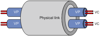

ATM is connection-oriented, and ATM connections are logical (virtual) connections. In an ATM network, you can create logical connections called virtual paths (VPs) and virtual circuits (VCs) on physical links.
As shown in Figure 1, you can create multiple VPs on a physical link, and each VP can be demultiplexed into multiple VCs. Cells from different users are transmitted over different VPs and VCs, which are identified by virtual path identifier (VPI) and virtual channel identifier (VCI). ATM uses VPI/VCI pairs to identify virtual connections.
Figure 1 Physical link, VP, and VC

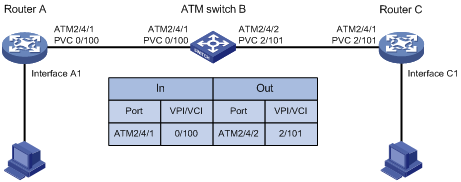

In an ATM network, an ATM switch forwards ATM cells by looking up the switching entries and changing the VPIs/VCIs. In PVC mode, the network administrator configures the switching entries and assigns VPIs/VCIs. Users can use the assigned VPIs/VCIs to configure the PVCs. If the ATM interfaces of two ATM devices are directly connected, they must be configured with the same VPIs/VCIs.
Figure 2 shows a typical ATM switching process:
1.     Router A forwards a cell through PVC 0/100 on interface ATM 2/4/1.
2.     ATM switch B receives the cell through PVC 0/100 on interface ATM 2/4/1.
3.     ATM switch B looks up its switching entries and forwards the cell through PVC 2/101 on interface ATM 2/4/2.
4.     Router C receives the cell through PVC 2/101 on interface ATM 2/4/1.
Figure 2 ATM switching

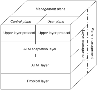

ATM architecture
ATM has a three-dimensional architecture. It contains the user plane, control plane, and management plane.
Both the user plane and the control plane are divided into the following layers: physical layer, ATM layer, ATM Adaptation Layer (AAL), and upper layer. Each layer is further divided into sublayers.
The control plane establishes and tears down connections with signaling protocols. The management plane contains layer management and plane management. Layer management manages the layers in each plane and has a layered structure corresponding to other planes. Plane management manages the system and the communications between different planes.
Figure 3 shows the relationships between layers and planes in ATM.
Figure 3 ATM architecture
ATM layers have the following functions:
·     Physical layer—Provides transmission channels for ATM cells. At this layer, cells received from the ATM layer are transferred into a continuous bit stream after transmission overheads are added to them. Meanwhile, continuous bit streams received from physical media are restored to cells, which are then passed to the ATM layer.
·     ATM layer—Resides over the physical layer, and implements cell-based communication with its peer layer by invoking the services provided by the physical layer. It is independent of physical media, implementation of the physical layer, and types of services being carried. AAL passes 48-byte payloads, which are called segmentation and reassembly protocol data units (SAR-PDUs) to the ATM layer. The ATM layer encapsulates the 48-byte payloads in 5-byte headers, and passes 53-byte cells to the physical layer. Other functions of the ATM layer include VPI/VCI transmission, cell multiplexing/demultiplexing, and generic flow control.
·     ATM Adaptation Layer—Provides interfaces between high-level protocols and the ATM Layer. It forwards information between the ATM layer and upper-layer protocols. Four types of AAL are available: AAL1, AAL2, AAL3/4, and AAL5, each of which supports specific services provided in an ATM network. H3C uses AAL5 for data communication services.
·     ATM upper-layer protocols—Responsible for WAN interconnection, Layer 3 interconnection, and multiprotocol over ATM (such as IP, IPoE, PPP, and PPPoE).

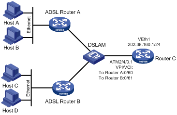

Configuring IPoEoA
About VEth interfaces and VEth subinterfaces
For IPoEoA applications, you can associate multiple PVCs with one Layer 3 virtual Ethernet (VE) interface. The PVCs associated with the same VEth interface are interconnected at Layer 2.
PPPoEoA uses VEth interfaces to carry Ethernet frames over ATM. A VEth interface has Ethernet characteristics and can be dynamically created. The following is the protocol stack used by a VEth interface:
·     ATM PVC (the bottom layer).
·     Ethernet (the link layer).
·     Network layer and other upper layers (the same as those for common Ethernet interfaces).
Restrictions and guidelines for IPoEoA configuration
Before you configure IPoEoA and PPPoEoA, you must create a VEth interface.
Configuring a VEth interface-to-PVC mapping
2.     Create a VEth interface or VEth subinterface and enter its view.
interface virtual-ethernet { interface-number | interface-number.subnumber }
3.     Configure an IP address for the VEth interface.
ip address ip-address { mask | mask-length }
For an IPoEoA application, configure the IP address for VEth interfaces instead of ATM interfaces. The IP address configuration does not take effect on ATM interfaces.
4.     Return to system view.
5.     Enter ATM interface view or ATM subinterface view.
interface atm { interface-number | interface-number.subnumber }
6.     Enter PVC view or PVC group view.
¡     Enter PVC view.
pvc { pvc-name [ vpi/vci ] | vpi/vci }
¡     Enter PVC group view.
pvc-group group-number
7.     Configure an IPoEoA mapping.
map bridge virtual-ethernet interface-number
By default, no mappings exist.
This command references the VEth interface previously created.
Configuring the VEth interface
2.     Enter VEth interface view.
interface virtual-ethernet  interface-number
The device supports a maximum of 1024 VEth interfaces.
3.     (Optional.) Configure the description of the interface.
description text
The default interface description is interface name Interface. For example, Virtual-Ethernet 0 Interface.
4.     (Optional.) Configure the MTU for the interface.
mtu size
By default, the MTU for the interface is 1500 bytes.
5.     (Optional.) Configure the MAC address for the interface.
mac-address mac-address
By default, the VEth interface uses the bridge MAC address as its MAC address.
6.     (Optional.) Configure the expected bandwidth for the interface.
bandwidth bandwidth-value
By default, the expected bandwidth (in kbps) is the interface baud rate divided by 1000.
The expected bandwidth is an informational parameter used only by higher-layer protocols for calculation. You cannot adjust the actual bandwidth of an interface by using this command.
7.     Bring up the interface.
undo shutdown

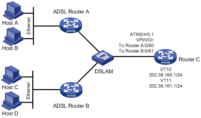

Configuring PPPoA
To transmit PPP packets across an ATM network, you must create a virtual-template (VT) interface.
When two routers are connected by using DSL interfaces through a dial-up connection, configure them as a PPPoA server and client. The PPPoA server acts as the PPP server, and you must configure an address pool for it to assign an IP address to the remote node. The PPPoA client acts as the PPP client, and you must configure address negotiation on it to accept the IP address assigned by the server end. For more information, see "Configuring PPP and MP."
When you configure a static route for the VT interface, specify the next hop instead of the output interface. If you have to specify an output interface, make sure the physical interface bound to the VT is valid to ensure correct packet transmission.
2.     Create a VT interface and enter its view.
interface virtual-template vt-number
3.     Configure PPP authentication and IP address.
¡     For the PPP server, configure an address pool to assign an IP address to the remote node.
¡     For the PPP client, configure address negotiation to accept the IP address assigned by the server end.
For more information, see "Configuring PPP" and "Configuring MP."
Configure PPP authentication and IP address on the VT interface instead of an ATM interface. The IP address configuration does not take effect on ATM interfaces.
¡     Enter PVC view.
7.     Configure a PPPoA mapping.
map ppp virtual-template vt-number

Example: Configuring IPoEoA
As shown in Figure 6, the hosts in the two Ethernets are connected to the ATM network through ADSL Router A and ADSL Router B. They communicate with Router C through DSLAM.
The IP address of the VEth interface of Router C is 202.38.160.1.
The VPI/VCI values of the two PVCs connecting Router C and DSLAM are 0/60 and 0/61, pointing to Router A and Router B, respectively.
Both the WAN port of Router C and the DSL interfaces of the ADSL routers use IPoEoA.
Figure 6 Network diagram
1.     Configure Router C:
# Create a VEth interface and configure an IP address for it.
<RouterC> system-view
[RouterC] interface virtual-ethernet 1
[RouterC-Virtual-Ethernet1] ip address 202.38.160.1 255.255.255.0
[RouterC-Virtual-Ethernet1] quit
# Create PVCs, and enable them to carry IPoE.
[RouterC] interface atm 2/4/0.1
[RouterC-ATM2/4/0.1] pvc to_adsl_a 0/60
[RouterC-ATM2/4/0.1-pvc-to_adsl_a-0/60] map bridge virtual-ethernet 1
[RouterC-ATM2/4/0.1-pvc-to_adsl_a-0/60] quit
[RouterC-ATM2/4/0.1] pvc to_adsl_b 0/61
[RouterC-ATM2/4/0.1-pvc-to_adsl_b-0/61] map bridge virtual-ethernet 1

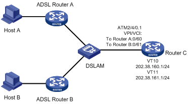

Example: Configuring PPPoA
As shown in Figure 7, two hosts dial into the ATM network each through an ADSL router, and communicate with Router C through DSLAM. This configuration example has the following requirements:
·     Create VT for multiuser on Router C, and configure PPP mapping on VT.
·     The VPI/VCI values of two PVCs connecting Router C and DSLAM are 0/60 and 0/61, pointing to ADSL Router A and ADSL Router B, respectively.
·     Both the WAN port of Router C and the DSL interfaces of the two ADSL routers use PPPoA. PPP authentication is not performed. The IP addresses of the two ADSL routers are assigned by Router C.
Figure 7 Network diagram
1.     Configure Router C (PPPoA server):
# Create VT interfaces and configure IP addresses for them. Assign IP addresses to the remote ends.
[RouterC] interface virtual-template 10
[RouterC-Virtual-Template10] ip address 202.38.160.1 255.255.255.0
[RouterC-Virtual-Template10] remote address 202.38.162.1
[RouterC-Virtual-Template10] quit
[RouterC] interface virtual-template 11
[RouterC-Virtual-Template11] ip address 202.38.161.1 255.255.255.0
[RouterC-Virtual-Template11] remote address 202.38.162.2
[RouterC-Virtual-Template11] quit
# Create PVCs, and enable them to carry PPP.
[RouterC-ATM2/4/0.1-pvc-to_adsl_a-0/60] map ppp virtual-template 10
[RouterC-ATM2/4/0.1-pvc-to_adsl_b-0/61] map ppp virtual-template 11

Example: Configuring PPPoEoA
As shown in Figure 8, the hosts in the two Ethernets are connected to the ATM network through ADSL Router A and ADSL Router B. They communicate with Router C through DSLAM.
The IP addresses of the VT interfaces of Router C are 202.38.160.1 and 202.38.161.1.
Both the WAN port of Router C and the DSL interfaces of the ADSL routers use PPPoEoA. PPP authentication is not performed. The IP addresses of the two ADSL routers are assigned by Router C.
Figure 8 Network diagram
1.     Configure Router C (PPPoEoA server):
# Create VEth interfaces, and enable them to carry PPP.
[RouterC-Virtual-Ethernet1] pppoe-server bind virtual-template 10
[RouterC] interface virtual-ethernet 2
[RouterC-Virtual-Ethernet2] pppoe-server bind virtual-template 11
[RouterC-Virtual-Ethernet2] quit
# Create PVCs, and enable them to carry PPPoE.
[RouterC-ATM2/4/0.1-pvc-to_adsl_b-0/61] map bridge virtual-ethernet 2

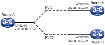

Example: Configuring ATM PVC transmission priority
As shown in Figure 9, create PVC 1 and PVC 2 on the same ATM 155 Mbps interface. Each PVC is assigned 100 Mbps of bandwidth and is associated with the UBR service. Set the transmission priority of PVC 1 to 1 and that of PVC 2 to 3.
Configure Router A to distribute equal amount of traffic to Router B and Router C on the two PVCs and observe the statistics of received/sent/dropped packets.
Figure 9 Network diagram
# Configure the ATM interface.
<RouterA> system-view
[RouterA] interface atm 2/4/0
[RouterA-Atm2/4/0] ip address 202.38.160.1 255.255.255.0
# Create two PVCs, and assign them different transmission priorities.
[RouterA-ATM2/4/0] pvc 1 0/33
[RouterA-ATM2/4/0-pvc-1-0/33] map ip 202.38.160.2
[RouterA-ATM2/4/0-pvc-1-0/33] service ubr 100000
[RouterA-ATM2/4/0-pvc-1-0/33] transmit-priority 1
[RouterA-ATM2/4/0-pvc-1-0/33] quit
[RouterA-ATM2/4/0] pvc 2 0/32
[RouterA-ATM2/4/0-pvc-2-0/32] map ip 202.38.160.3
[RouterA-ATM2/4/0-pvc-2-0/32] service ubr 100000
[RouterA-ATM2/4/0-pvc-2-0/32] transmit-priority 3
