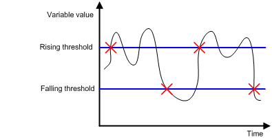

Threshold test
A threshold test regularly compares the value of the monitored object with the threshold values.
·          A rising alarm event is triggered if the value of the monitored object is greater than or equal to the rising threshold.
·          A falling alarm event is triggered if the value of the monitored object is smaller than or equal to the falling threshold.
·          A rising alarm event is triggered if the difference between the current sampled value and the previous sampled value is greater than or equal to the delta rising threshold.
·          A falling alarm event is triggered if the difference between the current sampled value and the previous sampled value is smaller than or equal to the delta falling threshold.
·          A falling alarm event is triggered if the values of the monitored object, the rising threshold, and the falling threshold are the same.
·          A falling alarm event is triggered if the delta rising threshold, the delta falling threshold, and the difference between the current sampled value and the previous sampled value is the same.
The alarm management module defines the set or notification action to take on alarm events.
If the value of the monitored object crosses a threshold multiple times in succession, the managed device triggers an alarm event only for the first crossing. For example, if the value of a sampled object crosses the rising threshold multiple times before it crosses the falling threshold, only the first crossing triggers a rising alarm event, as shown in Figure 1.
Figure 1 Rising and falling alarm events

Configuring a threshold trigger test
1.        Enter system view.
2.        Enter trigger view.
snmp mib event trigger owner trigger-owner name trigger-name
3.        Specify a threshold test for the trigger and enter trigger-threshold view.
test boolean
By default ,no test is configured for a trigger.
4.        Specify the object list to be added to the notification triggered by the test.
object list owner group-owner name group-name
By default, no object list is specified for a threshold trigger test.
5.        (Optional.) Specify the type of the threshold trigger test for the first sampling.
startup { falling | rising | rising-or-falling }
The default threshold trigger test type for the first sampling is rising-or-falling.
6.        Specify the delta falling threshold and the falling alarm event triggered when the delta value (difference between the current sampled value and the previous sampled value) is smaller than or equal to the delta falling threshold.
delta falling { event owner event-owner name event-name | value integer-value }
By default, the delta falling threshold is 0, and no falling alarm event is specified.
7.        Specify the delta rising threshold and the rising alarm event triggered when the delta value is greater than or equal to the delta rising threshold.
delta rising { event owner event-owner name event-name | value integer-value }
By default, the delta rising threshold is 0, and no rising alarm event is specified.
8.        Specify the falling threshold and the falling alarm event triggered when the sampled value is smaller than or equal to the threshold.
By default, the falling threshold is 0, and no falling alarm event is specified.
9.        Specify the rising threshold and the ring alarm event triggered when the sampled value is greater than or equal to the threshold.
By default, the rising threshold is 0, and no rising alarm event is specified.
