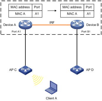

Enabling MAC address synchronization
About MAC address synchronization
To avoid unnecessary floods and improve forwarding speed, make sure all member devices have the same MAC address table. After you enable MAC address synchronization, each member device advertises learned MAC address entries to other member devices.
As shown in Figure 2:
·          Device A and Device B form an IRF fabric enabled with MAC address synchronization.
·          Device A and Device B connect to AP C and AP D, respectively.
When Client A associates with AP C, Device A learns a MAC address entry for Client A and advertises it to Device B.
Figure 2 MAC address tables of devices when Client A accesses AP C

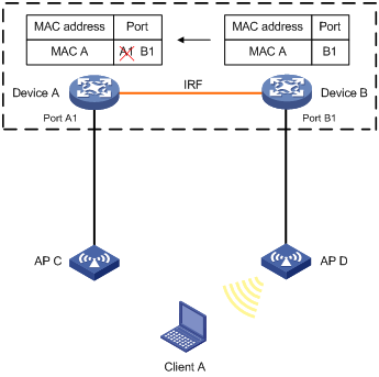

When Client A roams to AP D, Device B learns a MAC address entry for Client A. Device B advertises it to Device A to ensure service continuity for Client A, as shown in Figure 3.
Figure 3 MAC address tables of devices when Client A roams to AP D

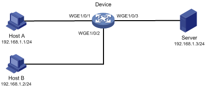

Example: Configuring the MAC address table
As shown in Figure 5:
·          Host A at MAC address 000f-e235-dc71 is connected to Twenty-FiveGigE 1/0/1 of Device and belongs to VLAN 1.
·          Host B at MAC address 000f-e235-abcd, which behaved suspiciously on the network, also belongs to VLAN 1.
Configure the MAC address table as follows:
·          To prevent MAC address spoofing, add a static entry for Host A in the MAC address table of Device.
·          To drop all frames destined for Host B, add a blackhole MAC address entry for Host B.
·          Set the aging timer to 500 seconds for dynamic MAC address entries.
Figure 5 Network diagram
# Add a static MAC address entry for MAC address 000f-e235-dc71 on Twenty-FiveGigE 1/0/1 that belongs to VLAN 1.
<Device> system-view
[Device] mac-address static 000f-e235-dc71 interface twenty-fivegige 1/0/1 vlan 1
# Add a blackhole MAC address entry for MAC address 000f-e235-abcd that belongs to VLAN 1.
[Device] mac-address blackhole 000f-e235-abcd vlan 1
# Set the aging timer to 500 seconds for dynamic MAC address entries.
[Device] mac-address timer aging 500
# Display the static MAC address entries for Twenty-FiveGigE 1/0/1.
[Device] display mac-address static interface twenty-fivegige 1/0/1
MAC Address      VLAN ID    State            Port/Nickname            Aging
000f-e235-dc71   1          Static           WGE1/0/1                 N
# Display the blackhole MAC address entries.
[Device] display mac-address blackhole
000f-e235-abcd   1          Blackhole        N/A                      N
# Display the aging time of dynamic MAC address entries.
[Device] display mac-address aging-time
MAC address aging time: 500s.
