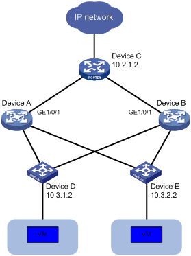

Track event monitor policy configuration example
Network requirements
As shown in Figure 2, Device A has established BGP sessions with Device D and Device E. Traffic from Device D and Device E to the Internet is forwarded through Device A.
Configure a CLI-defined EAA monitor policy on Device A to disconnect the sessions with Device D and Device E when GigabitEthernet 1/0/1 connected to Device C is down. In this way, traffic from Device D and Device E to the Internet can be forwarded through Device B.
Figure 2 Network diagram

# Configure a CLI-defined EAA monitor policy so that the system automatically disables session establishment with Device D and Device E when GigabitEthernet 1/0/1 is down.
[DeviceA] rtm cli-policy test
[DeviceA-rtm-test] event track 1 state negative
[DeviceA-rtm-test] action 0 cli system-view
[DeviceA-rtm-test] action 1 cli bgp 100
[DeviceA-rtm-test] action 2 cli peer 10.3.1.2 ignore
[DeviceA-rtm-test] action 3 cli peer 10.3.2.2 ignore
[DeviceA-rtm-test] user-role network-admin
[DeviceA-rtm-test] commit
[DeviceA-rtm-test] quit
# Shut down GigabitEthernet 1/0/1.
[DeviceA-GigabitEthernet1/0/1] shutdown
# Execute the display bgp peer ipv4 command on Device A to display BGP peer information. If no BGP peer information is displayed, Device A does not have any BGP peers.
