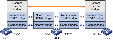

LLDP agent
An LLDP agent is a mapping of an entity where LLDP runs. Multiple LLDP agents can run on the same interface.
LLDP agents are divided into the following types:
·     Nearest bridge agent.
·     Nearest customer bridge agent.
·     Nearest non-TPMR bridge agent.
A Two-port MAC Relay (TPMR) is a type of bridge that has only two externally-accessible bridge ports. It supports a subset of the features of a MAC bridge. A TPMR is transparent to all frame-based media-independent protocols except for the following protocols:
·     Protocols destined to it.
·     Protocols destined to reserved MAC addresses that the relay feature of the TPMR is configured not to forward.
LLDP exchanges packets between neighbor agents and creates and maintains neighbor information for them. Figure 1 shows the neighbor relationships for these LLDP agents. LLDP has two bridge modes: customer bridge (CB) and service bridge (SB).
Figure 1 LLDP neighbor relationships

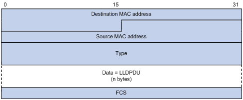

LLDP frame formats
LLDP sends device information in LLDP frames. LLDP frames are encapsulated in Ethernet II or Subnetwork Access Protocol (SNAP) frames.
·     LLDP frame encapsulated in Ethernet II
Figure 2 Ethernet II-encapsulated LLDP frame
Table 1 Fields in an Ethernet II-encapsulated LLDP frame
Field
Description
Destination MAC address
MAC address to which the LLDP frame is advertised. LLDP specifies different multicast MAC addresses as destination MAC addresses for LLDP frames destined for agents of different types. This helps distinguish between LLDP frames sent and received by different agent types on the same interface. The destination MAC address is fixed to one of the following multicast MAC addresses:
·     0x0180-c200-000E for LLDP frames destined for nearest bridge agents.
·     0x0180-c200-0000 for LLDP frames destined for nearest customer bridge agents.
·     0x0180-c200-0003 for LLDP frames destined for nearest non-TPMR bridge agents.
Source MAC address
MAC address of the sending port.
Type
Ethernet type for the upper-layer protocol. This field is 0x88CC for LLDP.
Data
LLDPDU.
FCS
Frame check sequence, a 32-bit CRC value used to determine the validity of the received Ethernet frame.
