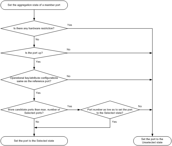

 Setting the aggregation state of each member port
After the reference port is chosen, the system sets the aggregation state of each member port in the static aggregation group.
Figure 2 Setting the aggregation state of a member port in a static aggregation group
After the limit on Selected ports is reached, the aggregation state of a new member port varies by following conditions:
·     The port is placed in Unselected state if the port and the Selected ports have the same port priority. This mechanism prevents traffic interruption on the existing Selected ports. A device reboot can cause the device to recalculate the aggregation states of member ports.
·     The port is placed in Selected state when the following conditions are met:
¡     The port and the Selected ports have different port priorities, and the port has a higher port priority than a minimum of one Selected port.
¡     The port has the same attribute configurations as the aggregate interface.
Any operational key or attribute configuration change might affect the aggregation states of link aggregation member ports.

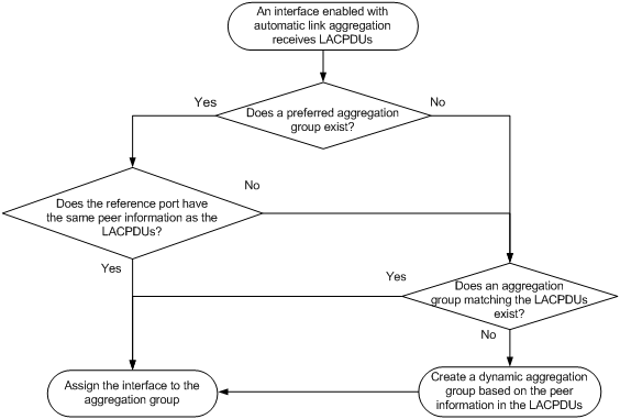

Automatic member interface assignment
As shown in Figure 3, an interface enabled with automatic assignment joins a dynamic aggregation group based on the peer information in the LACPDUs received from the aggregation peer. If none of the existing dynamic aggregation groups is qualified, the device automatically creates a new dynamic aggregation group, Then, the device assigns the interface to that group and synchronizes the interface's attribute configurations to the aggregate interface.
A dynamic aggregation group that contains automatically assigned member ports selects a reference port and Selected ports as described in "How dynamic link aggregation works." The assignment methods of member ports do not change the processes of reference port selection and Selected port selection.
Figure 3 Automatic member interface assignment process
Automatic link aggregation
Automatic link aggregation enables two devices to automatically create a dynamic link aggregation between them by using LLDP.
After you enable automatic link aggregation and LLDP on two connected devices, they automatically establish a dynamic link aggregation based on the information in incoming LLDP frames. The devices each automatically create a dynamic aggregate interface and assign the redundant ports connected to the peer to the aggregation group of that interface. When assigning the first member port to the aggregate group, the device synchronizes the member port's attribute configuration to the aggregate interface.
After the reference port is chosen, the system with the smaller system ID sets the state of each member port on its side.
Figure 4 Setting the state of a member port in a dynamic aggregation group
The system with the greater system ID can detect the aggregation state changes on the peer system. The system with the greater system ID sets the aggregation state of local member ports the same as their peer ports.

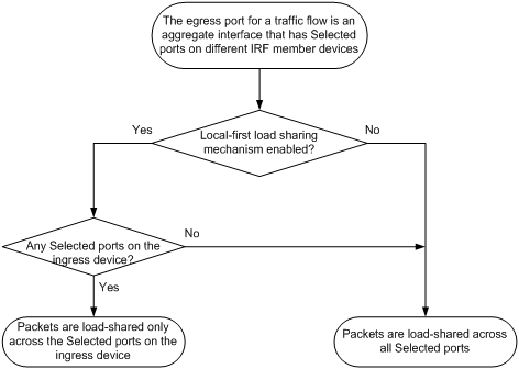

Load sharing modes for link aggregation groups
In a link aggregation group, traffic can be load shared across the Selected ports based on any of the following modes:
·     Per-flow load sharing—Distributes traffic on a per-flow basis. The load sharing mode classifies packets into flows and forwards packets of the same flow on the same link. This mode can be one or any combination of the following traffic classification criteria:
¡     Ingress port.
¡     Source or destination IP address.
¡     Source or destination MAC address.
¡     Source or destination port number.
¡     MPLS label.
·     Packet type-based load sharing—Distributes traffic automatically based on packet types (Layer 2 protocol, IPv4, MPLS, or IPv6).
If the source or destination MAC address criterion is specified, the device automatically takes the VLAN tag into account when it distributes traffic across the Selected ports.

Configuring automatic link aggregation
Overview
On a SmartMC network, you can use automatic link aggregation to aggregate the redundant physical links between devices to ease management and increase bandwidth and availability. For more information about SmartMC, see Network Management and Monitoring Configuration Guide.
On an interface, the port link-aggregation group setting takes precedence over automatic link aggregation. The interface will not be added to the aggregation group of an automatically created aggregate interface if it has been the member port of a manually created aggregate interface.
When automatic link aggregation is enabled, subinterface creation might fail on LLDP-enabled Layer 3 Ethernet interfaces.
As a best practice to ensure correct operation of dynamic aggregation groups, do not use automatic link aggregation and automatic member port assignment together.
Configuration prerequisites
Before you configure automatic link aggregation, enable LLDP on the peer devices.

Enabling local-first load sharing for link aggregation
Overview
Use local-first load sharing in a multichassis link aggregation scenario to distribute traffic preferentially across member ports on the ingress card or device.
When you aggregate ports on different member devices in an IRF fabric, you can use local-first load sharing to reduce traffic on IRF links, as shown in Figure 6. For more information about IRF, see Virtual Technologies Configuration Guide.
This feature takes effect only on known unicast traffic.
Figure 6 Load sharing for multichassis link aggregation in an IRF fabric
This feature is available only in IRF mode.
To perform local-first load sharing on an aggregation, you must configure local-first load sharing both globally and on the aggregate interface.
Configuration procedure
Step
Remarks
N/A
2.     Enable local-first load sharing for link aggregation globally.
link-aggregation load-sharing mode local-first
By default, local-first load sharing is globally enabled for link aggregation.
3.     Enter aggregate interface  view.
·     Enter Layer 2 aggregate interface view:
·     Enter Layer 3 aggregate interface view:
interface route-aggregation interface-number
N/A
4.     Enable local-first load sharing on the aggregate interface.
link-aggregation group load-sharing mode local-first
By default, local-first load sharing is not configured on aggregate interfaces.

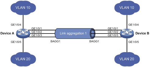

Ethernet link aggregation configuration examples
Layer 2 static aggregation configuration example
Network requirements
On the network shown in Figure 7, perform the following tasks:
·     Configure a Layer 2 static aggregation group on both Device A and Device B.
·     Enable VLAN 10 at one end of the aggregate link to communicate with VLAN 10 at the other end.
·     Enable VLAN 20 at one end of the aggregate link to communicate with VLAN 20 at the other end.
Figure 7 Network diagram
1.     Configure Device A:
# Create VLAN 10, and assign port GigabitEthernet 1/0/4 to VLAN 10.
<DeviceA> system-view
[DeviceA] vlan 10
[DeviceA-vlan10] port gigabitethernet 1/0/4
[DeviceA-vlan10] quit
# Create VLAN 20, and assign port GigabitEthernet 1/0/5 to VLAN 20.
[DeviceA] vlan 20
[DeviceA-vlan20] port gigabitethernet 1/0/5
[DeviceA-vlan20] quit
# Create Layer 2 aggregate interface Bridge-Aggregation 1.
[DeviceA] interface bridge-aggregation 1
[DeviceA-Bridge-Aggregation1] quit
# Assign ports GigabitEthernet 1/0/1 through GigabitEthernet 1/0/3 to link aggregation group 1.
[DeviceA-GigabitEthernet1/0/1] port link-aggregation group 1
[DeviceA-GigabitEthernet1/0/1] quit
[DeviceA] interface gigabitethernet 1/0/2
[DeviceA-GigabitEthernet1/0/2] port link-aggregation group 1
[DeviceA-GigabitEthernet1/0/2] quit
[DeviceA] interface gigabitethernet 1/0/3
[DeviceA-GigabitEthernet1/0/3] port link-aggregation group 1
[DeviceA-GigabitEthernet1/0/3] quit
# Configure Layer 2 aggregate interface Bridge-Aggregation 1 as a trunk port and assign it to VLANs 10 and 20.
[DeviceA-Bridge-Aggregation1] port link-type trunk
[DeviceA-Bridge-Aggregation1] port trunk permit vlan 10 20
2.     Configure Device B in the same way Device A is configured. (Details not shown.)
# Display detailed information about all aggregation groups on Device A.
[DeviceA] display link-aggregation verbose
Loadsharing Type: Shar -- Loadsharing, NonS -- Non-Loadsharing
Port Status: S -- Selected, U -- Unselected, I -- Individual
Port: A -- Auto port, M -- Management port, R -- Reference port
Flags:  A -- LACP_Activity, B -- LACP_Timeout, C -- Aggregation,
        G -- Defaulted, H -- Expired
Aggregate Interface: Bridge-Aggregation1
Aggregation Mode: Static
Management VLANs: None
  Port             Status  Priority Oper-Key
  GE1/0/1(R)       S       32768    1
  GE1/0/2          S       32768    1
  GE1/0/3          S       32768    1
The output shows that link aggregation group 1 is a Layer 2 static aggregation group that contains three Selected ports.

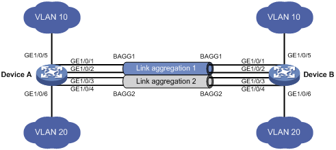

Layer 2 aggregation load sharing configuration example
On the network shown in Figure 9, perform the following tasks:
·     Configure Layer 2 static aggregation groups 1 and 2 on Device A and Device B, respectively.
·     Configure link aggregation groups 1 and 2 to load share traffic across aggregation group member ports.
¡     Configure link aggregation group 1 to load share packets based on source MAC addresses.
¡     Configure link aggregation group 2 to load share packets based on destination MAC addresses.
Figure 9 Network diagram
# Create VLAN 10, and assign the port GigabitEthernet 1/0/5 to VLAN 10.
[DeviceA] vlan 10
[DeviceA-vlan10] port gigabitethernet 1/0/5
# Create VLAN 20, and assign the port GigabitEthernet 1/0/6 to VLAN 20.
[DeviceA] vlan 20
[DeviceA-vlan20] port gigabitethernet 1/0/6
# Configure Layer 2 aggregation group 1 to load share packets based on source MAC addresses.
[DeviceA-Bridge-Aggregation1] link-aggregation load-sharing mode source-mac
# Assign ports GigabitEthernet 1/0/1 and GigabitEthernet 1/0/2 to link aggregation group 1.
# Configure Layer 2 aggregate interface Bridge-Aggregation 1 as a trunk port and assign it to VLAN 10.
# Create Layer 2 aggregate interface Bridge-Aggregation 2.
[DeviceA] interface bridge-aggregation 2
# Configure Layer 2 aggregation group 2 to load share packets based on destination MAC addresses.
[DeviceA-Bridge-Aggregation2] link-aggregation load-sharing mode destination-mac
[DeviceA-Bridge-Aggregation2] quit
# Assign ports GigabitEthernet 1/0/3 and GigabitEthernet 1/0/4 to link aggregation group 2.
[DeviceA-GigabitEthernet1/0/3] port link-aggregation group 2
[DeviceA] interface gigabitethernet 1/0/4
[DeviceA-GigabitEthernet1/0/4] port link-aggregation group 2
[DeviceA-GigabitEthernet1/0/4] quit
# Configure Layer 2 aggregate interface Bridge-Aggregation 2 as a trunk port and assign it to VLAN 20.
[DeviceA-Bridge-Aggregation2] port link-type trunk
[DeviceA-Bridge-Aggregation2] port trunk permit vlan 20
  GE1/0/2          S       32768    1
Aggregate Interface: Bridge-Aggregation2
  GE1/0/3(R)       S       32768    2
  GE1/0/4          S       32768    2
The output shows that:
·     Link aggregation groups 1 and 2 are both load-shared Layer 2 static aggregation groups.
·     Each aggregation group contains two Selected ports.
# Display all the group-specific load sharing modes on Device A.
[DeviceA] display link-aggregation load-sharing mode interface
Bridge-Aggregation1 Load-Sharing Mode:
source-mac address
Bridge-Aggregation2 Load-Sharing Mode:
destination-mac address
·     Link aggregation group 1 distributes packets based on source MAC addresses.
·     Link aggregation group 2 distributes packets based on destination MAC addresses.
