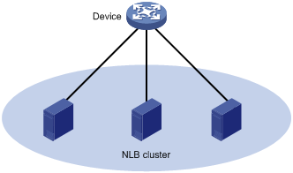

Adding or modifying a multiport unicast MAC address entry
You can configure a multiport unicast MAC address entry to associate a unicast destination MAC address with multiple ports. The frame with a destination MAC address matching the entry is sent out of multiple ports.
For example, in NLB unicast mode (see Figure 1):
·     All servers within a cluster uses the cluster's MAC address as their own address.
·     Frames destined for the cluster are forwarded to every server in the group.
In this case, you can configure a multiport unicast MAC address entry on the device connected to the server group. Then, the device forwards the frame destined for the server group to every server through all ports connected to the servers within the cluster.
Figure 1 NLB cluster
You can configure a multiport unicast MAC address entry globally or on an interface.
Configuring a multiport unicast MAC address entry globally
Step
Remarks
N/A
2.     Add or modify a multiport unicast MAC address entry.
mac-address multiport mac-address interface interface-list vlan vlan-id
By default, no multiport unicast MAC address entry is configured globally.
Make sure you have created the VLAN and assigned the interface to the VLAN.
Configuring a multiport unicast MAC address entry on an interface
Step
Remarks
N/A
2.     Enter interface view.
·     Enter Layer 2 Ethernet interface view:
·     Enter Layer 2 aggregate interface view:
N/A
3.     Add the interface to a multiport unicast MAC address entry.
mac-address multiport mac-address vlan vlan-id
By default, no multiport unicast MAC address entry is configured on the interface.

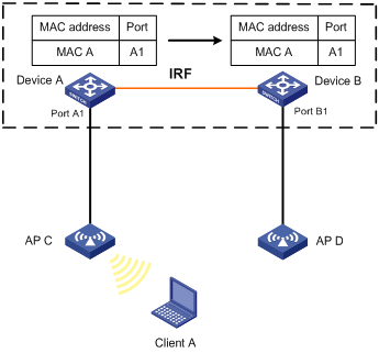

As shown in Figure 2:
·     Device A and Device B form an IRF fabric enabled with MAC address synchronization.
·     Device A and Device B connect to AP C and AP D, respectively.
When Client A associates with AP C, Device A learns a MAC address entry for Client A and advertises it to Device B.
Figure 2 MAC address tables of devices when Client A accesses AP C

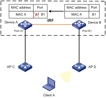

When Client A roams to AP D, Device B learns a MAC address entry for Client A. Device B advertises it to Device A to ensure service continuity for Client A, as shown in Figure 3.
Figure 3 MAC address tables of devices when Client A roams to AP D

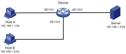

MAC address table configuration example
Network requirements
As shown in Figure 5:
·     Host A at MAC address 000f-e235-dc71 is connected to GigabitEthernet 1/0/1 of Device and belongs to VLAN 1.
·     Host B at MAC address 000f-e235-abcd, which behaved suspiciously on the network, also belongs to VLAN 1.
Configure the MAC address table as follows:
·     To prevent MAC address spoofing, add a static entry for Host A in the MAC address table of Device.
·     To drop all frames destined for Host B, add a blackhole MAC address entry for Host B.
·     Set the aging timer to 500 seconds for dynamic MAC address entries.
Figure 5 Network diagram
Configuration procedure
# Add a static MAC address entry for MAC address 000f-e235-dc71 on GigabitEthernet 1/0/1 that belongs to VLAN 1.
<Device> system-view
[Device] mac-address static 000f-e235-dc71 interface gigabitethernet 1/0/1 vlan 1
# Add a blackhole MAC address entry for MAC address 000f-e235-abcd that belongs to VLAN 1.
[Device] mac-address blackhole 000f-e235-abcd vlan 1
# Set the aging timer to 500 seconds for dynamic MAC address entries.
[Device] mac-address timer aging 500
# Display the static MAC address entries for GigabitEthernet 1/0/1.
[Device] display mac-address static interface gigabitethernet 1/0/1
MAC Address      VLAN ID    State            Port/Nickname            Aging
000f-e235-dc71   1          Static           GE1/0/1                  N
# Display the blackhole MAC address entries.
[Device] display mac-address blackhole
000f-e235-abcd   1          Blackhole        N/A                      N
# Display the aging time of dynamic MAC address entries.
[Device] display mac-address aging-time
MAC address aging time: 500s.
