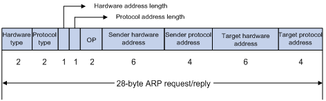

ARP uses two types of messages: ARP request and ARP reply. Figure 1 shows the format of ARP request/reply messages. Numbers in the figure refer to field lengths.
Figure 1 ARP message format
·     Hardware type—Hardware address type. The value 1 represents Ethernet.
·     Protocol type—Type of the protocol address to be mapped. The hexadecimal value 0x0800 represents IP.
·     Hardware address length and protocol address length—Length, in bytes, of a hardware address and a protocol address. For an Ethernet address, the value of the hardware address length field is 6. For an IPv4 address, the value of the protocol address length field is 4.
·     OP—Operation code, which describes the type of ARP message. The value 1 represents an ARP request, and the value 2 represents an ARP reply.
·     Sender hardware address—Hardware address of the device sending the message.
·     Sender protocol address—Protocol address of the device sending the message.
·     Target hardware address—Hardware address of the device to which the message is being sent.
·     Target protocol address—Protocol address of the device to which the message is being sent.

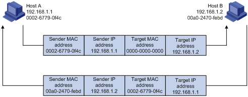

As shown in Figure 2, Host A and Host B are on the same subnet. Host A sends a packet to Host B as follows:
1.     Host A looks through the ARP table for an ARP entry for Host B. If one entry is found, Host A uses the MAC address in the entry to encapsulate the IP packet into a data link layer frame. Then Host A sends the frame to Host B.
2.     If Host A finds no entry for Host B, Host A buffers the packet and broadcasts an ARP request. The payload of the ARP request contains the following information:
¡     Sender IP address and sender MAC address—Host A's IP address and MAC address.
¡     Target IP address—Host B's IP address.
¡     Target MAC address—An all-zero MAC address.
All hosts on this subnet can receive the broadcast request, but only the requested host (Host B) processes the request.
3.     Host B compares its own IP address with the target IP address in the ARP request. If they are the same, Host B operates as follows:
a.     Adds the sender IP address and sender MAC address into its ARP table.
b.     Encapsulates its MAC address into an ARP reply.
c.     Unicasts the ARP reply to Host A.
4.     After receiving the ARP reply, Host A operates as follows:
a.     Adds the MAC address of Host B into its ARP table.
b.     Encapsulates the MAC address into the packet and sends the packet to Host B.
Figure 2 ARP address resolution process

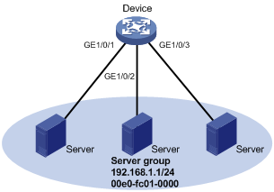

·     Multiport ARP entry—It contains the IP address, MAC address, and VLAN.
The device can use a multiport ARP entry that has the same MAC address and VLAN as a multicast or multiport unicast MAC address entry for packet forwarding. A multiport ARP entry is manually configured. It does not age out and cannot be overwritten by any dynamic ARP entry. For more information about multicast MAC, see IP Multicast Configuration Guide.

Multiport ARP entry configuration example
Network requirements
As shown in Figure 5, a device connects to three servers through interfaces GigabitEthernet 1/0/1, GigabitEthernet 1/0/2, and GigabitEthernet 1/0/3 in VLAN 10. The servers share the IP address 192.168.1.1/24 and MAC address 00e0-fc01-0000.
Configure a multiport ARP entry so that the device sends IP packets with the destination IP address 192.168.1.1 to the three servers.
Figure 5 Network diagram
Configuration procedure
# Create VLAN 10.
<Device> system-view
[Device] vlan 10
[Device-vlan10] quit
# Add GigabitEthernet 1/0/1, GigabitEthernet 1/0/2, and GigabitEthernet 1/0/3 to VLAN 10.
[Device-GigabitEthernet1/0/1] port access vlan 10
[Device] interface gigabitethernet 1/0/2
[Device-GigabitEthernet1/0/2] port access vlan 10
[Device-GigabitEthernet1/0/2] quit
[Device] interface gigabitethernet 1/0/3
[Device-GigabitEthernet1/0/3] port access vlan 10
[Device-GigabitEthernet1/0/3] quit
# Create VLAN-interface 10 and specify its IP address.
[Device] interface vlan-interface 10
[Device-vlan-interface10] ip address 192.168.1.2 24
[Device-vlan-interface10] quit
# Configure a multiport unicast MAC address entry that has MAC address 00e0-fc01-0000, and output interfaces GigabitEthernet 1/0/1, GigabitEthernet 1/0/2, and GigabitEthernet 1/0/3 in VLAN 10.
[Device] mac-address multiport 00e0-fc01-0000 interface gigabitethernet 1/0/1 to gigabitethernet 1/0/3 vlan 10
# Configure a multiport ARP entry with IP address 192.168.1.1 and MAC address 00e0-fc01-0000.
[Device] arp multiport 192.168.1.1 00e0-fc01-0000 10
# Verify that the device has a multiport ARP entry with IP address 192.168.1.1 and MAC address 00e0-fc01-0000.
[Device] display arp
  Type: S-Static   D-Dynamic   O-Openflow   R-Rule   M-Multiport  I-Invalid
IP address      MAC address    VLAN/VSI   Interface                Aging Type
192.168.1.1     00e0-fc01-0000 10         --                       --    M

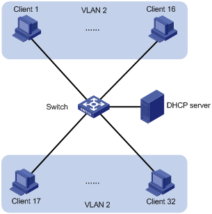

As shown in Figure 7, all clients are in VLAN 2, and access the network through the switch. They have obtained IP addresses through DHCP.
Enable ARP snooping and ARP fast-reply for VLAN 2. The switch directly returns an ARP reply without broadcasting received ARP requests in the VLAN.
Figure 7 Network diagram
# Enable ARP snooping for VLAN 2 on the switch.
<Switch> system-view
[Switch] vlan 2
[Switch-vlan2] arp snooping enable
# Enable ARP fast-reply for VLAN 2 on the switch.
[Switch-vlan2] arp fast-reply enable
[Switch-vlan2] quit

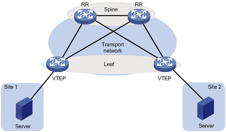

The ARP direct route advertisement feature advertises host routes instead of advertising the network route.
Cooperation with BGP
As shown in Figure 8, this feature can cooperate with BGP in an EVPN network. The Layer 3 Ethernet interfaces that directly connect a leaf node and a spine node borrow IP addresses with the subnet mask 255.255.255.255, for example, from loopback interfaces. For communication, the leaf node and the spine node learn the ARP entry of each other through LLDP.
Because the IP addresses of the interfaces that directly connect the spine node and the leaf node belong to different subnets, one node does not have the direct route to the other node. If BGP is used to transmit underlay network routes, BGP cannot perform correct route recursion. To resolve this problem, enable ARP direct route advertisement on the Layer 3 Ethernet interfaces that directly connect the spine node and the leaf node. One node generates a direct route to the other node and BGP can perform correct route recursion.
For information about EVPN, see EVPN Configuration Guide. For information about LLDP, see Layer 2—LAN Switching Configuration Guide. For information about BGP, see Layer 3—IP Routing Configuration Guide.
Figure 8 ARP direct route with BGP

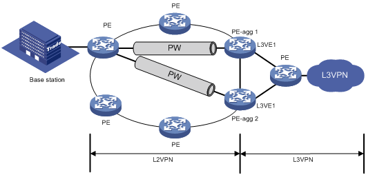

Application in L2VPN access to L3VPN networks
As shown in Figure 9, the ARP direct route feature is configured on PE-aggs to advertise host routes to the connected PEs in the L3VPN.
The PE in the L3VPN has ECMP routes destined to a base station in the L2VPN. Traffic from the PE in the L3VPN to the base station can be load shared by PE-agg 1 and PE-agg 2. If PE-agg 1 fails, the PE uses the host route through PE-agg 2 to forward traffic.
For information about L2VPN access to L3VPN, see MPLS Configuration Guide.
Figure 9 Typical application
