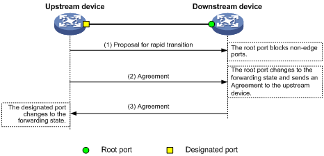

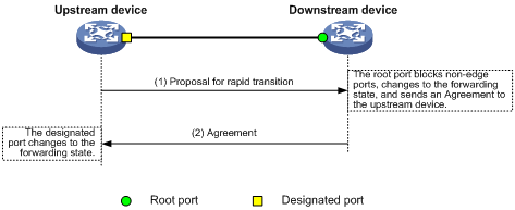

RSTP achieves rapid network convergence by allowing a newly elected root port or designated port to enter the forwarding state much faster under certain conditions than STP.
A newly elected RSTP root port rapidly enters the forwarding state if the old root port on the device has stopped forwarding data and the upstream designated port has started forwarding data.
A newly elected RSTP designated port rapidly enters the forwarding state if it is an edge port or it connects to a point-to-point link. Edge ports directly enter the forwarding state. Connecting to a point-to-point link, a designated port enters the forwarding state immediately after the device receives a handshake response from the directly connected device.

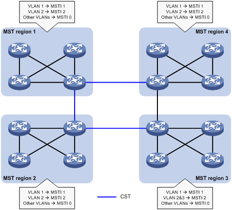

Figure 4 shows a switched network that comprises four MST regions, each MST region comprising four MSTP devices. Figure 5 shows the networking topology of MST region 3. This section describes some basic concepts of MSTP.
Figure 4 Basic concepts in MSTP

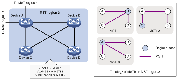

Figure 5 Network diagram and topology of MST region 3

MSTI

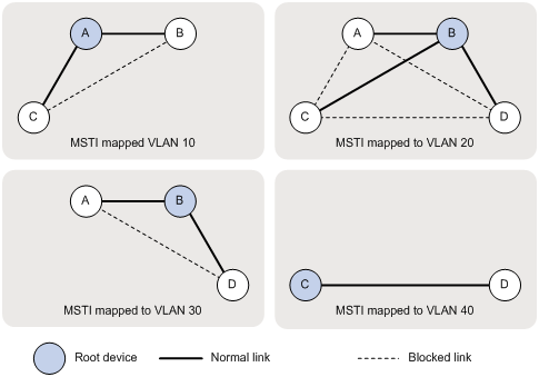

MSTP can generate multiple spanning trees in an MST region, and each spanning tree is independent of another and maps to specific VLANs. Each spanning tree is referred to as a multiple spanning tree instance (MSTI).
In Figure 5, MST region 3 comprises three MSTIs, MSTI 1, MSTI 2, and MSTI 0.
VLAN-to-instance mapping table
As an attribute of an MST region, the VLAN-to-instance mapping table describes the mapping relationships between VLANs and MSTIs.
In Figure 5, the VLAN-to-instance mapping table of MST region 3 is: VLAN 1 to MSTI 1, VLAN 2 and VLAN 3 to MSTI 2, and other VLANs to MSTI 0. MSTP achieves load balancing by means of the VLAN-to-instance mapping table.
CST
The common spanning tree (CST) is a single spanning tree that connects all MST regions in a switched network. If you regard each MST region as a device, the CST is a spanning tree calculated by these devices through STP or RSTP.
The blue lines in Figure 4 represent the CST.

CIST
The common and internal spanning tree (CIST) is a single spanning tree that connects all devices in a switched network. It consists of the ISTs in all MST regions and the CST.
In Figure 4, the ISTs (MSTI 0) in all MST regions plus the inter-region CST constitute the CIST of the entire network.
Regional root
The root bridge of the IST or an MSTI within an MST region is the regional root of the IST or MSTI. Based on the topology, different spanning trees in an MST region may have different regional roots.
For example, in MST region 3 in Figure 5, the regional root of MSTI 1 is Device B, the regional root of MSTI 2 is Device C, and the regional root of MSTI 0 (also known as the IST) is Device A.

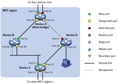

Port roles
A port can play different roles in different MSTIs. As shown in Figure 6, an MST region comprises Device A, Device B, Device C, and Device D. Port A1 and port A2 of Device A connect to the common root bridge. Port B2 and Port B3 of Device B form a loop. Port C3 and Port C4 of Device C connect to other MST regions. Port D3 of Device D directly connects to a host.
Figure 6 Port roles
MSTP calculation involves these port roles:
·          Root port: Forwards data for a non-root bridge to the root bridge. The root bridge does not have any root port.
·          Designated port: Forwards data to the downstream network segment or device.
·          Alternate port: The backup port for a root port or master port. When the root port or master port is blocked, the alternate port takes over.
·          Backup port: The backup port of a designated port. When the designated port is invalid, the backup port becomes the new designated port. A loop occurs when two ports of the same spanning tree device are interconnected, so the device blocks one of the ports. The blocked port acts as the backup.
·          Edge port: An edge port does not connect to any network device or network segment, but directly connects to a user host.
·          Master port: A port on the shortest path from the local MST region to the common root bridge. The master port is not always located on the regional root. It is a root port on the IST or CIST and still a master port on the other MSTIs.
·          Boundary port: Connects an MST region to another MST region or to an STP/RSTP-running device. In MSTP calculation, a boundary port’s role on an MSTI is consistent with its role on the CIST. But that is not true with master ports. A master port on MSTIs is a root port on the CIST.

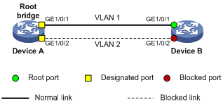

Figure 7 VLAN connectivity blocked by MSTP
As shown in Figure 7:
·          Port A1 on Device A allows the traffic of VLAN 1 to pass through, and Port A2 allows the traffic of VLAN 2 to pass through.
·          Port B1 on Device B allows the traffic of VLAN 1 to pass through, and Port B2 allows the traffic of VLAN 2 to pass through.
·          Device A and Device B run a spanning tree protocol. Device A is the root bridge, and Port A1 and Port A2 are designated ports. On Device B, Port B1 is the root port, and port B2 is the blocked port. Traffic of VLAN 2 is blocked.
·          Enabling the VLAN Ignore feature for a VLAN can make ports of the VLAN forward packets normally rather than comply with the spanning tree calculation result.

Figure 10 shows the rapid state transition mechanism on MSTP designated ports.
Figure 10 Rapid state transition of an MSTP designated port
Figure 11 shows rapid state transition of an RSTP designated port.
Figure 11 Rapid state transition of an RSTP designated port

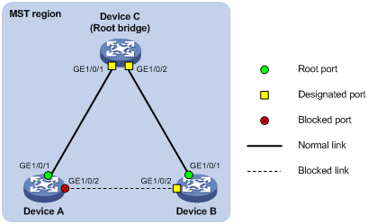

1.        Network requirements
As shown in Figure 12:
·          Device A connects to a third-party device that has a different spanning tree implementation. Both devices are in the same region.
·          The third-party device (Device B) is the regional root bridge, and Device A is the downstream device.
Figure 12 No Agreement Check configuration

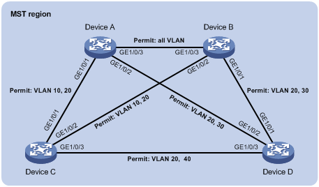

As shown in Figure 13:
·          All devices on the network are in the same MST region. Device A and Device B work at the distribution layer. Device C and Device D work at the access layer.
·          Configure MSTP so that packets of different VLANs are forwarded along different spanning trees: Packets of VLAN 10 are forwarded along MSTI 1, those of VLAN 30 are forwarded along MSTI 3, those of VLAN 40 are forwarded along MSTI 4, and those of VLAN 20 are forwarded along MSTI 0.
·          VLAN 10 and VLAN 30 are terminated on the distribution layer devices, and VLAN 40 is terminated on the access layer devices, so the root bridges of MSTI 1 and MSTI 3 are Device A and Device B respectively, and the root bridge of MSTI 4 is Device C.
Figure 13 Network diagram for MSTP configuration
Configuration procedure
1.        VLAN and VLAN member port configuration (details not shown)
Create VLAN 10, VLAN 20, and VLAN 30 on Device A and Device B respectively, VLAN 10, VLAN 20, and VLAN 40 on Device C, and VLAN 20, VLAN 30, and VLAN 40 on Device D. Configure the ports on these devices as trunk ports and assign them to related VLANs.

You can use the display stp brief command to display brief spanning tree information on each device after the network is stable.
# Display brief spanning tree information on Device A.
[DeviceA] display stp brief
 MSTID      Port                         Role  STP State     Protection
   0        GigabitEthernet1/0/1         ALTE  DISCARDING    NONE
   0        GigabitEthernet1/0/2         DESI  FORWARDING    NONE
   0        GigabitEthernet1/0/3         ROOT  FORWARDING    NONE
   1        GigabitEthernet1/0/1         DESI  FORWARDING    NONE
   1        GigabitEthernet1/0/3         DESI  FORWARDING    NONE
   3        GigabitEthernet1/0/2         DESI  FORWARDING    NONE
   3        GigabitEthernet1/0/3         ROOT  FORWARDING    NONE
# Display brief spanning tree information on Device B.
[DeviceB] display stp brief
   0        GigabitEthernet1/0/1         DESI  FORWARDING    NONE
   0        GigabitEthernet1/0/3         DESI  FORWARDING    NONE
   1        GigabitEthernet1/0/2         DESI  FORWARDING    NONE
   1        GigabitEthernet1/0/3         ROOT  FORWARDING    NONE
   3        GigabitEthernet1/0/1         DESI  FORWARDING    NONE
   3        GigabitEthernet1/0/3         DESI  FORWARDING    NONE
# Display brief spanning tree information on Device C.
[DeviceC] display stp brief
   0        GigabitEthernet1/0/2         ROOT  FORWARDING    NONE
   1        GigabitEthernet1/0/1         ROOT  FORWARDING    NONE
   1        GigabitEthernet1/0/2         ALTE  DISCARDING    NONE
   4        GigabitEthernet1/0/3         DESI  FORWARDING    NONE
# Display brief spanning tree information on Device D.
[DeviceD] display stp brief
   0        GigabitEthernet1/0/1         ROOT  FORWARDING    NONE
   0        GigabitEthernet1/0/2         ALTE  DISCARDING    NONE
   0        GigabitEthernet1/0/3         ALTE  DISCARDING    NONE
   3        GigabitEthernet1/0/1         ROOT  FORWARDING    NONE
   3        GigabitEthernet1/0/2         ALTE  DISCARDING    NONE
   4        GigabitEthernet1/0/3         ROOT  FORWARDING    NONE
Based on the output, you can draw the MSTI mapped to each VLAN, as shown in Figure 14.
Figure 14 MSTIs mapped to different VLANs
