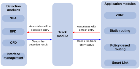

The Track module works between application modules and detection modules, as shown in Figure 1. It shields the differences between various detection modules from application modules.
Collaboration is enabled when you associate the Track module with a detection module and an application module, and it operates as follows:
1.     The detection module probes specific objects such as interface status, link status, network reachability, and network performance, and informs the Track module of detection results.
2.     The Track module sends the detection results to the application module.
3.     When notified of changes for the tracked object, the application modules can react to avoid communication interruption and network performance degradation.
Figure 1 Collaboration through the Track module

The Track module collaborates with detection modules and application modules.
Collaboration between the Track module and a detection module
The detection module sends the detection result of the tracked object to the Track module. The Track module changes the status of the track entry as follows:
·     If the tracked object operates correctly, the state of the track entry is Positive. For example, the track entry state is Positive in one of the following conditions:
¡     The target interface is up.
¡     The target network is reachable.
·     If the tracked object does not operate correctly, the state of the track entry is Negative. For example, the track entry state is Negative in one of the following conditions:
¡     The target interface is down.
¡     The target network is unreachable.
·     If the detection result is not valid, the state of the track entry is NotReady. For example, the track entry state is NotReady if its associated NQA operation does not exist.
The following detection modules can be associated with the Track module:
·     NQA.
·     BFD.
·     CFD.
·     Interface management.
Collaboration between the Track module and an application module
The following application modules can be associated with the Track module:
·     VRRP.
·     Static routing.
·     PBR.
·     Smart Link.
When configuring a track entry for an application module, you can set a notification delay to avoid immediate notification of status changes.
When the delay is not configured and the route convergence is slower than the link state change notification, communication failures occur. For example, when the master in a VRRP group detects an uplink interface failure through the Track module, the Track module immediately notifies the master to decrease its priority. A backup with a higher priority then preempts as the new master. When the failed uplink interface recovers, the Track module immediately notifies the original master to restore its priority. If the uplink route has not recovered, forwarding failure will occur.

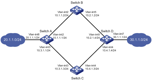

The following is an example of collaboration between NQA, Track, and static routing.
Configure a static route with the next hop 192.168.0.88 on the device. If the next hop is reachable, the static route is valid. If the next hop becomes unreachable, the static route is invalid. For this purpose, configure collaboration between the NQA, track, and static routing modules:
1.     Create an NQA operation to monitor the accessibility of IP address 192.168.0.88.
2.     Create a track entry and associate it with the NQA operation.
¡     When the next hop 192.168.0.88 is reachable, NQA sends the result to the Track module. The Track module sets the track entry to Positive state.
¡     When the next hop becomes unreachable, NQA sends the result to the Track module. The Track module sets the track entry to Negative state.
3.     Associate the track entry with the static route.
¡     When the track entry is in Positive state, the static routing module considers the static route to be valid.
¡     When the track entry is in Negative state, the static routing module considers the static route to be invalid.

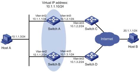

VRRP-Track-NQA collaboration configuration example
Network requirements
As shown in Figure 2:
·     Host A requires access to Host B. The default gateway of Host A is 10.1.1.10/24.
·     Switch A and Switch B belong to VRRP group 1. The virtual IP address of VRRP group 1 is 10.1.1.10.
Configure VRRP-Track-NQA collaboration to monitor the uplink on the master and meet the following requirements:
·     When Switch A operates correctly, it forwards packets from Host A to Host B.
·     When NQA detects a fault on the uplink of Switch A, Switch B forwards packets from Host A to Host B.
Figure 2 Network diagram
Configuration procedure
1.     Create VLANs and assign ports to them. Configure the IP address of each VLAN interface as shown in Figure 2. (Details not shown.)
2.     Configure an NQA operation on Switch A:
# Create an NQA operation with the administrator name admin and the operation tag test.
<SwitchA> system-view
[SwitchA] nqa entry admin test
# Configure the operation type as ICMP echo.
[SwitchA-nqa-admin-test] type icmp-echo
# Configure the destination address of ICMP echo requests as 10.1.2.2.

The output shows that in VRRP group 1, Switch A is the master, and Switch B is a backup. Switch A forwards packets from Host A to Host B.
# Disconnect the link between Switch A and Switch C, and verify that Host A can still ping Host B. (Details not shown.)
# Display detailed information about VRRP group 1 on Switch A.
IPv4 Virtual Router Information:
 Running Mode      : Standard
 Total number of virtual routers : 1
   Interface Vlan-interface2
     VRID           : 1               Adver Timer  : 500
     Admin Status   : Up              State        : Backup
     Config Pri     : 110             Running Pri  : 80
     Preempt Mode   : Yes             Delay Time   : 500
     Become Master  : 2200ms left
     Auth Type      : Simple          Key          : ******
     Virtual IP     : 10.1.1.10
     Master IP      : 10.1.1.2
   VRRP Track Information:
     Track Object   : 1              State : Negative          Pri Reduced : 30
# Display detailed information about VRRP group 1 on Switch B.
[SwitchB-Vlan-interface2] display vrrp verbose
     Admin Status   : Up              State        : Master
     Config Pri     : 100             Running Pri  : 100
     Virtual MAC    : 0000-5e00-0101
The output shows that Switch A becomes the backup, and Switch B becomes the master. Switch B forwards packets from Host A to Host B.

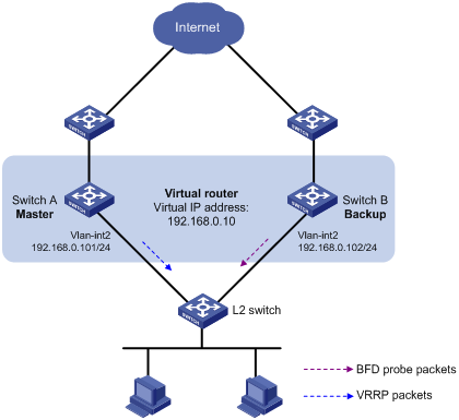

Configuring BFD for a VRRP backup to monitor the master
As shown in Figure 3:
·     Switch A and Switch B belong to VRRP group 1. The virtual IP address of VRRP group 1 is 192.168.0.10.
·     The default gateway of the hosts in the LAN is 192.168.0.10.
Configure VRRP-Track-BFD collaboration to monitor the master on the backup and meet the following requirements:
·     When Switch A operates correctly, the hosts in the LAN access the Internet through Switch A.
·     When Switch A fails, the backup (Switch B) can quickly detect the state change of the master through BFD and become the new master. The hosts in the LAN access the Internet through Switch B.

The output shows that when the status of the track entry becomes Positive, Switch A is the master and Switch B is the backup.
# Enable VRRP state debugging and BFD event notification debugging on Switch B.
<SwitchB> terminal debugging
<SwitchB> terminal monitor
<SwitchB> debugging vrrp fsm
<SwitchB> debugging bfd ntfy
# When Switch A fails, the following output is displayed on Switch B.
*Dec 17 14:44:34:142 2013 SwitchB BFD/7/DEBUG: Notify application:TRACK State:DOWN
*Dec 17 14:44:34:144 2013 SwitchB VRRP4/7/FSM:
 IPv4 Vlan-interface2 | Virtual Router 1 : Backup --> Master   reason: The status of the tracked object changed
# Display detailed information about the VRRP group on Switch B.
<SwitchB> display vrrp verbose
     VRID           : 1               Adver Timer  : 100
     Preempt Mode   : Yes             Delay Time   : 0
     Auth Type      : None
     Virtual IP     : 192.168.0.10
     Master IP      : 192.168.0.102
     Track Object   : 1              State : Negative          Switchover
The output shows that when BFD detects that Switch A fails, the Track module notifies VRRP to change the status of Switch B to master. The backup can quickly preempt as the master without waiting for a period three times the advertisement interval plus the Skew_Time.

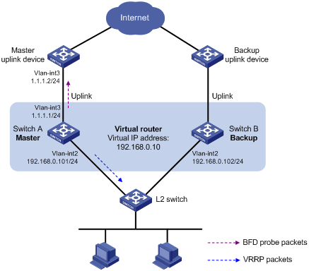

Configuring BFD for the VRRP master to monitor the uplinks
As shown in Figure 4:
Configure VRRP-Track-BFD collaboration to monitor the uplink on the master and meet the following requirements:
·     When Switch A detects that the uplink is down through BFD, Switch B can preempt as the master. The hosts in the LAN can access the Internet through Switch B.
1.     Create VLANs and assign ports to them. Configure the IP address of each VLAN interface as shown in Figure 4. (Details not shown.)
2.     Configure Switch A:
# Configure the source address of BFD echo packets as 10.10.10.10.
[SwitchA] bfd echo-source-ip 10.10.10.10
# Create track entry 1 for the BFD session to verify the reachability of the uplink device (1.1.1.2 ).
[SwitchA] track 1 bfd echo interface vlan-interface 3 remote ip 1.1.1.2 local ip 1.1.1.1
# Create VRRP group 1, and configure the virtual IP address of the group as 192.168.0.10.
[SwitchA-Vlan-interface2] vrrp vrid 1 virtual-ip 192.168.0.10
# Set the priority of Switch A to 110 in VRRP group 1.
[SwitchA-Vlan-interface2] vrrp vrid 1 priority 110
# Associate VRRP group 1 with track entry 1 and decrease the router priority by 20 when the state of track entry 1 changes to negative.
 [SwitchA-Vlan-interface2] vrrp vrid 1 track 1 priority reduced 20
[SwitchA-Vlan-interface2] return
3.     On Switch B, create VRRP group 1, and configure the virtual IP address of the group as 192.168.0.10.
<SwitchB> system-view
[SwitchB-Vlan-interface2] vrrp vrid 1 virtual-ip 192.168.0.10
[SwitchB-Vlan-interface2] return
# Display detailed information about the VRRP group on Switch A.
<SwitchA> display vrrp verbose
     Config Pri     : 110             Running Pri  : 110
     Auth Type      : None
     Master IP      : 192.168.0.101
     Track Object   : 1               State : Positive   Pri Reduced : 20
# Display information about track entry 1 on Switch A.
<SwitchA> display track 1
Track ID: 1
  State: Positive
  Duration: 0 days 0 hours 0 minutes 32 seconds
  Notification delay: Positive 0, Negative 0 (in seconds)
  Tracked object:
    BFD session mode: Echo
    Outgoing interface: Vlan-interface2
    VPN instance name: -
    Remote IP: 1.1.1.2
    Local IP: 1.1.1.1
     Auth Type      : None
The output shows that when the status of track entry 1 becomes Positive, Switch A is the master and Switch B is the backup.
# Display information about track entry 1 when the uplink of Switch A goes down.
Track ID: 1
  State: Negative
  Tracked object:
    Remote IP: 1.1.1.2
    Local IP: 1.1.1.1
     Config Pri     : 110             Running Pri  : 90
     Auth Type      : None
     Track Object   : 1               State : Negative   Pri Reduced : 20
     Auth Type      : None
The output shows that when Switch A detects that the uplink fails through BFD, it decreases its priority by 20. Switch B then preempts as the master.
Static routing-Track-NQA collaboration configuration example
As shown in Figure 5:
·     Switch A is the default gateway of the hosts in subnet 20.1.1.0/24.
·     Switch D is the default gateway of the hosts in subnet 30.1.1.0/24.
·     Hosts in the two subnets communicate with each other through static routes.
To ensure network availability, configure route backup and static routing-Track-NQA collaboration on Switch A and Switch D as follows:
·     On Switch A, assign a higher priority to the static route to 30.1.1.0/24 with Switch B as the next hop. This route is the master route. The static route to 30.1.1.0/24 as the next hop acts as the backup route. When the master route is unavailable, the backup route takes effect. Switch A forwards packets to 30.1.1.0/24 through Switch C.
·     On Switch D, assign a higher priority to the static route to 20.1.1.0/24 with Switch B as the next hop. This route is the master route. The static route to 20.1.1.0/24 with Switch C as the next hop acts as the backup route. When the master route is unavailable, the backup route takes effect. Switch D forwards packets to 20.1.1.0/24 through Switch C.
Figure 5 Network diagram
1.     Create VLANs and assign ports to them. Configure the IP address of each VLAN interface as shown in Figure 5. (Details not shown.)
# Configure a static route to 30.1.1.0/24 with the next hop 10.1.1.2 and the default priority 60. Associate this static route is with track entry 1.
[SwitchA] ip route-static 30.1.1.0 24 10.1.1.2 track 1
# Configure a static route to 30.1.1.0/24 with the next hop 10.3.1.3 and the priority 80.
[SwitchA] ip route-static 30.1.1.0 24 10.3.1.3 preference 80
# Configure a static route to 10.2.1.4 with the next hop 10.1.1.2.
[SwitchA] ip route-static 10.2.1.4 24 10.1.1.2
# Create an NQA operation with the administrator admin and the operation tag test.
# Configure the destination address of the operation as 10.2.1.4 and the next hop address as 10.1.1.2.
[SwitchA-nqa-admin-test-icmp-echo] destination ip 10.2.1.4
[SwitchA-nqa-admin-test-icmp-echo] next-hop 10.1.1.2
# Configure the ICMP echo operation to repeat at an interval of 100 milliseconds.
[SwitchA-nqa-admin-test-icmp-echo] frequency 100
# Configure reaction entry 1, specifying that five consecutive probe failures trigger the Track module.
[SwitchA-nqa-admin-test-icmp-echo] reaction 1 checked-element probe-fail threshold-type consecutive 5 action-type trigger-only
[SwitchA-nqa-admin-test-icmp-echo] quit
# Start the NQA operation.
[SwitchA] nqa schedule admin test start-time now lifetime forever
# Configure track entry 1, and associate it with reaction entry 1 of the NQA operation.
[SwitchA] track 1 nqa entry admin test reaction 1
3.     Configure Switch B:
# Configure a static route to 30.1.1.0/24 with the next hop 10.2.1.4.
[SwitchB] ip route-static 30.1.1.0 24 10.2.1.4
# Configure a static route to 20.1.1.0/24 with the next hop 10.1.1.1.
[SwitchB] ip route-static 20.1.1.0 24 10.1.1.1
4.     Configure Switch C:
# Configure a static route to 30.1.1.0/24 with the next hop 10.4.1.4.
<SwitchC> system-view
[SwitchC] ip route-static 30.1.1.0 24 10.4.1.4
# Configure a static route to 20.1.1.0/24 with the next hop 10.3.1.1.
[SwitchC] ip route-static 20.1.1.0 24 10.3.1.1
5.     Configure Switch D:
# Configure a static route to 20.1.1.0/24 with the next hop 10.2.1.2 and the default priority 60. Associate this static route with track entry 1.
<SwitchD> system-view
[SwitchD] ip route-static 20.1.1.0 24 10.2.1.2 track 1
# Configure a static route to 20.1.1.0/24 with the next hop 10.4.1.3 and the priority 80.
[SwitchD] ip route-static 20.1.1.0 24 10.4.1.3 preference 80
# Configure a static route to 10.1.1.1, with the next hop 10.2.1.2.
[SwitchD] ip route-static 10.1.1.1 24 10.2.1.2
[SwitchD] nqa entry admin test
[SwitchD-nqa-admin-test] type icmp-echo
# Configure the destination address of the operation as 10.1.1.1 and the next hop address as 10.2.1.2.
[SwitchD-nqa-admin-test-icmp-echo] destination ip 10.1.1.1
[SwitchD-nqa-admin-test-icmp-echo] next-hop 10.2.1.2
[SwitchD-nqa-admin-test-icmp-echo] frequency 100
[SwitchD-nqa-admin-test-icmp-echo] reaction 1 checked-element probe-fail threshold-type consecutive 5 action-type trigger-only
[SwitchD-nqa-admin-test-icmp-echo] quit
[SwitchD] nqa schedule admin test start-time now lifetime forever
[SwitchD] track 1 nqa entry admin test reaction 1
# Display information about the track entry on Switch A.
[SwitchA] display track all
Track ID: 1
  State: Positive
  Tracked object:
    NQA entry: admin test
    Reaction: 1
The output shows that the status of the track entry is Positive, indicating that the NQA operation has succeeded and the master route is available.
# Display the routing table of Switch A.
[SwitchA] display ip routing-table
Destinations : 10       Routes : 10
10.1.1.0/24         Direct 0    0            10.1.1.1        Vlan2
10.1.1.1/32         Direct 0    0            127.0.0.1       InLoop0
10.2.1.0/24         Static 60   0            10.1.1.2        Vlan2
10.3.1.0/24         Direct 0    0            10.3.1.1        Vlan3
10.3.1.1/32         Direct 0    0            127.0.0.1       InLoop0
20.1.1.0/24         Direct 0    0            20.1.1.1        Vlan6
20.1.1.1/32         Direct 0    0            127.0.0.1       InLoop0
30.1.1.0/24         Static 60   0            10.1.1.2        Vlan2
127.0.0.0/8         Direct 0    0            127.0.0.1       InLoop0
127.0.0.1/32        Direct 0    0            127.0.0.1       InLoop0
The output shows that Switch A forwards packets to 30.1.1.0/24 through Switch B.

·     On Switch B, assign a higher priority to the static route to 20.1.1.0/24 with Switch A as the next hop. This route is the master route. The static route to 20.1.1.0/24 with Switch C as the next hop acts as the backup route. When the master route is unavailable, BFD can quickly detect the route failure to make the backup route take effect.
Figure 6 Network diagram
1.     Create VLANs and assign ports to them. Configure the IP address of each VLAN interface as shown in Figure 6. (Details not shown.)
# Configure a static route to 30.1.1.0/24 with the next hop 10.2.1.2 and the default priority 60, and associate this static route with track entry 1.
[SwitchA] ip route-static 30.1.1.0 24 10.2.1.2 track 1
# Configure track entry 1, and associate it with the BFD session to verify the connectivity between Switch A and Switch B.
[SwitchA] track 1 bfd echo interface vlan-interface 2 remote ip 10.2.1.2 local ip 10.2.1.1
# Configure a static route to 20.1.1.0/24, with the next hop 10.2.1.1 and the default priority 60, and associate this static route with track entry 1.
[SwitchB] ip route-static 20.1.1.0 24 10.2.1.1 track 1
[SwitchB] ip route-static 20.1.1.0 24 10.4.1.3 preference 80
# Configure the source address of BFD echo packets as 1.1.1.1.
[SwitchB] bfd echo-source-ip 1.1.1.1
# Configure track entry 1, and associate it with the BFD session to verify the connectivity between Switch B and Switch A.
[SwitchB] track 1 bfd echo interface vlan-interface 2 remote ip 10.2.1.1 local ip 10.2.1.2
# Configure a static route to 30.1.1.0/24 with the next hop 10.4.1.2.
[SwitchC] ip route-static 30.1.1.0 24 10.4.1.2
[SwitchB] ip route-static 20.1.1.0 24 10.3.1.1
Track ID: 1
  State: Positive
  Tracked object:
    Remote IP: 10.2.1.2
    Local IP: 10.2.1.1
The output shows that the status of the track entry is Positive, indicating that the next hop 10.2.1.2 is reachable.
Destinations : 9        Routes : 9
10.2.1.0/24         Direct 0    0            10.2.1.1        Vlan2
10.2.1.1/32         Direct 0    0            127.0.0.1       InLoop0
20.1.1.0/24         Direct 0    0            20.1.1.1        Vlan5
30.1.1.0/24         Static 60   0            10.2.1.2        Vlan2
The output shows that Switch A forwards packets to 30.1.1.0/24 through Switch B. The master static route has taken effect.
# Remove the IP address of VLAN-interface 2 on Switch B.
[SwitchB-Vlan-interface2] undo ip address
Track ID: 1
  State: Negative
  Tracked object:
    Remote IP: 10.2.1.2
    Local IP: 10.2.1.1
The output shows that the status of the track entry is Negative, indicating that the next hop 10.2.1.2 is unreachable.
30.1.1.0/24         Static 80   0            10.3.1.3        Vlan3
The output shows that Switch A forwards packets to 30.1.1.0/24 through Switch C and Switch B. The backup static route has taken effect.
# Verify that the hosts in 20.1.1.0/24 can communicate with the hosts in 30.1.1.0/24 when the master route fails.
[SwitchA] ping -a 20.1.1.1 30.1.1.1
Ping 30.1.1.1: 56  data bytes, press CTRL_C to break
Reply from 30.1.1.1: bytes=56 Sequence=1 ttl=254 time=2 ms
Reply from 30.1.1.1: bytes=56 Sequence=2 ttl=254 time=1 ms
Reply from 30.1.1.1: bytes=56 Sequence=3 ttl=254 time=1 ms
Reply from 30.1.1.1: bytes=56 Sequence=4 ttl=254 time=2 ms
Reply from 30.1.1.1: bytes=56 Sequence=5 ttl=254 time=1 ms
--- Ping statistics for 30.1.1.1 ---
5 packet(s) transmitted, 5 packet(s) received, 0.00% packet loss
round-trip min/avg/max/std-dev = 1/1/2/1 ms

VRRP-Track-interface management collaboration configuration example
As shown in Figure 7:
Configure VRRP-Track-interface management collaboration to monitor the uplink interface on the master and meet the following requirements:
·     When VRRP detects a fault on the uplink interface of Switch A through the interface management module, Switch B forwards packets from Host A to Host B.
Figure 7 Network diagram
1.     Create VLANs and assign ports to them. Configure the IP address of each VLAN interface as shown in Figure 7. (Details not shown.)
# Configure track entry 1 and associate it with the link status of the uplink interface VLAN-interface 3.
[SwitchA] track 1 interface vlan-interface 3
# Create VRRP group 1 and configure the virtual IP address 10.1.1.10 for the group.
[SwitchA-Vlan-interface2] vrrp vrid 1 virtual-ip 10.1.1.10
# Associate VRRP group 1 with track entry 1 and decrease the router priority by 30 when the state of track entry 1 changes to negative.
[SwitchA-Vlan-interface2] vrrp vrid 1 track 1 priority reduced 30
3.     On Switch B, create VRRP group 1 and configure the virtual IP address 10.1.1.10 for the group.
[SwitchB-Vlan-interface2] vrrp vrid 1 virtual-ip 10.1.1.10
# Ping Host B from Host A to verify that Host B is reachable. (Details not shown.)
[SwitchA-Vlan-interface2] display vrrp verbose
     Auth Type      : None
     Master IP      : 10.1.1.1
     Track Object   : 1               State : Positive   Pri Reduced : 30
     Auth Type      : None
# Shut down the uplink interface VLAN-interface 3 on Switch A.
[SwitchA-Vlan-interface2] interface vlan-interface 3
[SwitchA-Vlan-interface3] shutdown
[SwitchA-Vlan-interface3] display vrrp verbose
     Auth Type      : None
     Auth Type      : None
