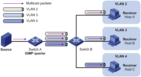

As shown in Figure 1, Host A, Host B, and Host C are in different VLANs and the same multicast group. When Switch A (Layer 3 device) receives multicast data for that group, it sends three copies of the multicast data to Switch B (Layer 2 device). This occupies a large amount of bandwidth and increases the burden on the Layer 3 device.
Figure 1 Multicast transmission without the multicast VLAN feature
After a multicast VLAN is configured on Switch B, Switch A sends only one copy of the multicast data to the multicast VLAN on Switch B. This method saves network bandwidth and lessens the burden on the Layer 3 device.

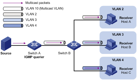

Port-based multicast VLAN
As shown in Figure 3:
·     Host A, Host B, and Host C are in VLAN 2 through VLAN 4, respectively.
·     On Switch B, VLAN 10 is a multicast VLAN.
·     All the user ports (ports with attached hosts) are hybrid ports and assigned to VLAN 10.
·     IGMP snooping is enabled for the multicast VLAN and VLAN 2 through VLAN 4.
Figure 3 Port-based multicast VLAN
IGMP snooping manages the router ports and member ports in the multicast VLAN. When Switch A receives multicast data from the multicast source, it sends only one copy of the multicast data to the multicast VLAN on Switch B. Then, Switch B sends a separate copy to each user port in the multicast VLAN.

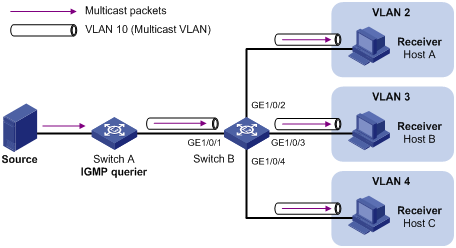

Multicast VLAN configuration examples
Sub-VLAN-based multicast VLAN configuration example
Network requirements
As shown in Figure 4:
·     IGMPv2 runs on Layer 3 device Switch A, and IGMPv2 snooping runs on Layer 2 device Switch B.
·     Switch A acts as the IGMP querier.
·     The multicast source sends multicast data to multicast group 224.1.1.1. Host A, Host B, and Host C are receivers. They belong to VLAN 2 through VLAN 4, respectively.
Configure a sub-VLAN-based multicast VLAN on Switch B to meet the following requirements:
·     Switch A sends the multicast data to Switch B through the multicast VLAN.
·     Switch B forwards the multicast data to the receivers in different user VLANs.
Figure 4 Network diagram
Configure a port-based multicast VLAN on Switch B to meet the following requirements:
·     Switch A sends multicast data to Switch B through the multicast VLAN.
Figure 5 Network diagram
Configuration procedure
1.     Configure Switch A:
# Enable IP multicast routing.
<SwitchA> system-view
[SwitchA] multicast routing
[SwitchA-mrib] quit
# Create VLAN 20, and assign GigabitEthernet 1/0/2 to this VLAN.
[SwitchA] vlan 20
[SwitchA-vlan20] port gigabitethernet 1/0/2
[SwitchA-vlan20] quit
# Assign an IP address to VLAN-interface 20, and enable PIM-DM on this interface.
[SwitchA] interface vlan-interface 20
[SwitchA-Vlan-interface20] ip address 1.1.1.2 24
[SwitchA-Vlan-interface20] pim dm
[SwitchA-Vlan-interface20] quit
# Create VLAN 10, configure GigabitEthernet 1/0/1 as a hybrid port, and assign it to VLAN 10 as a tagged VLAN member.
[SwitchA] vlan 10
[SwitchA-vlan10] quit
[SwitchA] interface gigabitethernet 1/0/1
[SwitchA-GigabitEthernet1/0/1] port link-type hybrid
[SwitchA-GigabitEthernet1/0/1] port hybrid vlan 10 tagged
# Assign an IP address to VLAN-interface 10, and enable IGMP on this interface.
[SwitchA-Vlan-interface10] ip address 10.110.1.1 24
[SwitchA-Vlan-interface10] igmp enable
[SwitchA-Vlan-interface10] quit
2.     Configure Switch B:
# Enable IGMP snooping globally.
<SwitchB> system-view
[SwitchB] igmp-snooping
[SwitchB-igmp-snooping] quit
# Create VLAN 10, assign GigabitEthernet 1/0/1 to VLAN 10, and enable IGMP snooping for this VLAN.
[SwitchB] vlan 10
[SwitchB-vlan10] port gigabitethernet 1/0/1
[SwitchB-vlan10] igmp-snooping enable
[SwitchB-vlan10] quit
# Create VLAN 2, and enable IGMP snooping for the VLAN.
[SwitchB] vlan 2
[SwitchB-vlan2] igmp-snooping enable
[SwitchB-vlan2] quit
# Create VLAN 3, and enable IGMP snooping for the VLAN.
[SwitchB] vlan 3
[SwitchB-vlan3] igmp-snooping enable
[SwitchB-vlan3] quit
# Create VLAN 4, and enable IGMP snooping for the VLAN.
[SwitchB] vlan 4
[SwitchB-vlan4] igmp-snooping enable
[SwitchB-vlan4] quit
# Configure GigabitEthernet 1/0/2 as a hybrid port, and configure VLAN 2 as the PVID of the hybrid port.
[SwitchB] interface gigabitethernet 1/0/2
[SwitchB-GigabitEthernet1/0/2] port link-type hybrid
[SwitchB-GigabitEthernet1/0/2] port hybrid pvid vlan 2
# Assign GigabitEthernet 1/0/2 to VLAN 2 and VLAN 10 as an untagged VLAN member.
[SwitchB-GigabitEthernet1/0/2] port hybrid vlan 2 untagged
[SwitchB-GigabitEthernet1/0/2] port hybrid vlan 10 untagged
[SwitchB-GigabitEthernet1/0/2] quit
# Configure GigabitEthernet 1/0/3 as a hybrid port, and configure VLAN 3 as the PVID of the hybrid port.
[SwitchB] interface gigabitethernet 1/0/3
[SwitchB-GigabitEthernet1/0/3] port link-type hybrid
[SwitchB-GigabitEthernet1/0/3] port hybrid pvid vlan 3
# Assign GigabitEthernet 1/0/3 to VLAN 3 and VLAN 10 as an untagged VLAN member.
[SwitchB-GigabitEthernet1/0/3] port hybrid vlan 3 untagged
[SwitchB-GigabitEthernet1/0/3] port hybrid vlan 10 untagged
[SwitchB-GigabitEthernet1/0/3] quit
# Configure GigabitEthernet 1/0/4 as a hybrid port, and configure VLAN 4 as the PVID of the hybrid port.
[SwitchB] interface gigabitethernet 1/0/4
[SwitchB-GigabitEthernet1/0/4] port link-type hybrid
[SwitchB-GigabitEthernet1/0/4] port hybrid pvid vlan 4
# Assign GigabitEthernet 1/0/4 to VLAN 4 and VLAN 10 as an untagged VLAN member.
[SwitchB-GigabitEthernet1/0/4] port hybrid vlan 4 untagged
[SwitchB-GigabitEthernet1/0/4] port hybrid vlan 10 untagged
[SwitchB-GigabitEthernet1/0/4] quit
# Configure VLAN 10 as a multicast VLAN.
[SwitchB] multicast-vlan 10
# Assign GigabitEthernet 1/0/2 and GigabitEthernet 1/0/3 to VLAN 10.
[SwitchB-mvlan-10] port gigabitethernet 1/0/2 to gigabitethernet 1/0/3
[SwitchB-mvlan-10] quit
# Assign GigabitEthernet 1/0/4 to VLAN 10.
[SwitchB-GigabitEthernet1/0/4] port multicast-vlan 10
# Display information about multicast VLANs on Switch B.
[SwitchB] display multicast-vlan
Total 1 multicast VLANs.
Multicast VLAN 10:
  Sub-VLAN list(0 in total):
  Port list(0 in total):
    GE1/0/2
    GE1/0/3
    GE1/0/4
# Display IGMP snooping forwarding entries for dynamic multicast groups on Switch B.
[SwitchB] display igmp-snooping group
Total 1 entries.
VLAN 10: Total 1 entries.
  (0.0.0.0, 224.1.1.1)
    Host slots (0 in total):
    Host ports (3 in total):
      GE1/0/2         (00:03:23)
      GE1/0/3         (00:04:07)
      GE1/0/4         (00:04:16)
The output shows that IGMP snooping maintains the user ports in VLAN 10. Switch B will forward the multicast data of VLAN 10 through these user ports.
