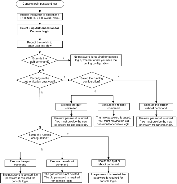

<8> Skip Authentication for Console Login
Enable console login without authentication.
This is a one-time operation and takes effect only for the first system boot or reboot after you choose this option.
This option is not available if password recovery capability is disabled.
Skipping console login authentication

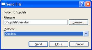

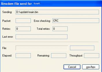

6.      On the configuration terminal, configure the communication settings and transfer the upgrade file. For more information, see "Using XMODEM to upgrade software through the console port."
In this example, the system sets the file as a main software image file when the file transfer is complete. The following is the sample output:
Waiting ...CCC
Download successfully!
47979456 bytes downloaded!
Updating File flash:/test.bin..............................................
..Done.
IMPORTANT
IMPORTANT:
·       To perform this task, make sure password recovery capability is enabled. If the capability is disabled, you cannot perform this task.
·       Perform this task only if the switch has one MPU. If the switch has two MPUs, you cannot skip console login authentication.
If you cannot remember the console login password, enter 8 in the EXTENDED-BOOTWARE menu, and then enter 1 or 0 in the EXTENDED-BOOTWARE menu. The switch will reboot and load the next-startup configuration file with the console login password ignored.
Enter your choice(0-9): 8
Clear Image Password Success!
After the switch starts up, you can configure a new console login password and save the running configuration so the new password takes effect (see Figure 1). If you do not configure a new console login password, the old password continues to take effect for the subsequent reboot.
Figure 1 Skipping console login authentication

6.      Select Transfer > Send File in the HyperTerminal window. In the dialog box that appears, click Browse to select the source file, and select Xmodem from the Protocol list. In this example, the file D:\update\main.bin is selected.
Figure 2 File transmission dialog box
7.      Click Send.
The following dialog box appears:
Figure 3 File transfer progress
After the file transfer is complete, the Serial submenu appears again. You can choose other options as required.
