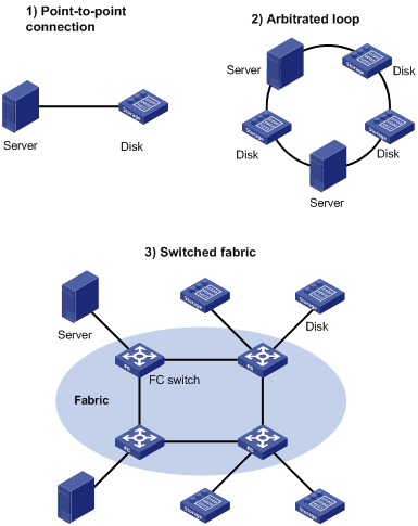

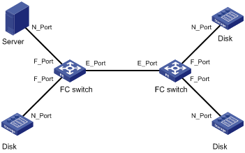

Figure 1 shows three FC SAN networking methods. The first two networking methods are simple and can connect only a limited number of devices.
·     Point-to-point connectionDirectly connects a server and a disk device.
·     Arbitrated loop—Supports up to 126 devices.
·     Switched fabric—Connects servers and disk devices through FC switches. In a switched fabric, the servers and disk devices are called "nodes." A fabric uses 24-bit addressing and supports thousands of devices.
Figure 1 FC SAN networking
·     An FC SAN refers to a network that includes FC switches and nodes.
·     A fabric refers to a transmission network that includes FC switches.

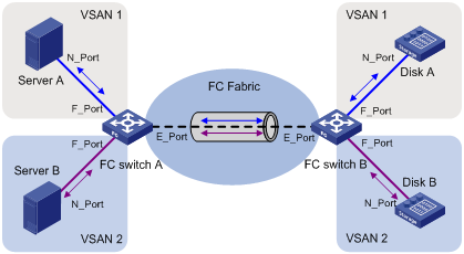

Figure 2 shows the structure of an FC address. The FC address is 24 bits long and contains the following 8-bit fields:
·     Domain_IDA domain represents a switch and all N_Ports connected to the switch. For more information about N_Ports, see "Port modes." A domain ID, which is in the range of 1 to 239, uniquely identifies an FC switch. Different FC switches in the same fabric have different domain IDs.
·     Area_IDOne or more N_Ports on the same node can be assigned to an area, which is identified by an area ID.
·     Port_IDThe Port_ID field identifies an N_Port.
Figure 2 Structure of an FC address
An FC address can uniquely identify an N_Port on a node. Different N_Ports on the same node have different FC addresses. FC switches use domain IDs to route messages between each other.
The FC protocol standardizes the FC address usage. For more information, see "Appendixes."
Port modes
In a switched fabric, nodes and FC switches communicate through interfaces operating in different modes.
Figure 3 Port modes
A node supports the following port modes:
·     N_Port—Directly connects to a fabric.
·     NL_Port—Connects to a fabric through an arbitrated loop.

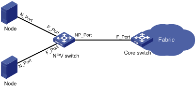

An FC switch provides the following port modes:
·     E_Port—Connects to an E_Port on another FC switch.
·     F_Port—Connects to an N_Port on a node or an NP_Port on another FC switch.
·     NP_Port—Connects to an F_Port on another FC switch. For more information about NP_Ports, see "Configuring NPV."
E_Ports connect FC switches to form a fabric, and F_Ports connect the nodes to FC switches in the fabric.

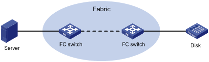

FC switches provide data transmission services. Through FC switches, a server sends instructions and data to disk devices and reads data from disk devices.
Figure 4 FC SAN communication model
The following takes a server accessing a disk device as an example to see how data communication occurs in an FC SAN.
1.     The server and the disk device send fabric login (FLOGI) packets to register with the FC switches. Then, the FC switches assign FC addresses to each directly-connected node.
A FLOGI packet contains information that includes the port WWN, node WWN, and the expected FC address.
2.     The registered server and disk device send name service registration requests to their respective access FC switches to register name service information, including FC4 information. Finally, each FC switch in the fabric stores the name service information of all nodes. For more information about FC4 information, see "Configuring and obtaining FC4 information of nodes."
3.     To access a disk device, the server must obtain the list of disk devices in the fabric and their WWNs and FC addresses. For this purpose, the server must send a name service query request to its directly-connected FC switch.
4.     After the server obtains the FC address of the disk device, the server can send FC frames destined to the FC address to the FC switch nearby.
5.     When the FC switch receives the FC frame from the server, it performs the following operations:
?     Queries its FIB table for a data forwarding path according to the destination FC address.
?     Forwards the FC frame to the next-hop FC switch.
6.     The next-hop FC switch forwards the FC frame in the same way, until the FC switch at the last hop forwards the FC frame to the destination disk device.
A FIB table is generated by the FC switch through calculation based on the FC routing protocol or configured static routes.
VSAN
In actual applications, the data is insecure if the data of all users is transmitted in the same FC SAN. You can divide one physical FC SAN into multiple virtual storage area networks (VSANs). VSANs are separated from one another and provide independent services. This enhances adaptability and security of the network and offers more effective services for users. For more information about VSANs, see "Configuring VSANs."

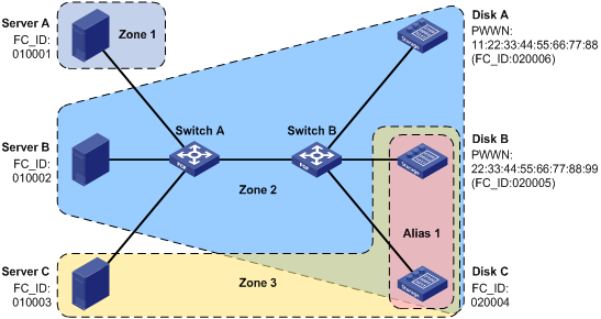

FC zone
The VSAN technique divides one physical SAN into multiple logical SANs. A VSAN, however, cannot perform access control over the servers and disk devices (or the N_Ports) connected to a fabric. N_Ports in the same VSAN can access one another only if these N_Ports register name services. This creates data security risks.
Zoning can solve the preceding problem by dividing a VSAN into zones and adding N_Ports to different zones for different purposes. N_Ports in different zones are separated to implement access control.
For more information about FC zones, see "Configuring FC zones."

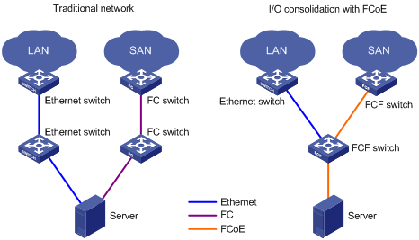

FCoE
A data center using the FC SAN technology typically includes separate local area networks (LANs) and SANs. LANs carry traditional Ethernet/IP services, and SANs carry network storage services.
To provide services for LANs and use SANs for storage simultaneously in a traditional network, the servers must use independent Ethernet adapters and FC adapters. In addition, the IP switches and the FC switches are also independent and have independent network connections. Such a network needs many switches, network adapters, and cables, and it brings high investments and maintenance costs and low scalability.
FCoE was introduced to solve this problem. FCoE transports FC over Ethernet. In an FCoE solution:
·     The server uses an FCoE-capable Ethernet adapter.
·     The FCoE forwarder (FCF) switch integrates the functions of both the traditional IP switch and FC switch.
FCoE reduces the number of network adapters, switches, and cables, and the network operation and maintenance workload. In all, FCoE reduces the total cost.
Figure 5 FCoE for I/O consolidation
As shown in Figure 5:
·     In the traditional network, the server is connected to the LAN through an Ethernet interface and to the SAN through an FC interface.
·     In the FCoE network, the server is connected to the LAN and SAN through one FCoE-capable FCF switch. The link between the server and the FCF switch can transmit both Ethernet frames and FC frames.

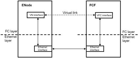

A virtual fibre channel (VFC) interface is a logical interface manually created on an FCF switch to simulate the functionality of a physical FC interface.
To use a VFC interface, bind it to a physical Ethernet interface.
You can connect either an ENode or an FCF switch to a VFC interface.
VFC interfaces support E mode, F mode (default), and NP mode.
The virtual node (VN) interface is a logical interface on an ENode to simulate the function of a physical FC interface.
FIP protocol
FCoE initialization protocol (FIP) is an FCoE control protocol that establishes and maintains virtual links.
FIP establishes a virtual link between the VFC interface of an FCF switch and either of the following:
·     A VN interface of an ENode.
·     A VFC interface of another FCF switch.
The virtual links provide a physical infrastructure for transmitting FC frames over Ethernet.

1.     FIP establishes a virtual link between the VFC interface of the FCF switch and one of the following interfaces:
?     A VN interface of an ENode.
?     A VFC interface of another FCF switch.
2.     After the virtual link is established, the FCF switch encapsulates the FC frame in an FCoE frame and sends it out.
3.     After receiving the FCoE frame, the FCF switch removes its Ethernet header to send the original FC frame to the upper layer for processing.

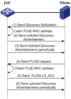

How FIP works
FIP establishes and maintains virtual links between a VFC interface and a VN interface or between VFC interfaces.
FIP uses Discovery Solicitation packets and Discovery Advertisement packets. Discovery Advertisement packets include the following types:
·     Solicited Discovery AdvertisementA reply for a Discovery Solicitation.
·     Unsolicited Discovery AdvertisementPeriodically sent to advertise the presence of a virtual link or maintain an existing virtual link.
The following example shows how a virtual link is established between an FCF switch and an ENode.
Figure 9 FIP operation
As shown in Figure 9, the following workflow is used to establish a virtual link:
1.     The ENode sends a Discovery Solicitation containing its FCoE MAC address.
2.     After receiving the Discovery Solicitation, the FCF switch acts differently depending on whether the receiving VFC interface is bound to an FCoE MAC address.
?     If it is not bound to an FCoE MAC address, the switch learns the FCoE MAC address and replies with a solicited Discovery Advertisement. The fcf priority field of the solicited Discovery Advertisement transports the FCF priority of the VFC interface.
?     If it is bound to an FCoE MAC address, the switch identifies whether the FCoE MAC address in the Discovery Solicitation matches the bound FCoE MAC address.
-     If they match, the switch replies with a solicited Discovery Advertisement, whose fcf priority field carries the FCF priority of the VFC interface.
-     If they do not match, the switch discards the Discovery Solicitation.
3.     The FCF switch periodically sends unsolicited Discovery Advertisements, whose fcf priority field carries the FCF priority of the system.
The sending interval is specified by using the fcoe fka-adv-period command and defaults to 8 seconds.
4.     After receiving the Discovery Advertisements, the ENode determines the FCF switch with the highest priority according to the fcf priority field. Then, the ENode sends a FLOGI request to that switch for login.
5.     After receiving the FLOGI request, the FCF switch identifies whether the source MAC address matches its learned or bound FCoE MAC address.
?     If they match, the FCF switch sends a FLOGI LS_ACC, which indicates that the establishment of the virtual link is completed.
?     If they do not match, the FCF switch discards the FLOGI request.
6.     The FCF switch also periodically sends unsolicited Discovery Advertisements to maintain established virtual links. If the ENode fails to receive an unsolicited Discovery Advertisement within a period 2.5 times the FKA advertisement interval, it deletes the virtual link.

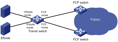

·     Transit mode—When the switch operates in this mode, you can perform one of the following tasks:
?     Configure an Ethernet interface to operate in ENode mode, so that the Ethernet interface can receive traffic from only an ENode.
?     Configure an Ethernet interface to operate in FCF mode, so that the Ethernet interface can receive traffic from only an FCF switch.

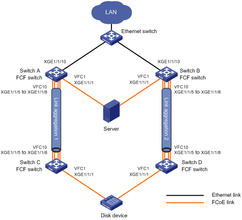

FCF mode
An FCF switch encapsulates FC frames in Ethernet frames and uses FCoE virtual links to simulate physical FC links. An FCF switch provides the FC switch features on a lossless Ethernet network.
Figure 10 FCF network diagram
In an FCoE environment as shown in Figure 10, FCF switches communicate with the ENode over a lossless Ethernet network. The end of an FCoE virtual link on an FCF switch is a VFC interface. The peer end of an FCoE virtual link can be a VN interface on an ENode or a VFC interface on another FCF switch.
Like an FC switch, each FCF switch is assigned a domain ID. Each FC SAN supports a maximum of 239 domain IDs, so an FC SAN cannot have more than 239 switches.

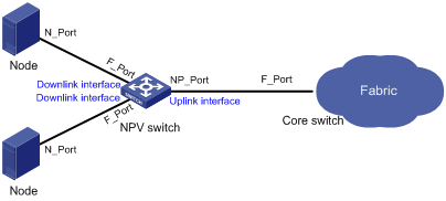

NPV mode
An FC SAN needs a large number of edge switches that are connected directly to nodes. NPV switches are developed to expand the number of switches in an FC SAN.
Figure 11 NPV network diagram
As shown in Figure 11, the NPV switch resides between nodes and the core switch on the edge of the fabric. The core switch is a switch operating in FCF mode. The NPV switch is connected to the nodes through its F_Ports and to the core switch through its NP_Port. The NPV switch forwards traffic from its connected nodes to the core switch.
The NPV switch appears as an FCF switch to nodes and as a node to the core switch.
For more information about NPV, see "Configuring NPV."

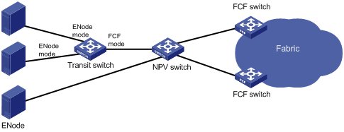

Transit mode
FCoE supports FC SANs built on lossless Ethernet networks, and allows Transit switches to be added between FCF switches and ENodes. Figure 12 shows a scenario where ENodes are connected to FCF switches through a Transit switch.
Figure 12 Transit network diagram
Ethernet interfaces on a Transit switch can operate in ENode mode or FCF mode.
·     An Ethernet interface connected to an ENode must be configured to operate in ENode mode.
·     An Ethernet interface connected to an FCF switch must be configured to operate in FCF mode.

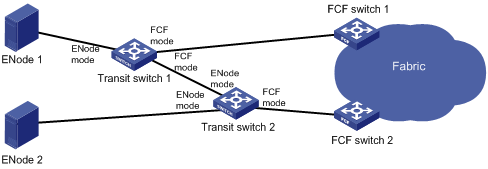

When Transit switches are interconnected, you must configure Ethernet interfaces to operate in the correct modes. As shown in Figure 13, ENode 2 can register with only FCF switch 2. To register ENode 2 with FCF switch 1, you must swap the operating modes of the Ethernet interfaces that connect the two Transit switches.
Figure 13 Transit cascading network diagram
Figure 14 shows a network scenario where both Transit and NPV switches are present.
Figure 14 Network diagram for NPV and Transit switches
The primary responsibilities of Transit switches are filtering and forwarding FCoE protocol packets. They can recognize and control FCoE packets as compared to standard Ethernet switches. However, they do not provide FCoE traffic processing capabilities as complex as FCF switches or NPV switches.

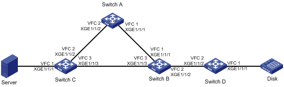

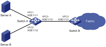

FCoE enabling configuration example
Network requirements
As shown in Figure 15, use FCoE in a data center combining a LAN and a SAN to reduce the number of devices, network adapters, and cables.
Figure 15 Network diagram
Configuration procedure
1.     Configure Switch A:
a.     Configure the switch to operate in advanced mode, save the configuration, and reboot the switch. (Skip this step if the switch is operating in advanced mode.)
<SwitchA> system-view
[SwitchA] system-working-mode advance
Do you want to change the system working mode? [Y/N]:y
The system working mode is changed, please save the configuration and reboot the
 system to make it effective.
[SwitchA] save
[SwitchA] quit
<SwitchA> reboot
b.     Configure VLANs and interfaces:
# Create VLAN 10 and 20, which are intended to transmit Ethernet data traffic and storage traffic, respectively.
[SwitchA] vlan 10
[SwitchA-vlan10] quit
[SwitchA] vlan 20
[SwitchA-vlan20] quit
# Configure interface Ten-GigabitEthernet 1/1/1 as a hybrid port.
[SwitchA] interface ten-gigabitethernet 1/1/1
[SwitchA-Ten-GigabitEthernet1/1/1] port link-type hybrid
# Assign interface Ten-GigabitEthernet 1/1/1 to VLAN 10 as an untagged member.
[SwitchA-Ten-GigabitEthernet1/1/1] port hybrid vlan 10 untagged
# Assign interface Ten-GigabitEthernet 1/1/1 to VLAN 20 as a tagged member.
[SwitchA-Ten-GigabitEthernet1/1/1] port hybrid vlan 20 tagged
# Set the PVID to VLAN 10 for interface Ten-GigabitEthernet 1/1/1.
[SwitchA-Ten-GigabitEthernet1/1/1] port hybrid pvid vlan 10
[SwitchA-Ten-GigabitEthernet1/1/1] quit
# Configure interface Ten-GigabitEthernet 1/1/2 as a trunk port, and assign the interface to VLAN 20.
[SwitchA] interface ten-gigabitethernet 1/1/2
[SwitchA-Ten-GigabitEthernet1/1/2] port link-type trunk
[SwitchA-Ten-GigabitEthernet1/1/2] port trunk permit vlan 20
[SwitchA-Ten-GigabitEthernet1/1/2] quit
# Configure interface Ten-GigabitEthernet 1/1/3 as a trunk port, and assign the interface to VLAN 10.
[SwitchA] interface ten-gigabitethernet 1/1/3
[SwitchA-Ten-GigabitEthernet1/1/3] port link-type trunk
[SwitchA-Ten-GigabitEthernet1/1/3] port trunk permit vlan 10
[SwitchA-Ten-GigabitEthernet1/1/3] quit
c.     Configure DCBX:
# Enable LLDP globally.
[SwitchA] lldp global enable
# Create Layer 2 ACL 4000.
[SwitchA] acl mac 4000
# Configure ACL 4000 to permit FCoE packets (whose protocol number is 0x8906) and FIP protocol packets (whose protocol number is 0x8914) to pass through.
[SwitchA-acl-mac-4000] rule 0 permit type 8906 ffff
[SwitchA-acl-mac-4000] rule 5 permit type 8914 ffff
[SwitchA-acl-mac-4000] quit
# Create a class named DCBX, specify the operator of the class as OR, and use ACL 4000 as the match criterion of the class.
[SwitchA] traffic classifier DCBX operator or
[SwitchA-classifier-DCBX] if-match acl 4000
[SwitchA-classifier-DCBX] quit
# Create a behavior named DCBX, and configure the behavior to mark packets with 802.1p priority value 3.
[SwitchA] traffic behavior DCBX
[SwitchA-behavior-DCBX] remark dot1p 3
[SwitchA-behavior-DCBX] quit
# Create a QoS policy named DCBX, associate class DCBX with traffic behavior DCBX in the QoS policy, and specify that the association apply to DCBX.
[SwitchA] qos policy DCBX
[SwitchA-qospolicy-DCBX] classifier DCBX behavior DCBX mode dcbx
[SwitchA-qospolicy-DCBX] quit
# Enable LLDP and DCBX TLV advertising on interface Ten-GigabitEthernet 1/1/1.
[SwitchA-Ten-GigabitEthernet1/1/1] lldp enable
[SwitchA-Ten-GigabitEthernet1/1/1] lldp tlv-enable dot1-tlv dcbx
# Apply QoS policy DCBX to the outgoing traffic of Ten-GigabitEthernet 1/1/1.
[SwitchA-Ten-GigabitEthernet1/1/1] qos apply policy DCBX outbound
d.     Configure PFC:
# Enable PFC in auto mode on interface Ten-GigabitEthernet 1/1/1.
[SwitchA-Ten-GigabitEthernet1/1/1] priority-flow-control auto
# Enable PFC for 802.1p priority 3 on the interface.
[SwitchA-Ten-GigabitEthernet1/1/1] priority-flow-control no-drop dot1p 3
# Configure the interface to trust the 802.1p priority carried in incoming packets.
[SwitchA-Ten-GigabitEthernet1/1/1] qos trust dot1p
# Forcibly enable PFC on interface Ten-GigabitEthernet 1/1/2.
[SwitchA-Ten-GigabitEthernet1/1/2] priority-flow-control enable
[SwitchA-Ten-GigabitEthernet1/1/2] priority-flow-control no-drop dot1p 3
[SwitchA-Ten-GigabitEthernet1/1/2] qos trust dot1p
e.     Configure ETS:
# Configure the 802.1p-local priority mapping table as follows:
-     Map 802.1p priority value 3 to local precedence 1.
-     Map the other 802.1p priorities to local precedence 0.
[SwitchA] qos map-table dot1p-lp
[SwitchA-maptbl-dot1p-lp] import 3 export 1
[SwitchA-maptbl-dot1p-lp] import 0 1 2 4 5 6 7 export 0
[SwitchA-maptbl-dot1p-lp] quit
# Configure WRR on interface Ten-GigabitEthernet 1/1/1 as follows:
-     Assign 50% of the interface bandwidth to the FCoE traffic (traffic assigned to queue 1).
-     Assign 50% of the interface bandwidth to the LAN traffic (traffic assigned to queue 0).
[SwitchA-Ten-GigabitEthernet1/1/1] qos wrr byte-count
[SwitchA-Ten-GigabitEthernet1/1/1] qos wrr 1 group 1 byte-count 1
[SwitchA-Ten-GigabitEthernet1/1/1] qos wrr 0 group 1 byte-count 1
# Assign the other queues to the SP group on interface Ten-GigabitEthernet 1/1/1.
[SwitchA-Ten-GigabitEthernet1/1/1] qos wrr 2 group sp
[SwitchA-Ten-GigabitEthernet1/1/1] qos wrr 3 group sp
[SwitchA-Ten-GigabitEthernet1/1/1] qos wrr 4 group sp
[SwitchA-Ten-GigabitEthernet1/1/1] qos wrr 5 group sp
[SwitchA-Ten-GigabitEthernet1/1/1] qos wrr 6 group sp
[SwitchA-Ten-GigabitEthernet1/1/1] qos wrr 7 group sp
f.     Configure FCoE:
# Configure the switch to operate in FCF mode and create VSAN 10.
[SwitchA] fcoe-mode fcf
[SwitchA] vsan 10
[SwitchA-vsan10] quit
# Create interface VFC 1, and configure the mode of VFC 1 as F.
[SwitchA] interface vfc 1
[SwitchA-Vfc1] fc mode f
# Bind VFC 1 to interface Ten-GigabitEthernet 1/1/1, and assign VFC 1 to VSAN 10 as a trunk port.
[SwitchA-Vfc1] bind interface ten-gigabitethernet 1/1/1
[SwitchA-Vfc1] port trunk vsan 10
[SwitchA-Vfc1] quit
# Create interface VFC 2, and configure the mode of VFC 2 as E.
[SwitchA] interface vfc 2
[SwitchA-Vfc2] fc mode e
# Bind VFC 2 to interface Ten-GigabitEthernet 1/1/2, and assign VFC 2 to VSAN 10 as a trunk port.
[SwitchA-Vfc2] bind interface ten-gigabitethernet 1/1/2
[SwitchA-Vfc2] port trunk vsan 10
[SwitchA-Vfc2] quit
# Enable FCoE for VLAN 20 and map VLAN 20 to VSAN 10.
[SwitchA] vlan 20
[SwitchA-vlan20] fcoe enable vsan 10
# Permit members in the default zone to access each other. By default, the server and disk belong to the default zone and members in the default zone are not permitted to access each other. For more information about zones, see "Configuring FC zones."
[SwitchA] vsan 10
[SwitchA-vsan10] zone default-zone permit
2.     Configure Switch B:
<SwitchB> system-view
[SwitchB] system-working-mode advance

VFC interfaces in a VSAN can only work as trunk ports. A trunk port can belong to multiple VSANs.
Trunk VSAN in an FC network
The trunk VSAN technology implements logical isolation among VSANs. A trunk VSAN adds a Virtual Fabric Tagging Header (VFT_Header, also known as VSAN tag) to the FC frames. The VFT_Header contains a VF_ID (also known as "VSAN ID") field to indicate the VSAN of the FC frames. In this way, FC frames with different VF_IDs are contained in their respective VSANs, and different VSANs cannot communicate with each other. The trunk VSAN implements physical connectivity and logical isolation in the network.
Figure 16 shows a typical trunk VSAN.
·     The F_Ports in blue on switches are configured as access ports and assigned to VSAN 1.
·     The F_Ports in purple are configured as access ports and assigned to VSAN 2.
·     The E_Ports are configured with trunk VSANs 1 and 2.
When servers read the disks, the N_Ports of different servers send FC frames without VFT_Headers to the F_Ports on FC switch Switch A. Switch A searches for the outgoing interfaces in the FIB table of the VSAN that each F_Port belongs to. These F_Ports use the same E_Port as the outgoing interface. When the frames are forwarded out of the E_Port, they are tagged with the VFT_Header of VSAN 1 and VSAN 2. Then, the frames travel across multiple VSAN-capable switches to the E_Port of FC switch Switch B.
According to the VFT_Headers, Switch B searches for the outgoing interfaces in the FIB tables of the VSANs, and forwards them to the F_Ports. Then, the F_Ports remove the VFT_Headers and send the frames to the N_Ports of different disk devices. The frames from the disk devices to the server are processed in the same way and finally reach the servers.
Figure 16 Trunk VSAN network
During the transmission process, VFT_Headers are added to and removed from the frames. A switch can use the same physical interface to support multiple VSANs. The trunk VSAN technology reduces the number of physical connections, actually implementing logical isolation in a physical network.
Trunk VSAN in an FCoE network

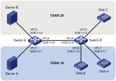

As shown in Figure 17, configure the VSANs to meet the following requirements:
·     Server A can read and write only the data of Disk A and Disk B.
·     Server B can read and write only the data of Disk C.
Figure 17 Network diagram
This section describes only the VSAN configurations.
# Configure the switch to operate in advanced mode, save the configuration, and reboot the switch. (Skip this step if the switch is operating in advanced mode.)
[SwitchA] save
[SwitchA] quit
<SwitchA> reboot
# Configure the switch to operate in FCF mode.
# Create VSAN 10 and VSAN 20.
[SwitchA] vsan 10
[SwitchA] vsan 20
[SwitchA-vsan20] quit
# Create interface VFC 1.
# Configure the mode of VFC 1 as F.
# Bind VFC 1 to interface Ten-GigabitEthernet 1/1/1.
# Assign VFC 1 to VSAN 10 as a trunk port.
[SwitchA-Vfc1] quit
# Configure Ten-GigabitEthernet 1/1/1 as a trunk port, and assign the port to VLAN 10.
[SwitchA-Ten-GigabitEthernet1/1/1] port link-type trunk
[SwitchA-Ten-GigabitEthernet1/1/1] port trunk permit vlan 10
# Create interface VFC 2.
# Configure the mode of VFC 2 as F.
[SwitchA-Vfc2] fc mode f
# Bind VFC 2 to interface Ten-GigabitEthernet 1/1/2.
# Assign VFC 2 to VSAN 20 as a trunk port.
[SwitchA-Vfc2] port trunk vsan 20
[SwitchA-Vfc2] quit
# Configure Ten-GigabitEthernet 1/1/2 as a trunk port, and assign the port to VLAN 20.
# Create interface VFC 4.
[SwitchA] interface vfc 4
# Configure the mode of VFC 4 as E.
[SwitchA-Vfc4] fc mode e
# Bind VFC 4 to interface Ten-GigabitEthernet 1/1/4.
[SwitchA-Vfc4] bind interface ten-gigabitethernet 1/1/4
# Assign VFC 4 to VSANs 10 and 20 as a trunk port.
[SwitchA-Vfc4] port trunk vsan 10 20
[SwitchA-Vfc4] quit
# Configure Ten-GigabitEthernet 1/1/4 as a trunk port, and assign the port to VLANs 10 and 20.
[SwitchA] interface ten-gigabitethernet 1/1/4
[SwitchA-Ten-GigabitEthernet1/1/4] port link-type trunk
[SwitchA-Ten-GigabitEthernet1/1/4] port trunk permit vlan 10 20
[SwitchA-Ten-GigabitEthernet1/1/4] quit
# Enable FCoE for VLAN 10 and map VLAN 10 to VSAN 10.
[SwitchA] vlan 10
[SwitchA-vlan10] fcoe enable vsan 10
# Enable FCoE for VLAN 20 and map VLAN 20 to VSAN 20.
[SwitchA] vlan 20
[SwitchA-vlan20] fcoe enable vsan 20
[SwitchA] vsan 10
[SwitchA] vsan 20
[SwitchA-vsan20] zone default-zone permit
2.     Configure Switch B in the same way Switch A is configured.
# Display member interfaces of each VSAN on switches, for example, Switch A.
[SwitchA] display vsan port-member
VSAN 1:
  Access Ports:
  Trunk Ports:
VSAN 10:
  Access Ports:
  Trunk Ports:
    Vfc1
    Vfc4
VSAN 20:
  Access Ports:
  Trunk Ports:
    Vfc2
    Vfc4
Building a fabric

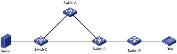

[SwitchA] interface Vfc 2
# Configure VFC 2 to operate in E mode, and assign it to VSAN 1 as a trunk port.
[SwitchA-Vfc2] quit
# Create interface VFC 1, and bind it to interface Ten-GigabitEthernet 1/1/1.
[SwitchA] interface Vfc 1
# Configure VFC 1 to operate in E mode, and assign it to VSAN 1 as a trunk port.
[SwitchA-Vfc1] fc mode e
[SwitchA-Vfc1] quit
[SwitchA] vsan 1
[SwitchA-vsan1] zone default-zone permit
[SwitchA-vsan1] quit
[SwitchB] save
[SwitchB] quit
<SwitchB> reboot
[SwitchB] fcoe-mode fcf
# Enable the fabric configuration feature in VSAN 1. By default, the fabric configuration feature is enabled.
[SwitchB] vsan 1
[SwitchB-vsan1] domain configure enable
# Set the switch priority to 1, so that Switch B can be selected as the principal switch.
[SwitchB-vsan1] priority 1
# Enable FCoE for VLAN 10 and map VLAN 10 to VSAN 1.
[SwitchB] vlan 10
[SwitchB-vlan10] fcoe enable vsan 1
[SwitchB-vlan10] quit
[SwitchB] interface Vfc 1
[SwitchB-Vfc1] bind interface ten-gigabitethernet 1/1/1
[SwitchB-Vfc1] fc mode e
[SwitchB-Vfc1] port trunk vsan 1
[SwitchB-Vfc1] quit
# Create interface VFC 2, and bind it to interface Ten-GigabitEthernet 1/1/2.
[SwitchB] interface Vfc 2
[SwitchB-Vfc2] bind interface ten-gigabitethernet 1/1/2
[SwitchB-Vfc2] fc mode e
[SwitchB-Vfc2] port trunk vsan 1
[SwitchB-Vfc2] quit
# Create interface VFC 3, and bind it to interface Ten-GigabitEthernet 1/1/3.
[SwitchB] interface Vfc 3
[SwitchB-Vfc3] bind interface ten-gigabitethernet 1/1/3
# Configure VFC 3 to operate in E mode, and assign it to VSAN 1 as a trunk port.
[SwitchB-Vfc3] fc mode e
[SwitchB-Vfc3] port trunk vsan 1
[SwitchB-Vfc3] quit
[SwitchB] vsan 1
[SwitchB-vsan1] zone default-zone permit
[SwitchB-vsan1] quit
3.     Configure Switch C:
<SwitchC> system-view
[SwitchC] system-working-mode advance
[SwitchC] save
[SwitchC] quit
<SwitchC> reboot
[SwitchC] fcoe-mode fcf
[SwitchC] vsan 1
[SwitchC-vsan1] domain configure enable
# Set the domain ID to 13.
[SwitchC-vsan1] domain-id 13 preferred
Non-disruptive reconfiguration or isolating the switch may be performed. Continue? [Y/N]:y
[SwitchC] vlan 10
[SwitchC-vlan10] fcoe enable vsan 1
[SwitchC-vlan10] quit
[SwitchC] interface Vfc 1
[SwitchC-Vfc1] bind interface ten-gigabitethernet 1/1/1
# Configure VFC 1 to operate in F mode, and assign it to VSAN 1 as a trunk port.
[SwitchC-Vfc1] fc mode f
[SwitchC-Vfc1] port trunk vsan 1
[SwitchC-Vfc1] quit
[SwitchC] interface Vfc 2
[SwitchC-Vfc2] bind interface ten-gigabitethernet 1/1/2
[SwitchC-Vfc2] fc mode e
[SwitchC-Vfc2] port trunk vsan 1
[SwitchC-Vfc2] quit
[SwitchC] interface Vfc 3
[SwitchC-Vfc3] bind interface ten-gigabitethernet 1/1/3
[SwitchC-Vfc3] fc mode e
[SwitchC-Vfc3] port trunk vsan 1
[SwitchC-Vfc3] quit
[SwitchC] vsan 1
[SwitchC-vsan1] zone default-zone permit
[SwitchC-vsan1] quit
4.     Configure Switch D:
<SwitchD> system-view
[SwitchD] system-working-mode advance
[SwitchD] save
[SwitchD] quit
<SwitchD> reboot
[SwitchD] fcoe-mode fcf
[SwitchD] vsan 1
[SwitchD-vsan1] domain configure enable
# Set the domain ID to 14.
[SwitchD-vsan1] domain-id 14 preferred
[SwitchD] vlan 10
[SwitchD-vlan10] fcoe enable vsan 1
[SwitchD-vlan10] quit
[SwitchD] interface Vfc 1
[SwitchD-Vfc1] bind interface ten-gigabitethernet 1/1/1
[SwitchD-Vfc1] fc mode f
[SwitchD-Vfc1] port trunk vsan 1
[SwitchD-Vfc1] quit
[SwitchD] interface Vfc 2
[SwitchD-Vfc2] bind interface ten-gigabitethernet 1/1/2
[SwitchD-Vfc2] fc mode e
[SwitchD-Vfc2] port trunk vsan 1
[SwitchD-Vfc2] quit
[SwitchD] vsan 1
[SwitchD-vsan1] zone default-zone permit
[SwitchD-vsan1] quit
Verify the configuration on switches, for example, Switch A.
# Display the domain information of VSAN 1.
[SwitchA-vsan1] display fc domain vsan 1
Domain Information of VSAN 1:
    Running time information:
        State: Stable
        Switch WWN: 48:33:43:2d:46:43:1A:1A
        Fabric name: 48:33:43:2d:46:43:1B:1B
        Priority: 128
        Domain ID: 11
    Configuration information:
        Domain configure: Enabled
        Domain auto-reconfigure: Disabled
        Fabric name: 48:33:43:2d:46:43:1A:1A
        Priority: 128
        Domain ID: 11 (preferred)
    Principal switch running time information:
        Priority: 1
    Path          Interface
    Upstream      Vfc1
    Downstream    Vfc2
The output shows that the domain configuration is complete and that the principal switch assigns domain ID 11 to Switch A.
# Display the domain ID list of VSAN 1.
[SwitchA-vsan1] display fc domain-list vsan 1
Domain list of VSAN 1:
  Number of domains: 4
  Domain ID      WWN
  0x01(5)        48:33:43:2d:46:43:1B:1B [Principal]
  0x0b(11)       48:33:43:2d:46:43:1A:1A [Local]
  0x0d(13)       48:33:43:2d:46:43:1C:1C
  0x0e(14)       48:33:43:2d:46:43:1D:1D
The output shows that Switch B becomes the principal switch and assigns a random domain ID (ID 5) to itself.

FSPF configuration example
Configure FSPF so the two FCF switches can communicate with each other.
Figure 22 Network diagram
This section describes only the FC routing configurations.

Zone database
To control access among N_Ports, you can divide N_Ports into different zones as needed, which form a zone set. The same N_Ports can form multiple zone sets according to different zone division policies. These zones and zone sets form a zone database.
Zone database structure
The zone database is organized into three levels (zone set, zone, and zone member).
Figure 23 Zone database structure
In the zone database structure:
·     A zone set is a set of zones. A zone is a set of zone members, which are N_Ports or F_Ports. N_Port membership can be identified by the WWN (pWWN) or FC address of an N_Port. F_Port membership is identified by the WWN of an F_Port (fWWN).
·     Each VSAN can have multiple zone sets, each zone set can have multiple zones, and each zone can have multiple zone members.
·     Zone membership configuration supports use of zone aliases. A zone alias is a set of N_Ports, which can be considered as a whole. To simplify configuration, you can add common zone members in multiple zones to a zone alias, and call the zone alias in different zones.

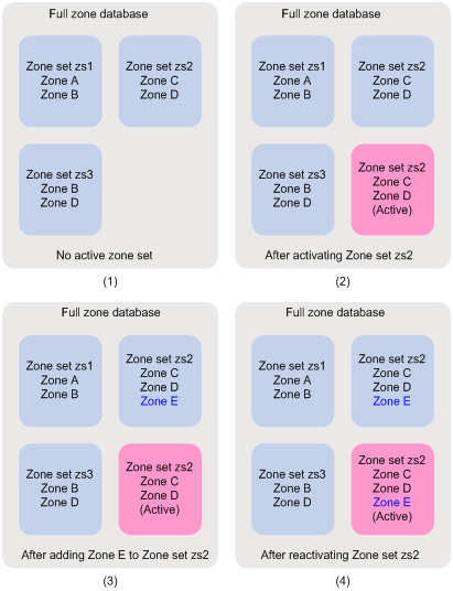

Active zone set
Each VSAN can have multiple zone sets, but only one zone set can be effective at a time. It is called the active zone set. Access control over N_Ports is subject to the active zone set.
To ensure consistent access control over N_Ports across a fabric, specify a zone set as the active zone set on a switch and distribute it to the entire fabric.
When you activate a zone set, a copy of the zone set at the time of activation is created and is called the active zone set. After that, modifications to the zone set do not take effect on the copy until the copy is reactivated. Figure 24 shows the relationship between active and full zone sets.
Figure 24 Active and full zone sets
In basic zoning mode, the system checks the size of the data to be distributed when you activate a zone set. If the size of the data exceeds the system limit, the activation fails, and an error message is displayed.
In enhanced zoning mode, the system does not limit the size of the data to be distributed.

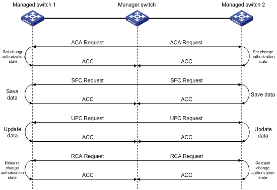

Zone distribution process
The manager switch completes data synchronization with each managed switch by using the following packets:
·     Acquire Change Authorization (ACA).
·     Stage Fabric Configuration Update (SFC).
·     Update Fabric Configuration (UFC).
·     Release Change Authorization (RCA).
These types of packets implement locking, data synchronization, submission, and unlocking processes, respectively. These processes ensure that only one switch is the manager switch when multiple users trigger a data distribution on different switches at the same time.
Figure 25 Distribution process
The distribution process is as follows:
1.     The manager switch obtains the status of each managed switch through an ACA request. The ACA request carries the fabric-wide list of domain IDs (addresses of all switches in the fabric) known to the manager switch. After sending the ACA request, the manager switch enters the locked state.
2.     After receiving the ACA request, a managed switch compares its list of domain IDs with that in the packet.
?     If they are consistent, the fabric is in stable state. In this case, the managed switch is prepared for synchronization, replies with an ACC (acknowledgment) packet, and enters the change authorization (locked) state.
IMPORTANT
IMPORTANT:
For a fabric to be stable, make sure the routes are correctly and consistently configured, and no unreachable routes exist.
?     If the managed switch has been in change authorization state or cannot process the ACA request, it replies with an RJT (reject) packet.
3.     The manager switch starts data synchronization by sending an SFC request only after receiving ACC requests from all managed switches. Otherwise, it notifies managed switches to release the change authorization state by sending an RCA request.
If the managed switch replies with neither an ACC packet nor an RJT packet because of its abnormal state, the manager switch cannot release its locked state. To prevent this situation, the manager switch transmits an ACA request up to three times.
?     If no reply is received, the manager switch releases its locked state.
?     If the manager switch becomes abnormal after sending an ACA request, the managed switch will be in locked state and cannot receive subsequent packets. In this situation, the managed switch releases its locked state after waiting for a period of time.
4.     The manager switch sends an SFC request to all managed switches. The SFC request carries data to be synchronized, including the active zone set and zone database information. After receiving the SFC request, the managed switch calculates the total numbers of zones, zone sets, and zone aliases if its local zone database is replaced.
?     If none of the total numbers exceed the limit, the managed switch replies with an ACC packet.
?     If any of the total numbers exceed the limit, the managed switch replies with an RJT packet.
?     After receiving ACC packets from all managed switches, the manager switch sends a UFC request to the managed switches. The UFC request notifies the managed switches to replace their local data with the received data. Otherwise, the manager switch sends an RCA request to notify managed switches to release the change authorization state.
5.     After receiving the UFC request, the managed switch updates its local zone database. It replies with an ACC packet for a successful update and with an RJT packet for a failed update.
6.     The manager switch notifies managed switches by sending an RCA request to release the change authorization state after receiving ACC packets from all managed switches.
7.     After receiving the RCA request, the managed switch releases its change authorization state and replies with an ACC packet.
8.     The manager switch releases its change authorization state after receiving ACC packets from all managed switches.

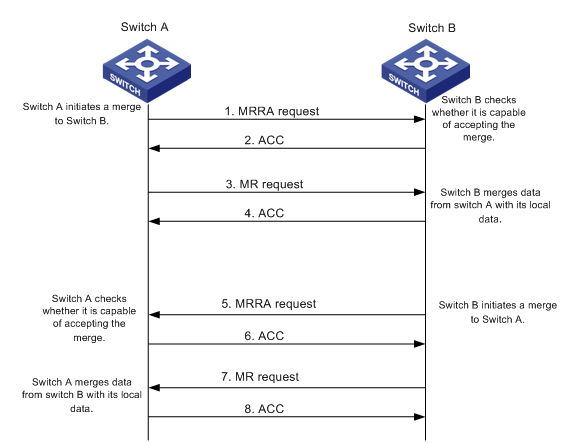

Zone merge process
When a switch discovers a new neighbor (the link layer module discovers neighbors and notifies the zone module), it starts a merge process with the neighbor. If the data changes after merging, the switch sends the changed data to neighbor switches until all switches in the fabric update their data.
During the merge, the switch sends Merge Request Resource Allocation (MRRA) requests to negotiate the size of data transmitted. Then, the switch sends Merge Request (MR) packets containing data to be merged to neighbor switches.
Figure 26 Zone merge process between two switches
The zone merge process is as follows:
1.     Switch A and Switch B are new neighbors to each other. Suppose that Switch A first initiates a merge to Switch B.
a.     Switch A sends an MRRA request carrying the size of its data to be merged to Switch B.
b.     After receiving the MRRA request, Switch B determines whether to accept the merge according to its local data size.
-     If the size of the data to be merged is acceptable, it replies with an ACC packet.
-     If the size of the data to be merged is not acceptable, it replies with an RJT packet.
c.     After receiving the ACC packet, Switch A sends an MR request containing its zone data to Switch B.
d.     After receiving the MR request, Switch B obtains the zone data and merges it with its local zone data. Then, it replies with an ACC packet for a successful merge or with an RJT packet containing the cause of failure for a failed merge.
2.     After the merge process initiated by Switch A is complete, the following rules apply:
?     If the local data of Switch B is the same as or a subset of the local data of Switch A, Switch B ends the merge process with Switch A.
?     Otherwise, Switch B initiates a merge process with Switch A.
The merge process is the same as the process initiated by Switch A to Switch B, as shown in steps 5, 6, 7, and 8 in Figure 26.
3.     After the merge process initiated by Switch A is complete, Switch B initiates a merge process to all its neighbors. This synchronizes Switch B's local database changes resulting from the merge to the entire fabric.
4.     Two 1-way merge processes can ensure data consistency between Switch A and Switch B.
Consistent active zone sets among switches can be achieved by a merge. Consistent zone databases achieved after a merge, however, require all participating switches to be configured with complete merge.

Configuring a merge control mode
Two merge control modes are available: Restrict and Allow. For information about these two modes, see "Zone merge in enhanced zoning mode."
In enhanced zoning mode, the merge control mode affects the result of a merge operation. Also, a merge operation is allowed only when the merge control mode is the same on both participating switches. Otherwise, the merge operation fails, and the link connecting the participating switches is isolated.
This feature is supported only in enhanced zoning mode. To ensure a consistent merge control mode across the fabric, use the zone activate or zone distribute command after you configure a merge control mode.
To configure a merge control mode:
Step
Remarks
N/A
2.     Enter VSAN view.
vsan vsan-id
N/A
3.     Configure a merge control mode.
·     Configure the merge control mode as Restrict:
zone merge-control restrict
·     Configure the merge control mode as Allow:
undo zone merge-control restrict
The default merge control mode is Allow.

FC zone configuration example
As shown in Figure 27, all nodes have registered with the switches.
Configure access control in VSAN 1 to meet the following requirements:
·     Server A cannot access any disk but might need to subsequently.
·     Server B can access Disks A, B, and C.
·     Server C can access Disks B and C.
·     Servers cannot access each other.
Figure 27 Network diagram
Requirements analysis
To meet the network requirements, divide VSAN 1 into three zones as follows:
·     Assign Server A to zone Zone1.
·     Assign Server B and Disks A, B, and C to zone Zone2.
·     Assign Server C and Disks B and C to zone Zone3.
·     Enable Pairwise for Zone2, configure Server B as an initiator, and configure Disks A, B, and C as targets.
·     Enable Pairwise for Zone3, configure Server C as an initiator, and configure Disks B and C as targets.
·     Create a zone alias named Alias1, which contains Disks B and C, to simplify the configuration.
·     Create a zone set named Zoneset1, which contains zones Zone1, Zone2, and Zone3, and activate it.
This section describes only FC zone configurations on Switch A. You do not need to configure FC zones on Switch B.
[SwitchA] save
[SwitchA] quit
<SwitchA> reboot
# Create a zone alias named Alias1.
[SwitchA] vsan 1
[SwitchA-vsan1] zone-alias name Alias1
# Add pWWN 22:33:44:55:66:77:88:99 (Disk B) and FC ID 020004 (Disk C) as its target members.
[SwitchA-vsan1-zone-alias-Alias1] member pwwn 22:33:44:55:66:77:88:99 target
[SwitchA-vsan1-zone-alias-Alias1] member fcid 020004 target
[SwitchA-vsan1-zone-alias-Alias1] quit
# Create a zone named Zone1, and specify FC ID 010001 as its member.
[SwitchA-vsan1] zone name Zone1
[SwitchA-vsan1-zone-Zone1] member fcid 010001
[SwitchA-vsan1-zone-Zone1] quit
# Create a zone named Zone2, and enable the Pairwise feature for Zone2.
[SwitchA-vsan1] zone name Zone2
[SwitchA-vsan1-zone-Zone2] pairwise-zoning enable
# Specify FC ID 010002 and pWWN 11:22:33:44:55:66:77:88 as its initiator member and target member, respectively.
[SwitchA-vsan1-zone-Zone2] member fcid 010002 initiator
[SwitchA-vsan1-zone-Zone2] member pwwn 11:22:33:44:55:66:77:88 target
# Add zone alias Alias1 to Zone2 as a member.
[SwitchA-vsan1-zone-Zone2] member zone-alias Alias1
[SwitchA-vsan1-zone-Zone2] quit
# Create the zone Zone3, and enable the Pairwise feature for Zone3.
[SwitchA-vsan1] zone name Zone3
[SwitchA-vsan1-zone-Zone3] pairwise-zoning enable
# Specify FC ID 010003 as an initiator member of Zone3.
[SwitchA-vsan1-zone-Zone3] member fcid 010003 initiator
# Add zone alias Alias1 to Zone3 as a member.
[SwitchA-vsan1-zone-Zone3] member zone-alias Alias1
[SwitchA-vsan1-zone-Zone3] quit
# Create a zone set named Zoneset1 and add zones Zone1, Zone2, and Zone3 as its members.
[SwitchA-vsan1] zoneset name Zoneset1
[SwitchA-vsan1-zoneset-Zoneset1] member Zone1
[SwitchA-vsan1-zoneset-Zoneset1] member Zone2
[SwitchA-vsan1-zoneset-Zoneset1] member Zone3
[SwitchA-vsan1-zoneset-Zoneset1] quit
# Configure the zone distribution and merge type as complete.
[SwitchA-vsan1] zoneset distribute full
# Activate a zone set as the active zone set and distribute it to the entire fabric.
[SwitchA-vsan1] zoneset activate name Zoneset1
Perform all verification tasks on Switch B.

NPV switches forward traffic from nodes to the core switch.
Figure 28 shows a typical NPV network diagram.
Figure 28 NPV network diagram
An NPV switch must be directly connected to the core switch.
Downlink interface and downlink
A downlink interface, also known as a server interface, is an interface through which an NPV switch connects to a node. It must be a VFC interface operating in F mode.
A downlink is a link from an NPV switch to its node.
Each downlink interface is uniquely mapped to an operational uplink interface. All traffic from the node connected to the downlink interface is forwarded to the core switch through the uplink interface.
Uplink interface and uplink
An uplink interface, also known as an external interface, is the interface through which an NPV switch connects to the core switch. It must be a VFC interface operating in NP mode.
An uplink is a link from an NPV switch to the core switch.
When the uplink becomes operational, the NPV switch sends a fabric login (FLOGI) packet to the core switch for registration. The core switch assigns the uplink interface (NP_Port) an FC address. Then, the NPV switch registers itself with the name server on the core switch. When receiving a packet from a node, the NPV switch performs the following operations:
·     Forwards the packet to the core switch through the mapped uplink interface.
·     Passes the response packet from the core switch to the node through the downlink interface.
Downlink-to-uplink interface mappings
NPV switches automatically map downlink interfaces to uplink interfaces. Before a downlink interface is brought up, the NPV switch maps it to the uplink interface to which the minimum number of downlink interfaces is mapped.
Typically, automatic mapping can meet your requirements. When a downlink interface must be connected to a fabric through the specified uplink interfaces, you can manually map the downlink interface to the uplink interfaces. After you configure the mapping, the downlink interface can be mapped to only the configured uplink interfaces. If none of the configured uplink interfaces is operational, the downlink interface cannot be operational.
A configured mapping selects the uplink interface with the minimum load from configured uplink interfaces and then maps the downlink interface to it.
After a mapping is established, all traffic from the downlink interface is forwarded through the uplink interface.

NPV configuration example
As shown in Figure 29, configure the edge switch (Switch A) as an NPV switch to expand the network.
Figure 29 Network diagram
[SwitchA] save
[SwitchA] quit
<SwitchA> reboot
# Configure the switch to operate in NPV mode.
[SwitchA] fcoe-mode npv
# Create VSAN 1.
[SwitchA] vsan 1
# Assign VFC 1 to VSAN 1 as a trunk port.
[SwitchA-Vfc1] quit
# Assign VFC 2 to VSAN 1 as a trunk port.
[SwitchA-Vfc2] quit
# Configure Ten-GigabitEthernet 1/1/2 as a trunk port, and assign the port to VLAN 10.
[SwitchA-Ten-GigabitEthernet1/1/2] port trunk permit vlan 10
# Create interface VFC 3.
[SwitchA] interface vfc 3
# Bind VFC 3 to interface Ten-GigabitEthernet 1/1/3.
[SwitchA-Vfc3] bind interface ten-gigabitethernet 1/1/3
# Assign VFC 3 to VSAN 1 as a trunk port.
[SwitchA-Vfc3] port trunk vsan 1
[SwitchA-Vfc3] quit
# Configure Ten-GigabitEthernet 1/1/3 as a trunk port, and assign the port to VLAN 10.
[SwitchA] vlan 10
# Configure the mode of the uplink port VFC 3 as NP.
[SwitchA-Vfc3] fc mode np
[SwitchA-Vfc3] quit
# Configure the mode of the downlink ports VFC 1 and VFC 2 as F.
[SwitchA-Vfc1] quit
[SwitchA-Vfc2] quit
[SwitchB] save
[SwitchB] quit
<SwitchB> reboot
# Create VSAN 1.
[SwitchB] vsan 1
[SwitchB] interface vfc 3
# Configure the mode of VFC 3 as F.
[SwitchB-Vfc3] fc mode f
[SwitchB-Vfc3] quit
[SwitchB] interface ten-gigabitethernet 1/1/3
[SwitchB-Ten-GigabitEthernet1/1/3] port link-type trunk
[SwitchB-Ten-GigabitEthernet1/1/3] port trunk permit vlan 10
[SwitchB-Ten-GigabitEthernet1/1/3] quit
[SwitchB] vlan 10
# Display the nodes on downlink interfaces and their mapped uplink interfaces.
[SwitchA] display npv login
Server                                                                  External
Interface VSAN FCID     Node WWN                Port WWN                Interface
Vfc1      1    0x010001 21:00:00:00:c8:00:e4:30 20:00:00:00:c8:60:e4:9a Vfc3
Vfc2      1    0x010002 21:00:00:00:c9:00:e4:30 20:00:00:00:c9:60:e4:9a Vfc3
# Display information about uplink and downlink interfaces on Switch A.
[SwitchA] display npv status
External Interfaces:
  Interface: Vfc3    VSAN tagging mode: Tagging
    VSAN  State  FCID
    1     Up     0x010000
  Number of External Interfaces: 1
Server Interfaces:
  Interface : Vfc1    VSAN tagging mode: Tagging
    VSAN  State
    1     Up
  Interface : Vfc2    VSAN tagging mode: Tagging
    VSAN  State
    1     Up
  Number of Server Interfaces: 2
# Display the traffic mapping information on NPV switch Switch A.
[SwitchA] display npv traffic-map
NPV traffic map information of VSAN 1:
Server Interface       External Interface
Vfc1                   Vfc3
Vfc2                   Vfc3
Configuring FIP snooping
Overview
To communicate with devices in the FC SAN, a node must register with an FC fabric. An FCF switch has point-to-point connections with nodes. An FCF switch brings up an interface connected to a node only after the node completes fabric login on the interface.
In an FCoE implementation, Transit switches can be present between ENodes and FCF switches, so the connections between ENodes and FCF switches are no longer point-to-point. In this case, a node that has not performed fabric login might communicate with the FC SAN. For example, two ENodes are connected to one FCF switch through a Transit switch. After one ENode has registered with the FCF switch and the corresponding interface is brought up, the other ENode can also communicate with the FC SAN.
FCoE Initialization Protocol Snooping (FIP snooping) is a security feature that can run only on Transit switches in an FCoE network. By checking source MAC addresses of FCoE frames, FIP snooping enables a Transit switch to forward FCoE frames only between the following elements:
·     An ENode that has performed fabric login.
·     The FCF switch that has accepted its fabric login.
FIP snooping network diagram
Figure 30 shows a typical FIP snooping network diagram.
Figure 30 Network diagram
Ethernet interfaces on a Transit switch can operate in ENode or FCF mode. An Ethernet interface connected to an ENode must be configured to operate in ENode mode. An Ethernet interface connected to an FCF switch must be configured to operate in FCF mode.
To control packet exchange between ENodes and FCF switches, perform the following tasks:
·     Enable FIP snooping.
·     Configure the Ethernet interfaces to operate in a correct mode on the Transit switch.
How FIP snooping works
After FIP snooping is enabled for a VLAN, Ethernet interfaces on the Transit switch establish FIP snooping rules according to FIP frames (with EtherType as 0x8914). Then, the Ethernet interfaces control the forwarding of FCoE frames (with EtherType as 0x8906) based on the FIP snooping rules.
To facilitate description, the following definitions are specified:
·     FIP snooping rules generated on an Ethernet interface operating in FCF mode are called FCF FIP snooping rules.
·     FIP snooping rules generated on an Ethernet interface operating in ENode mode are called ENode FIP snooping rules.

FIP snooping rules are established when a virtual link is established between an ENode and an FCF switch. The following workflow is used to establish FIP snooping rules:
1.     After receiving an unsolicited Discovery Advertisement from an FCF switch, the Ethernet interface in FCF mode on the Transit switch performs the following operations:
a.     Generates an FCF FIP snooping rule based on the unsolicited Discovery Advertisement.
b.     Forwards the unsolicited Discovery Advertisement to the ENode.
The FCF FIP snooping rule allows FCoE frames meeting the following requirements:
?     The source MAC address is the MAC address in the unsolicited Discovery Advertisement (FCoE MAC address of the FCF switch).
?     The 24 most significant bits of the destination MAC address is the FC-MAP value configured for the VLAN.
2.     The Transit switch receives a Discovery Solicitation from the ENode on the Ethernet interface in ENode mode.
3.     The Transit switch forwards the Discovery Solicitation to the FCF switch through the Ethernet interface in FCF mode.
4.     The Transit switch receives a FIP FLOGI request from the ENode on the Ethernet interface in ENode mode.
5.     The Transit switch forwards the FIP FLOGI request to the FCF switch through the Ethernet interface in FCF mode.
6.     When forwarding the FLOGI LS_ACC packet from the FCF switch to the ENode, the Ethernet interface in ENode mode performs the following operations:
a.     Obtains the FC address assigned by the FCF switch to the ENode and the FCoE MAC address of the FCF switch.
b.     Generates an ENode FIP snooping rule.
The ENode FIP snooping rule allows FCoE frames meeting the following requirements to pass through:

FCS configuration example
As shown in Figure 32, start a topology discovery to obtain topology information in the fabric for the management application.
Figure 32 Network diagram
This section describes only FCS configurations.
[SwitchA] save
[SwitchA] quit
<SwitchA> reboot
# Start a topology discovery in VSAN 1 on Switch A.
[SwitchA] fcs discovery start vsan 1
# Display the FCS database information in VSAN 1 on Switch A.
[SwitchA] display fcs database vsan 1
FCS Local Database in VSAN 1:
  IE WWN                   : 10:00:00:11:22:00:01:01
