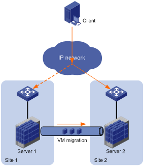

EVI enables long-distance virtual machine workload mobility and data mobility, disaster recovery, and business continuity. For example, virtual machines can move between data center sites without changing their IP addresses, so their movements are transparent to users and do not disrupt traffic.
Figure 1 Virtual machine migration

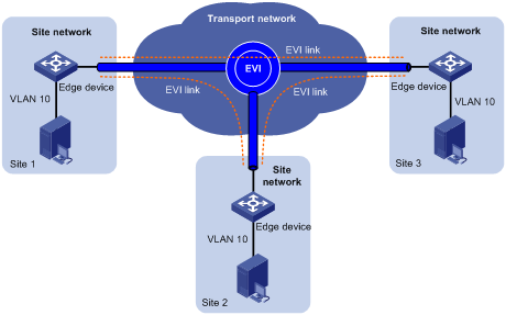

Network topologies
As shown in Figure 2, an EVI network has one edge device at each site. These sites are connected through virtual links and run the EVI IS-IS protocol to advertise their MAC address entries to each other. EVI maintains MAC routing information on the edge devices without changing the forwarding or routing information within the sites or the transport network.

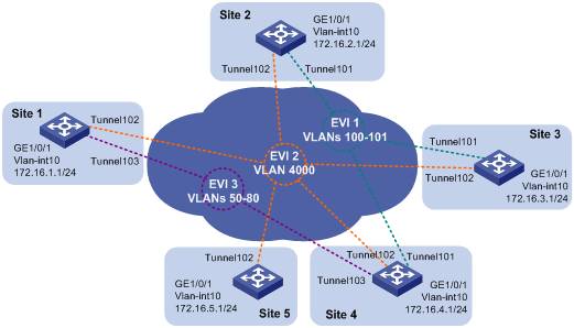

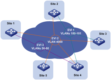

EVI supports multiple EVI networks on an edge device for extending different VLANs across the Layer 3 network. One EVI network can convey multiple VLANs, but one VLAN can map to only one EVI network. Each EVI network has separate network parameters and independently forwards traffic.
As shown in Figure 3, EVI network 1 extends VLAN 100 and VLAN 101 to Site 2, Site 3, and Site 4 for Web access traffic. EVI network 2 extends VLAN 4000 (the management VLAN) to all sites, and EVI network 3 extends VLANs 50 to 80 between Site 1 and Site 4 for database traffic.
Figure 3 Multiple EVI networks

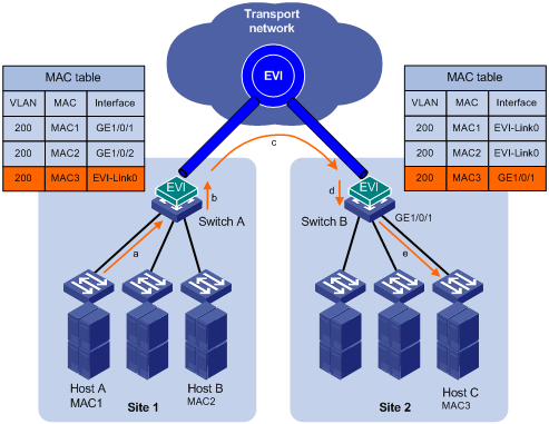

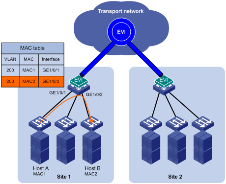

Unicast flow
For intra-site unicast flows, an edge device performs the typical MAC address table lookup, as shown in Figure 4.
Figure 4 Layer 2 forwarding in a site
The following forwarding process (see Figure 5) takes place for unicast flows between sites:
1.     The source edge device learns the source MAC address of the incoming Ethernet frame, and looks up the destination MAC address in its MAC table for the outgoing interface.
2.     If the outgoing interface is an EVI-Link interface instead of a physical port, the source edge device encapsulates the frame in a GRE header, and then adds an IP header and a link layer protocol header.
In the outer IP header, the source IP address is the source edge device's tunnel source IP address, and the destination IP address is the destination edge device's tunnel source IP address.
3.     The source edge device forwards the encapsulated packet out of the EVI link to the destination edge device across the IP transport network.
4.     The destination edge device removes the headers of the original Ethernet frame, looks up the destination MAC address in the MAC address table, and sends the frame out of the matching outgoing interface.
Figure 5 Layer 2 forwarding between sites

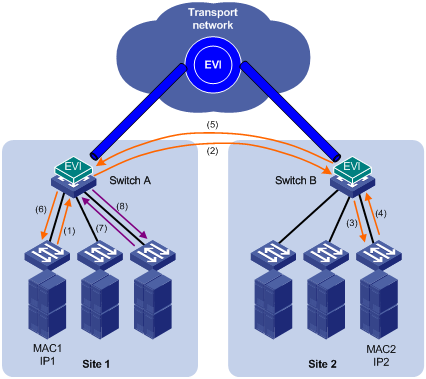

ARP flood suppression
ARP flood suppression reduces ARP request broadcasts on the EVI network by enabling edge devices to reply to ARP requests on behalf of remote-site hosts.
As shown in Figure 6, this feature snoops ARP packets on an EVI tunnel interface to populate the ARP flood suppression table with remote MAC addresses. If an ARP request has a matching entry, the local edge device replies to the request on behalf of the remote-site host. If no match is found, the edge device floods the request to the EVI network.
ARP flood suppression uses the following workflow:
1.     Host IP1 in site A sends an ARP request to obtain the MAC address of IP2.
2.     Site A's edge device floods the ARP requests out of all interfaces, including the EVI tunnel interfaces.
3.     Site B's edge device de-encapsulates the ARP request and broadcasts the request.
4.     IP2 sends an ARP reply back to site A's edge device over the EVI link.
5.     Site A's edge device creates an ARP cache entry for the remote MAC address and forwards the reply to the requesting host.
6.     Site A's edge device replies to all subsequent requests for the MAC address of IP2.

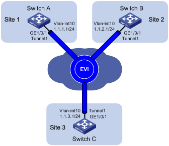

Single-homed EVI network configuration example
Network requirements
As shown in Figure 7.
·     Use EVI to extend VLANs 21 through 100 across site 1, site 2, and site 3 over an IPv4 network.
·     Use network ID 1 to identify the EVI network.
·     Use Switch A as an ENDS and all other edge switches as ENDCs for neighbor discovery.
·     Configure a routing policy on Switch A to advertise MAC addresses in VLANs 21 to 90 to the remote sites.
Figure 7 Network diagram
Configuration procedure
1.     Configure routes for the sites to reach each other. (Details not shown.)
2.     Configure Switch A:
# Configure the site ID.
<SwitchA> system-view
[SwitchA] evi site-id 1
# Configure the EVI tunnel source interface (VLAN-interface 10 in this example), and assign transport-facing physical interface GigabitEthernet 1/0/1 to the VLAN.
[SwitchA] vlan 10
[SwitchA-vlan10] port gigabitethernet 1/0/1
[SwitchA-vlan10] quit
[SwitchA-Vlan-interface10] ip address 1.1.1.1 24
[SwitchA-Vlan-interface10] quit
# Create an IPv4 EVI tunnel interface.
[SwitchA] interface tunnel 1 mode evi
# Set the network ID to 1 for the EVI tunnel interface.
[SwitchA-Tunnel1] evi network-id 1
# Specify the IP address of VLAN-interface 10 as the source IP of the EVI tunnel.
[SwitchA-Tunnel1] source 1.1.1.1
# Set the tunnel keepalive interval to 20 seconds and the maximum number of transmissions to 2.
[SwitchA-Tunnel1] keepalive 20 2
# Specify extended VLANs on the EVI tunnel interface.
[SwitchA-Tunnel1] evi extend-vlan 21 to 100
# Configure Switch A as an ENDS on the EVI tunnel interface.
[SwitchA-Tunnel1] evi neighbor-discovery server enable
[SwitchA-Tunnel1] quit
# Configure routing policy EVI-Filter to match MAC addresses in VLANs 21 to 90.
[SwitchA] route-policy EVI-Filter permit node 10
[SwitchA-route-policy-EVI-Filter-10] if-match vlan 21 to 90
[SwitchA-route-policy-EVI-Filter-10] quit
# Assign the policy to EVI IS-IS process 0.
[SwitchA] evi-isis 0
[SwitchA-evi-isis-0] filter-policy EVI-Filter
[SwitchA-evi-isis-0] quit
# Enable EVI on GigabitEthernet 1/0/1.
[SwitchA] interface gigabitethernet 1/0/1
[SwitchA-GigabitEthernet1/0/1] evi enable
[SwitchA-GigabitEthernet1/0/1] quit
3.     Configure Switch B:
<SwitchB> system-view
[SwitchB] evi site-id 2
[SwitchB] vlan 10
[SwitchB-vlan10] port gigabitethernet 1/0/1
[SwitchB-vlan10] quit
[SwitchB] interface vlan-interface 10
[SwitchB-Vlan-interface10] ip address 1.1.2.1 24
[SwitchB-Vlan-interface10] quit
[SwitchB] interface tunnel 1 mode evi
[SwitchB-Tunnel1] evi network-id 1
[SwitchB-Tunnel1] source 1.1.2.1
[SwitchB-Tunnel1] keepalive 20 2
[SwitchB-Tunnel1] evi extend-vlan 21 to 100
# Configure Switch B as an ENDC of Switch A.
[SwitchB-Tunnel1] evi neighbor-discovery client enable 1.1.1.1
[SwitchB-Tunnel1] quit
[SwitchB] interface gigabitethernet 1/0/1
[SwitchB-GigabitEthernet1/0/1] evi enable
[SwitchB-GigabitEthernet1/0/1] quit
4.     Configure Switch C:
<SwitchC> system-view
[SwitchC] evi site-id 3
[SwitchC] vlan 10
[SwitchC-vlan10] port gigabitethernet 1/0/1
[SwitchC-vlan10] quit
[SwitchC] interface vlan-interface 10
[SwitchC-Vlan-interface10] ip address 1.1.3.1 24
[SwitchC-Vlan-interface10] quit
[SwitchC] interface tunnel 1 mode evi
[SwitchC-Tunnel1] evi network-id 1
[SwitchC-Tunnel1] source 1.1.3.1
[SwitchC-Tunnel1] keepalive 20 2
[SwitchC-Tunnel1] evi extend-vlan 21 to 100
# Configure Switch C as an ENDC of Switch A.
[SwitchC-Tunnel1] evi neighbor-discovery client enable 1.1.1.1
[SwitchC-Tunnel1] quit
[SwitchC] interface gigabitethernet 1/0/1
[SwitchC-GigabitEthernet1/0/1] evi enable
[SwitchC-GigabitEthernet1/0/1] quit
1.     Verify the configuration on Switch A:
# Display information about the EVI tunnel interface.
[SwitchA] display interface tunnel 1
Tunnel1
Current state: UP
Line protocol state: UP
Description: Tunnel1 Interface
Bandwidth: 64 kbps
Maximum transmit unit: 64000
Internet protocol processing: Disabled
Tunnel source 1.1.1.1
Tunnel keepalive enabled, Period(20 s), Retries(2)
Network ID 1
Tunnel protocol/transport GRE_EVI/IP
Output queue - Urgent queuing: Size/Length/Discards 0/100/0
Output queue - Protocol queuing: Size/Length/Discards 0/500/0

# Display information about EVI links.
[SwitchA] display evi link interface tunnel 1
Interface     Status Source          Destination
EVI-Link0     UP     1.1.1.1         1.1.2.1
EVI-Link1     UP     1.1.1.1         1.1.3.1
# Display ENDS information.
[SwitchA] display evi neighbor-discovery server summary
Interface      Local Address   Network ID    Auth        Members   Vpn-instance
Tunnel1        1.1.1.1         1             disabled    3         [No Vrf]
# Display ENDC information.
[SwitchA] display evi neighbor-discovery client summary
                      Status: I-Init  E-Establish  P-Probe
Interface   Local Address   Server Address  Network ID  Reg  Auth      Status Vpn-instance
Tunnel1    1.1.1.1       1.1.1.1         1          15 disabled  E      [No Vrf]
# Display EVI neighbors registered with the ENDS.
[SwitchA] display evi neighbor-discovery server member
Interface: Tunnel1    Network ID: 1    Vpn-instance: [No Vrf]
IP Address: 1.1.1.1
Client Address  System ID         Expire    Created Time
1.1.1.1         000F-0001-0001    25        2013/01/01 00:00:43
1.1.2.1         000F-0001-0002    15        2013/01/01 01:00:46
1.1.3.1         000F-0001-0003    20        2013/01/01 01:02:13
# Display neighbor entries that Switch A has learned.
[SwitchA] display evi neighbor-discovery client member
Local Address: 1.1.1.1
Server Address: 1.1.1.1
Neighbor        System ID         Created Time           Expire    Status
1.1.2.1         000F-0001-0002    2013/01/01 12:12:12    13        Up
1.1.3.1         000F-0001-0003    2013/01/01 12:12:12    12        Up
# Verify that MAC addresses in VLAN 100 have been filtered by the routing policy on Switch A.
[SwitchA] display evi isis local-mac dynamic
Process ID: 0
  Tunnel interface: Tunnel1
  VLAN ID: 100
    MAC address: 0001-0100-0001 (Filtered)
    MAC address: 0001-0100-0002 (Filtered)
    MAC address: 0001-0100-0003 (Filtered)
# Verify that Switch A has remote MAC addresses in VLAN 100.
[SwitchA] display evi isis remote-mac
Process ID: 0
  VLAN ID: 100
    MAC address: 0002-0100-0001
      Interface: EVI-Link0
          Flags: 0x2
    MAC address: 0002-0100-0002
          Flags: 0x2
    MAC address: 0002-0100-0003
          Flags: 0x2
2.     Verify the configuration on Switch B:
[SwitchB] display interface tunnel 1
Tunnel1
Current state: UP
Bandwidth: 64 kbps
Tunnel source 1.1.2.1
Network ID 1
Output queue - FIFO queuing: Size/Length/Discards 0/75/0
Last clearing of counters: Never
Last 300 seconds input rate: 0 bytes/sec, 0 bits/sec, 0 packets/sec
Last 300 seconds output rate: 0 bytes/sec, 0 bits/sec, 0 packets/sec
Input: 0 packets, 0 bytes, 0 drops
Output: 0 packets, 0 bytes, 0 drops
[SwitchB] display evi link interface tunnel 1
EVI-Link0     UP     1.1.2.1         1.1.1.1
EVI-Link1     UP     1.1.2.1         1.1.3.1
[SwitchB] display evi neighbor-discovery client summary
Tunnel1    1.1.2.1       1.1.1.1         1         15   disabled  E    [No Vrf]
# Display neighbor entries that Switch B has learned.
[SwitchB] display evi neighbor-discovery client member
Local Address: 1.1.3.1
1.1.1.1        000F-0001-0001    2013/01/01 12:12:12    13        Up
1.1.3.1        000F-0001-0003    2013/01/01 12:12:12    13        Up
# Verify that MAC addresses in VLAN 100 are not filtered.
[SwitchB] display evi isis local-mac dynamic
Process ID: 0
  VLAN ID: 100
# Verify that Switch B does not have remote addresses in VLAN 100 from Switch A because VLAN 100 does not match the routing policy on Switch A. (Details not shown.)
3.     Verify the configuration on Switch C:
[SwitchC] display interface tunnel 1
Tunnel1
Current state: UP
Bandwidth: 64 kbps
Tunnel source 1.1.3.1
Network ID 1
# Display information about EVI links on Switch C.
[SwitchC] display evi link interface tunnel 1
EVI-Link0     UP     1.1.3.1         1.1.1.1
EVI-Link1     UP     1.1.3.1         1.1.2.1
[SwitchC] display evi neighbor-discovery client summary
Tunnel1    1.1.3.1       1.1.1.1         1         15  disabled  E     [No Vrf]
# Display neighbor entries that Switch C has learned.
[SwitchC] display evi neighbor-discovery client member
1.1.2.1        000F-0000-0002    2013/01/01 12:12:12    13        Up
# Verify the routing policy on Switch A is working correctly.
[SwitchC] display evi isis remote-mac
Process ID: 0
  VLAN ID: 100
      Interface: EVI-Link1
          Flags: 0x2
          Flags: 0x2
          Flags: 0x2
The output shows that Switch C can receive MAC addresses in VLAN 100 from Switch B but not from Switch A, because only Switch A filters VLAN 100.
4.     Verify that hosts in different sites can ping one another in the same extended VLAN. (Details not shown.)
Multiple-EVI-networks configuration example
Use EVI to connect the sites of the data center in Figure 8. To isolate different types of traffic and extend their VLANs to different sites, set up EVI networks as shown in Table 2.
Table 2 EVI networks
Traffic type
Network ID
Extended VLANs
Sites
Database
1
100, 101
2, 3, 4
Network management
2
4000
All sites
Web
3
50, 80
1, 4
In each EVI network, use the edge device at site 4 as an ENDS and all other edge devices as its ENDCs.
Figure 8 Network diagram
2.     Configure site 4:
<Site4> system-view
[Site4] evi site-id 4
# Configure the EVI tunnel source interface for all EVI tunnels (VLAN-interface 10 in this example), and assign transport-facing physical interface GigabitEthernet 1/0/1 to the VLAN.
[Site4] vlan 10
[Site4-vlan10] port gigabitethernet 1/0/1
[Site4-vlan10] quit
[Site4] interface vlan-interface 10
[Site4-Vlan-interface10] ip address 172.16.4.1 24
[Site4-Vlan-interface10] quit
# Configure the database EVI network.
[Site4] interface tunnel 101 mode evi
[Site4-Tunnel101] source 172.16.4.1
[Site4-Tunnel101] evi network-id 1
[Site4-Tunnel101] evi extend-vlan 100 101
[Site4-Tunnel101] evi neighbor-discovery server enable
[Site4-Tunnel101] quit
# Configure the network management EVI network.
[Site4] interface tunnel 102 mode evi
[Site4-Tunnel102] source 172.16.4.1
[Site4-Tunnel102] evi network-id 2
[Site4-Tunnel102] evi extend-vlan 4000
[Site4-Tunnel102] evi neighbor-discovery server enable
[Site4-Tunnel102] quit
# Configure the Web service EVI network.
[Site4] interface tunnel 103 mode evi
[Site4-Tunnel103] source 172.16.4.1
[Site4-Tunnel103] evi network-id 3
[Site4-Tunnel103] evi extend-vlan 50 to 80
[Site4-Tunnel103] evi neighbor-discovery server enable
[Site4-Tunnel103] quit
[Site4] interface gigabitethernet 1/0/1
[Site4-GigabitEthernet1/0/1] evi enable
[Site4-GigabitEthernet1/0/1] quit
3.     Configure site 1:
<Site1> system-view
[Site1] evi site-id 1
[Site1] vlan 10
[Site1-vlan10] port gigabitethernet 1/0/1
[Site1-vlan10] quit
[Site1] interface vlan-interface 10
[Site1-Vlan-interface10] ip address 172.16.1.1 24
[Site1-Vlan-interface10] quit
[Site1] interface tunnel 102 mode evi
[Site1-Tunnel102] source 172.16.1.1
[Site1-Tunnel102] evi network-id 2
[Site1-Tunnel102] evi extend-vlan 4000
[Site1-Tunnel102] evi neighbor-discovery client enable 172.16.4.1
[Site1-Tunnel102] quit
[Site1] interface tunnel 103 mode evi
[Site1-Tunnel103] source 172.16.1.1
[Site1-Tunnel103] evi network-id 3
[Site1-Tunnel103] evi extend-vlan 50 to 80
[Site1-Tunnel103] evi neighbor-discovery client enable 172.16.4.1
[Site1-Tunnel103] quit
[Site1] interface gigabitethernet 1/0/1
[Site1-GigabitEthernet1/0/1] evi enable
[Site1-GigabitEthernet1/0/1] quit
4.     Configure all the other sites in the same way that site 1 is configured. Make sure extended VLANs are correctly configured at each site. (Details not shown.)
# Display neighbors registered with the ENDS in each EVI network.
[Site4] display evi neighbor-discovery server member
Interface: Tunnel101    Network ID: 1    Vpn-instance: [No Vrf]
IP Address: 172.16.4.1
172.16.2.1      000F-0001-0002    25        2013/01/01 00:00:43
172.16.3.1      000F-0001-0003    15        2013/01/01 01:00:46
172.16.4.1      000F-0001-0004    20        2013/01/01 01:02:13
Interface: Tunnel102    Network ID: 2    Vpn-instance: [No Vrf]
172.16.1.1      000F-0001-0001    19        2013/01/01 00:19:31
172.16.5.1      000F-0001-0005    18        2013/01/01 01:04:32
Interface: Tunnel103    Network ID: 3    Vpn-instance: [No Vrf]
