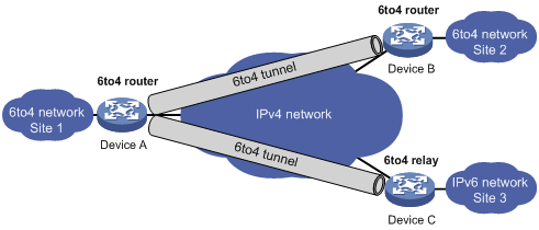

·     6to4 tunneling
¡     Ordinary 6to4 tunneling—A point-to-multipoint automatic tunnel. It is used to connect multiple isolated IPv6 networks over an IPv4 network.
¡     6to4 relay—Connects a 6to4 network and an IPv6 network that uses an IP prefix other than 2002::/16. A 6to4 relay router is a gateway that forwards packets from a 6to4 network to an IPv6 network.
As shown in Figure 2, 6to4 network Site 1 communicates with IPv6 network Site 3 over a 6to4 tunnel. Configure a static route on the border router (Device A) in the 6to4 network. The next hop address must be the 6to4 address of the 6to4 relay router (Device C). Device A forwards all packets destined for the IPv6 network over the 6to4 tunnel, and Device C then forwards them to the IPv6 network.
Figure 2 Principle of 6to4 tunneling and 6to4 relay

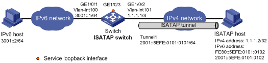

·     ISATAP tunneling—A point-to-multipoint automatic tunnel. It provides a solution to connect an IPv6 host and an IPv6 network over an IPv4 network. ISATAP tunnels are mainly used for communication between IPv6 routers or between an IPv6 host and an IPv6 router over an IPv4 network.
Figure 3 Principle of ISATAP tunneling

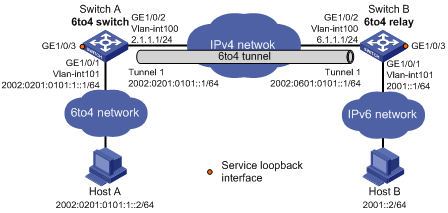

Configuration example
Network requirements

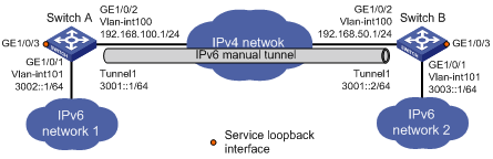

As shown in Figure 4, configure an IPv6 over IPv4 tunnel between Switch A and Switch B so the two IPv6 networks can reach each other over the IPv4 network. Because the tunnel destination IPv4 address cannot be automatically obtained from the destination IPv6 addresses, configure an IPv6 over IPv4 manual tunnel.
Figure 4 Network diagram
Configuration procedure
Make sure Switch A and Switch B have the corresponding VLAN interfaces created and can reach each other through IPv4.
·     Configure Switch A:
# Add GigabitEthernet 1/0/2 (the physical interface of the tunnel) to VLAN 100.
<SwitchA> system-view
[SwitchA] vlan 100
[SwitchA-vlan100] port gigabitethernet 1/0/2
[SwitchA-vlan100] quit
# Specify an IPv4 address for VLAN-interface 100.
[SwitchA-Vlan-interface100] ip address 192.168.100.1 255.255.255.0
# Add GigabitEthernet 1/0/1 to VLAN 101.
[SwitchA] vlan 101
[SwitchA-vlan101] port gigabitethernet 1/0/1
[SwitchA-vlan101] quit
# Specify an IPv6 address for VLAN-interface 101.
[SwitchA] interface vlan-interface 101
[SwitchA-Vlan-interface101] ipv6 address 3002::1 64
[SwitchA-Vlan-interface101] quit
# Create service loopback group 1, and specify its service type as tunnel.
[SwitchA] service-loopback group 1 type tunnel
# Add GigabitEthernet 1/0/3 to service loopback group 1.
[SwitchA] interface gigabitethernet 1/0/3
[SwitchA-GigabitEthernet1/0/3] port service-loopback group 1
[SwitchA-GigabitEthernet1/0/3] quit
# Create IPv6 over IPv4 manual tunnel interface Tunnel 1.
[SwitchA] interface tunnel 1 mode ipv6-ipv4
# Specify an IPv6 address for the tunnel interface.
[SwitchA-Tunnel1] ipv6 address 3001::1/64
# Specify VLAN-interface 100 as the source interface of the tunnel interface.
[SwitchA-Tunnel1] source vlan-interface 100
# Specify the destination address for the tunnel interface as the IP address of the VLAN-interface 100 on Switch B.
[SwitchA-Tunnel1] destination 192.168.50.1
[SwitchA-Tunnel1] quit
# Configure a static route destined for IPv6 network 2 through tunnel 1.
[SwitchA] ipv6 route-static 3003:: 64 tunnel 1
·     Configure Switch B:
<SwitchB> system-view
[SwitchB] vlan 100
[SwitchB-vlan100] port gigabitethernet 1/0/2
[SwitchB-vlan100] quit
[SwitchB-Vlan-interface100] ip address 192.168.50.1 255.255.255.0
[SwitchB] vlan 101
[SwitchB-vlan101] port gigabitethernet 1/0/1
[SwitchB-vlan101] quit
[SwitchB] interface vlan-interface 101
[SwitchB-Vlan-interface101] ipv6 address 3003::1 64
[SwitchB-Vlan-interface101] quit
[SwitchB] service-loopback group 1 type tunnel
[SwitchB] interface gigabitethernet 1/0/3
[SwitchB-GigabitEthernet1/0/3] port service-loopback group 1
[SwitchB-GigabitEthernet1/0/3] quit
[SwitchB] interface tunnel 1 mode ipv6-ipv4
[SwitchB-Tunnel1] ipv6 address 3001::2/64
[SwitchB-Tunnel1] source vlan-interface 100
# Specify the destination address for the tunnel interface as the IP address of VLAN-interface 100 of Switch A.
[SwitchB-Tunnel1] destination 192.168.100.1
[SwitchB-Tunnel1] quit
# Configure a static route destined for IPv6 network 1 through tunnel 1.
[SwitchB] ipv6 route-static 3002:: 64 tunnel 1
# Use the display ipv6 interface command to display tunnel interface status on Switch A and Switch B. Verify that the interface tunnel 1 is up. (Details not shown.)
# Verify that Switch B and Switch A can ping the IPv6 address of VLAN-interface 101 of each other. This example uses Switch A.
[SwitchA] ping ipv6 3003::1
Ping6(56 data bytes) 3001::1 --> 3003::1, press CTRL_C to break
56 bytes from 3003::1, icmp_seq=0 hlim=64 time=45.000 ms
56 bytes from 3003::1, icmp_seq=1 hlim=64 time=10.000 ms
56 bytes from 3003::1, icmp_seq=2 hlim=64 time=4.000 ms
56 bytes from 3003::1, icmp_seq=3 hlim=64 time=10.000 ms
56 bytes from 3003::1, icmp_seq=4 hlim=64 time=11.000 ms
--- Ping6 statistics for 3003::1 ---
round-trip min/avg/max/std-dev = 4.000/16.000/45.000/14.711 ms

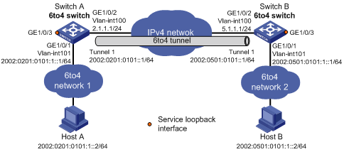

6to4 tunnel configuration example
As shown in Figure 5, configure a 6to4 tunnel between 6to4 switches Switch A and Switch B so the two hosts can reach each other over the IPv4 network.
Figure 5 Network diagram
Requirements analysis
To enable communication between 6to4 networks, configure 6to4 addresses for 6to4 switches and hosts in the 6to4 networks.
·     The IPv4 address of VLAN-interface 100 on Switch A is 2.1.1.1/24, and the corresponding 6to4 prefix is 2002:0201:0101::/48. Host A must use this prefix.
·     The IPv4 address of VLAN-interface 100 on Switch B is 5.1.1.1/24, and the corresponding 6to4 prefix is 2002:0501:0101::/48. Host B must use this prefix.
[SwitchA] vlan 100
[SwitchA-Vlan-interface100] ip address 2.1.1.1 24
[SwitchA] vlan 101
# Specify a 6to4 address for VLAN-interface 101.
[SwitchA-Vlan-interface101] ipv6 address 2002:0201:0101:1::1/64
# Assign GigabitEthernet 1/0/3 to service loopback group 1.
# Create 6to4 tunnel interface Tunnel 1.
[SwitchA] interface tunnel 1 mode ipv6-ipv4 6to4
[SwitchA-Tunnel1] ipv6 address 2002:0201:0101::1/64
# Specify the source interface as VLAN-interface 100 for the tunnel interface.
# Configure a static route destined for 2002::/16 through the tunnel interface.
[SwitchA] ipv6 route-static 2002:: 16 tunnel 1
[SwitchB] vlan 100
[SwitchB-Vlan-interface100] ip address 5.1.1.1 24
[SwitchB] vlan 101
[SwitchB-Vlan-interface101] ipv6 address 2002:0501:0101:1::1/64
[SwitchB] interface tunnel 1 mode ipv6-ipv4 6to4
[SwitchB-Tunnel1] ipv6 address 2002:0501:0101::1/64
[SwitchB] ipv6 route-static 2002:: 16 tunnel 1
# Verify that the Linux-running hosts Host A and Host B can ping each other.
D:\>ping6 -s 2002:201:101:1::2 2002:501:101:1::2
Pinging 2002:501:101:1::2
from 2002:201:101:1::2 with 32 bytes of data:
Reply from 2002:501:101:1::2: bytes=32 time=13ms
Reply from 2002:501:101:1::2: bytes=32 time=1ms
Reply from 2002:501:101:1::2: bytes=32 time<1ms
Ping statistics for 2002:501:101:1::2:
    Minimum = 0ms, Maximum = 13ms, Average = 3ms
6to4 relay configuration example
As shown in Figure 6, Switch A is a 6to4 switch, and 6to4 addresses are used on the connected IPv6 network. Switch B acts as a 6to4 relay switch and is connected to the IPv6 network (2001::/16). Configure a 6to4 tunnel between Switch A and Switch B to make Host A and Host B reachable to each other.
The configuration on a 6to4 relay switch is similar to that on a 6to4 switch. To enable communication between the 6to4 network and the IPv6 network, configure a route destined for the IPv6 network on the 6to4 switch. The IPv4 address of VLAN-interface 100 on the relay switch is 6.1.1.1/24 and its corresponding 6to4 prefix is 2002:0601:0101::/48. The next hop of the static route must be an address using this prefix.
Figure 6 Network diagram
[SwitchA] vlan 100
[SwitchA-Vlan-interface100] ip address 2.1.1.1 255.255.255.0
[SwitchA] vlan 101
# Configure a static route destined for the 6to4 relay switch.
[SwitchA] ipv6 route-static 2002:0601:0101:: 64 tunnel 1
# Configure a default route to reach the IPv6 network, which specifies the 6to4 address of the 6to4 relay switch as the next hop.
[SwitchA] ipv6 route-static :: 0 2002:0601:0101::1
[SwitchB] vlan 100
[SwitchB-Vlan-interface100] ip address 6.1.1.1 255.255.255.0
[SwitchB] vlan 101
[SwitchB-Vlan-interface101] ipv6 address 2001::1/16
[SwitchB-Tunnel1] ipv6 address 2002:0601:0101::1/64
D:\>ping6 -s 2002:201:101:1::2 2001::2
Pinging 2001::2
Reply from 2001::2: bytes=32 time=13ms
Reply from 2001::2: bytes=32 time=1ms
Reply from 2001::2: bytes=32 time<1ms
Ping statistics for 2001::2:
As shown in Figure 7, configure an ISATAP tunnel between the switch and the ISATAP host so the ISATAP host in the IPv4 network can access the IPv6 network.
Figure 7 Network diagram
·     Configure the switch:
# Add GigabitEthernet 1/0/1 to VLAN 100.
<Switch> system-view
[Switch] vlan 100
[Switch-vlan100] port gigabitethernet 1/0/1
[Switch-vlan100] quit
# Specify an IPv6 address for VLAN-interface 100.
[Switch-Vlan-interface100] ipv6 address 3001::1/64
# Add GigabitEthernet 1/0/2 (the physical interface of the tunnel) to VLAN 101.
[Switch] vlan 101
[Switch-vlan101] port gigabitethernet 1/0/2
[Switch-vlan101] quit
# Specify an IPv4 address for VLAN-interface 101.
[Switch] interface vlan-interface 101
[Switch-Vlan-interface101] ip address 1.1.1.1 255.0.0.0
[Switch-Vlan-interface101] quit
[Switch] service-loopback group 1 type tunnel
[Switch] interface gigabitethernet 1/0/3
[Switch-GigabitEthernet1/0/3] port service-loopback group 1
[Switch-GigabitEthernet1/0/3] quit
# Create ISATAP tunnel interface Tunnel 1.
[Switch] interface tunnel 1 mode ipv6-ipv4 isatap
# Specify an EUI-64 IPv6 address for the tunnel interface.
[Switch-Tunnel1] ipv6 address 2001:: 64 eui-64
# Specify VLAN-interface 101 as the source interface of the tunnel interface.
[Switch-Tunnel1] source vlan-interface 101
# Disable RA message suppression so that the ISATAP host can acquire information such as the address prefix from the RA message advertised by the ISATAP switch.
[Switch-Tunnel1] undo ipv6 nd ra halt
[Switch-Tunnel1] quit
·     Configure the ISATAP host:
Configurations on the ISATAP host vary by operating system. The following configuration is performed on Windows XP.
# Install IPv6.
C:\>ipv6 install
# On a host running Windows XP, the ISATAP interface is typically interface 2. Display information about the ISATAP interface.
C:\>ipv6 if 2
Interface 2: Automatic Tunneling Pseudo-Interface
  Guid {48FCE3FC-EC30-E50E-F1A7-71172AEEE3AE}
  does not use Neighbor Discovery
  does not use Router Discovery
  routing preference 1
  EUI-64 embedded IPv4 address: 0.0.0.0
  router link-layer address: 0.0.0.0
    preferred link-local fe80::5efe:1.1.1.2, life infinite
  link MTU 1280 (true link MTU 65515)
  current hop limit 128
  reachable time 42500ms (base 30000ms)
  retransmission interval 1000ms
  DAD transmits 0
  default site prefix length 48
# Specify an IPv4 address for the ISATAP switch.
C:\>netsh interface ipv6 isatap set router 1.1.1.1
# Display information about the ISATAP interface.
C:\>ipv6 if 2
  uses Router Discovery
  EUI-64 embedded IPv4 address: 1.1.1.2
  router link-layer address: 1.1.1.1
    preferred global 2001::5efe:1.1.1.2, life 29d23h59m46s/6d23h59m46s (public)
  link MTU 1500 (true link MTU 65515)
  current hop limit 255
  DAD transmits 0
The host has obtained the address prefix 2001::/64 and has automatically generated the global unicast address 2001::5efe:1.1.1.2. The message "uses Router Discovery" indicates that the router discovery feature is enabled on the host.
# Display information about IPv6 routes on the host.
C:\>ipv6 rt
2001::/64 -> 2 pref 1if+8=9 life 29d23h59m43s (autoconf)
::/0 -> 2/fe80::5efe:1.1.1.1 pref 1if+256=257 life 29m43s (autoconf)
·     On the IPv6 host, configure a route to the ISATAP switch.
C:\>netsh interface ipv6 set route 2001::/64 5 3001::1
# Verify that the ISATAP host can ping the IPv6 host.
C:\>ping 3001::2
Pinging 3001::2 with 32 bytes of data:
Reply from 3001::2: time=1ms
Ping statistics for 3001::2:

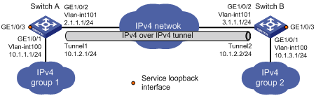

As shown in Figure 9, the two subnets IPv4 group 1 and IPv4 group 2 use private IPv4 addresses. Configure an IPv4 over IPv4 tunnel between Switch A and Switch B to make the two subnets reachable to each other.
Figure 9 Network diagram
[SwitchA] vlan 100
[SwitchA-vlan100] port gigabitethernet 1/0/1
[SwitchA-Vlan-interface100] ip address 10.1.1.1 255.255.255.0
[SwitchA] vlan 101
[SwitchA-vlan101] port gigabitethernet 1/0/2
[SwitchA-Vlan-interface101] ip address 2.1.1.1 255.255.255.0
# Create IPv4 over IPv4 tunnel interface Tunnel 1.
[SwitchA] interface tunnel 1 mode ipv4-ipv4
# Specify an IPv4 address for the tunnel interface.
[SwitchA-Tunnel1] ip address 10.1.2.1 255.255.255.0
# Specify the IP address of VLAN-interface 101 as the source address for the tunnel interface.
[SwitchA-Tunnel1] source 2.1.1.1
# Specify the IP address of VLAN-interface 101 on Switch B as the destination address for the tunnel interface.
[SwitchA-Tunnel1] destination 3.1.1.1
# Configure a static route destined for IPv4 group 2 through the tunnel interface.
[SwitchA] ip route-static 10.1.3.0 255.255.255.0 tunnel 1
[SwitchB] vlan 100
[SwitchB-vlan100] port gigabitethernet 1/0/1
[SwitchB-Vlan-interface100] ip address 10.1.3.1 255.255.255.0
[SwitchB] vlan 101
[SwitchB-vlan101] port gigabitethernet 1/0/2
[SwitchB-Vlan-interface101] ip address 3.1.1.1 255.255.255.0
# Create IPv4 over IPv4 tunnel interface Tunnel 2.
[SwitchB] interface tunnel 2 mode ipv4-ipv4
[SwitchB-Tunnel2] ip address 10.1.2.2 255.255.255.0
[SwitchB-Tunnel2] source 3.1.1.1
# Specify the IP address of VLAN-interface 101 on Switch A as the destination address for the tunnel interface.
[SwitchB-Tunnel2] destination 2.1.1.1
[SwitchB-Tunnel2] quit
# Configure a static route destined for IPv4 group 1 through the tunnel interface.
[SwitchB] ip route-static 10.1.1.0 255.255.255.0 tunnel 2
# Use the display interface tunnel command to display the status of the tunnel interfaces on Switch A and Switch B. Verify that the tunnel interfaces are up. (Details not shown.)
# Verify that Switch A and Switch B can ping the IPv4 address of the peer interface VLAN-interface 100. This example uses Switch A.
[SwitchA] ping -a 10.1.1.1 10.1.3.1
Ping 10.1.3.1 (10.1.3.1) from 10.1.1.1: 56 data bytes, press CTRL_C to break
56 bytes from 10.1.3.1: icmp_seq=0 ttl=255 time=2.000 ms
56 bytes from 10.1.3.1: icmp_seq=1 ttl=255 time=1.000 ms
56 bytes from 10.1.3.1: icmp_seq=2 ttl=255 time=0.000 ms
56 bytes from 10.1.3.1: icmp_seq=3 ttl=255 time=1.000 ms
56 bytes from 10.1.3.1: icmp_seq=4 ttl=255 time=1.000 ms
--- Ping statistics for 10.1.3.1 ---
round-trip min/avg/max/std-dev = 0.000/1.000/2.000/0.632 ms

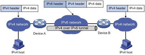

IPv4 over IPv6 tunneling
Overview
Implementation
IPv4 over IPv6 tunneling adds an IPv6 header to IPv4 packets so that the IPv4 packets can pass an IPv6 network through a tunnel to realize interworking between isolated IPv4 networks.
Figure 10 IPv4 over IPv6 tunnel
Figure 10 shows the encapsulation and de-encapsulation processes.
·     Encapsulation:
a.     Upon receiving an IPv4 packet, Device A delivers it to the IPv4 protocol stack.
b.     The IPv4 protocol stack uses the destination address of the packet to determine the egress interface. If the egress interface is the tunnel interface, the IPv4 protocol stack delivers the packet to the tunnel interface.
c.     The tunnel interface adds an IPv6 header to the original IPv4 packet and delivers the packet to the IPv6 protocol stack.
d.     The IPv6 protocol stack uses the destination IPv6 address of the packet to look up the routing table, and then sends it out.
·     De-encapsulation:
a.     Upon receiving the IPv6 packet from the attached IPv6 network, Device B delivers the packet to the IPv6 protocol stack to examine the protocol type encapsulated in the data portion of the packet.
b.     If the protocol type is IPv4, the IPv6 protocol stack delivers the packet to the tunneling module.
c.     The tunneling module removes the IPv6 header and delivers the remaining IPv4 packet to the IPv4 protocol stack.
d.     The IPv4 protocol stack forwards the IPv4 packet.
Tunnel modes
Only the IPv4 over IPv6 manual tunnel mode is available.
An IPv4 over IPv6 manual tunnel is a point-to-point link and its source and destination IPv6 addresses are manually configured. You can establish an IPv4 over IPv6 manual tunnel to connect isolated IPv4 networks over an IPv6 network.
Configuring an IPv4 over IPv6 manual tunnel
Follow these guidelines when you configure an IPv4 over IPv6 manual tunnel:
·     The tunnel destination address specified on the local device must be identical with the tunnel source address specified on the tunnel peer device.
·     Do not specify the same source and destination addresses for local tunnel interfaces in the same tunnel mode.
·     To ensure correct packet forwarding, identify whether the destination IPv4 network and the IPv4 address of the local tunnel interface are on the same subnet. If they are not, configure a route reaching the destination IPv4 network through the tunnel interface. You can configure the route by using one of the following methods:
¡     Configure a static route, and specify the local tunnel interface as the egress interface or specify the IPv6 address of the peer tunnel interface as the next hop.
¡     Enable a dynamic routing protocol on both tunnel interfaces to achieve the same purpose.
For more information about route configuration, see Layer 3—IP Routing Configuration Guide.
To configure an IPv4 over IPv6 manual tunnel:
Step

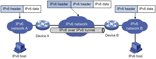

IPv6 over IPv6 tunneling
Overview
IPv6 over IPv6 tunneling (RFC 2473) enables isolated IPv6 networks to communicate with each other over another IPv6 network. For example, two isolated IPv6 networks that do not want to show their addresses to the Internet can use an IPv6 over IPv6 tunnel to communicate with each other.
Figure 12 Principle of IPv6 over IPv6 tunneling
Figure 12 shows the encapsulation and de-encapsulation processes.
·     Encapsulation:
a.     After receiving an IPv6 packet, Device A submits it to the IPv6 protocol stack.
b.     The IPv6 protocol stack uses the destination IPv6 address of the packet to find the egress interface. If the egress interface is the tunnel interface, the stack delivers it to the tunnel interface.
c.     After receiving the packet, the tunnel interface adds an IPv6 header to it and submits it to the IPv6 protocol stack.
d.     The IPv6 protocol stack forwards the packet according to its destination IPv6 address.
·     De-encapsulation:
a.     Upon receiving the IPv6 packet, Device B delivers it to the IPv6 protocol stack.
b.     The IPv6 protocol stack checks the protocol type of the data portion encapsulated in the IPv6 packet. If the encapsulation protocol is IPv6, the stack delivers the packet to the tunnel module.
c.     The tunnel module de-encapsulates the packet and sends it back to the IPv6 protocol stack.
d.     The IPv6 protocol stack forwards the IPv6 packet.
