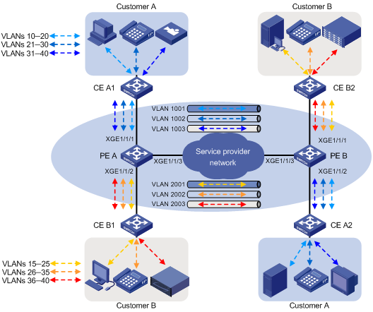

Network requirements
As shown in Figure 1:
·     Customer A and Customer B each have two branches that require Layer 2 connectivity over the service provider network.
·     Both customers have three types of traffic. For each customer, the service provider assigns one SVLAN by traffic type.
Configure one-to-two VLAN mapping on each customer-side port of PE A and PE B to meet the following requirements:
·     The service provider adds an SVLAN tag to packets from customer networks based on the traffic type, as described in Table 1 and Figure 2.
·     The SVLAN tag uses the same 802.1p priority as the CVLAN tag.
Figure 1 Network diagram

Figure 2 Required traffic pattern in the service provider network
Requirements analysis
To support multiple SVLANs and send traffic to the customer networks with the SVLAN tag removed, perform the following tasks on the customer-side ports:
1.     Configure the link type of the ports as hybrid.
2.     Assign the ports to the SVLANs as untagged VLAN members.
For the SVLAN tag to use the same 802.1p priority as the CVLAN tag, configure the customer-side port to use the 802.1p priority in incoming packets for priority mapping.

 port hybrid vlan 10 to 40 tagged
 port hybrid vlan 1001 to 1003 untagged
 vlan mapping nest range 10 to 20 nested-vlan 1001
 vlan mapping nest range 21 to 30 nested-vlan 1002
 vlan mapping nest range 31 to 40 nested-vlan 1003
 qos trust dot1p
interface Ten-GigabitEthernet1/1/2
 port link-type hybrid
 undo port hybrid vlan 1
 port hybrid vlan 15 to 40 tagged
 port hybrid vlan 2001 to 2003 untagged
 vlan mapping nest range 15 to 25 nested-vlan 2001
 vlan mapping nest range 26 to 35 nested-vlan 2002
 vlan mapping nest range 36 to 40 nested-vlan 2003
 qos trust dot1p
interface Ten-GigabitEthernet1/1/3
 port link-type trunk
 undo port trunk permit vlan 1
 port trunk permit vlan 1001 to 1003 2001 to 2003
·     PE B:
vlan 10 to 40
vlan 1001 to 1003
vlan 2001 to 2003
interface Ten-GigabitEthernet1/1/1
 qos trust dot1p
 qos trust dot1p

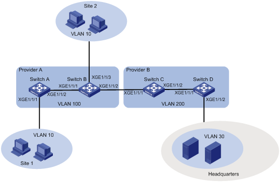

Example: Configuring two-to-two VLAN mapping
As shown in Figure 3:
·     A company assigns its branch sites (Site 1 and Site 2) to VLAN 10, and the headquarters provides services in VLAN 30.
·     Service provider A uses SVLAN 100 to transmit VLAN 10 traffic for the branch sites.
·     Service provider B uses SVLAN 200 to transmit VLAN 30 traffic for the headquarters.
Configure two-to-two VLAN mapping to permit the two branch sites to access VLAN 30 of the headquarters without changing their VLAN assignment.
Figure 3 Network diagram
Software version used
This configuration example was created and verified on S7500EXS-CMW710-R7178.
Configure two-to-two VLAN mapping on one of the edge devices between the two service provider networks. This example uses Switch C.
Configuration procedures
Configuring Switch A
# Create SVLAN 100.
<SwitchA> system-view
[SwitchA] vlan 100
[SwitchA-vlan100] quit
# Assign Ten-GigabitEthernet 1/1/1 to VLAN 100.
[SwitchA] interface ten-gigabitethernet 1/1/1
[SwitchA-Ten-GigabitEthernet1/1/1] port access vlan 100
# Configure QinQ on Ten-GigabitEthernet 1/1/1.
[SwitchA-Ten-GigabitEthernet1/1/1] qinq enable
[SwitchA-Ten-GigabitEthernet1/1/1] quit
# Configure the network-side port Ten-GigabitEthernet 1/1/2 as a trunk port.
[SwitchA] interface ten-gigabitethernet 1/1/2
[SwitchA-Ten-GigabitEthernet1/1/2] port link-type trunk
# Assign Ten-GigabitEthernet 1/1/2 to VLAN 100.
[SwitchA-Ten-GigabitEthernet1/1/2] port trunk permit vlan 100
# Remove Ten-GigabitEthernet 1/1/2 from VLAN 1.
[SwitchA-Ten-GigabitEthernet1/1/2] undo port trunk permit vlan 1
[SwitchA-Ten-GigabitEthernet1/1/2] quit
Configuring Switch B
# Create SVLAN 100.
<SwitchB> system-view
[SwitchB] vlan 100
[SwitchB-vlan100] quit
# Assign Ten-GigabitEthernet 1/1/3 to VLAN 100.
[SwitchB] interface ten-gigabitethernet 1/1/3
[SwitchB-Ten-GigabitEthernet1/1/3] port access vlan 100
# Configure QinQ on Ten-GigabitEthernet 1/1/3.
[SwitchB-Ten-GigabitEthernet1/1/3] qinq enable
[SwitchB-Ten-GigabitEthernet1/1/3] quit
# Configure Ten-GigabitEthernet 1/1/1 as a trunk port.
[SwitchB] interface ten-gigabitethernet 1/1/1
[SwitchB-Ten-GigabitEthernet1/1/1] port link-type trunk
[SwitchB-Ten-GigabitEthernet1/1/1] port trunk permit vlan 100
# Remove Ten-GigabitEthernet 1/1/1 from VLAN 1.
[SwitchB-Ten-GigabitEthernet1/1/1] undo port trunk permit vlan 1
[SwitchB-Ten-GigabitEthernet1/1/1] quit
# Configure Ten-GigabitEthernet 1/1/2 as a trunk port.
[SwitchB] interface ten-gigabitethernet 1/1/2
[SwitchB-Ten-GigabitEthernet1/1/2] port link-type trunk
[SwitchB-Ten-GigabitEthernet1/1/2] port trunk permit vlan 100
[SwitchB-Ten-GigabitEthernet1/1/2] undo port trunk permit vlan 1
[SwitchB-Ten-GigabitEthernet1/1/2] quit
Configuring Switch C
# Create SVLANs 100 and 200.
<SwitchC> system-view
[SwitchC] vlan 100
[SwitchC-vlan100] quit
[SwitchC] vlan 200
[SwitchC-vlan200] quit
[SwitchC] interface ten-gigabitethernet 1/1/1
[SwitchC-Ten-GigabitEthernet1/1/1] port link-type trunk
# Assign Ten-GigabitEthernet 1/1/1 to VLANs 100 to 200.
[SwitchC-Ten-GigabitEthernet1/1/1] port trunk permit vlan 100 200
[SwitchC-Ten-GigabitEthernet1/1/1] undo port trunk permit vlan 1
# Configure a two-to-two VLAN mapping on Ten-GigabitEthernet 1/1/1 to map SVLAN 100 and CVLAN 10 to SVLAN 200 and CVLAN 30.
[SwitchC-Ten-GigabitEthernet1/1/1] vlan mapping tunnel 100 10 translated-vlan 200 30
[SwitchC-Ten-GigabitEthernet1/1/1] quit
[SwitchC] interface ten-gigabitethernet 1/1/2
[SwitchC-Ten-GigabitEthernet1/1/2] port link-type trunk
# Assign Ten-GigabitEthernet 1/1/2 to VLAN 200.
[SwitchC-Ten-GigabitEthernet1/1/2] port trunk permit vlan 200
[SwitchC-Ten-GigabitEthernet1/1/2] undo port trunk permit vlan 1
[SwitchC-Ten-GigabitEthernet1/1/2] quit
Configuring Switch D
# Create SVLAN 200.
<SwitchD> system-view
[SwitchD] vlan 200
[SwitchD-vlan200] quit
[SwitchD] interface ten-gigabitethernet 1/1/2
[SwitchD-Ten-GigabitEthernet1/1/2] port access vlan 200
# Configure QinQ on Ten-GigabitEthernet 1/1/2.
[SwitchD-Ten-GigabitEthernet1/1/2] qinq enable
[SwitchD-Ten-GigabitEthernet1/1/2] quit
[SwitchD] interface ten-gigabitethernet 1/1/1
[SwitchD-Ten-GigabitEthernet1/1/1] port link-type trunk
# Assign Ten-GigabitEthernet 1/1/1 to VLAN 200.
[SwitchD-Ten-GigabitEthernet1/1/1] port trunk permit vlan 200
[SwitchD-Ten-GigabitEthernet1/1/1] undo port trunk permit vlan 1
[SwitchD-Ten-GigabitEthernet1/1/1] quit
# Verify VLAN mapping information on Switch C.
[SwitchC] display vlan mapping
Interface Ten-GigabitEthernet1/1/1:
  Outer VLAN    Inner VLAN    Translated Outer VLAN    Translated Inner VLAN
  100           10            200                      30
Configuration files
·     Switch A:
vlan 100
 qinq enable
·     Switch B:
vlan 100
 qinq enable
 qinq enable
·     Switch C:
vlan 100
vlan 200
·     Switch D:
vlan 200
 qinq enable
