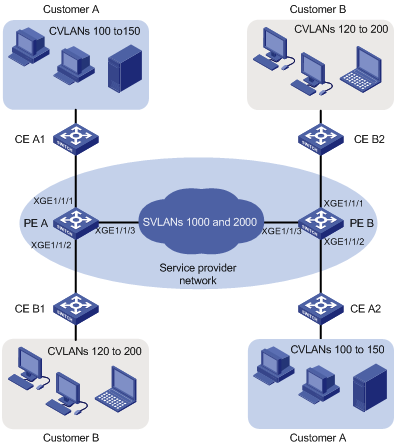

Network requirements
As shown in Figure 1:
·     The service provider assigns VLAN 1000 to Company A's VLANs 100 through 150.
·     The service provider assigns VLAN 2000 to Company B's VLANs 120 through 200.
Configure QinQ on PE A and PE B to transmit traffic in VLANs 1000 and 2000 for Company A and Company B, respectively.
Figure 1 Network diagram

When you configure QinQ, follow these restrictions and guidelines:
·     You only need to configure QinQ on customer-side ports of PEs.
·     The link type of the customer-side port can be access, hybrid, or trunk.
¡     If the link type is access, you must assign the port to the SVLAN.
¡     If the link type is trunk, you must assign the port to the SVLAN, and set the SVLAN ID as the PVID of the port.
¡     If the link type is hybrid, you must assign the port to the SVLAN as an untagged VLAN member, and set the SVLAN ID as the PVID of the port. The settings ensure that the port can forward traffic to the customer site with the SVLAN tag removed.
·     For QinQ frames to travel across the service provider network, you must perform the following tasks:
¡     Set the MTU to a minimum of 1504 bytes for each port on the path of QinQ frames. This value is the sum of the default Ethernet interface MTU (1500 bytes) and the length (4 bytes) of a CVLAN tag. The CVLAN tag of QinQ frames is treated as part of the payload during transmission.
¡     Configure all the ports on the forwarding path to allow frames from VLANs 1000 and 2000 to pass through without removing the VLAN tag.
