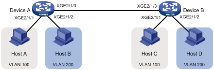

Example: Configuring port-based VLANs
Network requirements
As shown in Figure 1:
·     Host A and Host C belong to Department A. VLAN 100 is assigned to Department A.
·     Host B and Host D belong to Department B. VLAN 200 is assigned to Department B.
Configure port-based VLANs so that hosts only in the same department can communicate with each other.

1.     Configure Device A:
# Configure Ten-GigabitEthernet 2/1/1 through Ten-GigabitEthernet 2/1/3 to operate in bridge mode.
<DeviceA> system-view
[DeviceA] interface range ten-gigabitethernet 2/1/1 to ten-gigabitethernet 2/1/3
[DeviceA-if-range] port link-mode bridge
[DeviceA-if-range] quit
# Create VLAN 100, and assign Ten-GigabitEthernet 2/1/1 to VLAN 100.
[DeviceA] vlan 100
[DeviceA-vlan100] port ten-gigabitethernet 2/1/1
[DeviceA-vlan100] quit
# Create VLAN 200, and assign Ten-GigabitEthernet 2/1/2 to VLAN 200.
[DeviceA] vlan 200
[DeviceA-vlan200] port ten-gigabitethernet 2/1/2
[DeviceA-vlan200] quit
# Configure Ten-GigabitEthernet 2/1/3 as a trunk port, and assign it to VLANs 100 and 200.
[DeviceA] interface ten-gigabitethernet 2/1/3
[DeviceA-Ten-GigabitEthernet2/1/3] port link-type trunk
[DeviceA-Ten-GigabitEthernet2/1/3] port trunk permit vlan 100 200
2.     Configure Device B in the same way Device A is configured. (Details not shown.)

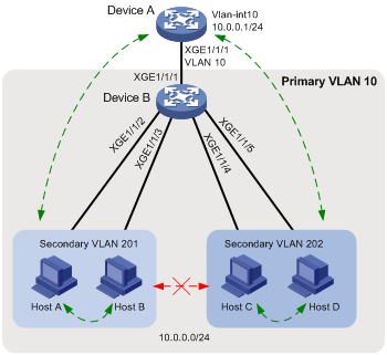

Example: Configuring the private VLAN
As shown in Figure 3:
·     The aggregation-layer device Device A assigns VLAN 10 to Device B. Hosts access the network through VLAN-interface 10.
·     Users connected to Device B are on the same subnet 10.0.0.0/24.
·     Host A and Host B are in the Marketing department. Host C and Host D are in the Finance department.
Configure the private VLAN feature to meet the following requirements:
·     Device A is only aware of the primary VLAN 10.
·     Hosts in the same secondary VLAN are interoperable at Layer 2.
·     Hosts in different secondary VLANs are isolated at Layer 2.
Figure 3 Network diagram
Requirements analysis
The private VLAN configuration is required only on Device B.
Software version used
This configuration example was created and verified on S7500EXS-CMW710-R7178.
The system default VLAN (VLAN 1) does not support the private VLAN configuration.
Configuration procedures
Configuring Device B
# Create VLAN 10 and configure it as a primary VLAN.
<DeviceB> system-view
[DeviceB] vlan 10
[DeviceB-vlan10] private-vlan primary
[DeviceB-vlan10] quit
# Create VLANs 201 and 202.
[DeviceB] vlan 201 to 202
# Associate primary VLAN 10 with secondary VLANs 201 and 202.
[DeviceB] vlan 10
[DeviceB-vlan10] private-vlan secondary 201 to 202
# Configure the uplink port Ten-GigabitEthernet 1/1/1 as a promiscuous port of VLAN 10.
[DeviceB] interface ten-gigabitethernet 1/1/1
[DeviceB-Ten-GigabitEthernet1/1/1] port private-vlan 10 promiscuous
[DeviceB-Ten-GigabitEthernet1/1/1] undo shutdown
[DeviceB-Ten-GigabitEthernet1/1/1] quit
# Assign downlink ports Ten-GigabitEthernet 1/1/2 and Ten-GigabitEthernet 1/1/3 to VLAN 201 as host ports.
[DeviceB] interface range ten-gigabitethernet 1/1/2 to ten-gigabitethernet 1/1/3
[DeviceB-if-range] port link-mode bridge
[DeviceB-if-range] port access vlan 201
[DeviceB-if-range] port private-vlan host
[DeviceB-if-range] undo shutdown
[DeviceB-if-range] quit
# Assign downlink ports Ten-GigabitEthernet 1/1/4 and Ten-GigabitEthernet 1/1/5 to VLAN 202 as host ports.
[DeviceB] interface range ten-gigabitethernet 1/1/4 to ten-gigabitethernet 1/1/5
[DeviceB-if-range] port access vlan 202
Configuring Device A
# Create VLAN 10.
[DeviceA] vlan 10
[DeviceA] quit
# Assign Ten-GigabitEthernet 1/1/1 to VLAN 10.
[DeviceA] interface ten-gigabitethernet 1/1/1
[DeviceA-Ten-GigabitEthernet1/1/1] port link-mode bridge
[DeviceA-Ten-GigabitEthernet1/1/1] port access vlan 10
[DeviceA-Ten-GigabitEthernet1/1/1] undo shutdown
[DeviceA-Ten-GigabitEthernet1/1/1] quit
# Create VLAN-interface 10, and assign IP address 10.0.0.1 to it.
[DeviceA] interface vlan-interface 10
[DeviceA-Vlan-interface10] ip address 10.0.0.1 24
[DeviceA-Vlan-interface10] undo shutdown
[DeviceA-Vlan-interface10] quit
# Verify that Device A can ping Host A, Host B, Host C, and Host D successfully. (Details not shown.)
# Display the ARP table of Device A.
[DeviceA] display arp
  Type: S-Static   D-Dynamic   O-Openflow   M-Multiport  I-Invalid
IP address      MAC address    VLAN     Interface                Aging Type
10.0.0.2        d485-64a1-7e4a 10       XGE1/1/1                 19    D
10.0.0.3        7446-a0aa-7774 10       XGE1/1/1                 19    D
10.0.0.4        6805-ca05-39ae 10       XGE1/1/1                 20    D
10.0.0.5        6805-ca05-414e 10       XGE1/1/1                 20    D
# Display the private VLAN configuration on Device B.
[DeviceB] display private-vlan
 Primary VLAN ID: 10
 Secondary VLAN ID: 201-202
 VLAN ID: 10
 VLAN type: Static
 Private VLAN type: Primary
 Route interface: Not configured
 Description: VLAN 0010
 Tagged ports:   None
 Untagged ports:
    Ten-GigabitEthernet1/1/1          Ten-GigabitEthernet1/1/2
    Ten-GigabitEthernet1/1/3          Ten-GigabitEthernet1/1/4
    Ten-GigabitEthernet1/1/5
 VLAN ID: 201
 VLAN type: Static
 Private VLAN type: Secondary
 Description: VLAN 0201
 Tagged ports:   None
 Untagged ports:
 VLAN ID: 202
 VLAN type: Static
 Description: VLAN 0202
 Tagged ports:   None
 Untagged ports:
    Ten-GigabitEthernet1/1/1          Ten-GigabitEthernet1/1/4
The output shows that:
·     The promiscuous port Ten-GigabitEthernet 1/1/1 is an untagged member of primary VLAN 10 and secondary VLANs 201 and 202.
·     Host ports Ten-GigabitEthernet 1/1/2 and Ten-GigabitEthernet 1/1/3 are untagged members of secondary VLANs 201.
·     Host ports Ten-GigabitEthernet 1/1/4 and Ten-GigabitEthernet 1/1/5 are untagged members of secondary VLANs 202.
# Verify that Hosts in the same secondary VLAN can ping each other, but they fail to ping hosts in the other secondary VLAN. (Details not shown.)
