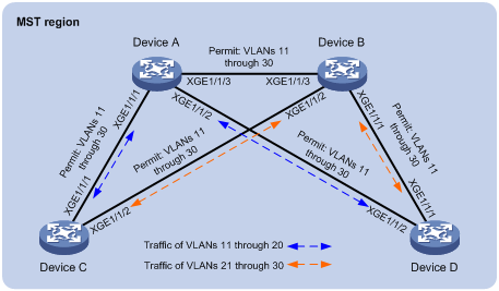

Network requirements
As shown in Figure 1, Device A and Device B operate at the core layer, and Device C and Device D operate at the distribution layer. The ports on the devices have the same path cost, and they all permit VLANs 11 through 30.
Configure MSTP to meet the following requirements:
·     Device A, Device B, Device C, and Device D belong to the same MST region.
·     MSTIs are used to share the traffic of VLANs 11 through 20 and of VLANs 21 through 30.
Figure 1 Network diagram

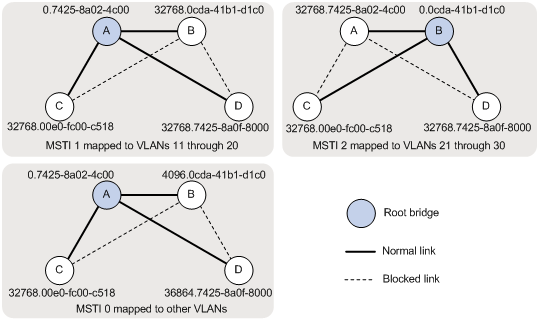

To use redundant links to share the traffic of different VLANs (as shown in Figure 2), perform the following tasks:
·     Configure Device A as the root bridge of MSTI 1.
·     Configure Device B as the root bridge of MIST 2.
·     Assign priorities to Device A, Device B, Device C, and Device D in MSTI 0 in descending order for Device A to be the regional root bridge.
Figure 2 MSTIs mapped to different VLANs

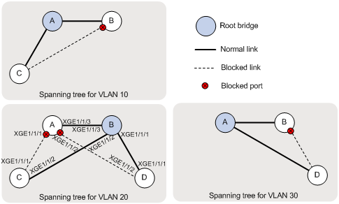

1.     Verify that Layer 2 loops have been eliminated in each MSTI:
Use the display stp brief command to display brief spanning tree information on each device.
# Display brief spanning tree information on Device A.
[DeviceA] display stp brief
 MST ID   Port                                Role  STP State   Protection
 0        Ten-GigabitEthernet1/1/1            DESI  FORWARDING  NONE
 0        Ten-GigabitEthernet1/1/2            DESI  FORWARDING  NONE
 0        Ten-GigabitEthernet1/1/3            DESI  FORWARDING  NONE
 1        Ten-GigabitEthernet1/1/1            DESI  FORWARDING  NONE
 1        Ten-GigabitEthernet1/1/2            DESI  FORWARDING  NONE
 1        Ten-GigabitEthernet1/1/3            DESI  FORWARDING  NONE
 2        Ten-GigabitEthernet1/1/1            ALTE  DISCARDING  NONE
 2        Ten-GigabitEthernet1/1/2            DESI  FORWARDING  NONE
 2        Ten-GigabitEthernet1/1/3            ROOT  FORWARDING  NONE
# Display brief spanning tree information on Device B.
[DeviceB] display stp brief
 0        Ten-GigabitEthernet1/1/3            ROOT  FORWARDING  NONE
 1        Ten-GigabitEthernet1/1/2            ALTE  DISCARDING  NONE
 1        Ten-GigabitEthernet1/1/3            ROOT  FORWARDING  NONE
 2        Ten-GigabitEthernet1/1/1            DESI  FORWARDING  NONE
 2        Ten-GigabitEthernet1/1/3            DESI  FORWARDING  NONE
# Display brief spanning tree information on Device C.
[DeviceC] display stp brief
 0        Ten-GigabitEthernet1/1/1            ROOT  FORWARDING  NONE
 0        Ten-GigabitEthernet1/1/2            ALTE  DISCARDING  NONE
 1        Ten-GigabitEthernet1/1/1            ROOT  FORWARDING  NONE
 2        Ten-GigabitEthernet1/1/2            ROOT  FORWARDING  NONE
# Display brief spanning tree information on Device D.
[DeviceD] display stp brief
 0        Ten-GigabitEthernet1/1/1            ALTE  DISCARDING  NONE
 0        Ten-GigabitEthernet1/1/2            ROOT  FORWARDING  NONE
 1        Ten-GigabitEthernet1/1/1            ALTE  DISCARDING  NONE
 1        Ten-GigabitEthernet1/1/2            ROOT  FORWARDING  NONE
 2        Ten-GigabitEthernet1/1/1            ROOT  FORWARDING  NONE
 2        Ten-GigabitEthernet1/1/2            ALTE  DISCARDING  NONE

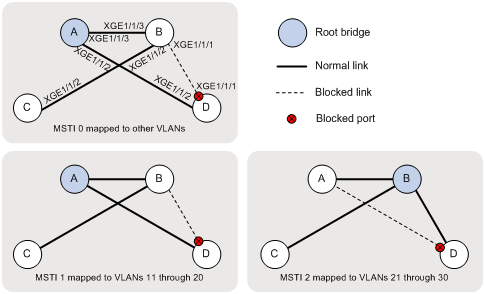

Based on the output, the topology for each MSTI is shown in Figure 3.
Figure 3 MSTI topologies

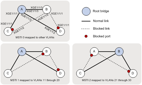

Based on the output, the topology for each MSTI is shown in Figure 4.
Figure 4 MSTI topologies

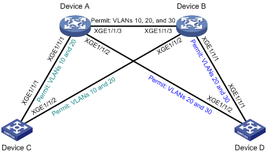

Example: Configuring PVST
As shown in Figure 5, Device A and Device B operate at the distribution layer, and Device C and Device D operate at the access layer. The ports on the devices have the same path cost.
Configure PVST to meet the following requirements:
·     Redundant links are used for load sharing.
·     Packets of each VLAN are forwarded along its spanning tree.
Figure 5 Network diagram
Requirements analysis

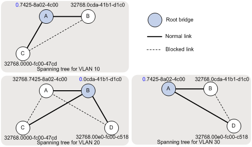

For traffic of different VLANs to be shared along the spanning trees in Figure 6, perform the following tasks:
·     Configure Device A as the root bridge of the spanning trees for VLAN 10 and VLAN 30.
·     Configure Device B as the root bridge of the spanning tree for VLAN 20.
Figure 6 VLAN spanning tree topologies
Software version used
This configuration example was created and verified on S7500EXS-CMW710-R7178.
Configuration procedures
Configuring Device A
# Create VLAN 10, VLAN 20, and VLAN 30.

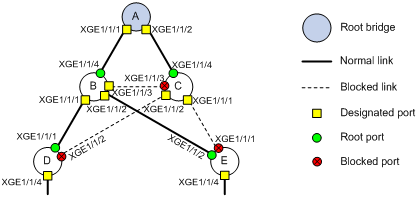

 VLAN ID  Port                                Role  STP State   Protection
 1        Ten-GigabitEthernet1/1/3            ALTE  DISCARDING  NONE
 10       Ten-GigabitEthernet1/1/1            DESI  FORWARDING  NONE
 10       Ten-GigabitEthernet1/1/3            DESI  FORWARDING  NONE
 20       Ten-GigabitEthernet1/1/1            ALTE  DISCARDING  NONE
 20       Ten-GigabitEthernet1/1/2            ALTE  DISCARDING  NONE
 20       Ten-GigabitEthernet1/1/3            ROOT  FORWARDING  NONE
 30       Ten-GigabitEthernet1/1/2            DESI  FORWARDING  NONE
 30       Ten-GigabitEthernet1/1/3            DESI  FORWARDING  NONE
 10       Ten-GigabitEthernet1/1/2            ALTE  DISCARDING  NONE
 10       Ten-GigabitEthernet1/1/3            ROOT  FORWARDING  NONE
 20       Ten-GigabitEthernet1/1/1            DESI  FORWARDING  NONE
 20       Ten-GigabitEthernet1/1/2            DESI  FORWARDING  NONE
 20       Ten-GigabitEthernet1/1/3            DESI  FORWARDING  NONE
 30       Ten-GigabitEthernet1/1/1            ALTE  DISCARDING  NONE
 30       Ten-GigabitEthernet1/1/3            ROOT  FORWARDING  NONE
 10       Ten-GigabitEthernet1/1/1            ROOT  FORWARDING  NONE
 10       Ten-GigabitEthernet1/1/2            DESI  FORWARDING  NONE
 20       Ten-GigabitEthernet1/1/2            ROOT  FORWARDING  NONE
 20       Ten-GigabitEthernet1/1/1            ROOT  FORWARDING  NONE
 30       Ten-GigabitEthernet1/1/1            DESI  FORWARDING  NONE
 30       Ten-GigabitEthernet1/1/2            ROOT  FORWARDING  NONE
Based on the output, the topology for each VLAN is shown in Figure 7.
Figure 7 VLAN spanning tree topologies

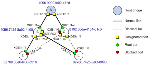

1.     Verify that Layer 2 loops have been eliminated in the network:
# Display the brief spanning tree information on Device A.
# Display the brief spanning tree information on Device B.
 0        Ten-GigabitEthernet1/1/4            ROOT  FORWARDING  NONE
# Display the brief spanning tree information on Device C.
 0        Ten-GigabitEthernet1/1/3            ALTE  DISCARDING  NONE
# Display the brief spanning tree information on Device D.
 0        Ten-GigabitEthernet1/1/4            DESI  FORWARDING  BPDU
# Display the brief spanning tree information on Device E.
[DeviceE] display stp brief
Based on the output, the topology for the network is shown in Figure 10.
Figure 10 Network topology

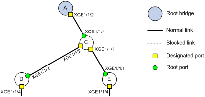

3.     Verify that traffic is forwarded through Device C when Device B fails:
# Reboot Device B. (Details not shown.)
# Display the brief spanning tree information on Device A, Device C, Device D, and Device E before Device B completes the reboot.
[DeviceA] dis stp brief
 0        Ten-GigabitEthernet1/1/2            DESI  FORWARDING  ROOT
[DeviceC] dis stp brief
 0        Ten-GigabitEthernet1/1/1            DESI  FORWARDING  ROOT
[DeviceD] dis stp brief
[DeviceE] dis stp brief
Based on the network topology, the topology for the network is shown in Figure 11.
Figure 11 Network topology
