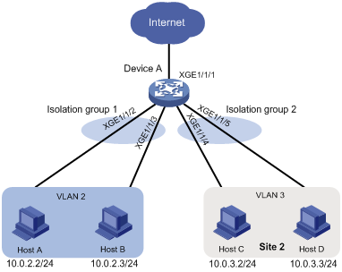

As shown in Figure 1, the company branches Site 1 and Site 2 transfer service traffic in VLAN 2 and VLAN 3. Device A connects to the Internet through Ten-GigabitEthernet 1/1/1.
Configure port isolation on Device A to meet the following requirements:
·     All hosts can access the Internet through Device A.
·     Host A and Host B are isolated from each other at Layer 2.
·     Host C and Host D are isolated from each other at Layer 2.
Figure 1 Network diagram

# Create isolation groups 1 and 2.
[DeviceA] port-isolate group 1
[DeviceA] port-isolate group 2
# Assign ports Ten-GigabitEthernet 1/1/2 and Ten-GigabitEthernet 1/1/3 to isolation group 1.
[DeviceA] interface ten-gigabitethernet 1/1/2
[DeviceA-Ten-GigabitEthernet1/1/2] port-isolate enable group 1
[DeviceA-Ten-GigabitEthernet1/1/2] quit
[DeviceA] interface ten-gigabitethernet 1/1/3
[DeviceA-Ten-GigabitEthernet1/1/3] port-isolate enable group 1
[DeviceA-Ten-GigabitEthernet1/1/3] quit
# Assign ports Ten-GigabitEthernet 1/1/4 and Ten-GigabitEthernet 1/1/5 to isolation group 2.
[DeviceA] interface ten-gigabitethernet 1/1/4
[DeviceA-Ten-GigabitEthernet1/1/4] port-isolate enable group 2
[DeviceA-Ten-GigabitEthernet1/1/4] quit
[DeviceA] interface ten-gigabitethernet 1/1/5
[DeviceA-Ten-GigabitEthernet1/1/5] port-isolate enable group 2
[DeviceA-Ten-GigabitEthernet1/1/5] quit
# Display information about all isolation groups.
[DeviceA] display port-isolate group
 Port isolation group information:
 Group ID: 1
 Group members:
Group ID: 2
 Group members:
The output shows that:
·     Ports Ten-GigabitEthernet 1/1/2 and Ten-GigabitEthernet 1/1/3 are in isolation group 1. As a result, Host A and Host B are isolated from each other at Layer 2.
·     Ports Ten-GigabitEthernet 1/1/4 and Ten-GigabitEthernet 1/1/4 are in isolation group 2. As a result, Host C and Host D are isolated from each other at Layer 2.
