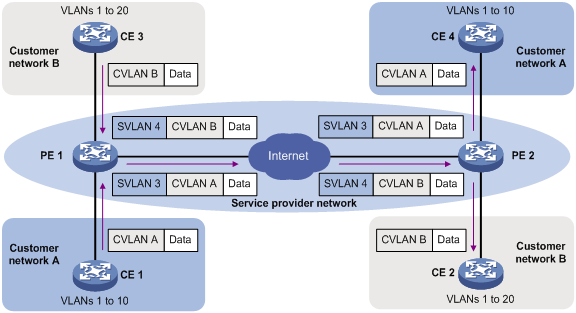

As shown in Figure 2, customer A has remote sites CE 1 and CE 4. Customer B has remote sites CE 2 and CE 3. The CVLANs of the two customers overlap. The service provider assigns SVLANs 3 and 4 to customers A and B, respectively.
When a tagged Ethernet frame from CE 1 arrives at PE 1, the PE tags the frame with SVLAN 3. The double-tagged Ethernet frame travels over the service provider network until it arrives at PE 2. PE 2 removes the SVLAN tag of the frame, and then sends the frame to CE 4.
Figure 2 Typical QinQ application scenario

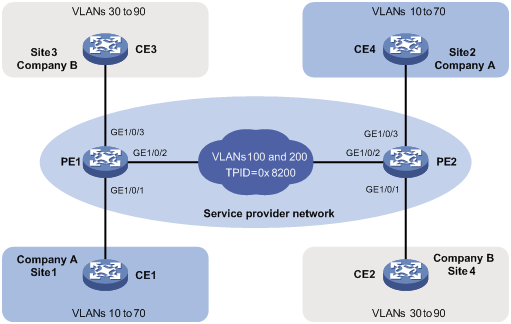

Basic QinQ configuration example
Network requirements
As shown in Figure 3:
·     The service provider assigns VLAN 100 to Company A's VLANs 10 through 70.
·     The service provider assigns VLAN 200 to Company B's VLANs 30 through 90.
·     The devices between PE 1 and PE 2 in the service provider network use a TPID value of 0x8200.
Configure QinQ on PE 1 and PE 2 to transmit traffic in VLANs 100 and 200 for Company A and Company B, respectively.
For the QinQ frames to be identified correctly, set the SVLAN TPID to 0x8200 on the service provider-side ports of PE 1 and PE 2.
Figure 3 Network diagram
Configuration procedure
1.     Configure PE 1:
# Configure GigabitEthernet 1/0/1 as a trunk port, and assign it to VLAN 100.
<PE1> system-view
[PE1] interface gigabitethernet 1/0/1
[PE1-GigabitEthernet1/0/1] port link-type trunk
[PE1-GigabitEthernet1/0/1] port trunk permit vlan 100
# Configure VLAN 100 as the PVID for GigabitEthernet 1/0/1.
[PE1-GigabitEthernet1/0/1] port trunk pvid vlan 100
# Enable QinQ on GigabitEthernet 1/0/1.
[PE1-GigabitEthernet1/0/1] qinq enable
[PE1-GigabitEthernet1/0/1] quit
# Configure GigabitEthernet 1/0/2 as a trunk port, and assign it to VLANs 100 and 200.
[PE1] interface gigabitethernet 1/0/2
[PE1-GigabitEthernet1/0/2] port link-type trunk
[PE1-GigabitEthernet1/0/2] port trunk permit vlan 100 200
# Set the TPID value in the SVLAN tags to 0x8200 on GigabitEthernet 1/0/2.
[PE1-GigabitEthernet1/0/2] qinq ethernet-type service-tag 8200
[PE1-GigabitEthernet1/0/2] quit
# Configure GigabitEthernet 1/0/3 as a trunk port, and assign it to VLAN 200.
[PE1] interface gigabitethernet 1/0/3
[PE1-GigabitEthernet1/0/3] port link-type trunk
[PE1-GigabitEthernet1/0/3] port trunk permit vlan 200
# Configure VLAN 200 as the PVID for GigabitEthernet 1/0/3.
[PE1-GigabitEthernet1/0/3] port trunk pvid vlan 200
# Enable QinQ on GigabitEthernet 1/0/3.
[PE1-GigabitEthernet1/0/3] qinq enable
[PE1-GigabitEthernet1/0/3] quit
2.     Configure PE 2:
# Configure GigabitEthernet 1/0/1 as a trunk port, and assign it to VLAN 200.
<PE2> system-view
[PE2] interface gigabitethernet 1/0/1
[PE2-GigabitEthernet1/0/1] port link-type trunk
[PE2-GigabitEthernet1/0/1] port trunk permit vlan 200
# Configure VLAN 200 as the PVID for GigabitEthernet 1/0/1.
[PE2-GigabitEthernet1/0/1] port trunk pvid vlan 200
[PE2-GigabitEthernet1/0/1] qinq enable
[PE2-GigabitEthernet1/0/1] quit
[PE2] interface gigabitethernet 1/0/2
[PE2-GigabitEthernet1/0/2] port link-type trunk
[PE2-GigabitEthernet1/0/2] port trunk permit vlan 100 200
[PE2-GigabitEthernet1/0/2] qinq ethernet-type service-tag 8200
[PE2-GigabitEthernet1/0/2] quit
# Configure GigabitEthernet 1/0/3 as a trunk port, and assign it to VLAN 100.
[PE2] interface gigabitethernet 1/0/3
[PE2-GigabitEthernet1/0/3] port link-type trunk
[PE2-GigabitEthernet1/0/3] port trunk permit vlan 100

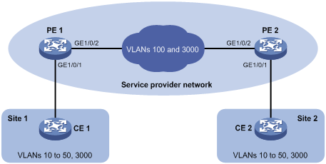

As shown in Figure 4:
·     The service provider assigns VLAN 100 to a company's VLANs 10 through 50.
·     VLAN 3000 is the dedicated VLAN of the company on the service provider network.
Configure QinQ on PE 1 and PE 2 to provide Layer 2 connectivity for CVLANs 10 through 50 over the service provider network.
Configure VLAN transparent transmission for VLAN 3000 on PE 1 and PE 2 to enable the hosts in VLAN 3000 to communicate without using an SVLAN.
Figure 4 Network diagram
1.     Configure PE 1:
# Configure GigabitEthernet 1/0/1 as a trunk port, and assign it to VLANs 100 and 3000.
<PE1> system-view
[PE1-GigabitEthernet1/0/1] port trunk permit vlan 100 3000
# Configure VLAN 100 as the PVID of GigabitEthernet 1/0/1.
# Enable transparent transmission for VLAN 3000 on GigabitEthernet 1/0/1.
[PE1-GigabitEthernet1/0/1] qinq transparent-vlan 3000
# Configure GigabitEthernet 1/0/2 as a trunk port, and assign it to VLANs 100 and 3000.
[PE1-GigabitEthernet1/0/2] port trunk permit vlan 100 3000
2.     Configure PE 2:
<PE2> system-view
[PE2-GigabitEthernet1/0/1] port trunk permit vlan 100 3000
[PE2-GigabitEthernet1/0/1] qinq transparent-vlan 3000
[PE2-GigabitEthernet1/0/2] port trunk permit vlan 100 3000
3.     Configure the devices between PE 1 and PE 2:
# Set the MTU to a minimum of 1504 bytes for each port on the path of QinQ frames. (Details not shown.)
# Configure all ports on the forwarding path to allow frames from VLANs 100 and 3000 to pass through without removing the VLAN tag. (Details not shown.)
