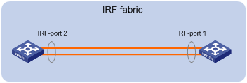

H3C Intelligent Resilient Framework (IRF) technology virtualizes multiple physical devices at the same layer into one virtual fabric to provide data center class availability and scalability. IRF virtualization technology offers processing power, interaction, unified management, and uninterrupted maintenance of multiple devices.
Figure 1 shows an IRF fabric that has two member devices, which appear as a single node to the upper-layer and lower-layer devices.
Figure 1 IRF application scenario

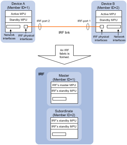

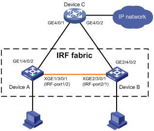

As shown in Figure 2, Device A and Device B form a two-chassis IRF fabric. The fabric has four MPUs (one active and three standbys), and two times the number of interface cards that a single device provides. The IRF fabric manages the physical and software resources of Device A and Device B in a centralized manner.
Figure 2 Two-chassis IRF fabric implementation schematic diagram

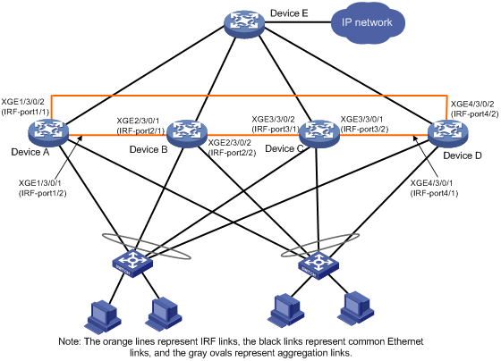

You can scale this two-chassis IRF fabric to a four-chassis IRF fabric for higher port density and availability, as shown in Figure 3.
Figure 3 Four-chassis IRF fabric implementation schematic diagram

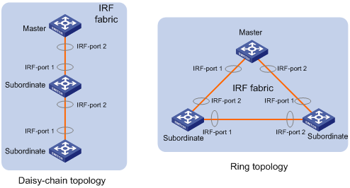

The device supports daisy-chain or ring topology for IRF fabrics. IRF does not support the full mesh topology. For information about connecting IRF member devices, see "Connecting IRF physical interfaces."

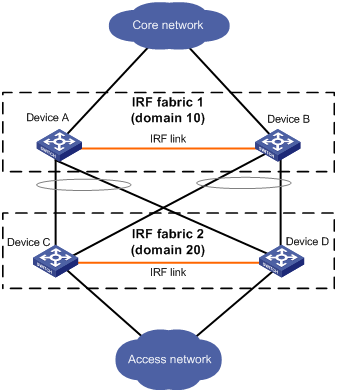

One IRF fabric forms one IRF domain. IRF uses IRF domain IDs to uniquely identify IRF fabrics and prevent IRF fabrics from interfering with one another.
As shown in Figure 4, IRF fabric 1 contains Device A and Device B, and IRF fabric 2 contains Device C and Device D. Both fabrics use the LACP aggregate links between them for MAD. When a member device receives an extended LACPDU for MAD, it checks the domain ID to see whether the packet is from the local IRF fabric. Then, the device can handle the packet correctly.
Figure 4 A network that contains two IRF domains

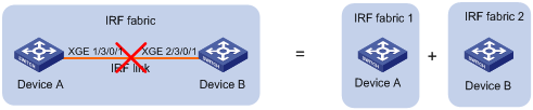

IRF split
IRF split occurs when an IRF fabric breaks up into multiple IRF fabrics because of IRF link failures, as shown in Figure 5. The split IRF fabrics operate with the same IP address. IRF split causes routing and forwarding problems on the network. To quickly detect a multi-active collision, configure a minimum of one MAD mechanism (see "Configuring MAD").
Figure 5 IRF split

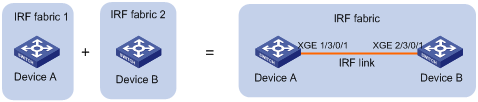

IRF merge
IRF merge occurs when two split IRF fabrics reunite or when two independent IRF fabrics are united, as shown in Figure 6.

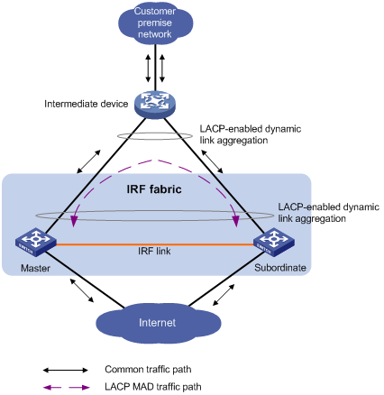

LACP MAD uses the following process to handle a multi-active collision:
1.     Compares the number of members in each fabric.
2.     Sets all fabrics to the Recovery state except the one that has the most members.
3.     Compares the member IDs of their masters if all IRF fabrics have the same number of members.
4.     Sets all fabrics to the Recovery state except the one that has the lowest numbered master.
5.     Shuts down all physical network ports in the Recovery-state fabrics except for the following ports:

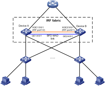

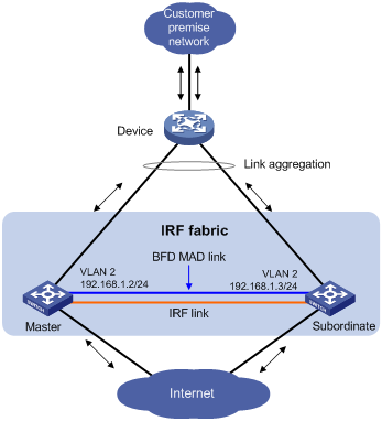

In contrast, BFD MAD, ARP MAD, and ND MAD do not compare the number of members in fabrics. These MAD mechanisms use the following process to handle a multi-active collision:
1.     Compare the member IDs of the masters in the IRF fabrics.
2.     Set all fabrics to the Recovery state except the one that has the lowest numbered master.
3.     Take the same action on the network ports in Recovery-state fabrics as LACP MAD.

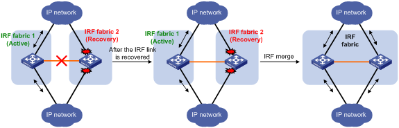

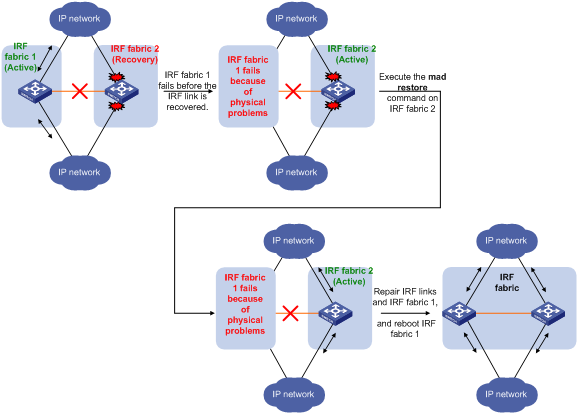

Failure recovery
To merge two split IRF fabrics, first repair the failed IRF link and remove the IRF link failure.
·     If the IRF fabric in Recovery state fails before the failure is recovered, repair the failed IRF fabric and the failed IRF link.
·     If the active IRF fabric fails before the failure is recovered, enable the inactive IRF fabric to take over the active IRF fabric. Then, recover the MAD failure.

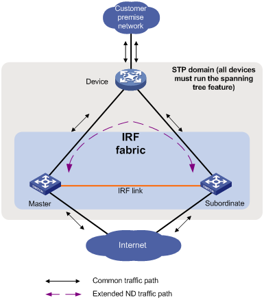

ND MAD
·     No intermediate device is required.
·     Intermediate device, if used, can come from any vendor.
·     Does not require MAD dedicated ports.
·     Detection speed is slower than BFD MAD and LACP MAD.
·     The spanning tree feature must be enabled.
Spanning tree-enabled non-link aggregation IPv6 network scenario.
LACP MAD
As shown in Figure 7, LACP MAD has the following requirements:
·     Every IRF member must have a link with an intermediate device.
·     All the links form a dynamic link aggregation group.
·     The intermediate device must be a device that supports extended LACP for MAD.
The IRF member devices send extended LACPDUs that convey a domain ID and an active ID. The intermediate device transparently forwards the extended LACPDUs received from one member device to all the other member devices.
·     If the domain IDs and active IDs sent by all the member devices are the same, the IRF fabric is integrated.
·     If the extended LACPDUs convey the same domain ID but different active IDs, a split has occurred. LACP MAD handles this situation as described in "Collision handling."
Figure 7 LACP MAD scenario
BFD MAD
On a two-chassis IRF fabric, BFD MAD can work with or without intermediate devices. On a three- or four-chassis IRF fabric, BFD MAD must work with an intermediate device.
BFD MAD can be used on common Ethernet ports or management Ethernet ports. If management Ethernet ports are used, you must select the first management Ethernet port on the active MPU of each member device for BFD MAD links.
Figure 8 shows a typical BFD MAD application scenario on common Ethernet ports. Figure 9 shows a typical BFD MAD application scenario on management Ethernet ports.
To use BFD MAD:
·     Set up dedicated BFD MAD link between each pair of IRF members or between each IRF member and the intermediate device. Do not use the BFD MAD links for any other purposes.
·     If common Ethernet ports are used for BFD MAD links, you must configure BFD MAD on a VLAN interface. Perform the following tasks:
¡     Assign the ports connected by BFD MAD links to the same VLAN. The VLAN must be unique across MDCs and the network.
¡     Create a VLAN interface for the VLAN, and assign a MAD IP address to each member on the VLAN interface.
On the intermediate device (if any), you must create the VLAN and assign the ports on the BFD MAD links to the VLAN.
·     If management Ethernet ports are used for BFD MAD, assign a MAD IP address to the management Ethernet port on each member. On the intermediate device (if any), assign the ports on the BFD links to the same VLAN.
The MAD addresses identify the member devices and must belong to the same subnet.
Figure 8 BFD MAD scenario for common Ethernet ports
Figure 9 BFD MAD scenario for management Ethernet ports
With BFD MAD, the master attempts to establish BFD sessions with other member devices by using its MAD IP address as the source IP address.
·     If the IRF fabric is integrated, only the MAD IP address of the master takes effect. The master cannot establish a BFD session with any other member. If you execute the display bfd session command, the state of the BFD sessions is Down.
·     When the IRF fabric splits, the IP addresses of the masters in the split IRF fabrics take effect. The masters can establish a BFD session. If you execute the display bfd session command, the state of the BFD session between the two devices is Up.

ND MAD
ND MAD detects multi-active collisions by using NS packets to transmit the IRF domain ID and the active ID.
You can set up ND MAD links between neighbor IRF member devices or between each IRF member device and an intermediate device (see Figure 11). If an intermediate device is used, you must also run the spanning tree protocol between the IRF fabric and the intermediate device.
Figure 11 ND MAD scenario
Each IRF member device compares the domain ID and the active ID in incoming NS packets with its domain ID and active ID:
·     If the domain IDs are different, the NS packet is from a different IRF fabric. The device does not continue to process the packet with the MAD mechanism.
·     If the domain IDs are the same, the device compares the active IDs:
¡     If the active IDs are different, the IRF fabric has split.
¡     If the active IDs are the same, the IRF fabric is integrated.
When you connect two neighboring IRF members, connect the physical interfaces of IRF-port 1 on one member to the physical interfaces of IRF-port 2 on the other (see Figure 12).
For example, you have four chassis: A, B, C, and D. IRF-port 1 and IRF-port 2 are represented by A1 and A2 on chassis A, represented by B1 and B2 on chassis B, and so on. To connect the four chassis into a ring topology of A-B-C-D(A), the IRF link cabling scheme must be one of the following:
·     A1-B2, B1-C2, C1-D2, and D1-A2.
·     A2-B1, B2-C1, C2-D1, and D2-A1.
Figure 12 Connecting IRF physical interfaces
Connect the devices into a daisy-chain topology or a ring topology. A ring topology is more reliable (see Figure 13). In ring topology, the failure of one IRF link does not cause the IRF fabric to split as in daisy-chain topology. Rather, the IRF fabric changes to a daisy-chain topology without interrupting network services.
To use the ring topology, you must have a minimum of three member devices.
Figure 13 Daisy-chain topology vs. ring topology

Configuring MAD
When you configure MAD, follow these restrictions and guidelines:
·     You can configure ARP MAD and ND MAD together in an IRF fabric for prompt IRF split detection.
¡     Do not configure LACP MAD together with BFD MAD, ARP MAD, or ND MAD, because they handle collisions differently.
¡     Do not configure BFD MAD together with ARP MAD or ND MAD. BFD MAD is exclusive with the spanning tree feature, but ARP MAD and ND MAD require the spanning tree feature.
·     If LACP MAD, ARP MAD, or ND MAD runs between two IRF fabrics, assign each fabric a unique IRF domain ID. (For BFD MAD, this task is optional.)
·     An IRF fabric has only one IRF domain ID.
¡     You can change the IRF domain ID by using the following commands: irf domain, mad enable, mad arp enable, or mad nd enable. The IRF domain IDs configured by using these commands overwrite each other.
¡     In an MDC environment, if you change the IRF domain ID in one MDC, the IRF domain IDs in all other MDCs change automatically. The irf domain command is available only on the default MDC. The mad enable, mad arp enable, and mad nd enable commands are available on any MDCs.
·     To prevent a port from being shut down when the IRF fabric transits to the Recovery state, use the mad exclude interface command. To bring up ports in a Recovery-state IRF fabric, use the mad restore command instead of the undo shutdown command. The mad restore command activates the Recovery-state IRF fabric.
Configuring LACP MAD
When you use LACP MAD, follow these guidelines:
·     If the intermediate device is also an IRF fabric, assign the two IRF fabrics different domain IDs for correct split detection.
·     Use dynamic link aggregation mode. MAD is LACP dependent. Even though LACP MAD can be configured on both static and dynamic aggregate interfaces, it takes effect only on dynamic aggregate interfaces.
·     Configure link aggregation settings on the intermediate device.
To configure LACP MAD:

Configuring BFD MAD on a VLAN interface
Configure BFD MAD on a VLAN interface if you use common Ethernet ports for BFD MAD.
When you use BFD MAD on a VLAN interface, follow these restrictions and guidelines:
Category
BFD MAD VLAN
·     Do not enable BFD MAD on VLAN-interface 1.
·     If you are using an intermediate device, perform the following tasks on both the IRF fabric and the intermediate device:
¡     Create a VLAN and VLAN interface for BFD MAD.
¡     Assign the ports of BFD MAD links to the BFD MAD VLAN.
·     Make sure the BFD MAD VLAN belongs to only one MDC. The VLAN ID is unique across MDCs.
·     Make sure the IRF fabrics on the network use different BFD MAD VLANs.
·     Make sure the BFD MAD VLAN contains only ports on the BFD MAD links.

Configuring BFD MAD on management Ethernet ports
When you use BFD MAD on management Ethernet ports, follow these restrictions and guidelines:
Category
Management Ethernet ports for BFD MAD
Use the first management Ethernet port on the active MPU of each member device to set up BFD MAD links.
Ports on the intermediate device for BFD MAD

¡     If the intermediate device is also an IRF fabric, assign the two IRF fabrics different domain IDs for correct split detection.

Configuring ND MAD
When you use ND MAD, follow these guidelines:
·     Do not configure ND MAD on VLAN-interface 1.
·     Do not use the VLAN configured for ND MAD for any other purposes.
·     If an intermediate device is used, you can use common data links as ND MAD links. If no intermediate device is used, set up dedicated ND MAD links between IRF member devices.
·     If an intermediate device is used, make sure the following requirements are met:
¡     Run the spanning tree feature between the IRF fabric and the intermediate device. Make sure there is only one ND MAD link in forwarding state. For more information about the spanning tree feature and its configuration, see Layer 2—LAN Switching Configuration Guide.
¡     Enable the IRF fabric to change its bridge MAC address as soon as the bridge MAC owner leaves.
¡     Create an ND MAD VLAN and assign the ports on the ND MAD links to the VLAN.

Recovering an IRF fabric
After the failed IRF link between two split IRF fabrics is recovered, log in to the inactive IRF fabric, and use the reboot command to reboot all its members. If the irf auto-merge enable command has been configured, the inactive IRF member devices automatically reboot after the failed link is recovered. After these member devices join the active IRF fabric as subordinates, IRF merge is complete, as shown in Figure 14.
Figure 14 Recovering the IRF fabric
If the active IRF fabric fails before the IRF link is recovered (see Figure 15), use the mad restore command on the inactive IRF fabric to recover the inactive IRF fabric. The command also brings up all network ports that were shut down by MAD. After you repair the IRF link, the two parts merge into a unified IRF fabric.
Figure 15 Active IRF fabric fails before the IRF link is recovered
To manually recover an inactive IRF fabric:
Step
2.     Recover the inactive IRF fabric.
mad restore
After the IRF fabric is recovered, all ports that have been shut down by MAD come up automatically.

LACP MAD-enabled IRF configuration example for a two-chassis IRF fabric
Network requirements
As shown in Figure 16, set up a two-chassis IRF fabric at the access layer of the enterprise network.
Configure LACP MAD on the multichassis aggregation to Device C, an H3C device that supports extended LACP.
Figure 16 Network diagram
Configuration procedure
IMPORTANT
IMPORTANT:
Between two neighboring IRF members, IRF links must be bound to IRF-port 1 on one member and to IRF-port 2 on the other.
1.     Configure Device A:
# Assign member ID 1 to Device A, and bind Ten-GigabitEthernet 3/0/1 to IRF-port 2.
<Sysname> system-view
[Sysname] irf member 1
[Sysname] irf-port 2
[Sysname-irf-port2] port group interface ten-gigabitethernet 3/0/1
[Sysname-irf-port2] quit
# Save the configuration.
[Sysname] quit
<Sysname> save
# Enable IRF mode.
[Sysname] chassis convert mode irf
The device will switch to IRF mode and reboot. You are recommended to save the current running configuration and specify the configuration file for the next startup. Continue? [Y/N]:y
 Do you want to convert the content of the next startup configuration file flash:/startup.cfg to make it available in IRF mode? [Y/N]:y
 Please wait...
 Saving the converted configuration file to the main board succeeded.
Slot 1:
 Saving the converted configuration file succeeded.
 Now rebooting, please wait...
2.     Configure Device B:
# Assign member ID 2 to Device B, and bind Ten-GigabitEthernet 3/0/1 to IRF-port 1.
[Sysname] irf member 2
[Sysname] irf-port 1
[Sysname-irf-port1] port group interface ten-gigabitethernet 3/0/1
[Sysname-irf-port1] quit
[Sysname] quit
<Sysname> save
# Connect the two devices as shown in Figure 16.
# Enable IRF mode on Device B.
 Please wait...
Slot 1:
Device B and Device A form an IRF fabric after Device B reboots.
3.     Configure LACP MAD:
# Assign domain ID 1 to the IRF fabric.
[Sysname] irf domain 1
# Create a dynamic aggregate interface and enable LACP MAD.
[Sysname] interface bridge-aggregation 2
[Sysname-Bridge-Aggregation2] link-aggregation mode dynamic
[Sysname-Bridge-Aggregation2] mad enable
You need to assign a domain ID (range: 0-4294967295)
 [Current domain is: 1]:
 The assigned  domain ID is: 1
 MAD LACP only enable on dynamic aggregation interface.
[Sysname-Bridge-Aggregation2] quit
# Assign GigabitEthernet 1/4/0/2 and GigabitEthernet 2/4/0/2 to the aggregate interface.
[Sysname] interface gigabitethernet 1/4/0/2
[Sysname-GigabitEthernet1/4/0/2] port link-aggregation group 2
[Sysname-GigabitEthernet1/4/0/2] quit
[Sysname] interface gigabitethernet 2/4/0/2
[Sysname-GigabitEthernet2/4/0/2] port link-aggregation group 2
4.     Configure Device C as the intermediate device:
CAUTION
CAUTION:
If the intermediate device is also an IRF fabric, assign the two IRF fabrics different domain IDs for correct split detection. False detection causes IRF split.
# Create a dynamic aggregate interface.
# Assign GigabitEthernet 4/0/1 and GigabitEthernet 4/0/2 to the aggregate interface.
[Sysname] interface gigabitethernet 4/0/1
[Sysname-GigabitEthernet4/0/1] port link-aggregation group 2
[Sysname-GigabitEthernet4/0/1] quit
[Sysname] interface gigabitethernet 4/0/2
[Sysname-GigabitEthernet4/0/2] port link-aggregation group 2
BFD MAD-enabled IRF configuration example for a two-chassis IRF fabric
As shown in Figure 17, set up an IRF fabric at the distribution layer of the network.
·     Configure BFD MAD in the IRF fabric and set up BFD MAD links between the member devices.
·     Disable the spanning tree feature on the ports used for BFD MAD, because the two features conflict with each other.
Figure 17 Network diagram

3.     Configure BFD MAD:
# Set the IRF link down report delay to 0 seconds.
[Sysname] irf link-delay 0
# Create VLAN 3, and add GigabitEthernet 1/4/0/1 and GigabitEthernet 2/4/0/1 to VLAN 3.
[Sysname] vlan 3
[Sysname-vlan3] port gigabitethernet 1/4/0/1 gigabitethernet 2/4/0/1
[Sysname-vlan3] quit
# Create VLAN-interface 3, and configure a MAD IP address for each member device on the VLAN interface.
[Sysname] interface vlan-interface 3
[Sysname-Vlan-interface3] mad bfd enable
[Sysname-Vlan-interface3] mad ip address 192.168.2.1 24 member 1
[Sysname-Vlan-interface3] mad ip address 192.168.2.2 24 member 2
[Sysname-Vlan-interface3] quit
# Disable the spanning tree feature on GigabitEthernet 1/4/0/1 and GigabitEthernet 2/4/0/1.
[Sysname] interface gigabitethernet 1/4/0/1
[Sysname-gigabitethernet1/4/0/1] undo stp enable
[Sysname-gigabitethernet1/4/0/1] quit
[Sysname] interface gigabitethernet 2/4/0/1
[Sysname-gigabitethernet2/4/0/1] undo stp enable

ND MAD-enabled IRF configuration example for a two-chassis IRF fabric
As shown in Figure 19, set up a two-chassis IRF fabric at the distribution layer of the enterprise network.
·     Configure ND MAD for the IRF fabric and use Device C as an intermediate device. Device C can come from any vendor.
·     To prevent loops, enable the spanning tree feature between the IRF fabric and Device C.
Figure 19 Network diagram
[Sysname] quit
<Sysname> save
# Enable IRF mode.
 Please wait...
Slot 1:
[Sysname] quit
<Sysname> save
# Connect the two devices as shown in Figure 19.
 Please wait...
Slot 1:
Device B and Device A form an IRF after Device B reboots.
3.     Configure ND MAD on the IRF fabric:
# Enable the spanning tree feature globally, and map the ND MAD VLAN to MSTI 1 in the MST region.
[Sysname] stp global enable
[Sysname] stp region-configuration
[Sysname-mst-region] region-name ndmad
[Sysname-mst-region] instance 1 vlan 3
[Sysname-mst-region] active region-configuration
[Sysname-mst-region] quit
# Configure the bridge MAC address of the IRF fabric to change as soon as the bridge MAC owner leaves.
[Sysname] undo irf mac-address persistent
# Set the domain ID of the IRF fabric to 1.
# Create VLAN 3, and add GigabitEthernet 1/4/0/2 and GigabitEthernet 2/4/0/2 to VLAN 3.
[Sysname] vlan 3
[Sysname-vlan3] port gigabitethernet 1/4/0/2 gigabitethernet 2/4/0/2
# Create VLAN-interface 3, assign it an IP address, and enable ND MAD on the interface.
[Sysname-Vlan-interface3] ipv6 address 2001::1 64
[Sysname-Vlan-interface3] mad nd enable
CAUTION
CAUTION:
<DeviceC> system-view
[DeviceC] stp global enable
[DeviceC] stp region-configuration
[DeviceC-mst-region] region-name ndmad
[DeviceC-mst-region] instance 1 vlan 3
[DeviceC-mst-region] active region-configuration
[DeviceC-mst-region] quit
# Create VLAN 3, and add GigabitEthernet 4/0/1 and GigabitEthernet 4/0/2 to VLAN 3.
[DeviceC] vlan 3
[DeviceC-vlan3] port gigabitethernet 4/0/1 gigabitethernet 4/0/2
[DeviceC-vlan3] quit
Configuration example for restoring standalone mode
Break the IRF fabric in Figure 20, and change the operating mode of Device A and Device B from IRF to standalone.
Figure 20 Network diagram

Four-chassis IRF fabric configuration example
As shown in Figure 22, set up a four-chassis IRF fabric at the access layer of the enterprise network.
Figure 21 Network diagram before IRF deployment
Figure 22 Network diagram after IRF deployment
IMPORTANT
IMPORTANT:

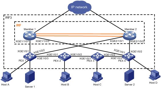

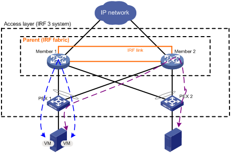

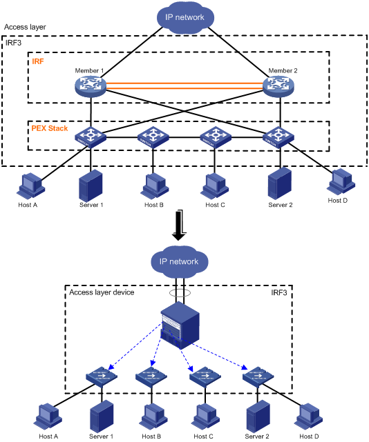

Setting up an IRF 3 system
Overview

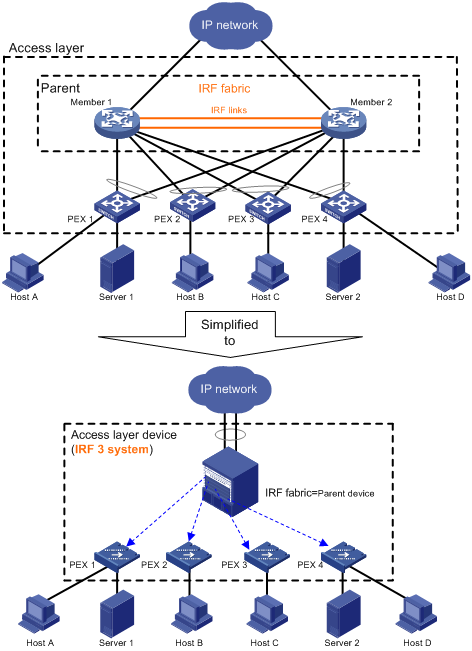

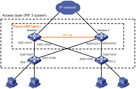

IRF 3 integrates multiple lower-layer devices with a higher-layer IRF fabric to provide high-density, low-cost connectivity at the access layer.
In an IRF 3 system, the higher-layer IRF fabric is called the parent fabric and the lower-layer devices are called port extenders (PEXs). You can manage and configure the PEXs from the parent fabric as if they were interface cards on the parent fabric.
Typically, IRF 3 works at the access layer of data centers. As shown in Figure 23, the access layer of a network is virtualized into an IRF 3 system. The system contains one parent fabric (a two-chassis IRF fabric) and multiple PEXs to provide connectivity for servers and hosts.
Figure 23 IRF 3 application scenario
IRF 3 provides the following benefits:
·     Simplified topologyDevices in an IRF 3 system appear as one node. For redundancy and load balancing, a downstream or upstream device can connect to the IRF 3 system through multichassis link aggregation. Together with link aggregation, IRF 3 creates a loop-free Layer 2 network. The spanning tree feature is not needed among devices in the IRF 3 system or on the link aggregations. IRF 3 also simplifies the Layer 3 network topology because it reduces the number of routing peers. The network topology does not change when a device is added to or removed from the IRF 3 system.
·     Single point of managementAn IRF 3 system is accessible at a single IP address on the network. You can use this IP address to log in through any network port to manage all the devices in the system. For an SNMP NMS, an IRF 3 system is one managed network node.
·     Network scalability and resiliency—You can increase the number of ports in an IRF 3 system by adding PEXs without changing network topology.

Network topology
The following are the methods to connect PEXs to the parent fabric:
·     One tier of PEXs—Each PEX is directly connected to the parent fabric. PEXs cannot be connected to each other, as shown in Figure 24.
·     Two-tier PEX stack—One tier of PEXs (tier-2 PEXs) are attached to the tier-1 PEXs (the PEXs that are directly connected to the parent fabric). The two tiers of PEXs are connected and configured to form a PEX stack. Figure 25 shows a typical PEX stack access topology.
Figure 24 IRF 3 network topology with one tier of PEXs
Figure 25 IRF 3 network topology (PEX stack)

The PEXs send any incoming traffic to the parent fabric. The parent fabric makes the forwarding decisions and sends the traffic to the outgoing interfaces. Figure 26 shows the data forwarding model.
Figure 26 Data forwarding model
IRF fabric split handling
A PEX uses an independent mechanism to regularly detect the IRF split on the parent fabric. When the parent fabric splits into multiple IRF fabrics, a PEX selects one IRF fabric as its parent fabric, as follows:
1.     The PEX selects the IRF fabric that has the most members as the parent fabric.
2.     If the IRF fabrics have the same number of members, the PEX compares the member IDs of their masters. Then, the PEX selects the IRF fabric that has the lowest numbered master.
After selecting one IRF fabric as the parent fabric, the PEX blocks all PEX links to other IRF fabrics.
These conflict handling rules are the same as LACP MAD. As a best practice, use LACP MAD on the parent fabric to ensure that the PEX selects the same IRF fabric to forward traffic as IRF. If any other MAD mechanisms are used, the parent fabric selected by the PEX might be placed in Recovery state.

·     Hardware compatibility and restrictions.
·     IRF 3 system size. (See "Enabling IRF 3 capability on the parent device.")
·     Parent devices and PEXs.
·     PEX access mode.
·     PEX physical interfaces and cabling scheme.
·     Virtual chassis assignment for PEXs.
The plan must meet the requirements described in "Hardware compatibility" and "Configuration restrictions and guidelines."
For more information about hardware and cabling, see the installation guide for the device.

Configuring IRF 3 settings on the parent fabric for PEXs
Creating PEX ports
To connect one tier of PEXs, you must create a PEX port for each PEX. To connect a PEX stack, you must create a PEX port for each tier-1 PEX and its attached tier-2 PEX.

Assigning virtual chassis numbers to one tier of PEXs
Perform this task if you are connecting one tier of PEXs to the parent fabric.
You must assign a unique virtual chassis number to each PEX.
You cannot change the chassis number of a PEX while it is starting up.
An operating PEX will reboot if you change or remove its chassis number.

IRF 3 system with one tier of PEXs configuration example
As shown in Figure 27, set up an IRF 3 system that contains a two-chassis H3C S7500E-X parent fabric and one tier of two S6300-52QF PEXs.
Figure 27 Network diagram
1.     Configure the parent fabric:
# Set up a two-chassis S7500E-X IRF fabric, as described in "Setting up an IRF fabric." (Details not shown.)
# Enable enhanced IRF mode on the IRF fabric.
[Sysname] irf mode enhanced
[Sysname] quit
<Sysname> reboot
# Create PEX port 1 for PEX 1.
[Sysname] pex-port 1
# Assign virtual chassis number 100 to PEX 1.
[Sysname-pex-port1] associate 100
[Sysname-pex-port1] quit
# Shut down two ranges of ports: Ten-GigabitEthernet 1/2/0/1 through Ten-GigabitEthernet 1/2/0/4, and Ten-GigabitEthernet 2/2/0/1 through Ten-GigabitEthernet 2/2/0/4.
[Sysname] interface range ten-gigabitethernet 1/2/0/1 to ten-gigabitethernet 1/2/0/4 ten-gigabitethernet 2/2/0/1 to ten-gigabitethernet 2/2/0/4
[Sysname-if-range] shutdown
[Sysname-if-range] quit
# Assign Ten-GigabitEthernet 1/2/0/1 and Ten-GigabitEthernet 2/2/0/1 to PEX port 1.
[Sysname-pex-port1] port group interface ten-gigabitethernet 1/2/0/1
[Sysname-pex-port1] port group interface ten-gigabitethernet 2/2/0/1
# Configure the description of PEX port 1 as connect-to-pex1.
[Sysname-pex-port1] description connect-to-pex1
# Create PEX port 2 for PEX 2.
[Sysname] pex-port 2
# Assign virtual chassis number 101 to PEX 2.
[Sysname-pex-port2] associate 101
# Assign Ten-GigabitEthernet 1/2/0/2 and Ten-GigabitEthernet 2/2/0/2 to PEX port 2.
[Sysname-pex-port2] port group interface ten-gigabitethernet 1/2/0/2
[Sysname-pex-port2] port group interface ten-gigabitethernet 2/2/0/2
# Configure the description of PEX port 2 as connect-to-pex2.
[Sysname-pex-port2] description connect-to-pex2
[Sysname-pex-port2] quit
# Bind all idle physical interfaces in the same group as the PEX physical interfaces to PEX port 1 and PEX port 2.
[Sysname-pex-port1] port group interface ten-gigabitethernet 1/2/0/3
[Sysname-pex-port1] port group interface ten-gigabitethernet 1/2/0/4
[Sysname-pex-port2] port group interface ten-gigabitethernet 2/2/0/3
[Sysname-pex-port2] port group interface ten-gigabitethernet 2/2/0/4
To shut down or bring up any SFP+ ports in a group, you must make sure all the SFP+ ports have been assigned to or removed from PEX ports.
# Bring up the ports Ten-GigabitEthernet 1/2/0/1 through Ten-GigabitEthernet 1/2/0/4 and Ten-GigabitEthernet 2/2/0/1 through Ten-GigabitEthernet 2/2/0/4.
[Sysname-if-range] undo shutdown
[Sysname-if-range] return
<Sysname> save
The current configuration will be written to the device. Are you sure? [Y/N]:y
Please input the file name(*.cfg)[flash:/startup.cfg]
(To leave the existing filename unchanged, press the enter key):
flash:/startup.cfg exists, overwrite? [Y/N]:y
Validating file. Please wait...
Saved the current configuration to mainboard device successfully.
# Use FTP or TFTP to transfer PEX startup software image file to the parent device. (Details not shown.)
You must store the image file in the root directory of a file system on the parent fabric.
# Specify the file as the startup image file for S6300-52QF switches.
<Sysname> boot-loader pex PEX-S6300 file ipe flash:/S6300PEX.ipe main
Verifying the IPE file and the images....Done.
Decompressing file S6300PEX-CMW710-BOOT-A0045P57.bin to flash:/S6300PEX-CMW710-BOOT-A0045P57.bin.....................Done.
Decompressing file S6300PEX-CMW710-SYSTEM-A0045P57.bin to flash:/S6300PEX-CMW710-SYSTEM-A0045P57.bin............................................................................................................Done.
The system reads the images from the file after they pass verification.
2.     Connect the PEXs to the parent fabric, as shown in Figure 27. (Details not shown.)
3.     Run PEX-capable Boot ROM and Comware images on the switches to be used as PEXs. For software versions that support PEX, see the release notes for the switches. (Details not shown.)
4.     Use one of the following methods to change the operating mode to PEX for the switches to be used as PEXs:
¡     Change the operating mode to PEX from the EXTENDED BOOT MENU:
# Reboot PEX 1 and press Ctrl+B at the prompt. If you have set a password, you must enter the correct password to access the EXTENDED BOOT MENU.
Starting......
Press Ctrl+D to access BASIC BOOT MENU
*                     H3C S6300-52QF BOOTROM, Version 135                      *
Copyright (c) 2004-2014 Hangzhou H3C Technologies Co., Ltd.
Creation Date   : Jul 15 2014,19:17:00
CPU Clock Speed : 1000MHz
Memory Size     : 2048MB
Flash Size      : 512MB
CPLD Version    : 002/002
PCB Version     : Ver.B
Mac Address     : 70F96D3DBB2B
PEX mode is disabled.
Press Ctrl+B to access EXTENDED BOOT MENU...0
Password recovery capability is enabled.
# In the EXTENDED BOOT MENU, press Ctrl+Y to change the operating mode to PEX.
   EXTENDED BOOT MENU
1. Download image to flash
2. Select image to boot
3. Display all files in flash
4. Delete file from flash
5. Restore to factory default configuration
6. Enter BootRom upgrade menu
7. Skip current system configuration
8. Set switch startup mode
0. Reboot
Ctrl+Z: Access EXTENDED ASSISTANT MENU
Ctrl+F: Format file system
Ctrl+P: Change authentication for console login
Ctrl+Y: Change Work Mode
Ctrl+R: Download image to SDRAM and run
Enter your choice(0-8):
# Enter Y to confirm the operating mode change.
PEX mode is disabled. Are you sure you want to enable PEX mode? [Y/N]Y
Mode changed successfully
# Enter 0 in the EXTENDED BOOT MENU to reboot PEX 1.
¡     Change the operating mode to PEX from the CLI:
# Enter system view.
# Change the operating mode to PEX.
[Sysname] pex working-mode pex slot 1
Are you sure you want to change to the PEX mode? [Y/N]: y
If you want to change parent device to PEX mode or change PEX device to switch mode, you must reboot the device.
Reboot PEX 1 for the change to take effect.
At startup, PEX 1 loads the startup images from the parent fabric.
Flash Size      : 512MB
PCB Version     : Ver.B
Mac Address     : 70BAEF5CA028
PEX mode is enabled.
Loading the main image files...
Loading file flash:/s5800v2_s6300pex-cmw710-system-e2130l15.bin..........................................................................................................................................................................................................................................................................Done.
Loading file flash:/s5800v2_s6300pex-cmw710-boot-e2130l15.bin........................................................................Done.
Image file flash:/s5800v2_s6300pex-cmw710-boot-e2130l15.bin is
self-decompressing...........................................................................................................................................................................................................................................................................................................................................................................................................................................................................................................................................................................................................................................................................................................................................................................Done.
System is starting...
Started downloading S6300PEX-CMW710-SYSTEM-A0045P57.bin
Writing to flash
Started downloading S6300PEX-CMW710-BOOT-A0045P57.bin
Writing to flash
Starting......
Flash Size      : 512MB
PCB Version     : Ver.B
Loading file flash:/S6300PEX-CMW710-SYSTEM-A0045P57.bin..................................................................................................................................................................................................................................................................................Done.
Loading file flash:/S6300PEX-CMW710-BOOT-A0045P57.bin..............................................................................Done.
Image file flash:/S6300PEX-CMW710-BOOT-A0045P57.bin is self-decompressing.........................................................................................................................................................................................................................................................................................................................................................................................................................................................................................................................................................................................................................................................................................................................................................Done.
Cryptographic algorithms tests passed.
Done.
While the PEX is starting up, the parent fabric displays messages about PEX port state changes, PEX registration, and PEX startup.
%Nov 12 10:32:43:326 2014 H3C PEX/4/PEX_LINK_BLOCK: -MDC=1-Chassis=1-Slot=2; Status of Ten-GigabitEthernet1/2/0/1 changed from down to blocked.
%Nov 12 10:32:43:326 2014 H3C PEX/4/PEX_LINK_BLOCK: -MDC=1-Chassis=2-Slot=2; Status of Ten-GigabitEthernet2/2/0/1 changed from down to blocked.
%Nov 12 10:32:43:352 2014 H3C IFNET/3/PHY_UPDOWN: -MDC=1; Ten-GigabitEthernet1/2/0/1 link status is up.
%Nov 12 10:32:43:352 2014 H3C IFNET/3/PHY_UPDOWN: -MDC=1; Ten-GigabitEthernet2/2/0/1 link status is up.
%Nov 12 10:32:43:353 2014 H3C IFNET/5/LINK_UPDOWN: -MDC=1; Line protocol on the interface Ten-GigabitEthernet1/2/0/1 is up.
%Nov 12 10:32:43:353 2014 H3C IFNET/5/LINK_UPDOWN: -MDC=1; Line protocol on the interface Ten-GigabitEthernet2/2/0/1 is up.
%Nov 12 10:32:52:753 2014 H3C PEX/5/PEX_REG_REQUEST: -MDC=1; Received a REGISTER request on PEX port 1 from PEX (chassis 100).
%Nov 12 10:32:52:766 2014 H3C DEV/4/BOARD_LOADING: -MDC=1; Board in chassis 100 slot 0 is loading software images.
%Nov 12 10:32:52:742 2014 H3C PEX/5/PEX_LINK_FORWARD: -MDC=1-Chassis=1-Slot=2; Status of Ten-GigabitEthernet1/2/0/1 changed from blocked to forwarding.
%Nov 12 10:32:52:742 2014 H3C PEX/5/PEX_LINK_FORWARD: -MDC=1-Chassis=2-Slot=2; Status of Ten-GigabitEthernet2/2/0/1 changed from blocked to forwarding.
%Nov 12 10:33:09:127 2014 H3C DEV/2/BOARD_STATE_FAULT: -MDC=1; Board state changed to Fault on chassis 100 slot 0, type is unknown.
%Nov 12 10:33:21:290 2014 H3C DEV/5/BOARD_STATE_NORMAL: -MDC=1; Board state changed to Normal on chassis 100 slot 0, type is S6300-52QF.
%Nov 12 10:33:27:754 2014 H3C PEX/5/PEX_REG_JOININ: -MDC=1; PEX (chassis 100) registered successfully on PEX port 1.
%Nov 12 10:33:28:645 2014 H3C IFNET/3/PHY_UPDOWN: -MDC=1; Pex100/0/0/51 link status is up.
%Nov 12 10:33:28:645 2014 H3C IFNET/3/PHY_UPDOWN: -MDC=1; Pex100/0/0/52 link status is up.
%Nov 12 10:33:28:647 2014 H3C IFNET/5/LINK_UPDOWN: -MDC=1; Line protocol on the interface Pex100/0/0/51 is up.
%Nov 12 10:33:28:647 2014 H3C IFNET/5/LINK_UPDOWN: -MDC=1; Line protocol on the interface Pex100/0/0/52 is up.
5.     Configure PEX 2 in the same way PEX 1 is configured. (Details not shown.)
# Verify that the IRF 3 system has been set up. You can configure the PEXs from the parent fabric if the PEXs are in Online state and each have a minimum of one PEX link in Forwarding state.
<Sysname> display pex-port verbose
PEX port 1:
  Description: connnect-to-pex1
  Associated ID: Chassis 100
    Chassis       PEX status
    *100          Online
  Member interfaces: 4
    Member interface        Status               Peer interface
    XGE1/2/0/1              Forwarding           PEX100/0/0/51
    XGE1/2/0/3              Down                 --
    XGE1/2/0/4              Down                 --
    XGE2/2/0/1              Forwarding           PEX100/0/0/52
PEX port 2:
  Description: connnect-to-pex2
  Associated ID: Chassis 101
    Chassis       PEX status
    *101          Online
    XGE1/2/0/2              Forwarding           PEX101/0/0/52
    XGE2/2/0/2              Forwarding           PEX101/0/0/51
    XGE2/2/0/3              Down                 --
    XGE2/2/0/4              Down                 --
IRF 3 system with a PEX stack configuration example
As shown in Figure 28, set up an IRF 3 system that contains a two-chassis parent fabric and a stack of four S5130-EI PEXs.
Figure 28 Network diagram
# Set up a two-chassis IRF fabric, as described in "Setting up an IRF fabric." (Details not shown.)
# Create PEX port 1.
# Assign virtual chassis number 100 to PEX 1 at tier 1.
# Assign virtual chassis number 101 to PEX 2 (the tier-2 PEX attached to PEX 1).
[Sysname-pex-port1] associate order 101
# Shut down two ranges of ports: Ten-GigabitEthernet 1/1/0/1 through Ten-GigabitEthernet 1/1/0/4, and Ten-GigabitEthernet 2/1/0/1 through Ten-GigabitEthernet 2/1/0/4.
[Sysname] interface range ten-gigabitethernet 1/1/0/1 to ten-gigabitethernet 1/1/0/4 ten-gigabitethernet 2/1/0/1 to ten-gigabitethernet 2/1/0/4
# Assign Ten-GigabitEthernet 1/1/0/1 and Ten-GigabitEthernet 2/1/0/1 to PEX port 1.
[Sysname-pex-port1] port group interface ten-gigabitethernet 1/1/0/1
[Sysname-pex-port1] port group interface ten-gigabitethernet 2/1/0/1
# Create PEX port 2.
# Assign virtual chassis number 103 to PEX 4 at tier 1.
[Sysname-pex-port2] associate 103
# Assign virtual chassis number 102 to PEX 3 (the tier-2 PEX attached to PEX 4).
[Sysname-pex-port2] associate order 102
# Assign Ten-GigabitEthernet 1/1/0/2 and Ten-GigabitEthernet 2/1/0/2 to PEX port 2.
[Sysname-pex-port2] port group interface ten-gigabitethernet 1/1/0/2
[Sysname-pex-port2] port group interface ten-gigabitethernet 2/1/0/2
# Bind all idle physical interfaces in the same group to PEX port 1 and PEX port 2.
[Sysname-pex-port1] port group interface ten-gigabitethernet 1/1/0/3
[Sysname-pex-port1] port group interface ten-gigabitethernet 1/1/0/4
[Sysname-pex-port2] port group interface ten-gigabitethernet 2/1/0/3
[Sysname-pex-port2] port group interface ten-gigabitethernet 2/1/0/4
# Bring up the ports Ten-GigabitEthernet 1/1/0/1 through Ten-GigabitEthernet 1/1/0/4 and Ten-GigabitEthernet 2/1/0/1 through Ten-GigabitEthernet 2/1/0/4.
# Create PEX port group 1.
[Sysname] pex-port-group 1
# Assign PEX port 1 and PEX port 2 to PEX port group 1.
[Sysname-pex-port-group1] member pex-port 1
[Sysname-pex-port-group1] member pex-port 2
[Sysname-pex-port1] return
<Sysname> save

2.     Connect the PEXs and the parent fabric, as shown in Figure 28. (Details not shown.)
4.     Use one of the following methods to change the operating mode to PEX for the candidate PEXs:
¡     Change the operating mode to PEX from the BOOT MENU:
# Reboot PEX 1 and press Ctrl+B at the prompt. If you have set a password, you must enter the correct password to access the BOOT MENU.
Starting......
Press Ctrl+T to start memory test
Press Ctrl+E to start heavy memory test
*                    H3C S5130-52S-EI BOOTROM, Version 130                     *
Copyright (c) 2004-2015 Hangzhou H3C Technologies Co., Ltd.
Creation Date       : Jun 26 2015, 09:31:44
Memory Size         : 1024MB
Flash Size          : 512MB
CPLD Version        : 002
PCB Version         : Ver.B
Mac Address         : 586ab10acdef
Press Ctrl+B to access EXTENDED BOOT MENU...0BootRom password: Not required. Please press Enter to continue.
# In the BOOT MENU, press Ctrl+Y to change the operating mode to PEX. By default, PEX mode is disabled for the S5130-EI switch.
BOOT MENU
1. Download application file to flash
2. Select application file to boot
8. Reserved
9. Set switch startup mode
0. Reboot
Ctrl+F: Format File System
Ctrl+P: Skip Super Password
Ctrl+R: Download application to SDRAM and Run
Ctrl+Z: Access EXTEND-ASSISTANT MENU
Enter your choice(0-9):
PEX mode is disabled. Are you sure you want to enable PEX mode? [Y/N]YDone!
# Enter 0 in the BOOT MENU to reboot PEX 1.
[Sysname] quit
# Reboot the PEX.
<Sysname> reboot
Press Ctrl-B to enter Extended Boot menu...0......Done!
Request File: flash:/pex-s5130EI-system.bin......Done.
Loading...Done!
Loading file pex_s5130EI.cpio.gz...Done!
Request File: flash:/pex-s5130EI-boot.bin...Done.
Loading...Done!...............................................................................................................................................................................................................................Done!
%Jan  1 11:44:04:850 2015 Sysname PEX/4/PEX_LINK_BLOCK: Status of Ten-GigabitEthernet1/1/0/1 changed from down to blocked.
%Jan  1 11:44:04:850 2015 Sysname PEX/4/PEX_LINK_BLOCK: Status of Ten-GigabitEthernet2/1/0/1 changed from down to blocked.
%Jan  1 11:44:13:483 2015 Sysname PEX/5/PEX_LINK_FORWARD: Status of Ten-GigabitEthernet1/1/0/1 changed from blocked to forwarding.
%Jan  1 11:44:13:483 2015 Sysname PEX/5/PEX_LINK_FORWARD: Status of Ten-GigabitEthernet2/1/0/1 changed from blocked to forwarding.
%Jan  1 11:44:13:518 2015 Sysname PEX/5/PEX_REG_REQUEST: Received a REGISTER request on PEX port 1 from PEX (chassis 100).
%Jan  1 11:44:14:363 2015 Sysname DEV/4/BOARD_LOADING: Board in chassis 100 is loading software images.
%Jan  1 11:44:14:365 2015 Sysname DEV/5/LOAD_FINISHED: Board in chassis 100 has finished loading software images.
%Jan  1 11:44:42:136 2015 Sysname DEV/4/BOARD_LOADING: Board in chassis 100 is loading software images.
%Jan  1 11:45:32:097 2015 Sysname DEV/5/LOAD_FINISHED: Board in chassis 100 has finished loading software images.
%Jan  1 11:48:24:339 2015 Sysname DEV/5/BOARD_STATE_NORMAL: Board state changes to NORMAL on Chassis 100, type is MAIN_BOARD_TYPE_50.
%Jan  1 11:48:29:061 2015 Sysname OPTMOD/4/MODULE_IN: -Chassis=100; Pex100/0/0/1: The transceiver is STACK_SFP_PLUS.
%Jan  1 11:48:29:061 2015 Sysname OPTMOD/4/MODULE_IN: -Chassis=100; Pex100/0/0/2: The transceiver is STACK_SFP_PLUS.
%Jan  1 11:48:37:455 2015 Sysname PEX/5/PEX_REG_JOININ: PEX (chassis 100) registered successfully on PEX port 1.
%Jan  1 11:48:42:422 2015 Sysname IFNET/3/PHY_UPDOWN: Pex100/0/0/1 link status is up.
%Jan  1 11:48:42:422 2015 Sysname IFNET/3/PHY_UPDOWN: Pex100/0/0/2 link status is up.
%Jan  1 11:48:42:430 2015 Sysname IFNET/5/LINK_UPDOWN: Line protocol on the interface Pex100/0/0/1 is up.
%Jan  1 11:48:42:430 2015 Sysname IFNET/5/LINK_UPDOWN: Line protocol on the interface Pex100/0/0/2 is up.
5.     Configure PEX 2, PEX 3, and PEX 4 in the same way PEX 1 is configured. As a best practice, first configure the tier-1 PEXs and then the tier-2 PEXs. (Details not shown.)
<Sysname>dis pex-port verbose
PEX port 1:
  Description: pex-port 0001
  Group: 1
  Associated chassis numbers: 2
    Chassis             PEX status
    *100                Online
     101                Online
  Member interfaces: 2
    XGE1/1/0/1              Forwarding      PEX100/0/0/1
    XGE2/1/0/1              Forwarding      PEX100/0/0/2
PEX port 2:
  Description: pex-port 0002
  Group: 1
    Chassis             PEX status
    *103                Online
     102                Online
    XGE1/1/0/2              Forwarding      PEX103/0/0/1
    XGE2/1/0/2              Forwarding      PEX103/0/0/2
# Verify that the PEX stack topology is correct on PEX port 1.
<Sysname> display pex-port 1 topology
PEX port 1:
PEX            Neighbors       Local interfaces     Peer interfaces
Chassis 100    PEX port 1      PEX100/0/0/1         XGE1/1/0/1
                               PEX100/0/0/2         XGE2/1/0/1
               Chassis 101     PEX100/0/0/3         PEX101/0/0/1
Chassis 101    Chassis 100     PEX101/0/0/1         PEX100/0/0/3
               Chassis 102     PEX101/0/0/2         PEX102/0/0/1
Chassis 102    Chassis 101     PEX102/0/0/1         PEX101/0/0/2
               Chassis 103     PEX102/0/0/2         PEX103/0/0/1
Chassis 103    Chassis 102     PEX103/0/0/3         PEX102/0/0/2
               PEX port 2      PEX103/0/0/1         XGE1/1/0/2
                               PEX103/0/0/2         XGE2/1/0/2
# Verify that the PEX stack topology is correct on PEX port 2. (Details not shown.)
