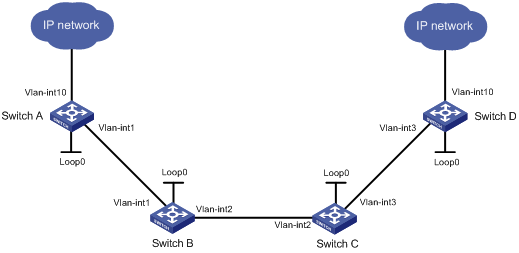

RSVP configuration examples
Establishing an MPLS TE tunnel with RSVP-TE
Network requirements
Switch A, Switch B, Switch C, and Switch D run IS-IS and all of them are Layer 2 switches.
Use RSVP-TE to establish an MPLS TE tunnel from Switch A to Switch D to transmit data between the two IP networks. The MPLS TE tunnel requires a bandwidth of 2000 kbps.
The maximum bandwidth of the link that the tunnel traverses is 10000 kbps and the maximum reservable bandwidth of the link is 5000 kbps.
Figure 2 Network diagram
Device
Interface
IP address
Device
Interface
IP address
Switch A
Loop0
1.1.1.9/32
Switch D
Loop0
4.4.4.9/32
Vlan-int1
10.1.1.1/24
Vlan-int3
30.1.1.2/24
Vlan-int10
100.1.1.1/24
Vlan-int10
100.1.2.1/24
Switch B
Loop0
2.2.2.9/32
Switch C
Loop0
3.3.3.9/32
Vlan-int1
10.1.1.2/24
Vlan-int3
30.1.1.1/24
Vlan-int2
20.1.1.1/24
Vlan-int2
20.1.1.2/24
Configuration procedure
1.     Configure IP addresses and masks for interfaces. (Details not shown.)
2.     Configure IS-IS to advertise interface addresses, including the loopback interface address:
# Configure Switch A.
<SwitchA> system-view
[SwitchA] isis 1
[SwitchA-isis-1] network-entity 00.0005.0000.0000.0001.00
[SwitchA-isis-1] quit
[SwitchA] interface vlan-interface 1
[SwitchA-Vlan-interface1] isis enable 1
[SwitchA-Vlan-interface1] isis circuit-level level-2
[SwitchA-Vlan-interface1] quit
[SwitchA] interface loopback 0
[SwitchA-LoopBack0] isis enable 1
[SwitchA-LoopBack0] isis circuit-level level-2
[SwitchA-LoopBack0] quit
# Configure Switch B.
<SwitchB> system-view
[SwitchB] isis 1
[SwitchB-isis-1] network-entity 00.0005.0000.0000.0002.00
[SwitchB-isis-1] quit
[SwitchB] interface vlan-interface 1
[SwitchB-Vlan-interface1] isis enable 1
[SwitchB-Vlan-interface1] isis circuit-level level-2
[SwitchB-Vlan-interface1] quit
[SwitchB-Vlan-interface2] isis enable 1
[SwitchB-Vlan-interface2] isis circuit-level level-2
[SwitchB-Vlan-interface2] quit
[SwitchB] interface loopback 0
[SwitchB-LoopBack0] isis enable 1
[SwitchB-LoopBack0] isis circuit-level level-2
[SwitchB-LoopBack0] quit
# Configure Switch C.
<SwitchC> system-view
[SwitchC] isis 1
[SwitchC-isis-1] network-entity 00.0005.0000.0000.0003.00
[SwitchC-isis-1] quit
[SwitchC] interface vlan-interface 3
[SwitchC-Vlan-interface3] isis enable 1
[SwitchC-Vlan-interface3] isis circuit-level level-2
[SwitchC-Vlan-interface3] quit
[SwitchC] interface vlan-interface 2
[SwitchC-Vlan-interface2] isis enable 1
[SwitchC-Vlan-interface2] isis circuit-level level-2
[SwitchC-Vlan-interface2] quit
[SwitchC] interface loopback 0
[SwitchC-LoopBack0] isis enable 1
[SwitchC-LoopBack0] isis circuit-level level-2
[SwitchC-LoopBack0] quit
# Configure Switch D.
<SwitchD> system-view
[SwitchD] isis 1
[SwitchD-isis-1] network-entity 00.0005.0000.0000.0004.00
[SwitchD-isis-1] quit
[SwitchD] interface vlan-interface 3
[SwitchD-Vlan-interface3] isis enable 1
[SwitchD-Vlan-interface3] isis circuit-level level-2
[SwitchD-Vlan-interface3] quit
[SwitchD] interface loopback 0
[SwitchD-LoopBack0] isis enable 1
[SwitchD-LoopBack0] isis circuit-level level-2
[SwitchD-LoopBack0] quit
# Execute the display ip routing-table command on each switch to verify that the switches have learned the routes to one another, including the routes to the loopback interfaces. (Details not shown.)
3.     Configure an LSR ID, and enable MPLS, MPLS TE, and RSVP:
[SwitchA] mpls lsr-id 1.1.1.9
[SwitchA] mpls te
[SwitchA-te] quit
[SwitchA] rsvp
[SwitchA-rsvp] quit
[SwitchA-Vlan-interface1] mpls enable
[SwitchA-Vlan-interface1] mpls te enable
[SwitchA-Vlan-interface1] rsvp enable
[SwitchB] mpls lsr-id 2.2.2.9
[SwitchB] mpls te
[SwitchB-te] quit
[SwitchB] rsvp
[SwitchB-rsvp] quit
[SwitchB-Vlan-interface1] mpls enable
[SwitchB-Vlan-interface1] mpls te enable
[SwitchB-Vlan-interface1] rsvp enable
[SwitchB-Vlan-interface2] mpls enable
[SwitchB-Vlan-interface2] mpls te enable
[SwitchB-Vlan-interface2] rsvp enable
[SwitchC] mpls lsr-id 3.3.3.9
[SwitchC] mpls te
[SwitchC-te] quit
[SwitchC] rsvp
[SwitchC-rsvp] quit
[SwitchC-Vlan-interface3] mpls enable
[SwitchC-Vlan-interface3] mpls te enable
[SwitchC-Vlan-interface3] rsvp enable
[SwitchC-Vlan-interface2] mpls enable
[SwitchC-Vlan-interface2] mpls te enable
[SwitchC-Vlan-interface2] rsvp enable
[SwitchD] mpls lsr-id 4.4.4.9
[SwitchD] mpls te
[SwitchD-te] quit
[SwitchD] rsvp
[SwitchD-rsvp] quit
[SwitchD-Vlan-interface3] mpls enable
[SwitchD-Vlan-interface3] mpls te enable
[SwitchD-Vlan-interface3] rsvp enable
4.     Configure IS-IS TE:
[SwitchA] isis 1
[SwitchA-isis-1] cost-style wide
[SwitchA-isis-1] mpls te enable level-2
[SwitchB] isis 1
[SwitchB-isis-1] cost-style wide
[SwitchB-isis-1] mpls te enable level-2
[SwitchC] isis 1
[SwitchC-isis-1] cost-style wide
[SwitchC-isis-1] mpls te enable level-2
[SwitchD] isis 1
[SwitchD-isis-1] cost-style wide
[SwitchD-isis-1] mpls te enable level-2
5.     Configure MPLS TE attributes of links:
# Configure the maximum link bandwidth and maximum reservable bandwidth on Switch A.
[SwitchA-Vlan-interface1] mpls te max-link-bandwidth 10000
[SwitchA-Vlan-interface1] mpls te max-reservable-bandwidth 5000
# Configure the maximum link bandwidth and maximum reservable bandwidth on Switch B.
[SwitchB-Vlan-interface1] mpls te max-link-bandwidth 10000
[SwitchB-Vlan-interface1] mpls te max-reservable-bandwidth 5000
[SwitchB-Vlan-interface2] mpls te max-link-bandwidth 10000
[SwitchB-Vlan-interface2] mpls te max-reservable-bandwidth 5000
# Configure the maximum link bandwidth and maximum reservable bandwidth on Switch C.
[SwitchC-Vlan-interface3] mpls te max-link-bandwidth 10000
[SwitchC-Vlan-interface3] mpls te max-reservable-bandwidth 5000
[SwitchC-Vlan-interface2] mpls te max-link-bandwidth 10000
[SwitchC-Vlan-interface2] mpls te max-reservable-bandwidth 5000
# Configure the maximum link bandwidth and maximum reservable bandwidth on Switch D.
[SwitchD-Vlan-interface3] mpls te max-link-bandwidth 10000
[SwitchD-Vlan-interface3] mpls te max-reservable-bandwidth 5000
6.     Configure an MPLS tunnel on Switch A:
# Configure MPLS TE tunnel interface Tunnel 1.
[SwitchA] interface tunnel 1 mode mpls-te
[SwitchA-Tunnel1] ip address 7.1.1.1 255.255.255.0
# Specify the tunnel destination address as the LSR ID of Switch D.
[SwitchA-Tunnel1] destination 4.4.4.9
# Configure MPLS TE to use RSVP-TE to establish the tunnel.
[SwitchA-Tunnel1] mpls te signaling rsvp-te
# Assign 2000 kbps bandwidth to the tunnel.
[SwitchA-Tunnel1] mpls te bandwidth 2000
[SwitchA-Tunnel1] quit
7.     Configure a static route on Switch A to direct the traffic destined for subnet 100.1.2.0/24 to the MPLS TE tunnel 1 for forwarding.
[SwitchA] ip route-static 100.1.2.0 24 tunnel 1 preference 1
# Verify that the tunnel interface is up on Switch A.
[SwitchA] display interface tunnel
Tunnel1
Current state: UP
Line protocol state: UP
Description: Tunnel1 Interface
Bandwidth: 64kbps
Maximum Transmit Unit: 64000
Internet Address is 7.1.1.1/24 Primary
Tunnel source unknown, destination 4.4.4.9
Tunnel TTL 255
Tunnel protocol/transport CR_LSP
Last clearing of counters: Never
    Last 300 seconds input rate: 0 bytes/sec, 0 bits/sec, 0 packets/sec
    Last 300 seconds output rate: 6 bytes/sec, 48 bits/sec, 0 packets/sec
Input: 0 packets, 0 bytes, 0 drops
Output: 177 packets, 11428 bytes, 0 drops
# Display detailed information about the MPLS TE tunnel on Switch A.
[SwitchA] display mpls te tunnel-interface
Tunnel Name            : Tunnel 1
Tunnel State            : Up (Main CRLSP up, Shared-resource CRLSP down)
Tunnel Attributes      :
  LSP ID               : 23331           Tunnel ID            : 1
  Admin State          : Normal
  Ingress LSR ID       : 1.1.1.9         Egress LSR ID        : 4.4.4.9
  Signaling            : RSVP-TE         Static CRLSP Name    : -
  Resv Style           : SE
  Tunnel mode          : -
  Reverse-LSP name     : -
  Reverse-LSP LSR ID   : -               Reverse-LSP Tunnel ID: -
  Class Type           : CT0             Tunnel Bandwidth     : 2000 kbps
  Reserved Bandwidth   : 2000 kbps
  Setup Priority       : 7               Holding Priority     : 7
  Affinity Attr/Mask   : 0/0
  Explicit Path        : -
  Backup Explicit Path : -
  Metric Type          : TE
  Record Route         : Disabled        Record Label         : Disabled
  FRR Flag             : Disabled        Backup Bandwidth Flag: Disabled
  Backup Bandwidth Type: -               Backup Bandwidth     : -
  Route Pinning        : Disabled
  Retry Limit          : 10              Retry Interval       : 2 sec
  Reoptimization       : Disabled        Reoptimization Freq  : -
  Backup Type          : None            Backup LSP ID        : -
  Auto Bandwidth       : Disabled        Auto Bandwidth Freq  : -
  Min Bandwidth        : -               Max Bandwidth        : -
  Collected Bandwidth  : -
# Execute the display ip routing-table command on Switch A to verify that a static route entry with interface Tunnel 1 as the output interface exists. (Details not shown.)

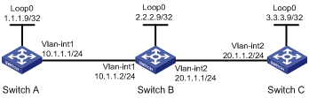

RSVP GR configuration example
Switch A, Switch B, and Switch C run IS-IS, and all of them are Layer 2 switches.
Use RSVP-TE to establish a TE tunnel from Switch A to Switch C.
Configure RSVP GR on the switches to ensure continuous forwarding when a switch reboots.
Figure 3 Network diagram
2.     Configure IS-IS to advertise interface addresses, including the loopback interface address. (Details not shown.)
3.     Configure an LSR ID, enable MPLS, MPLS TE, RSVP, and RSVP hello extension:
[SwitchA] mpls te
[SwitchA-te] quit
[SwitchA] rsvp
[SwitchA-rsvp] quit
[SwitchA-Vlan-interface1] rsvp hello enable
[SwitchB] mpls te
[SwitchB-te] quit
[SwitchB] rsvp
[SwitchB-rsvp] quit
[SwitchB-mpls] interface vlan-interface 1
[SwitchB-Vlan-interface1] rsvp hello enable
[SwitchB-Vlan-interface2] rsvp hello enable
[SwitchC] mpls te
[SwitchC-te] quit
[SwitchC] rsvp
[SwitchC-rsvp] quit
[SwitchC-Vlan-interface2] rsvp hello enable
4.     Configure IS-IS TE. (Details not shown.)
5.     Configure an MPLS TE tunnel. (Details not shown.)
6.     Configure RSVP GR:
[SwitchA] rsvp
[SwitchA-rsvp] graceful-restart enable
[SwitchB] rsvp
[SwitchB-rsvp] graceful-restart enable
[SwitchC] rsvp
[SwitchC-rsvp] graceful-restart enable
# After a tunnel is established from Switch A and Switch C, display detailed RSVP neighbor information on Switch A.
<SwitchA> display rsvp peer verbose
Peer: 10.1.1.2                            Interface: Vlan1
Hello state: Up                           Hello type: Active
PSB count: 0                              RSB count: 1
Src instance: 0x1f08                      Dst instance: 0x22
Summary refresh: Disabled                 Graceful Restart state: Ready
Peer GR restart time: 120000 ms           Peer GR recovery time: 0 ms
The output shows that the neighbor's GR state is Ready.
