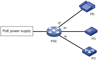

As shown in Figure 1, a PoE system includes the following elements:
·     PoE power supply—The PoE power supply provides power for the entire PoE system.
·     PSE—A power sourcing equipment (PSE) detects and classifies powered devices (PDs), supplies power to PDs, and monitors the PD power and connection status. PSEs include endpoint PSEs and midspan PSEs.
H3C PSEs are endpoint PSEs. An H3C PSE can be a device with only one built-in PSE, or it can be a PoE-capable interface card or subcard on a device. A device with multiple PSEs uses PSE IDs to identify different PSEs. The display poe device command displays the mapping between a PSE ID and the slot or subslot number of a PSE. The S10500 switch supports multiple PSEs.
·     PI—A power interface (PI) is a PoE-capable Ethernet interface on a PSE.
·     PD—A PD receives power from the PSE.
PDs include IP telephones, APs, portable chargers, POS terminals, and Web cameras.
You can also connect a PD to a redundant power source for reliability.

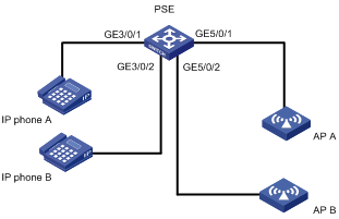

PoE configuration example
Network requirements
As shown in Figure 2, the device has two PSEs PSE 10 and PSE 16. Configure PoE to meet the following requirements:
·     Enable the device to supply power to IP telephones and APs.
·     Configure PI power management so that the PSE does not supply power to a new PD when the new PD results in PSE power overload.
·     Allocate 400 watts to PSE 10. (This example assumes that the default maximum power of PSE 16 can meet the requirements.)
·     Allocate AP B a maximum power of 9000 milliwatts.
Figure 2 Network diagram
Configuration procedure
# Enable PoE for the PSE.
<PSE> system-view
[PSE] poe enable pse 10
[PSE] poe enable pse 16
# Set the maximum power of PSE 10 to 400 watts.
[PSE] poe max-power 400 pse 10
# Enable PoE on GigabitEthernet 3/0/1 and GigabitEthernet 5/0/1.
[PSE] interface gigabitethernet 3/0/1
[PSE-GigabitEthernet3/0/1] poe enable
[PSE-GigabitEthernet3/0/1] quit
[PSE] interface gigabitethernet 5/0/1
[PSE-GigabitEthernet5/0/1] poe enable
[PSE-GigabitEthernet5/0/1] quit
# Enable PoE on GigabitEthernet 3/0/2, and set its power priority to critical.
[PSE] interface gigabitethernet 3/0/2
[PSE-GigabitEthernet3/0/2] poe enable
[PSE-GigabitEthernet3/0/2] poe priority critical
[PSE-GigabitEthernet3/0/2] quit
# Enable PoE on GigabitEthernet 5/0/2, and set its maximum power to 9000 milliwatts.
[PSE] interface gigabitethernet 5/0/2
[PSE-GigabitEthernet5/0/2] poe enable
[PSE-GigabitEthernet5/0/2] poe max-power 9000
# Connect the IP telephones and APs to the PSEs to verify that they can obtain power and operate correctly. (Details not shown.)
