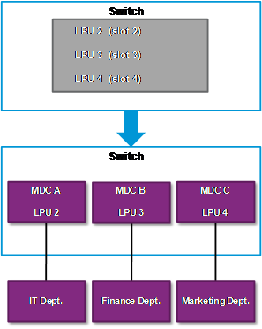

Example: Configuring MDCs in standalone mode
Network requirements
As shown in Figure 1, the switch has three LPUs. Each LPU has 48 Ethernet interfaces. The company has three departments:
·     The IT department is responsible for the data center. The data center has servers and storage devices.
·     The finance department has higher network availability and security requirements than the other departments.
·     The marketing department has less Internet traffic than the other departments.
Configure three MDCs on the switch as shown in Table 2 to meet the Internet access requirements of the three departments.
Table 2 CPU, disk space, and memory space quotas for MDCs
MDC
CPU weight
Disk space quota
Memory space quota
MDC A
10 (default)
60%
70%
MDC B
10 (default)
50%
60%
MDC C
5
40%
50%
Figure 1 Network diagram

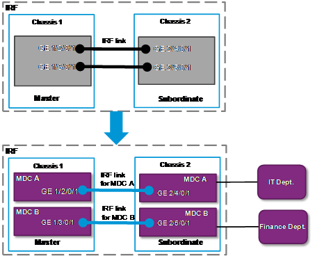

As shown in Figure 2, the IRF fabric has two members. Each member has two LPUs. Each LPU has 48 Ethernet interfaces. Two IRF links are established between the two members.
The company wants to use the IRF fabric to meet the Internet access requirements of two departments:
·     The finance department has higher network availability and security requirements but less Internet traffic than the IT department.
Configure two MDCs on the IRF fabric as shown in Table 3 to meet the Internet access requirements.

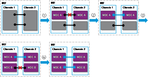

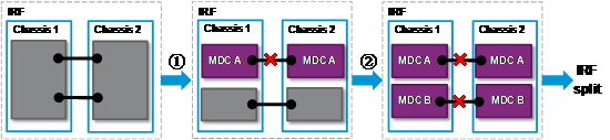

Requirements analysis
Both MDC A and MDC B are across chassis. To allow MDCs across chassis to forward traffic correctly, you must establish a minimum of one IRF link for each MDC. H3C recommends that you establish two IRF links for each MDC to implement redundancy and load sharing.
Assigning an LPU that has an IRF link established closes the IRF link. To avoid IRF fabric split, make sure a minimum of one IRF link is operating correctly during the configuration process, as shown in Figure 3.
Figure 3 Correct configuration order
1.     Assign all interfaces on LPUs 2 and 4 to MDC A.
2.     Establish a new IRF link on MDC A.
3.     Assign all interfaces on LPUs 3 and 5 to MDC B.
4.     Establish a new IRF link on MDC B.
Figure 4 Incorrect configuration order
2.     Assign all interfaces on LPUs 3 and 5 to MDC B.

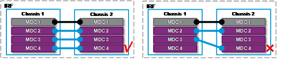

·     The physical IRF ports of an IRF link must belong to the same MDC. If they do not, the link cannot be established and forwarding errors might occur, as shown in Figure 5.
Figure 5 The physical IRF ports of an IRF link must belong to the same MDC

To avoid IRF fabric split, make sure a minimum of one IRF link is operating correctly during this process.

2.     Create and configure MDC A for the IT department:
# Shut down physical IRF ports GE 1/2/0/1 and GE 2/4/0/1 and remove the IRF port-physical IRF port binding.

3.     Create and configure MDC B for the finance department:
# Shut down physical IRF ports GE 1/3/0/1 and GE 2/5/0/1 and remove the IRF port-physical IRF port binding.
