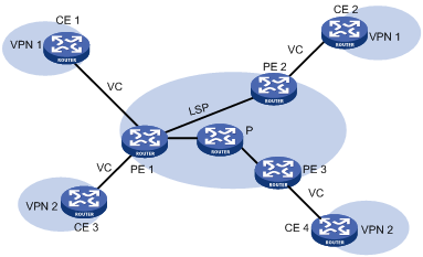

Consider ATM as an example. Each customer edge (CE) device can connect to the MPLS network through an ATM virtual circuit (VC) to communicate with another CE. This is similar to that on an ATM network.
Figure 1 Network diagram for MPLS L2VPN

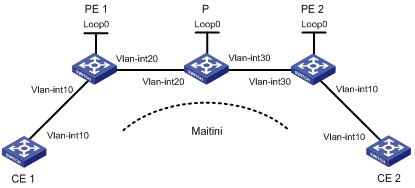

Configuring a Martini MPLS L2VPN connection based on Layer 2 Ethernet interface and VLAN
Network requirements
CEs are connected to PEs through VLAN interfaces.
Establish a Martini MPLS L2VPN connection between CE 1 and CE 2.
Figure 3 Network diagram
Device
Interface
IP address
Device
Interface
IP address
CE 1
Vlan-int10
100.1.1.1/24
P
Loop0
192.4.4.4/32
PE 1
Loop0
192.2.2.2/32
Vlan-int20
10.1.1.2/24
Vlan-int20
10.1.1.1/24
Vlan-int30
10.2.2.2/24
CE 2
Vlan-int10
100.1.1.2/24
PE 2
Loop0
192.3.3.3/32
Vlan-int30
10.2.2.1/24
Configuration procedure

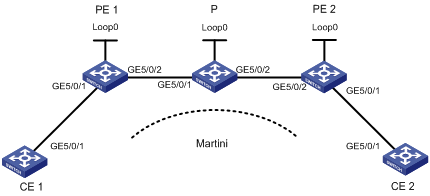

Configuring a Martini MPLS L2VPN on a Layer 3 Ethernet interface
CEs are connected to PEs through routing interfaces.
Establish a Martini MPLS L2VPN between CE 1 and CE 2.
Figure 4 Network diagram
Device
Interface
IP address
Device
Interface
IP address
CE 1
GE5/0/1
100.1.1.1/24
P
Loop0
192.4.4.4/32
PE 1
Loop0
192.2.2.2/32
GE5/0/1
10.1.1.2/24
GE5/0/2
10.1.1.1/24
GE5/0/2
10.2.2.2/24
CE 2
GE5/0/1
100.1.1.2/24
PE 2
Loop0
192.3.3.3/32
GE5/0/2
10.2.2.1/24

[PE2] l2vpn
[PE2-l2vpn] mpls l2vpn
[PE2-l2vpn] quit
# Enable LDP globally.
[PE2] mpls ldp
[PE2-mpls-ldp] quit
# Configure the peer relationship with PE 1 so that the LDP remote session can be established between them.
[PE2] mpls ldp remote-peer 2
[PE2-mpls-ldp-remote-2] remote-ip 192.2.2.2
[PE2-mpls-ldp-remote-2] quit
# Configure the interface connected with the P device (GigabitEthernet 5/0/2), and enable LDP on the interface.
[PE2] interface GigabitEthernet 5/0/2
[PE2-GigabitEthernet5/0/2] port link-mode route
[PE2-GigabitEthernet5/0/2] ip address 10.2.2.1 24
[PE2-GigabitEthernet5/0/2] mpls
[PE2-GigabitEthernet5/0/2] mpls ldp
[PE2-GigabitEthernet5/0/2] quit
# Configure OSPF on PE 2 for establishing LSPs.
[PE2] ospf
[PE2-ospf-1] area 0
[PE2-ospf-1-area-0.0.0.0] network 192.3.3.3 0.0.0.0
[PE2-ospf-1-area-0.0.0.0] network 10.2.2.0 0.0.0.255
[PE2-ospf-1-area-0.0.0.0] quit
[PE2-ospf-1] quit
# On the interface connected to CE 2 (GigabitEthernet 5/0/1), create a Martini MPLS L2VPN connection. The interface requires no IP address.
[PE2] interface GigabitEthernet 5/0/1
[PE2-GigabitEthernet5/0/1] port link-mode route
[PE2-GigabitEthernet5/0/1] mpls l2vc 192.2.2.2 101
[PE2-GigabitEthernet5/0/1] quit
5.     Configure CE 2.
<Sysname> system-view
[Sysname] sysname CE2
[CE2] interface GigabitEthernet 5/0/1
[CE2-GigabitEthernet5/0/1] port link-mode route
[CE2-GigabitEthernet5/0/1] ip address 100.1.1.2 24
6.     Verify your configuration:
# Display L2VPN connection information on PE 1. The output shows that an L2VC has been established.
[PE1] display mpls l2vc
Total  ldp vc : 1     1 up       0 down      0 blocked
Transport   Client               Service  VC       Local     Remote
VC ID       Intf                 ID       State    VC Label  VC Label
101         GE5/0/1              --       up       65880      65674
# Display L2VPN connection information on PE 2. The output shows that an L2VC has been established.
[PE2] display mpls l2vc
101         GE5/0/1              --       up       65674      65880
# Verify that CE 1 can ping CE 2.
[CE1] ping 100.1.1.2
  PING 100.1.1.2: 56  data bytes, press CTRL_C to break
    Reply from 100.1.1.2: bytes=56 Sequence=1 ttl=255 time=30 ms
    Reply from 100.1.1.2: bytes=56 Sequence=2 ttl=255 time=60 ms
    Reply from 100.1.1.2: bytes=56 Sequence=3 ttl=255 time=50 ms
    Reply from 100.1.1.2: bytes=56 Sequence=4 ttl=255 time=40 ms
    Reply from 100.1.1.2: bytes=56 Sequence=5 ttl=255 time=70 ms
  --- 100.1.1.2 ping statistics ---
    5 packet(s) transmitted
    5 packet(s) received
    0.00% packet loss
    round-trip min/avg/max = 30/50/70 ms
