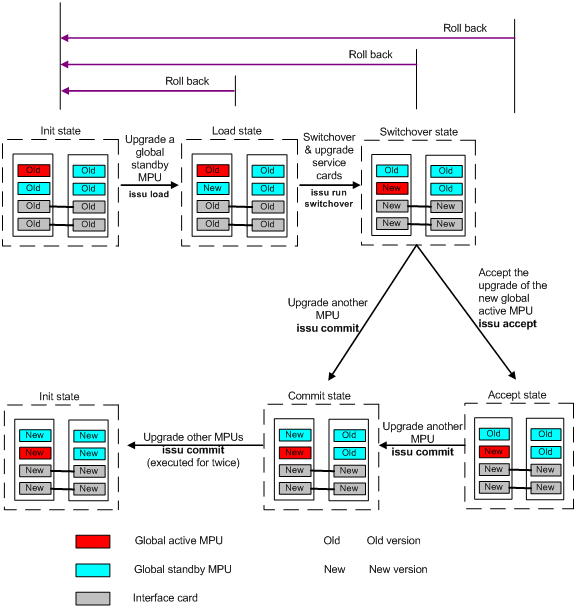

MPU-based ISSU upgrade (for compatible versions only)
With this method, an IRF fabric is considered as a single switch with one global active MPU, multiple global standby MPUs, and multiple interface cards. The global active MPU is the active MPU of the master switch. You can configure and manage the entire IRF fabric at the CLI of the global active MPU. All MPUs except the active MPU of the master switch are global standby MPUs.
To perform an MPU-based ISSU upgrade:
1.     Upgrade the standby MPU of the master when the global active MPU operates.
2.     Upgrade each interface card by installing a hotfix, and perform an active and standby switchover, so the upgraded standby MPU becomes the new global standby MPU.
3.     Upgrade the other MPUs one by one.
This method ensures non-stop services or the least service interruption during the ISSU upgrade process because data and state synchronization during the operation of the IRF fabric provides high consistency among all MPUs, and the interface cards are upgraded by installing a hotfix without rebooting them.
This method requires that the master have both an active MPU and a standby MPU installed and the new system software image contain hotfixes for all service cards of the IRF fabric.
During MPU-based ISSU upgrade, no master/subordinate switchover occurs.
This method applies only when the version compatibility check result is compatible.
The upgrade programs for the MPUs and service cards are compressed in the system software image. To upgrade system software image, use the issu load command.
You can use the display version comp-matrix file upgrading-filename command to display the upgrade method of each service card if you upgrade the current version to the version specified by the upgrading-filename argument. If the upgrade method of a service card is displayed as Hotfix, an MPU-based ISSU upgrade applies and the service on this service card will not be interrupted. If Reboot is displayed, a member switch-based or member switches-based ISSU upgrade applies and the service on this service card will be interrupted for a short time.

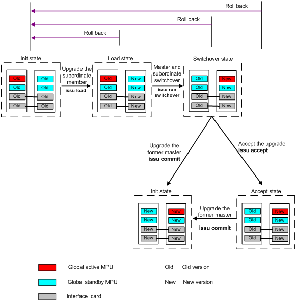

Member switch-based ISSU upgrade for compatible and partially compatible versions
With this method, each member switch is considered as a separate switch.
To perform a member switch-based ISSU upgrade for a compatible or partially compatible version:
1.     Upgrade a subordinate switch when the master is operating correctly.
2.     Set the priority of the subordinate switch so that the subordinate switch has a higher priority than the master.
3.     Perform a master/subordinate switchover so that the subordinate switch becomes the new master.
4.     Upgrade the former master and the other switches one by one.
This method does not require upgrade hotfixes in the system software image. It upgrades each member switch through switch reboot, thus causing a brief interruption to the traffic passing through the member switches. H3C recommends that you aggregate links on different interface cards or even different switches to avoid traffic interruption during the upgrade process.
This method is not applicable when the version compatibility check result is incompatible.

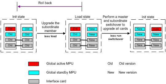

Member switch-based ISSU upgrade for incompatible versions
To perform a member switch-based ISSU upgrade for an incompatible version:
2.     Perform a master/subordinate switchover, so that the subordinate switch becomes the new master and the former master and the other switches get upgraded.
This method requires that the IRF connection is a ring connection if there are more than two members. If you do not follow this guideline, the IRF fabric will be partitioned during upgrade and the upgrade process will be out of control.
This method is not applicable when the version compatibility check result is compatible or partially compatible.

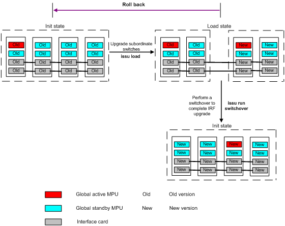

Member switches-based ISSU upgrade (for incompatible versions only)
With this method, multiple member switches are considered as a whole.
To perform a member switches-based ISSU upgrade:
1.     When the master is operating correctly, upgrade two or more subordinate switches.
2.     Perform a master/subordinate switchover so that an upgraded subordinate switch (the one with the highest priority) becomes the new master and the former master and the other switches get upgraded.
This method requires that the IRF connection is a ring connection if there are more than two members. If you do not follow this guideline, the IRF will be partitioned during upgrade and the upgrade process will be out of control.
The subordinate switches to be upgraded first must be physically connected.
This method is a good choice for upgrading a four-member IRF fabric. By upgrading more than one member first, this method helps improve the reliability of the ISSU upgrade and the service continuity during the upgrade.

Figure 1 MPU-based upgrade for compatible versions
Figure 2 Member switch-based upgrade for compatible/partially compatible versions
Figure 3 Member switch-based upgrade for incompatible versions
Figure 4 Member switches-based upgrade for incompatible versions

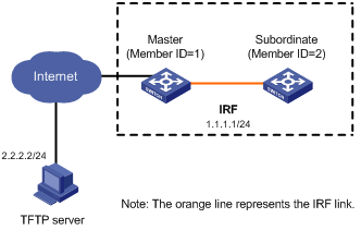

MPU-based ISSU upgrade example (compatible version)
Network requirements
As shown in Figure 5:
·     The IRF fabric comprises two member switches, each of which has an active MPU in slot 0 and a standby MPU in slot 1.
·     The current system software image of the IRF fabric is soft-version1. The latest system software image soft-version2.bin is saved on the TFTP server. The two versions are compatible.
·     The IRF fabric and the TFTP server can reach each other.
Use ISSU to upgrade the software version of the IRF fabric to soft-version2.
Figure 5 Network diagram
Upgrade procedure

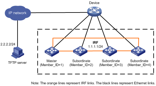

MPU-based ISSU upgrade example (four members, compatible version)
As shown in Figure 6:
·     The IRF fabric comprises four member switches, each of which has an active MPU in slot 0 and a standby MPU in slot 1.
Figure 6 Network diagram

Member switch-based ISSU upgrade example (four members, compatible or partially compatible version)
As shown in Figure 8:
·     The IRF fabric is made up of four member switches. The master has an MPU in slot 0, and each subordinate switch has an active MPU in slot 0 and a standby MPU in slot 1.
·     The current system software image of the IRF fabric is soft-version1. The latest system software image soft-version2.bin is saved on the TFTP server. The two versions are compatible. (This example also applies if the two versions are partially compatible.)
Figure 8 Network diagram
Upgrade procedure

Member switch-based ISSU upgrade example (incompatible version)
As shown in Figure 9:
·     The IRF fabric is made up of two member switches, each of which has an active MPU in slot 0 and a standby MPU in slot 1.
·     The current system software image of the IRF fabric is soft-version1. The latest system software image is soft-version2.bin and is saved on the TFTP server. The two versions are incompatible.
Use ISSU to upgrade the software version of the IRF fabric to soft-version2.bin.
Figure 9 Network diagram
Upgrade procedure

Member switch-based ISSU upgrade example (four members, incompatible version)
As shown in Figure 10:
·     The IRF fabric is made up of four member switches, each of which has an active MPU in slot 0 and a standby MPU in slot 1.
Perform a member switch-based ISSU upgrade to upgrade the software version of the IRF fabric to soft-version2.bin.
Figure 10 Network diagram
Upgrade procedure

[IRF] issu load file soft-version2.bin chassis 2 chassis 3 force
This command will begin ISSU, and the specified board will reboot and be upgraded. Please save the current running configuration first; otherwise, the configuration may be lost.Continue? [Y/N]:y
# After the two subordinate switches reboot, perform a master/subordinate switchover to complete the IRF fabric upgrade.
[IRF] issu run switchover
The system will continue to upgrade the software and reboot the other chassis. Continue? [Y/N]:y
The ISSU upgrade process is completed and the software of the IRF fabric is upgraded to the new version. The master is now the switch with the member ID 2.
