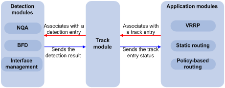

The Track module works between application and detection modules, as shown in Figure 1. It hides the differences among detection modules from application modules.
Collaboration is enabled after you associate the Track module with a detection module and an application module. The detection module monitors specific objects such as interface status, link status, network reachability, and network performance, and informs the Track module of detection results. The Track module sends the detection results to the associated application module, and the application module takes actions when the tracked object changes its state.
Figure 1 Collaboration through the Track module
Collaboration fundamentals
The Track module collaborates with detection modules and application modules:
·     Collaboration between the Track module and a detection module
·     Collaboration between the Track module and an application module
After being associated with a track entry, the detection module sends the detection result of the tracked object to the Track module, which then changes the status of the track entry:
·     If the tracked object functions correctly, for example, the target interface is up or the target network is reachable, the state of the track entry is Positive.
·     If the tracked object does not function correctly, for example, the target interface is down or the target network is unreachable, the state of the track entry is Negative.
·     If the detection result is not valid, for example, the NQA test group that is associated with the track entry does not exist, the state of the track entry is Invalid.
Detection modules that can be associated with the Track module include:
·     NQA
·     BFD
·     Interface management module
After being associated with an application module, when the status of the track entry changes, the Track module notifies the application module, which then takes proper actions.
Application modules that can be associated with the Track module include:
·     Virtual Router Redundancy Protocol (VRRP)
·     Static routing
·     Policy-based routing
In some cases, when the status of the track entry changes, if the Track module notifies the application modules immediately, communication might be interrupted because routes cannot be recovered in time. For example, the master in a VRRP group monitors the uplink interface through the Track module. When the uplink interface fails, the Track module notifies the master to reduce its priority so that a backup with a higher priority can preempt as the master to forward packets. When the uplink interface recovers, if the Track module notifies the original master to restore its priority immediately, the master will forward packets immediately; however, the uplink route has not been recovered yet, which might result in packet forwarding failure. Then configure the Track module to wait a specified delay time before notifying the application modules of the track entry status change.

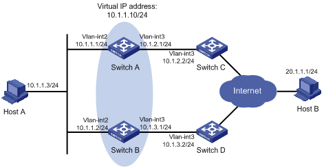

Network requirements
As shown in Figure 2, Host A needs to access Host B on the Internet. The default gateway of Host A is 10.1.1.10/24. Switch A and Switch B belong to VRRP group 1, whose virtual IP address is 10.1.1.10.
When Switch A works correctly, packets from Host A to Host B are forwarded through Switch A. When VRRP finds that a fault is on the uplink of Switch A through NQA, packets from Host A to Host B are forwarded through Switch B.
Figure 2 Network diagram

6.     Verify the configuration.
After configuration, ping Host B on Host A, and you can see that Host B is reachable. Use the display vrrp command to view the configuration result.
# Display detailed information about VRRP group 1 on Switch A.
[SwitchA-Vlan-interface2] display vrrp verbose
IPv4 Standby Information:
     Run Mode       : Standard
     Run Method     : Virtual MAC
 Total number of virtual routers : 1
   Interface Vlan-interface2
     VRID           : 1                    Adver Timer  : 5
     Admin Status   : Up                   State        : Master
     Config Pri     : 110                  Running Pri  : 110
     Preempt Mode   : Yes                  Delay Time   : 5
     Auth Type      : Simple               Key          : hello
     Virtual IP     : 10.1.1.10
     Virtual MAC    : 0000-5e00-0101
     Master IP      : 10.1.1.1
   VRRP Track Information:
     Track Object   : 1                    State : Positive   Pri Reduced : 30
# Display detailed information about VRRP group 1 on Switch B.
[SwitchB-Vlan-interface2] display vrrp verbose
     Run Mode       : Standard
     Admin Status   : Up                   State        : Backup
     Config Pri     : 100                  Running Pri  : 100
     Become Master  : 2200ms left
The output shows that in VRRP group 1, Switch A is the master and Switch B is a backup. Packets from Host A to Host B are forwarded through Switch A.
When a fault is on the link between Switch A and Switch C, you can still successfully ping Host B on Host A. Use the display vrrp command to view information about VRRP group 1.
# Display detailed information about VRRP group 1 on Switch A when a fault is on the link between Switch A and Switch C.
     Run Mode       : Standard
     Config Pri     : 110                  Running Pri  : 80
     Master IP      : 10.1.1.2
     Track Object   : 1                    State : Negative   Pri Reduced : 30
# Display detailed information about VRRP group 1 on Switch B when a fault is on the link between Switch A and Switch C.
     Run Mode       : Standard
The output shows that when a fault is on the link between Switch A and Switch C, the priority of Switch A decreases to 80. Switch A becomes the backup, and Switch B becomes the master. Packets from Host A to Host B are forwarded through Switch B.

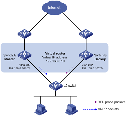

Configuring BFD for a VRRP backup to monitor the master
As shown in Figure 3, Switch A and Switch B belong to VRRP group 1, the virtual IP address of which is 192.168.0.10.
The default gateway of the hosts in the LAN is 192.168.0.10. When Switch A works correctly, the hosts in the LAN access the external network through Switch A. When Switch A fails, the hosts in the LAN access the external network through Switch B.
If BFD is not configured, when the master in a VRRP group fails, the backup cannot become the master until the configured timeout timer expires. The timeout is generally 3 to 4 seconds, which makes the switchover slow. To solve this problem, VRRP uses BFD to probe the state of the master. Once the master fails, the backup can become the new master in milliseconds.
Figure 3 Network diagram
Configuration procedure
<SwitchA> display vrrp verbose
     Run Mode       : Standard
     VRID           : 1                    Adver Timer  : 1
     Preempt Mode   : Yes                  Delay Time   : 0
     Auth Type      : None
     Virtual IP     : 192.168.0.10
     Master IP      : 192.168.0.101
<SwitchB> display vrrp verbose
     Run Mode       : Standard
     Auth Type      : None
     Track Object   : 1                    State : Positive   Switchover
# Display information about track entry 1 on Switch B.
<SwitchB> display track 1
Track ID: 1
  Status: Positive
  Duration: 0 days 0 hours 0 minutes 32 seconds
  Notification delay: Positive 0, Negative 0 (in seconds)
  Reference object:
    BFD session:
    Packet type: Echo
    Interface  : Vlan-interface2
    Remote IP  : 192.168.0.101
    Local IP   : 192.168.0.102
The output shows that when the status of the track entry becomes Positive, Switch A is the master and Switch B the backup.
# Enable VRRP state debugging and BFD event debugging on Switch B.
<SwitchB> terminal debugging
<SwitchB> terminal monitor
<SwitchB> debugging vrrp state
<SwitchB> debugging bfd event
# When Switch A fails, the following output is displayed on Switch B.
*Dec 17 14:44:34:142 2008 SwitchB BFD/7/EVENT:Send sess-down Msg, [Src:192.168.0.102,Dst:192.168.0.101,Vlan-interface2,Echo], instance:0, protocol:Track
*Dec 17 14:44:34:144 2008 SwitchB VRRP/7/DebugState: IPv4 Vlan-interface2 | Virtual Router 1 : Backup --> Master   reason: The status of the tracked object changed
# Display detailed information about the VRRP group on Switch B.
     Run Mode       : Standard
     Auth Type      : None
     Master IP      : 192.168.0.102
     Track Object   : 1                    State : Negative   Switchover
The output shows that when BFD detects that Switch A fails, it notifies VRRP through the Track module to change the status of Switch B to master, without waiting for a period three times the advertisement interval, so that a backup can quickly preempt as the master.

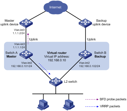

Configuring BFD for the VRRP master to monitor the uplinks
As shown in Figure 4, Switch A and Switch B belong to VRRP group 1, which has the virtual IP address 192.168.0.10. The default gateway of the hosts in the LAN is 192.168.0.10.
When Switch A works correctly, the hosts in the LAN access the external network through Switch A. When Switch A detects that the uplink is down through BFD, it decreases its priority so that Switch B can preempt as the master, ensuring that the hosts in the LAN can access the external network through Switch B.
Figure 4 Network diagram
# Display detailed information about the VRRP group on Switch A.
     Run Mode       : Standard
     Auth Type      : None
     Track Object   : 1                    State : Positive   Pri Reduced : 20
# Display information about track entry 1 on Switch A.
<SwitchA> display track 1
Track ID: 1
  Status: Positive
  Reference object:
    BFD session:
    Packet type: Echo
    Remote IP  : 1.1.1.2
    Local IP   : 1.1.1.1
     Run Mode       : Standard

The output shows that when the status of track entry 1 becomes Positive, Switch A is the master and Switch B the backup.
# When the uplink of Switch A goes down, the status of track entry 1 becomes Negative.
Track ID: 1
  Status: Negative
  Reference object:
    BFD session:
    Packet type: Echo
    Remote IP  : 1.1.1.2
    Local IP   : 1.1.1.1
     Run Mode       : Standard
     Config Pri     : 110                  Running Pri  : 90
     Auth Type      : None
     Track Object   : 1                    State : Negative   Pri Reduced : 20
     Run Mode       : Standard
     Auth Type      : None
The output shows that when Switch A detects that the uplink fails through BFD, it decreases its priority by 20 to make sure that Switch B can preempt as the master.

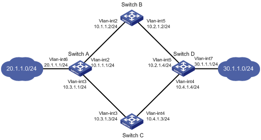

Static routing-Track-NQA collaboration configuration example
As shown in Figure 5, Switch A, Switch B, Switch C, and Switch D are connected to two segments 20.1.1.0/24 and 30.1.1.0/24. Configure static routes on these switches so that the two segments can communicate with each other, and configure route backup to improve reliability of the network.
Switch A is the default gateway of the hosts in segment 20.1.1.0/24. Two static routes to 30.1.1.0/24 exist on Switch A, with the next hop being Switch B and Switch C, respectively. These two static routes back up each other, where:
·     The static route with Switch B as the next hop has a higher priority, and is the master route. If this route is available, Switch A forwards packets to 30.1.1.0/24 through Switch B.
·     The static route with Switch C as the next hop acts as the backup route.
·     Configure static routing-Track-NQA collaboration to determine whether the master route is available in real time. If the master route is unavailable, the backup route takes effect, and Switch A forwards packets to 30.1.1.0/24 through Switch C.
Similarly, Switch D is the default gateway of the hosts in segment 30.1.1.0/24. Two static routes to 20.1.1.0/24 exist on Switch D, with the next hop being Switch B and Switch C, respectively. These two static routes back up each other, where:
·     The static route with Switch B as the next hop has a higher priority, and is the master route. If this route is available, Switch D forwards packets to 20.1.1.0/24 through Switch B.
·     Configure static routing-Track-NQA collaboration to determine whether the master route is available in real time. If the master route is unavailable, the backup route takes effect, and Switch D forwards packets to 20.1.1.0/24 through Switch C.
Figure 5 Network diagram

5.     Verify the configuration.
# Display information about the track entry on Switch A.
[SwitchA] display track all
Track ID: 1
  Status: Positive
  Reference object:
    BFD Session:
    Packet type: Echo
    Remote IP  : 10.2.1.2
    Local IP   : 10.2.1.1
# Display the routing table of Switch A.
[SwitchA] display ip routing-table
Routing Tables: Public
         Destinations : 9        Routes : 9
10.2.1.0/24         Direct 0    0            10.2.1.1        Vlan2
10.2.1.1/32         Direct 0    0            127.0.0.1       InLoop0
10.3.1.0/24         Direct 0    0            10.3.1.1        Vlan3
10.3.1.1/32         Direct 0    0            127.0.0.1       InLoop0
20.1.1.0/24         Direct 0    0            20.1.1.1        Vlan5
20.1.1.1/32         Direct 0    0            127.0.0.1       InLoop0
30.1.1.0/24         Static 60   0            10.2.1.2        Vlan2
127.0.0.0/8         Direct 0    0            127.0.0.1       InLoop0
127.0.0.1/32        Direct 0    0            127.0.0.1       InLoop0
The output shows the BFD detection result: the next hop 10.2.1.2 is reachable (the status of the track entry is Positive), and the master static route takes effect. Switch A forwards packets to 30.1.1.0/24 through Switch B.
# Remove the IP address of interface VLAN-interface 2 on Switch B.
<SwitchB> system-view
[SwitchB-Vlan-interface2] undo ip address
Track ID: 1
  Status: Negative
  Reference object:
    BFD Session:
    Packet type: Echo
    Local IP   : 10.2.1.1
30.1.1.0/24         Static 80   0            10.3.1.3        Vlan3
The output shows the BFD detection result: the next hop 10.2.1.2 is unreachable (the status of the track entry is Negative), and the backup static route takes effect, and Switch A forwards packets to 30.1.1.0/24 through Switch C and Switch B.
# When the master route fails, the hosts in 20.1.1.0/24 can still communicate with the hosts in 30.1.1.0/24.
[SwitchA] ping -a 20.1.1.1 30.1.1.1
  PING 30.1.1.1: 56  data bytes, press CTRL_C to break
    Reply from 30.1.1.1: bytes=56 Sequence=1 ttl=254 time=2 ms
    Reply from 30.1.1.1: bytes=56 Sequence=2 ttl=254 time=1 ms
    Reply from 30.1.1.1: bytes=56 Sequence=3 ttl=254 time=1 ms
    Reply from 30.1.1.1: bytes=56 Sequence=4 ttl=254 time=2 ms
    Reply from 30.1.1.1: bytes=56 Sequence=5 ttl=254 time=1 ms
  --- 30.1.1.1 ping statistics ---
    5 packet(s) transmitted
    5 packet(s) received
    0.00% packet loss
    round-trip min/avg/max = 1/1/2 ms
# The output on Switch B is similar to that on Switch A. When the master route fails, the hosts in 30.1.1.0/24 can still communicate with the hosts in 20.1.1.0/24.
[SwitchB] ping -a 30.1.1.1 20.1.1.1
  PING 20.1.1.1: 56  data bytes, press CTRL_C to break
    Reply from 20.1.1.1: bytes=56 Sequence=1 ttl=254 time=2 ms
    Reply from 20.1.1.1: bytes=56 Sequence=2 ttl=254 time=1 ms
    Reply from 20.1.1.1: bytes=56 Sequence=3 ttl=254 time=1 ms
    Reply from 20.1.1.1: bytes=56 Sequence=4 ttl=254 time=1 ms
    Reply from 20.1.1.1: bytes=56 Sequence=5 ttl=254 time=1 ms
  --- 20.1.1.1 ping statistics ---
    0.00% packet loss
VRRP-Track-interface management collaboration configuration example (the master monitors the uplink interface)
As shown in Figure 7, Host A needs to access Host B on the Internet. The default gateway of Host A is 10.1.1.10/24. Switch A and Switch B belong to VRRP group 1, whose virtual IP address is 10.1.1.10.
When Switch A works correctly, packets from Host A to Host B are forwarded through Switch A. When VRRP detects that a fault is on the uplink interface of Switch A through the interface management module, packets from Host A to Host B are forwarded through Switch B.
Figure 7 Network diagram
1.     Create VLANs, and assign corresponding ports to the VLANs, and configure the IP address of each VLAN interface as shown in Figure 7. (Details not shown.)
2.     Configure a track entry on Switch A.
# Configure track entry 1, and associate it with the physical status of the uplink interface VLAN-interface 3.
[SwitchA] track 1 interface vlan-interface 3
3.     Configure VRRP on Switch A.
# Create VRRP group 1, and configure the virtual IP address 10.1.1.10 for the group.
[SwitchA-Vlan-interface2] vrrp vrid 1 virtual-ip 10.1.1.10
# Set the priority of Switch A in VRRP group 1 to 110.
[SwitchA-Vlan-interface2] vrrp vrid 1 priority 110
# Configure to monitor track entry 1 and specify the priority decrement as 30.
[SwitchA-Vlan-interface2] vrrp vrid 1 track 1 reduced 30
4.     Configure VRRP on Switch B.
[SwitchB-Vlan-interface2] vrrp vrid 1 virtual-ip 10.1.1.10
     Run Mode       : Standard
     Auth Type      : None
     Run Mode       : Standard
     Auth Type      : None
# Shut down the uplink interface VLAN-interface 3 on Switch A.
[SwitchA-Vlan-interface2] interface vlan-interface 3
[SwitchA-Vlan-interface3] shutdown
After shutting down the uplink interface on Switch A, you can still successfully ping Host B on Host A. Use the display vrrp command to view information about VRRP group 1.
# After shutting down the uplink interface on Switch A, display detailed information about VRRP group 1 on Switch A.
[SwitchA-Vlan-interface3] display vrrp verbose
     Run Mode       : Standard
     Auth Type      : None
# After shutting down the uplink interface on Switch A, display detailed information about VRRP group 1 on Switch B.
     Run Mode       : Standard
     Auth Type      : None
The output shows that when the uplink interface on Switch A is shut down, the priority of Switch A decreases to 80. Switch A becomes the backup, and Switch B becomes the master. Packets from Host A to Host B are forwarded through Switch B.
