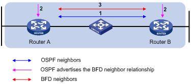

Figure 1 BFD session establishment (on OSPF routers)
BFD session establishment (as shown in Figure 1):
1.     A protocol sends Hello messages to discover neighbors and establish neighborships.
2.     After establishing neighborships, the protocol notifies BFD of the neighbor information, including destination and source addresses.
3.     BFD uses the information to establish BFD sessions.

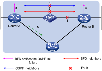

Figure 2 BFD fault detection (on OSPF routers)
BFD fault detection (as shown in Figure 2):
1.     BFD detects a link failure.
2.     BFD clears the neighbor session.
3.     BFD notifies the protocol of the failure.
4.     The protocol terminates the neighborship on the link.
5.     If a backup link is available, the protocol will use it to forward packets.

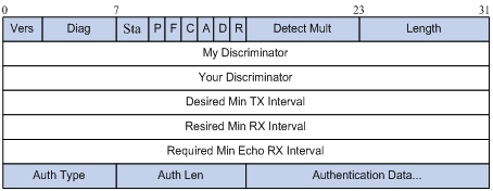

BFD packet format
BFD control packets are encapsulated into UDP packets with port number 3784 for single-hop detection or port number 4784 for multi-hop detection (also can be 3784 based on the configuration task). BFD echo packets have a similar format as BFD control packets (except that the Desired Min Tx Interval and Required Min Rx Interval fields are null) with UDP port number 3785. Figure 3 illustrates the BFD control packet format.
Figure 3 BFD packet format
·     Vers—Protocol version. The protocol version is 1.
·     Diag—This bit indicates the reason for the last transition of the local session from up to some other state. Table 1 lists the states.
Table 1 Diag bit values
Diag
Description
0
No Diagnostic.
1
Control Detection Time Expired.
2
Echo Function Failed.
3
Neighbor Signaled Session Down.
4
Forwarding Plane Reset.
5
Path Down.
6
Concatenated Path Down.
7
Administratively Down.
8
Reverse Concatenated Path Down.
9~31
Reserved for future use.
·     State (Sta)—Current BFD session state. Its value can be 0 for AdminDown, 1 for Down, 2 for Init, and 3 for Up.
·     Poll (P)—If set, the transmitting system is requesting verification of connectivity, or of a parameter change, and is expecting a packet with the Final (F) bit in reply. If clear, the transmitting system is not requesting verification.
·     Final (F)—If set, the transmitting system is responding to a received BFD control packet that had the Poll (P) bit set. If clear, the transmitting system is not responding to a Poll.
·     Control Plane Independent(C)—If set, the transmitting system's BFD implementation does not share fate with its control plane (in other words, BFD is implemented in the forwarding plane and can continue to function through disruptions in the control plane.)  If clear, the transmitting system's BFD implementation shares fate with its control plane.
·     Authentication Present (A)—If set, the Authentication Section is present and the session is to be authenticated.
·     Demand (D—If set, Demand mode is active in the transmitting system. (The system wishes to operate in Demand mode, knows that the session is up in both directions, and is directing the remote system to cease the periodic transmission of BFD Control packets.) If clear, Demand mode is not active in the transmitting system.
·     Reserved (R)—This byte must be set to zero on transmit, and ignored on receipt.
·     Detect Mult—Detection time multiplier.
·     Length—Length of the BFD control packet, in bytes.
·     My Discriminator—A unique, nonzero discriminator value generated by the transmitting system, used to demultiplex multiple BFD sessions between the same pair of systems.
·     Your Discriminator—It is the discriminator received from the corresponding remote system. This field reflects back the received value of My Discriminator, or is 0 if that value is unknown.
·     Desired Min Tx Interval—This is the minimum interval, in microseconds, that the local system would like to use when transmitting BFD control packets. The value zero is reserved.
·     Required Min Rx Interval—This is the minimum interval, in microseconds, between received BFD control packets that this system is capable of supporting. If this value is zero, the transmitting system does not want the remote system to send any periodic BFD control packets.
·     Required Min Echo Rx Interval—This is the minimum interval, in microseconds, between received BFD echo packets that this system is capable of supporting. If this value is zero, the transmitting system does not support the receipt of BFD echo packets.
·     Auth Type—The authentication type in use, if the Authentication Present (A) bit is set.
·     Auth Len—The length, in bytes, of the authentication section, including the Auth Type and Auth Len fields.
