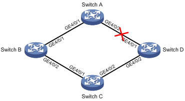

As shown in Figure 2, Switch C is a smart link device, and Switch A, Switch B, and Switch D are associated devices. Traffic of VLANs 1 through 30 on Switch C is dual-uplinked to Switch A through a smart link group.
Implement dual uplink backup on Switch C, and make sure that when the link between Switch A and Switch B (or Switch D) fails, Switch C must be able to sense the link fault and perform uplink switchover in the smart link group.
For more information about the Smart Link feature, see "Configuring Smart Link."
Figure 2 Network diagram

5.     Verify the configuration:
Use the display monitor-link group command display the monitor link group information on devices. For example, when GigabitEthernet 4/0/2 on Switch A goes down due to a link fault:
# Check information about monitor link group 1 on Switch B.
<SwitchB> display monitor-link group 1
 Monitor link group 1 information:
 Group status: UP
 Last-up-time: 16:37:20 2009/4/21
 Last-down-time: 16:35:26 2009/4/21
 Member                    Role     Status
 GigabitEthernet4/0/1      UPLINK   UP
 GigabitEthernet4/0/2      DOWNLINK UP
# Check information about monitor link group 1 on Switch D.
<SwitchD> display monitor-link group 1
 Group status: DOWN
 Last-up-time: 16:35:27 2009/4/21
 Last-down-time: 16:37:19 2009/4/21
 Member                    Role     Status
 GigabitEthernet4/0/1      UPLINK   DOWN
 GigabitEthernet4/0/2      DOWNLINK DOWN
