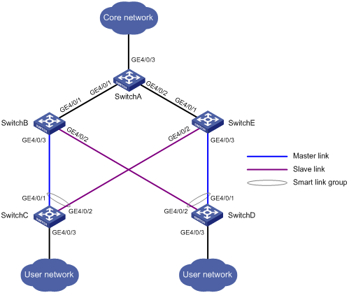

Background
To avoid single-point failures and guarantee network reliability, downstream devices are usually dual-homed to upstream devices, as shown in Figure 1.
Figure 1 Diagram for a dual uplink network
To remove network loops on a dual-homed network, you can use a spanning tree protocol or the Rapid Ring Protection Protocol (RRPP). The problem with STP, however, is that STP convergence time is long, which makes it not suitable for users who have high demand on convergence speed. RRPP can meet users' demand on convergence speed, but it involves complicated networking and configurations and therefore is mainly used in ring-shaped networks.
For more information about STP and RRPP, see Layer 2—LAN Switching Configuration Guide and "Configuring RRPP."Smart Link is a feature developed to address the slow convergence issue with STP. It provides link redundancy as well as fast convergence in a dual uplink network, allowing the backup link to take over quickly when the primary link fails. To sum up, Smart Link delivers the following benefits:
·     Dedicated to dual uplink networks
·     Subsecond convergence
·     Easy to configure

Smart link group
A smart link group consists of only two member ports: the master and the slave. At a time, only one port is active for forwarding, and the other port is blocked, in other words, in standby state. When link failure occurs on the active port due to port shutdown or presence of unidirectional link for example, the standby port becomes active to take over while the original active port transits to the blocked state.
As shown in Figure 1, GigabitEthernet 4/0/1 and GigabitEthernet 4/0/2 of Switch C and GigabitEthernet 4/0/1 and GigabitEthernet 4/0/2 of Switch D each form a smart link group, with GigabitEthernet 4/0/1 being active and GigabitEthernet 4/0/2 being standby.
Master/slave port
Master port and slave port are two port roles in a smart link group. When both ports in a smart link group are up, the master port preferentially transits to the forwarding state, while the slave port stays in standby state. Once the master port fails, the slave port takes over to forward traffic. As shown in Figure 1, you can configure GigabitEthernet 4/0/1 of Switch C and that of Switch D as master ports, and GigabitEthernet 4/0/2 of Switch C and that of Switch D slave ports.
Master/slave link
The link that connects the master port in a smart link group is the master link; the link that connects the slave port is the slave link.

Link backup mechanism
As shown in Figure 1, the link on GigabitEthernet 4/0/1 of Switch C is the master link, and the link on GigabitEthernet 4/0/2 of Switch C is the slave link. Typically, GigabitEthernet 4/0/1 is in forwarding state, while GigabitEthernet 4/0/2 is in standby state. When the link on GigabitEthernet 4/0/1 fails, GigabitEthernet 4/0/2 takes over to forward traffic while GigabitEthernet 4/0/1 is blocked and placed in standby state.
·     When a port switches to the forwarding state, the system outputs log information to notify the user of the port state change.
·     To keep traffic forwarding stable, the master port that has been blocked due to link failure does not take over immediately upon its recovery. Instead, link switchover will occur at next link switchover.

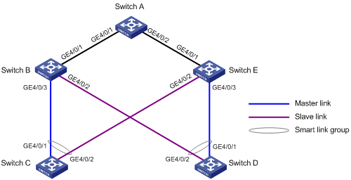

Single Smart Link group configuration example
Network requirements
As shown in Figure 2, Switch C and Switch D are smart link devices, and Switch A, Switch B, and Switch E are associated devices. Traffic of VLANs 1 through 30 on Switch C and Switch D are dually uplinked to Switch A.
Configure Smart Link on Switch C and Switch D for dual uplink backup.
Figure 2 Network diagram
Configuration procedure
1.     Configure Switch C:
# Create VLANs 1 through 30, map these VLANs to MSTI 1, and activate the MST region configuration.
<SwitchC> system-view
[SwitchC] vlan 1 to 30
[SwitchC] stp region-configuration
[SwitchC-mst-region] instance 1 vlan 1 to 30
[SwitchC-mst-region] active region-configuration
[SwitchC-mst-region] quit
# Shut down GigabitEthernet 4/0/1 and GigabitEthernet 4/0/2, disable the spanning tree feature on GigabitEthernet 4/0/1 and GigabitEthernet 4/0/2 separately, and configure them as trunk ports that permit VLANs 1 through 30.
[SwitchC] interface gigabitethernet 4/0/1
[SwitchC-GigabitEthernet4/0/1] shutdown
[SwitchC-GigabitEthernet4/0/1] undo stp enable
[SwitchC-GigabitEthernet4/0/1] port link-type trunk
[SwitchC-GigabitEthernet4/0/1] port trunk permit vlan 1 to 30
[SwitchC-GigabitEthernet4/0/1] quit
[SwitchC] interface gigabitethernet 4/0/2
[SwitchC-GigabitEthernet4/0/2] shutdown
[SwitchC-GigabitEthernet4/0/2] undo stp enable
[SwitchC-GigabitEthernet4/0/2] port link-type trunk
[SwitchC-GigabitEthernet4/0/2] port trunk permit vlan 1 to 30
[SwitchC-GigabitEthernet4/0/2] quit
# Create smart link group 1, and configure all VLANs mapped to MSTI 1 as the protected VLANs.
[SwitchC] smart-link group 1
[SwitchC-smlk-group1] protected-vlan reference-instance 1
# Configure GigabitEthernet 4/0/1 as the master port and GigabitEthernet 4/0/2 as the slave port for smart link group 1.
[SwitchC-smlk-group1] port gigabitethernet4/0/1 master
[SwitchC-smlk-group1] port gigabitethernet4/0/2 slave
# Enable flush message sending in smart link group 1, and configure VLAN 10 as the transmit control VLAN.
[SwitchC-smlk-group1] flush enable control-vlan 10
[SwitchC-smlk-group1] quit
# Bring up GigabitEthernet 4/0/1 and GigabitEthernet 4/0/2 again.
[SwitchC-GigabitEthernet4/0/1] undo shutdown
[SwitchC-GigabitEthernet4/0/2] undo shutdown
2.     Configure Switch D:
<SwitchD> system-view
[SwitchD] vlan 1 to 30
[SwitchD] stp region-configuration
[SwitchD-mst-region] instance 1 vlan 1 to 30
[SwitchD-mst-region] active region-configuration
[SwitchD-mst-region] quit
[SwitchD] interface gigabitethernet 4/0/1
[SwitchD-GigabitEthernet4/0/1] shutdown
[SwitchD-GigabitEthernet4/0/1] undo stp enable
[SwitchD-GigabitEthernet4/0/1] port link-type trunk
[SwitchD-GigabitEthernet4/0/1] port trunk permit vlan 1 to 30
[SwitchD-GigabitEthernet4/0/1] quit
[SwitchD] interface gigabitethernet 4/0/2
[SwitchD-GigabitEthernet4/0/2] shutdown
[SwitchD-GigabitEthernet4/0/2] undo stp enable
[SwitchD-GigabitEthernet4/0/2] port link-type trunk
[SwitchD-GigabitEthernet4/0/2] port trunk permit vlan 1 to 30
[SwitchD-GigabitEthernet4/0/2] quit
[SwitchD] smart-link group 1
[SwitchD-smlk-group1] protected-vlan reference-instance 1
[SwitchD-smlk-group1] port gigabitethernet4/0/1 master
[SwitchD-smlk-group1] port gigabitethernet4/0/2 slave
# Enable flush message sending in smart link group 1, and configure VLAN 20 as the transmit control VLAN.
[SwitchD-smlk-group1] flush enable control-vlan 20
[SwitchD-smlk-group1] quit
[SwitchD-GigabitEthernet4/0/1] undo shutdown
[SwitchD-GigabitEthernet4/0/2] undo shutdown
3.     Configure Switch B:
# Create VLANs 1 through 30.
<SwitchB> system-view
[SwitchB] vlan 1 to 30
# Configure GigabitEthernet 4/0/1 as a trunk port, and assign it to VLANs 1 through 30. Enable flush message receiving on it, and configure VLAN 10 and VLAN 20 as the receive control VLANs.
[SwitchB] interface gigabitethernet 4/0/1
[SwitchB-GigabitEthernet4/0/1] port link-type trunk
[SwitchB-GigabitEthernet4/0/1] port trunk permit vlan 1 to 30
[SwitchB-GigabitEthernet4/0/1] smart-link flush enable control-vlan 10 20
[SwitchB-GigabitEthernet4/0/1] quit
# Configure GigabitEthernet 4/0/2 as a trunk port, and assign it to VLANs 1 through 30. Disable the spanning tree feature and enable flush message receiving on it, and configure VLAN 20 as the receive control VLAN.
[SwitchB] interface gigabitethernet 4/0/2
[SwitchB-GigabitEthernet4/0/2] port link-type trunk
[SwitchB-GigabitEthernet4/0/2] port trunk permit vlan 1 to 30
[SwitchB-GigabitEthernet4/0/2] undo stp enable
[SwitchB-GigabitEthernet4/0/2] smart-link flush enable control-vlan 20
[SwitchB-GigabitEthernet4/0/2] quit
# Configure GigabitEthernet 4/0/3 as a trunk port, and assign it to VLANs 1 through 30. Disable the spanning tree feature and enable flush message receiving on it, and configure VLAN 10 as the receive control VLAN.
[SwitchB] interface gigabitethernet 4/0/3
[SwitchB-GigabitEthernet4/0/3] port link-type trunk
[SwitchB-GigabitEthernet4/0/3] port trunk permit vlan 1 to 30
[SwitchB-GigabitEthernet4/0/3] undo stp enable
[SwitchB-GigabitEthernet4/0/3] smart-link flush enable control-vlan 10
[SwitchB-GigabitEthernet4/0/3] quit
4.     Configure Switch E:
<SwitchE> system-view
[SwitchE] vlan 1 to 30
[SwitchE] interface gigabitethernet 4/0/1
[SwitchE-GigabitEthernet4/0/1] port link-type trunk
[SwitchE-GigabitEthernet4/0/1] port trunk permit vlan 1 to 30
[SwitchE-GigabitEthernet4/0/1] smart-link flush enable control-vlan 10 20
[SwitchE-GigabitEthernet4/0/1] quit
# Configure GigabitEthernet 4/0/2 as a trunk port, and assign it to VLANs 1 through 30. Disable the spanning tree feature and enable flush message receiving on it, and configure VLAN 10 as the receive control VLAN.
[SwitchE] interface gigabitethernet 4/0/2
[SwitchE-GigabitEthernet4/0/2] port link-type trunk
[SwitchE-GigabitEthernet4/0/2] port trunk permit vlan 1 to 30
[SwitchE-GigabitEthernet4/0/2] undo stp enable
[SwitchE-GigabitEthernet4/0/2] smart-link flush enable control-vlan 10
[SwitchE-GigabitEthernet4/0/2] quit
# Configure GigabitEthernet 4/0/3 as a trunk port, and assign it to VLANs 1 through 30. Disable the spanning tree feature and enable flush message receiving on it, and configure VLAN 20 as the receive control VLAN.
[SwitchE] interface gigabitethernet 4/0/3
[SwitchE-GigabitEthernet4/0/3] port link-type trunk
[SwitchE-GigabitEthernet4/0/3] port trunk permit vlan 1 to 30
[SwitchE-GigabitEthernet4/0/3] undo stp enable
[SwitchE-GigabitEthernet4/0/3] smart-link flush enable control-vlan 20
[SwitchE-GigabitEthernet4/0/3] quit
5.     Configure Switch A:
<SwitchA> system-view
[SwitchA] vlan 1 to 30
# Configure GigabitEthernet 4/0/1 and GigabitEthernet 4/0/2 as trunk ports that permit VLANs 1 through 30. Enable flush message receiving on them, and configure VLAN 10 and VLAN 20 as the receive control VLANs.
[SwitchA] interface gigabitethernet 4/0/1
[SwitchA-GigabitEthernet4/0/1] port link-type trunk
[SwitchA-GigabitEthernet4/0/1] port trunk permit vlan 1 to 30
[SwitchA-GigabitEthernet4/0/1] smart-link flush enable control-vlan 10 20
[SwitchA-GigabitEthernet4/0/1] quit
[SwitchA] interface gigabitethernet 4/0/2
[SwitchA-GigabitEthernet4/0/2] port link-type trunk
[SwitchA-GigabitEthernet4/0/2] port trunk permit vlan 1 to 30
[SwitchA-GigabitEthernet4/0/2] smart-link flush enable control-vlan 10 20
[SwitchA-GigabitEthernet4/0/2] quit
6.     Verify the configuration:
You can use the display smart-link group command to display the smart link group configuration on a switch.
# Display the smart link group configuration on Switch C.
<SwitchC> display smart-link group 1
 Smart link group 1 information:
 Device ID: 000f-e23d-5af0
 Preemption mode: NONE
 Preemption delay: 1(s)
 Control VLAN: 10
 Protected VLAN: Reference Instance 1
 Member                      Role    State    Flush-count Last-flush-time
 GigabitEthernet4/0/1                 MASTER  ACTVIE   5           16:37:20 2010/02/21
 GigabitEthernet4/0/2                 SLAVE   STANDBY  1           17:45:20 2010/02/21
You can use the display smart-link flush command to display the flush messages received on a switch.
# Display the flush messages received on Switch B.
<SwitchB> display smart-link flush
 Received flush packets                             : 5
 Receiving interface of the last flush packet       : GigabitEthernet4/0/3
 Receiving time of the last flush packet            : 16:25:21 2009/02/21
 Device ID of the last flush packet                 : 000f-e23d-5af0
 Control VLAN of the last flush packet              : 1
Multiple Smart Link groups load sharing configuration example
As shown in Figure 3, Switch C is a smart link device, and Switch A, Switch B, and Switch D are associated devices. Traffic of VLANs 1 through 200 on Switch C are dually uplinked to Switch A by Switch B and Switch D.
Implement dual uplink backup and load sharing on Switch C: traffic of VLANs 1 through 100 is uplinked to Switch A by Switch B; traffic of VLANs 101 through 200 is uplinked to Switch A by Switch D.
Figure 3 Network diagram
1.     Configure Device C:
# Create VLAN 1 through VLAN 200, map VLANs 1 through 100 to MSTI 1, and VLANs 101 through 200 to MSTI 2, and activate MST region configuration.
[SwitchC] vlan 1 to 200
[SwitchC-mst-region] instance 1 vlan 1 to 100
[SwitchC-mst-region] instance 2 vlan 101 to 200
# Shut down GigabitEthernet 4/0/1 and GigabitEthernet 4/0/2, disable the spanning tree feature on GigabitEthernet 4/0/1 and GigabitEthernet 4/0/2 separately, configure the ports as trunk ports, and assign them to VLAN 1 through VLAN 200.
[SwitchC-GigabitEthernet4/0/1] port trunk permit vlan 1 to 200
[SwitchC-GigabitEthernet4/0/2] port trunk permit vlan 1 to 200
# Create smart link group 1, and configure all VLANs mapped to MSTI 1 as the protected VLANs for smart link group 1.
# Enable role preemption in smart link group 1, enable flush message sending, and configure VLAN 10 as the transmit control VLAN.
[SwitchC-smlk-group1] preemption mode role
[SwitchC-smlk-group-1] flush enable control-vlan 10
[SwitchC-smlk-group-1] quit
# Create smart link group 2, and configure all VLANs mapped to MSTI 2 as the protected VLANs for smart link group 2.
[SwitchC] smart-link group 2
[SwitchC-smlk-group2] protected-vlan reference-instance 2
# Configure GigabitEthernet 4/0/1 as the slave port and GigabitEthernet 4/0/2 as the master port for smart link group 2.
[SwitchC-smlk-group2] port gigabitethernet4/0/2 master
[SwitchC-smlk-group2] port gigabitethernet4/0/1 slave
# Enable role preemption in smart link group 2, enable flush message sending, and configure VLAN 110 as the transmit control VLAN.
[SwitchC-smlk-group2] preemption mode role
[SwitchC-smlk-group2] flush enable control-vlan 110
[SwitchC-smlk-group2] quit
2.     Configure Switch B:
# Create VLAN 1 through VLAN 200.
[SwitchB] vlan 1 to 200
# Configure GigabitEthernet 4/0/1 as a trunk port and assign it to VLANs 1 through 200. Enable flush message receiving and configure VLAN 10 and VLAN 110 as the receive control VLANs on GigabitEthernet 4/0/1.
[SwitchB-GigabitEthernet4/0/1] port trunk permit vlan 1 to 200
[SwitchB-GigabitEthernet4/0/1] smart-link flush enable control-vlan 10 110
# Configure GigabitEthernet 4/0/2 as a trunk port and assign it to VLANs 1 through 200. Disable the spanning tree feature and enable flush message receiving on it, and configure VLAN 10 and VLAN 110 as the receive control VLANs.
[SwitchB-GigabitEthernet4/0/2] port trunk permit vlan 1 to 200
[SwitchB-GigabitEthernet4/0/2] smart-link flush enable control-vlan 10 110
3.     Configure Switch D:
[SwitchD] vlan 1 to 200
[SwitchD-GigabitEthernet4/0/1] port trunk permit vlan 1 to 200
[SwitchD-GigabitEthernet4/0/1] smart-link flush enable control-vlan 10 110
[SwitchD-GigabitEthernet4/0/2] port trunk permit vlan 1 to 200
[SwitchD-GigabitEthernet4/0/2] smart-link flush enable control-vlan 10 110
4.     Configure Switch A:
[SwitchA] vlan 1 to 200
# Configure GigabitEthernet 4/0/1 and GigabitEthernet 4/0/2 as trunk ports and assign them to VLANs 1 through 200. Enable flush message receiving and configure VLAN 10 and VLAN 110 as the receive control VLANs on GigabitEthernet 4/0/1 and GigabitEthernet 4/0/2.
[SwitchA-GigabitEthernet4/0/1] port trunk permit vlan 1 to 200
[SwitchA-GigabitEthernet4/0/1] smart-link flush enable control-vlan 10 110
[SwitchA-GigabitEthernet4/0/2] port trunk permit vlan 1 to 200
[SwitchA-GigabitEthernet4/0/2] smart-link flush enable control-vlan 10 110
5.     Verify the configuration:
<SwitchC> display smart-link group all
 Preemption mode: ROLE
 Control VLAN: 10
 Smart link group 2 information:
 Control VLAN: 110
 Protected VLAN: Reference Instance 2
 GigabitEthernet4/0/2                MASTER  ACTVIE   5           16:37:20 2010/02/21
 GigabitEthernet4/0/1                SLAVE   STANDBY  1           17:45:20 2010/02/21
